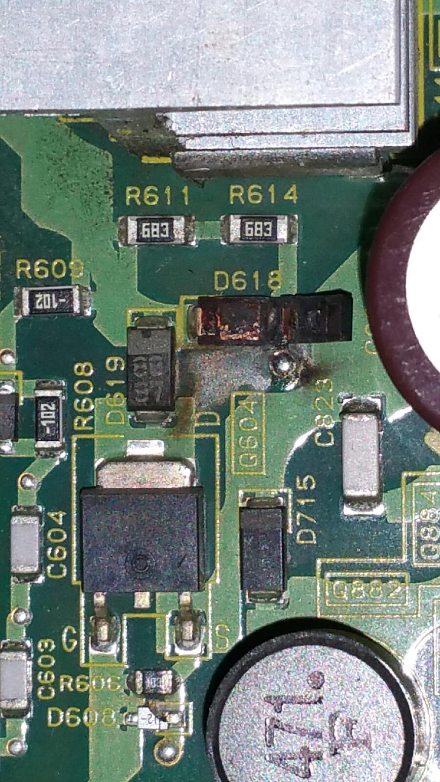

          Re: Panasonic TC-P42S1 - 10 Blinks Replaced SC Board Now 7 Blinks
          Upon closer inspection of the refurbished SC board I purchased, who thinks I was sold a bunk board? Pictures attached...see D618

            Re: Panasonic TC-P42S1 - 1 Blinks Replaced SC Board Now 7 Blinks
            i would send that board back and get a refund that didodes certainly blown.
            Did you do the buffer test? to make sure there ok.

                      • Hombre
                        • Jul 2013
                        • 231
                        • Croatia
                        You can check if buffers are short easily, just watch this video:
                        https://www.youtube.com/watch?v=51SZsfH60EY
                        I assume they are ok, but check it, twice
                        Your old board sounds like dead short on SC connector, "new" one, who knows
                        Unplug old sc board and measure resistance on SC connector. If shorted (100%) start checking fets, diodes. Start with q661, usual suspect.
                            Well it's not only q661 that is damaged, for sure, so simply replacing that one most probably won't solve anything and there is high posibility that more damage will be done.
                            And you can test all the others, like q401, 421,etc, diodes, and then regulators, basically you have to check everything for shorts/low resistance.
                            You can search here TNPA4829 or TNPA4844 or TNPA4872 and see where to check, and how. Alot of good info on the forum.
                            Measure resistance from TP82 to GND, also C561 to GND, write them down.
