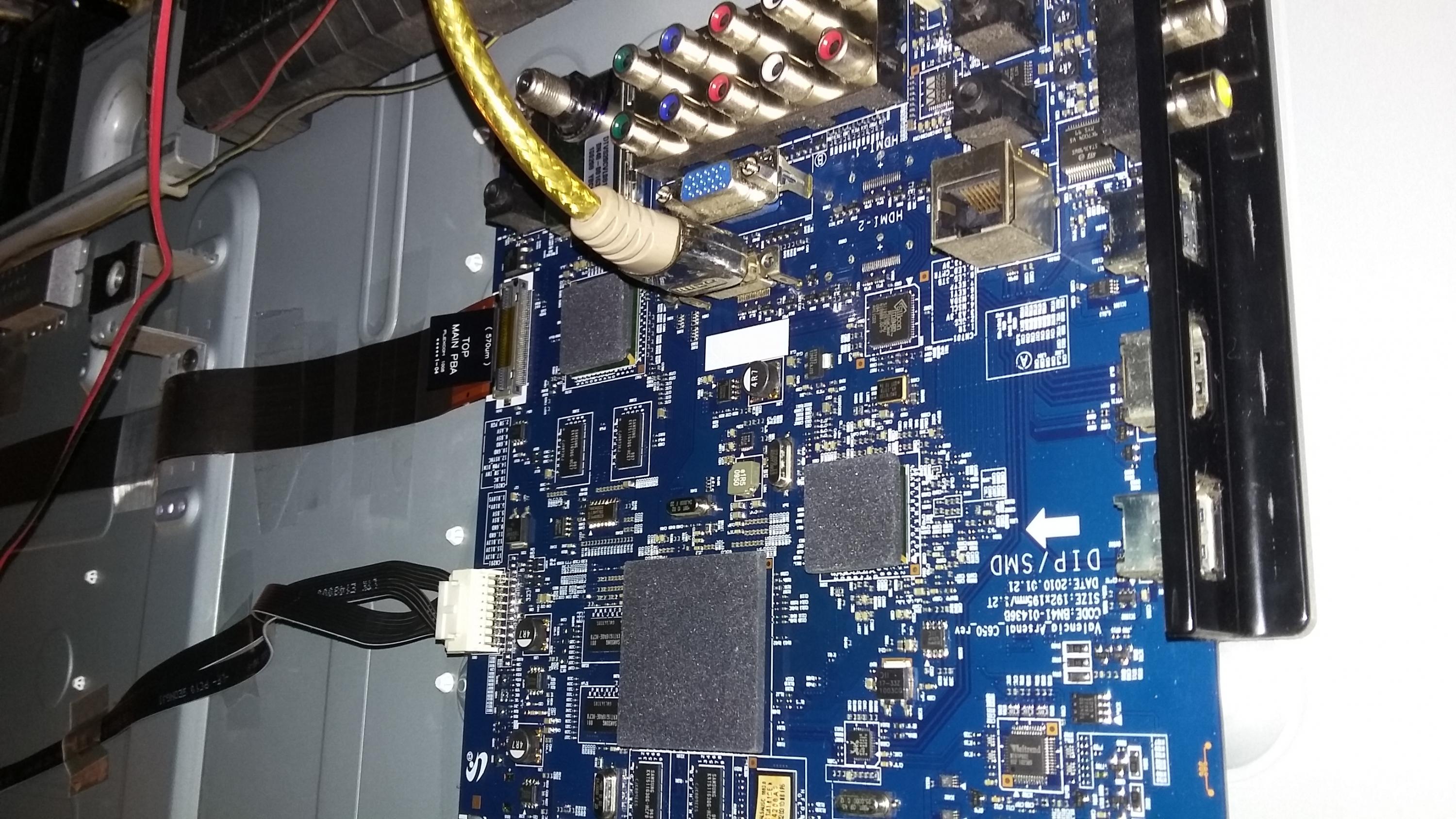

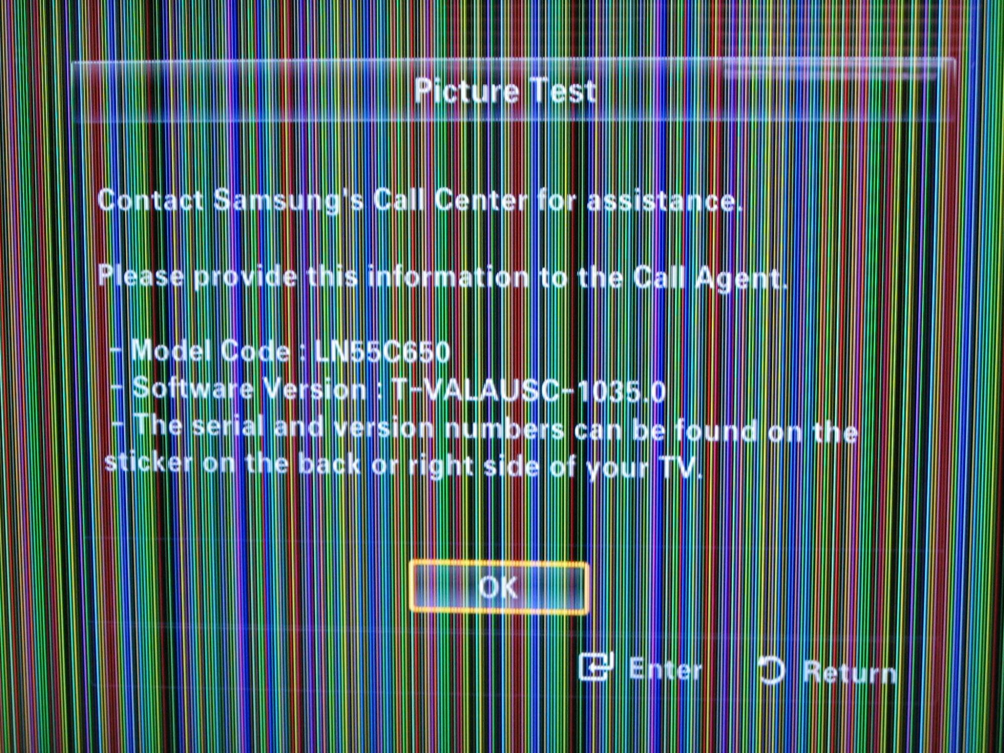

    i have a samsung 55in tv its a ln55c630K1FXZA it still works just gets lines in picture. im looking for s new main board or one that will work with my model tv. any help would be greatly appericated. bn94-02701e is the board tag.

    Post pictures of the fault. This sounds like a bad panel right off the bat based on your description.

        i know the pannel has a problem if i tap the ribbon cable that goes to bn94-02701e it fixes it for a little while. it also has 2 hdmi ports that came disconnected. i cant find these boards anywhere. are there other boards that are compatible? thanks for the help.

          Images of the boards please, also have you reseated and cleaned the wires ? Seems like motherboard fault to me not the panel.

            i think its the main circut board that has the issue because when i reseat the cable to the board it fixes it for a while.

              Had a 55" Sammy that displayed similar symptom...My lines were green...new Main Bd solved my issue.

                  Maybe give the Mb a reflow my bet that the issue is bad Bga solder under one of the heatsunk cpu's.

                        also tried a reflow and no luck. its an issue at the ribbon cable connection to the board.
