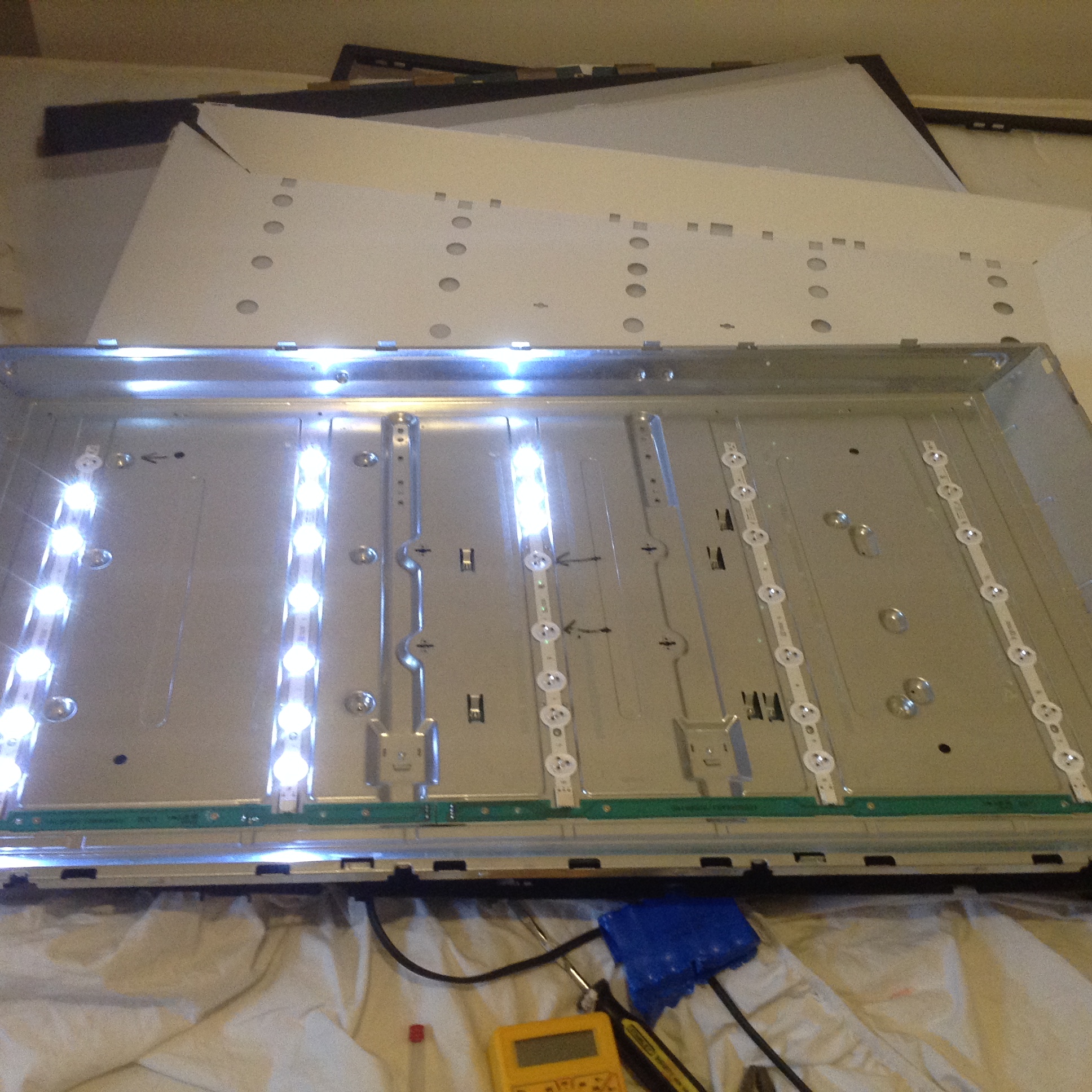

        #43
        Re: Digihome (Vestel) LED Backlighting Problem
        In that pic, one led is out on the very top left.

          #44
          Correct - the other two faulty bulbs are in the middle row (with the black arrows next to them). Not apparent from the photo though - tested with a 7.2V battery

            #45
            The two and a half strips that work - voltage drop across each bulb is 2.4 - 2.5V, nice steady bright light.
            The two and a half strips that don't work - voltage drop across each bulb is ALSO 2.4 - 2.5V, but they just barely light up. Not only that, but they stay in their just barely lit up state when I put the TV in standby mode!

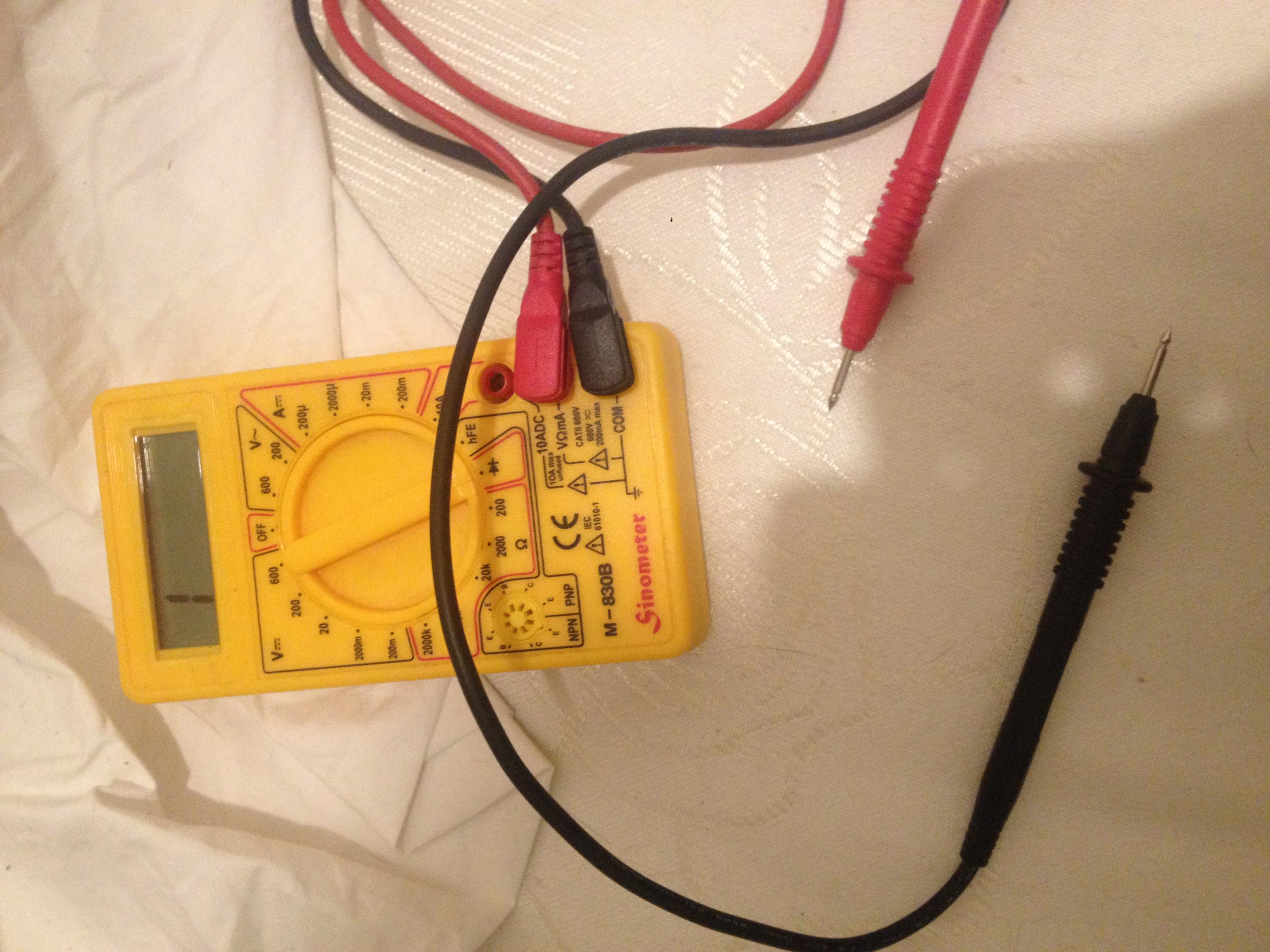

                                  Originally posted by Diah
                                  you use analogue test meter ?
                                  No, it's digital. Photo below...
