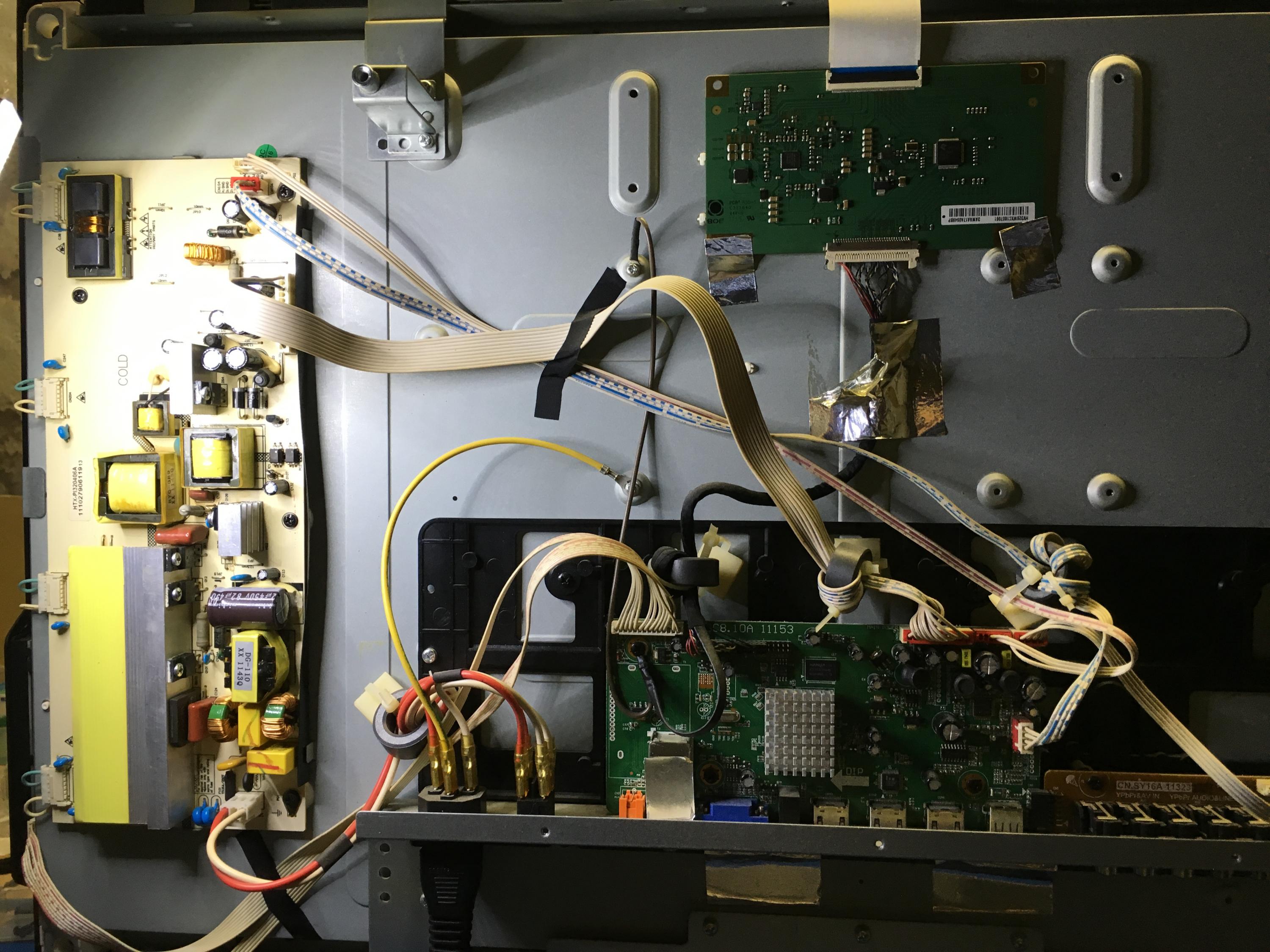

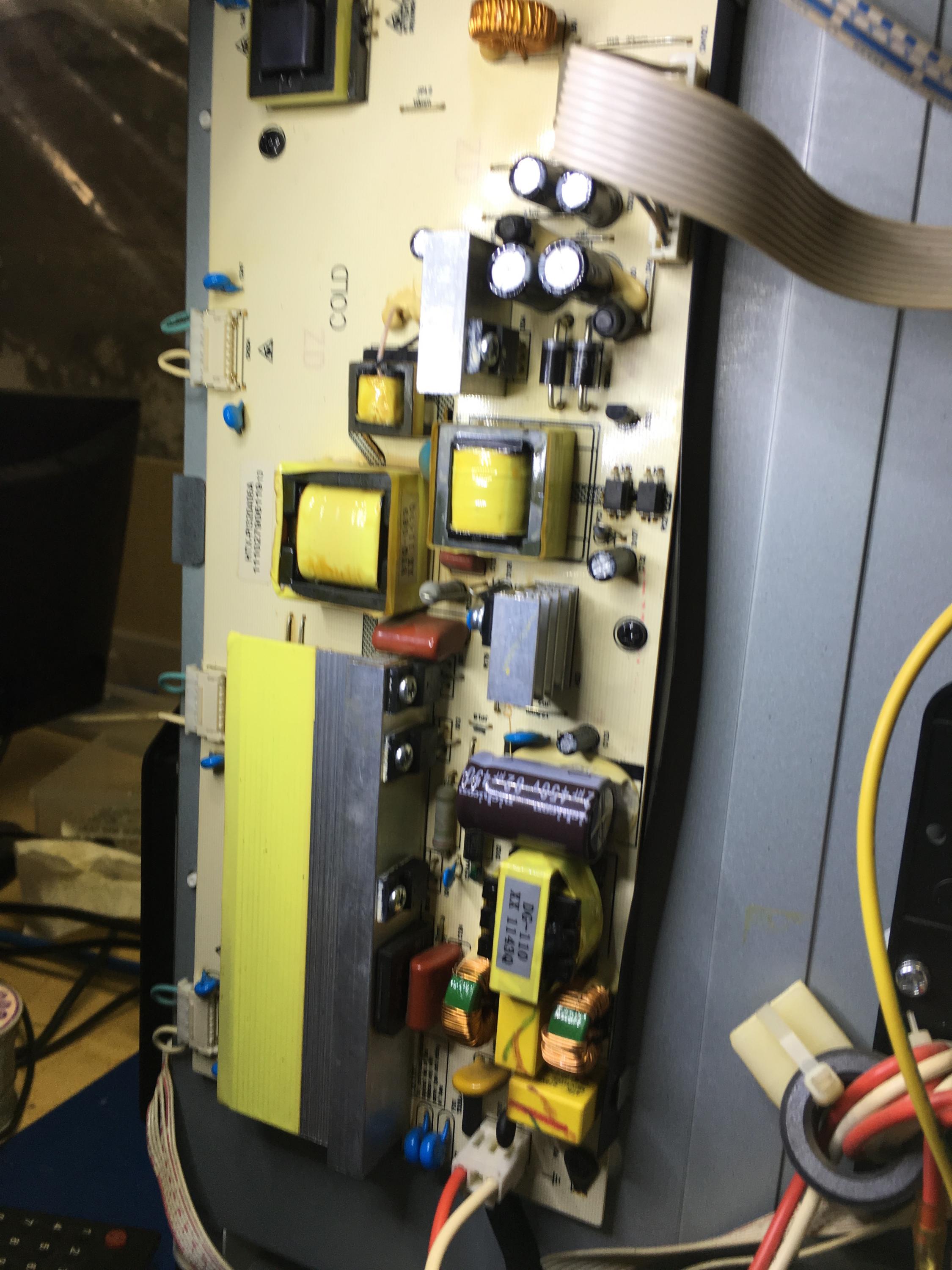

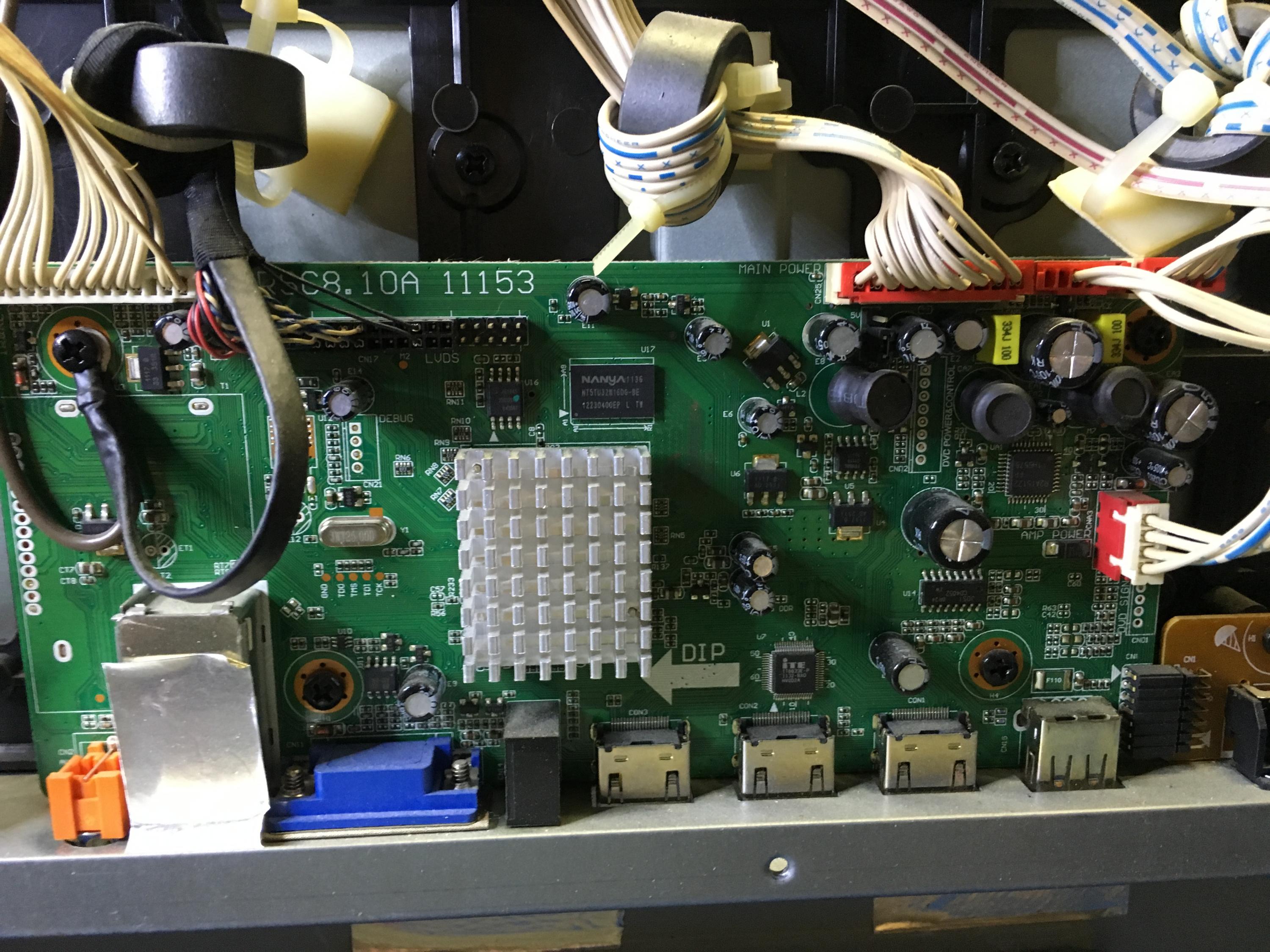

    RCA RLC3257A dead
    I have an RCA tv with no standby or anything. Everything seems ok on the hot side of the power supply, so I am leaning towards a possible main board issue. Since RCA does not supply service manuals, how can I force the p/s on so I can rule it out. I don't see any PS_ON anywhere. There is 5, 12 and 24V. Can I put 5V into the p/s to turn it on, since I am not seeing a PSON anywhere.
  • sordids999
    • May 2013
    • 2149
    • uk
    Re: RCA RLC3257A dead
    Posting pictures of the back of your tv showing the boards with clear pictures may help you more with fixing your problem
    • ReeceyBurger123
      Never Give Up !
      • May 2014
      • 7325
      • Britain
      Faulty Mb probably flash Ic failed/corrupt firmware.
      • tech2014
        • Aug 2014
        • 807
        • ReeceyBurger123
          Never Give Up !
          • May 2014
          • 7325
          • Britain
          Yep RS/TMS junk board it will be the firmware thats gone, probably easier to replace the mb.
          • tech2014
            • Aug 2014
            • 807
            thanks. Shop jimmy has a bunch but not for RCA.
            • ReeceyBurger123
              Never Give Up !
              • May 2014
              • 7325
              • Britain
              Doesn't matter what brand is buddy these are used in loads of Tv's You only need to match it to the panel model thats it.
              • tech2014
                • Aug 2014
                • 807
                oh thats awesome, thanks.
                • ReeceyBurger123
                  Never Give Up !
                  • May 2014
                  • 7325
                  • Britain
                  Ok matey let us know how it goes
