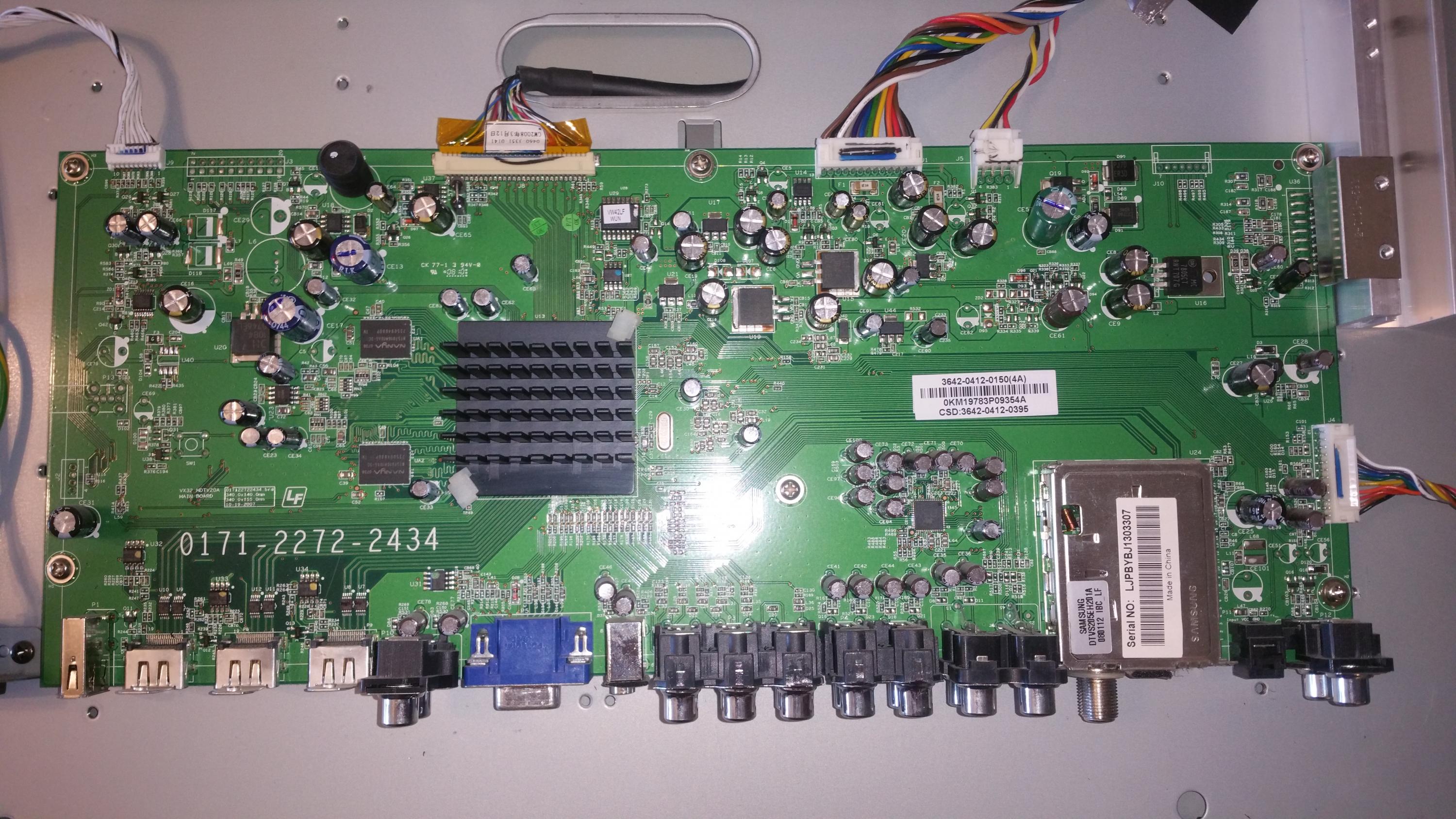

              Got no idea on what the IC number is. You didn't post any pictures. Post a high resolution, straight shot picture of YOUR mainboard. Then we can find the EEPROM.

                Re: Vizio VW42LFHDTV10A Dies after a few minutes
                Look if your main board has a U29. Its a 16 pin IC, next to the LVDS connector.
                  16 pin U29 - yes. MB pic attached.
                    I've got a zillion little stick-on raspberry pi heat sinks, think I should strategically stick those on some components?
                      Try suggestion in post #4 on U29, see if it changes symptoms.
                        air cooling with a tiny fan seems to have lengthened the run time. Unfortunately, I'm having a hard time finding that component.
                                    Check U44,U17,U21 and U22? all LVDO(low voltage drop out) voltage regulators.
                                    Check their voltage while the TV is operating properly vs when it shuts down.
                                    We need the voltage on all three legs. Please report it this format:
                                    Uxx (Also part number written on the chip)
                                    operating not operating
                                    Pin 1 x.xxvolts x.xxvolts
                                    Pin 2 x.xxv x.xxv
                                    Pin 3 x.xxv x.xxv
                                    Positive DC probe to the chip, Negative DC probe to chassis.
                                    That eeprom chip $15 at Shopjimmy.
                                    (board number 3642-0412-0150)
