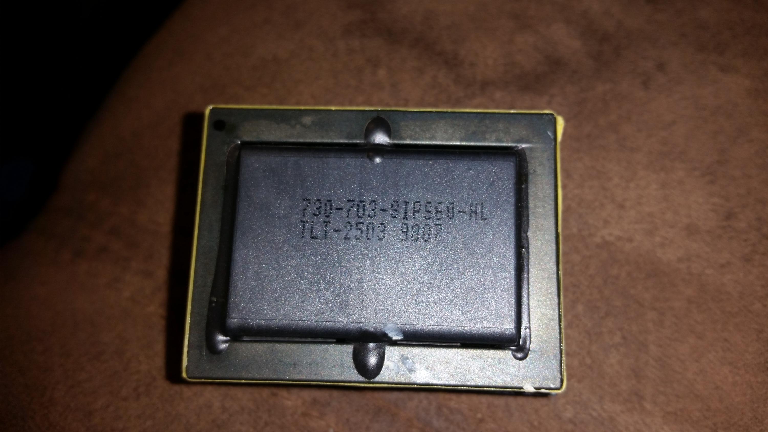

      The only method of testing i have is a DMM, i checked the resistance between the ballast caps and for the top 2 which are 10p 6000v i had around .030nf, i asume that is picofarads, and the other 2, which are 6000v 15p test at .022 nf, as for the inverter, there is no resistance across any pins whatsoever, i measured in ohms, is that correct?
        Re: Element 32le30q
        I get a resistance of 1.5 ohms between the two pins that show shorted, im still not sure how to identify which pins are which on this inverter.
          Re: Element 32le30q
          https://www.badcaps.net/forum/attach...6&d=1471213443
          The transformer only has one primary winding, those two pins are the primary winding and it will show very low Ohms reading (DCR: DC Resistance), it also has only one winding for the Secondary high Voltage side.
          You can see how the wires are attached to the pins.

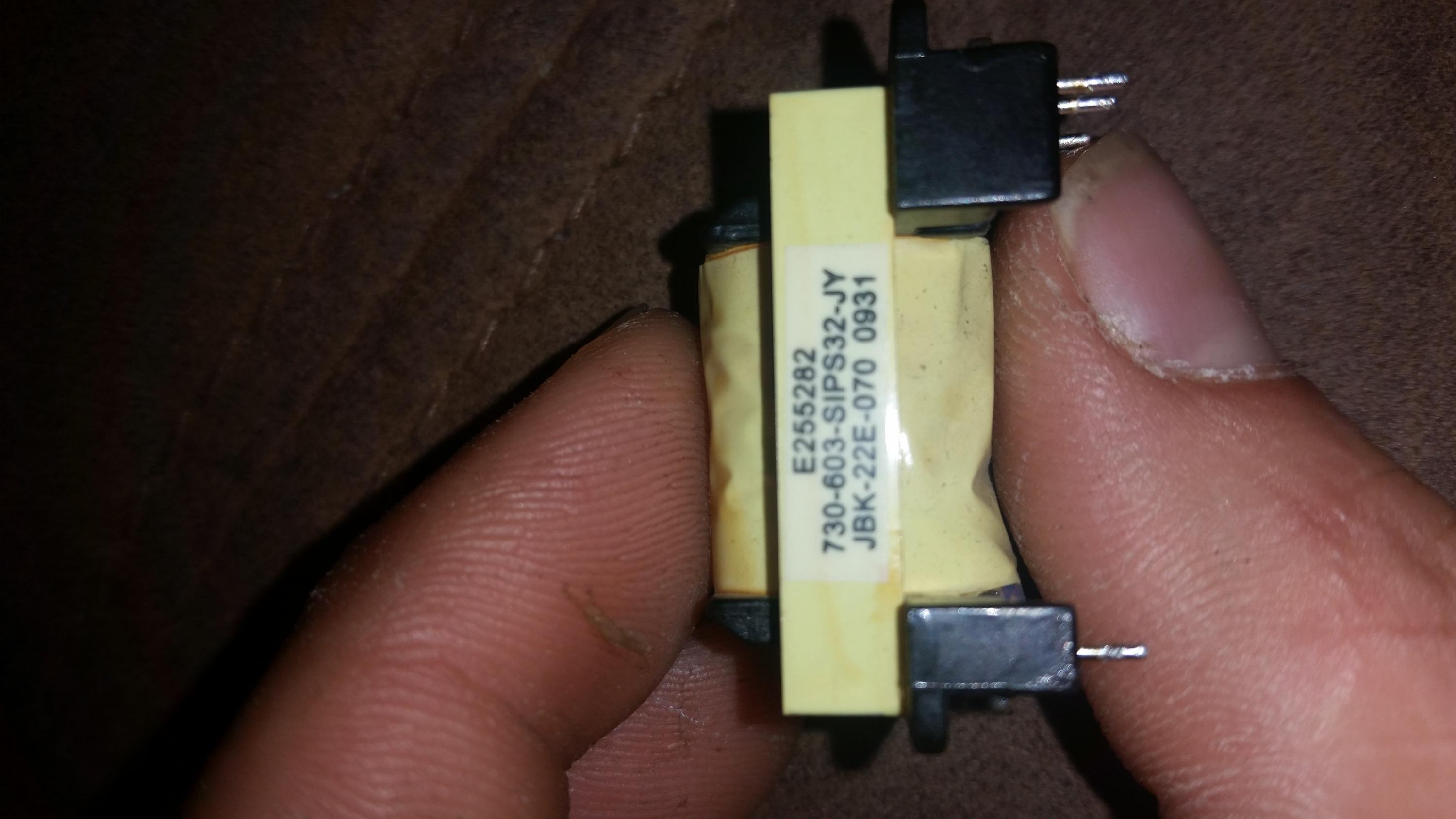

          The primary winding of the inverter transformer is being driven by that yellow transformer next to it, if you trace out the connections you can see how they are connected.

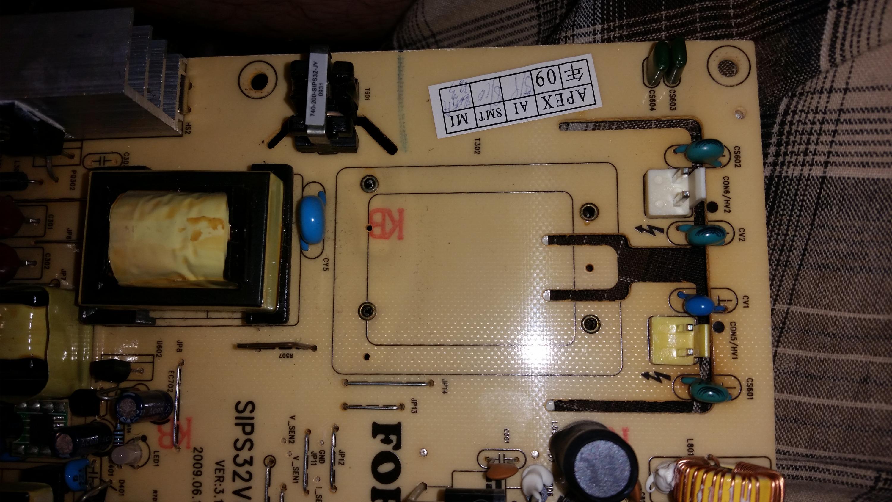

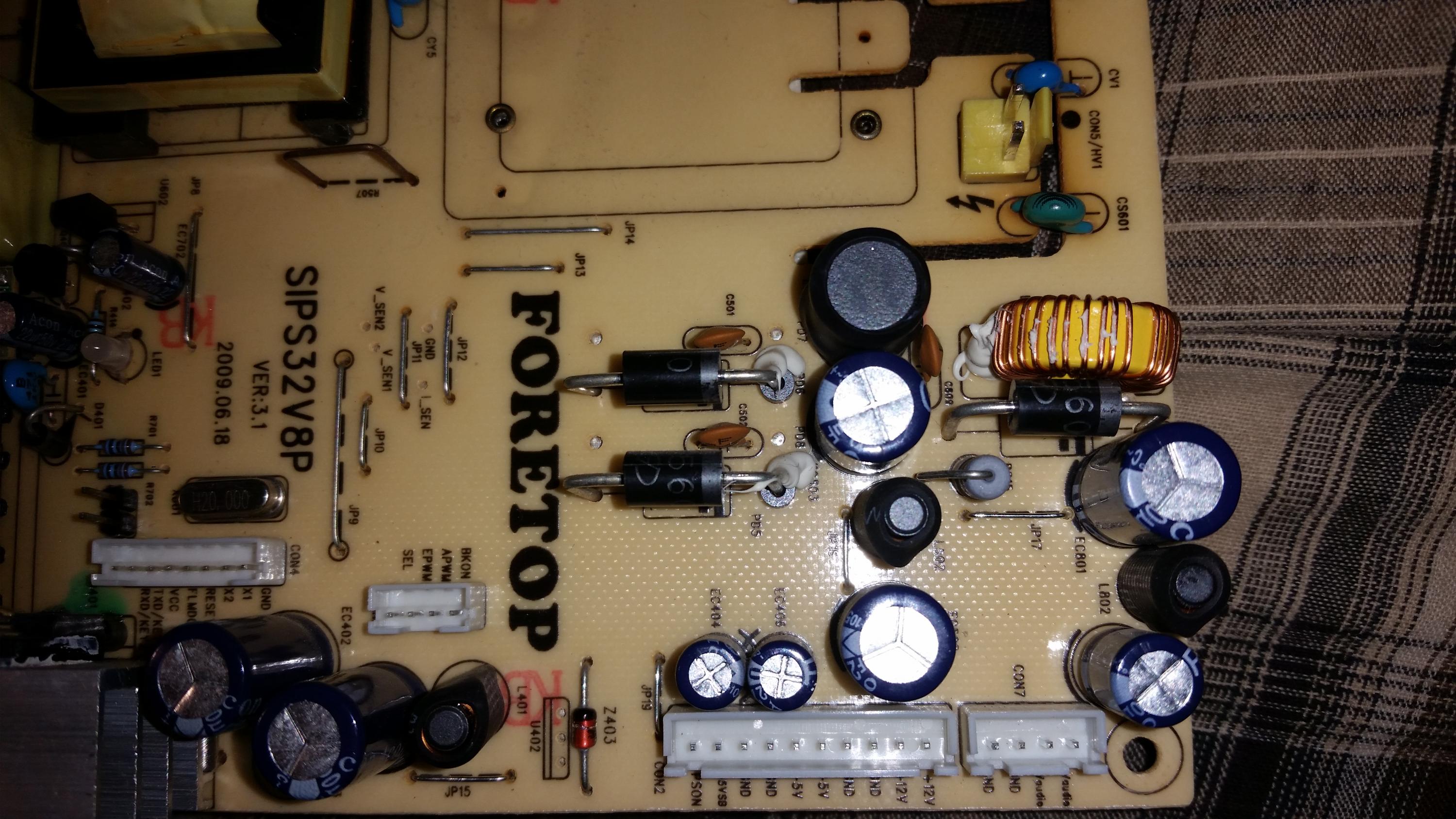

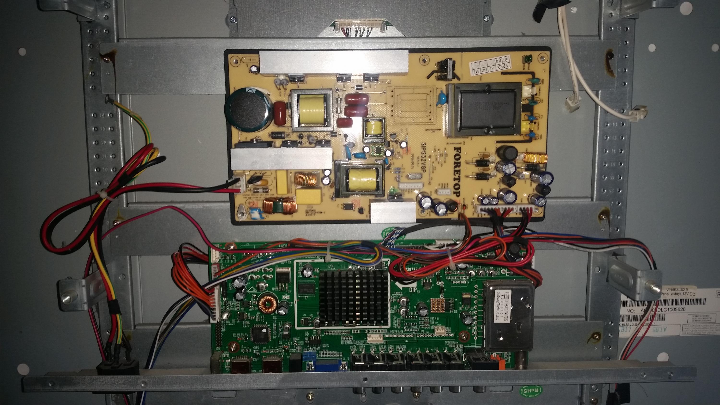

                Can we see the pictures of the whole backside of the TV showing all the boards and how they are connected together?
                There are so many versions of this model.
                http://www.shopjimmy.com/catalogsear...lement+32le30q
                Which version of the power supply do you have?
                OK, it looks like you have version 3.1 Power supply based on you pictures.

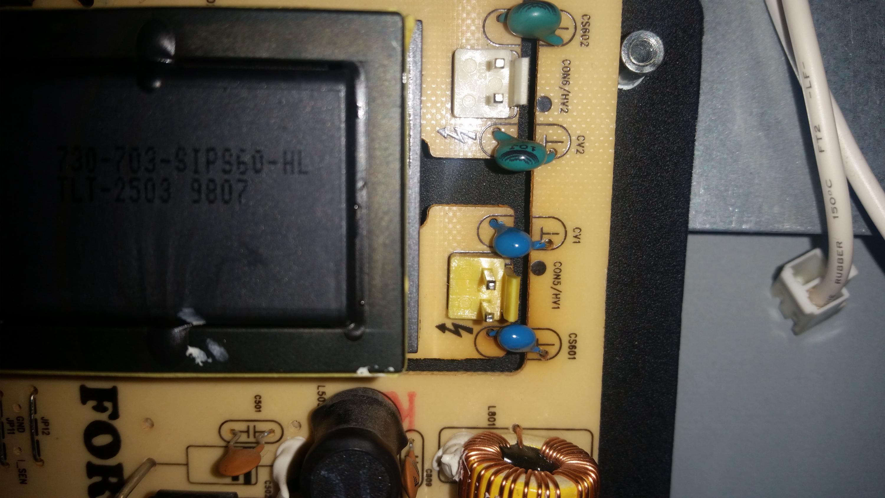

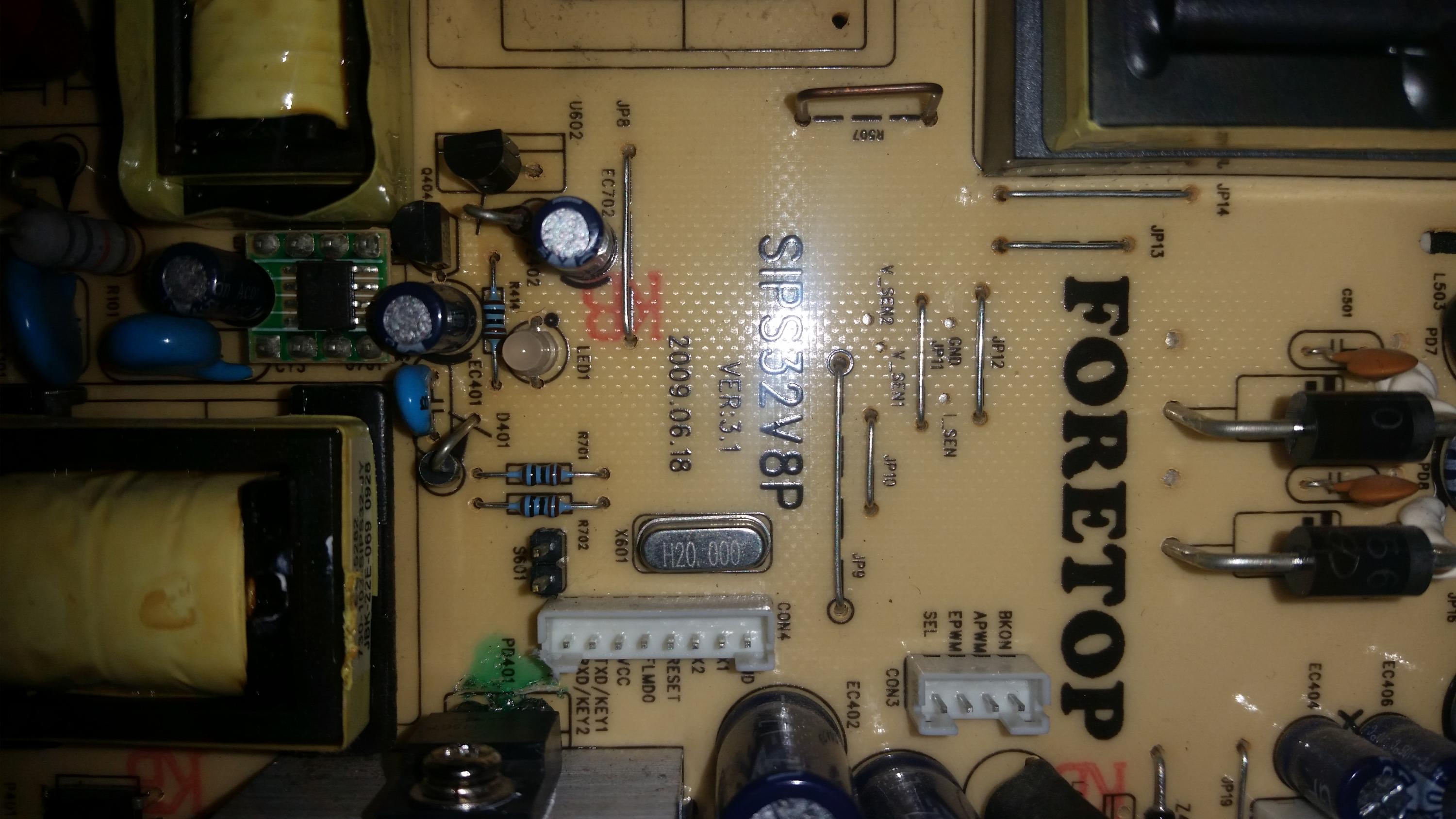

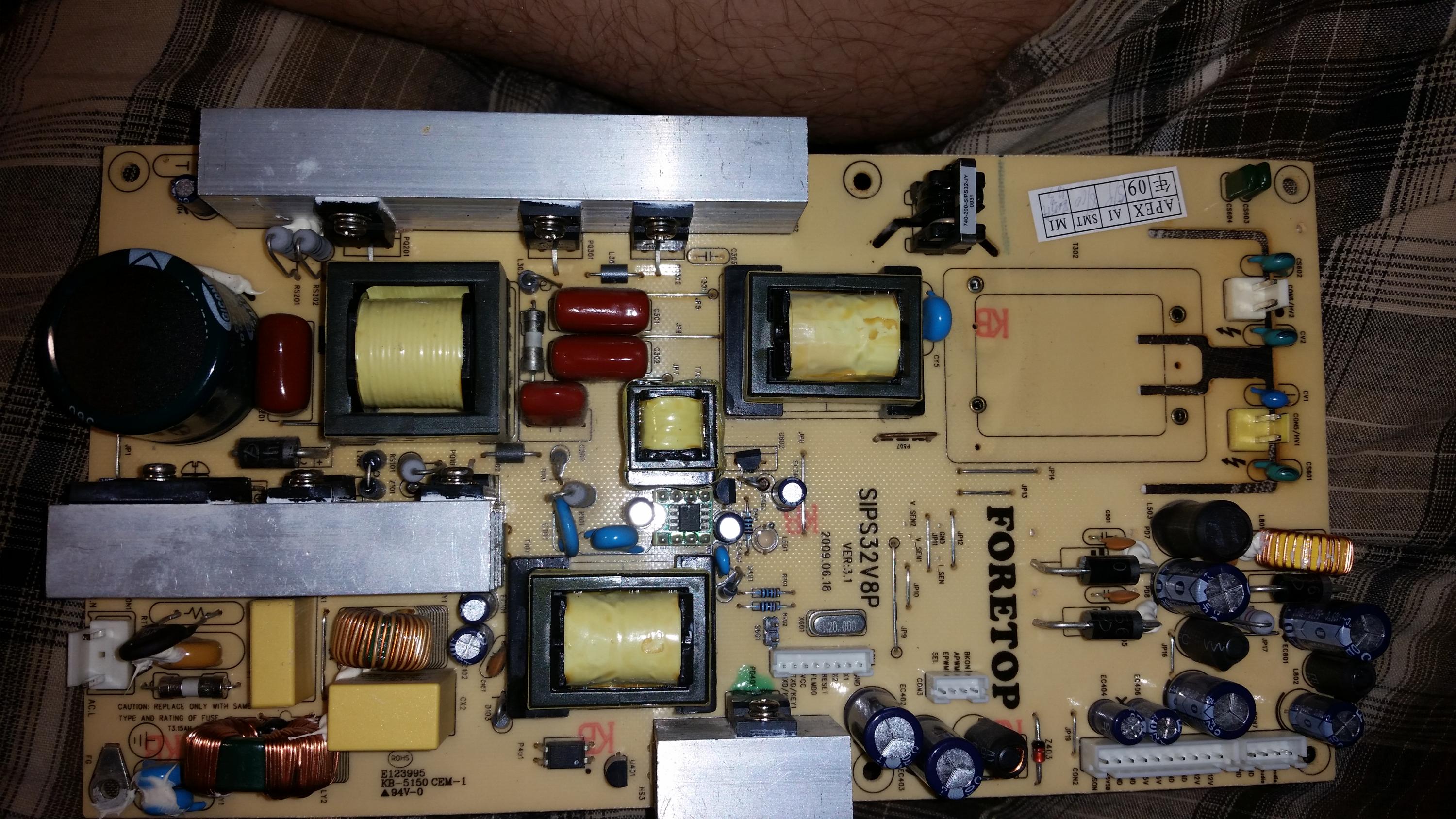

                  I have version 3.1, im also posting a closeup of the area where the original damage occured, notice the discolored connector, and the 2 newer blue ceramic capacitors. I did verify that the replacement was the exact same part before replacing, both were stamped 15j 6kv, if im correct that means 6000v 15 picofarads.
                    Re: Element 32le30q
                    That is correct, 15pF 6000V.

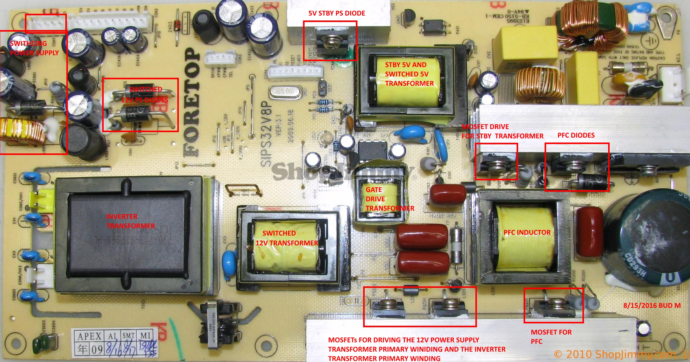

                      Re: Element 32le30q
                      How do i identify this transformer, if that's what it is, i tried looking this part # up online and, i can't find anything relevant.

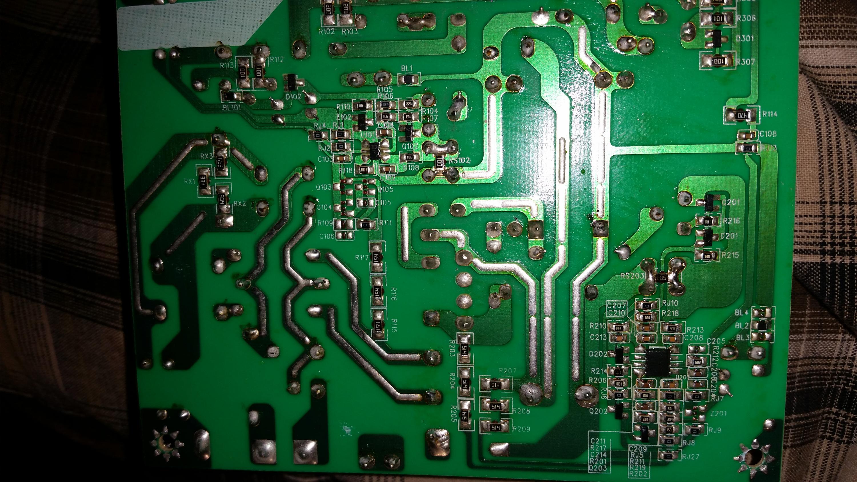

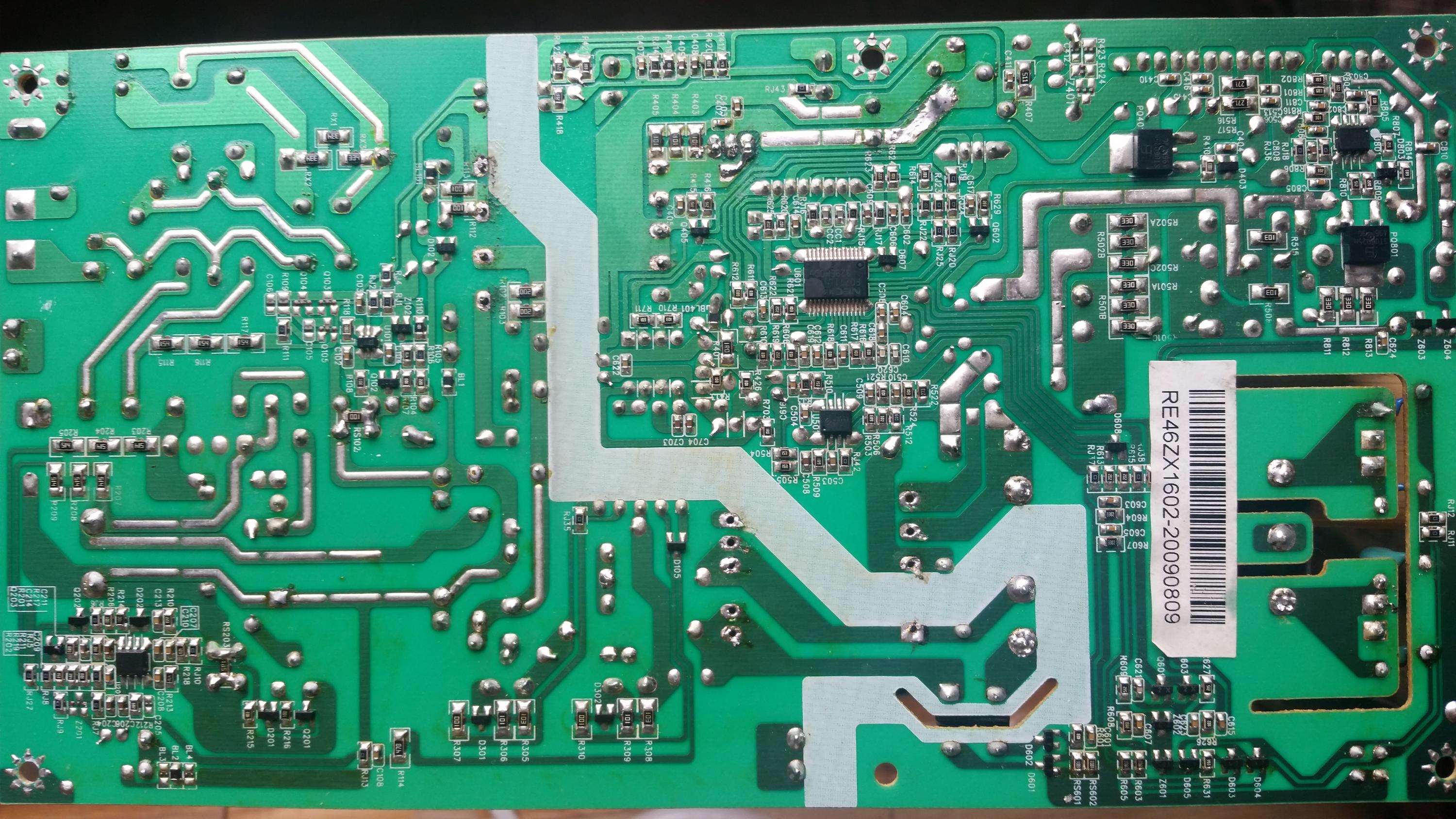

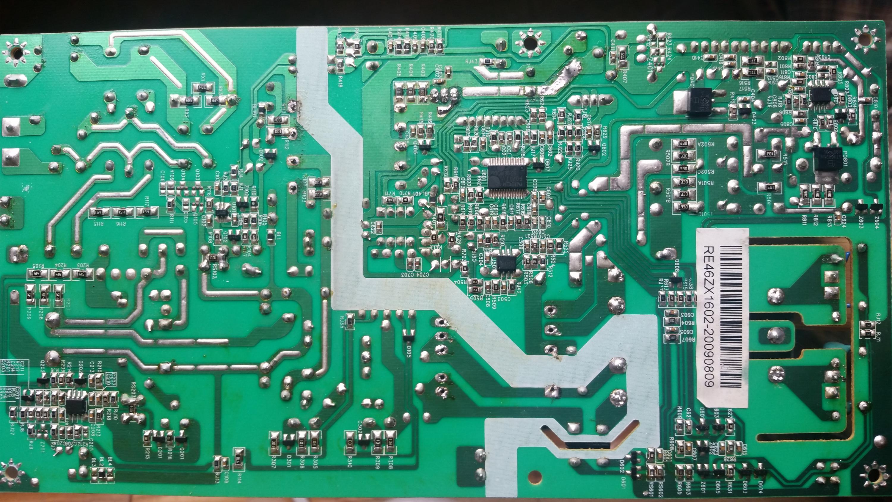

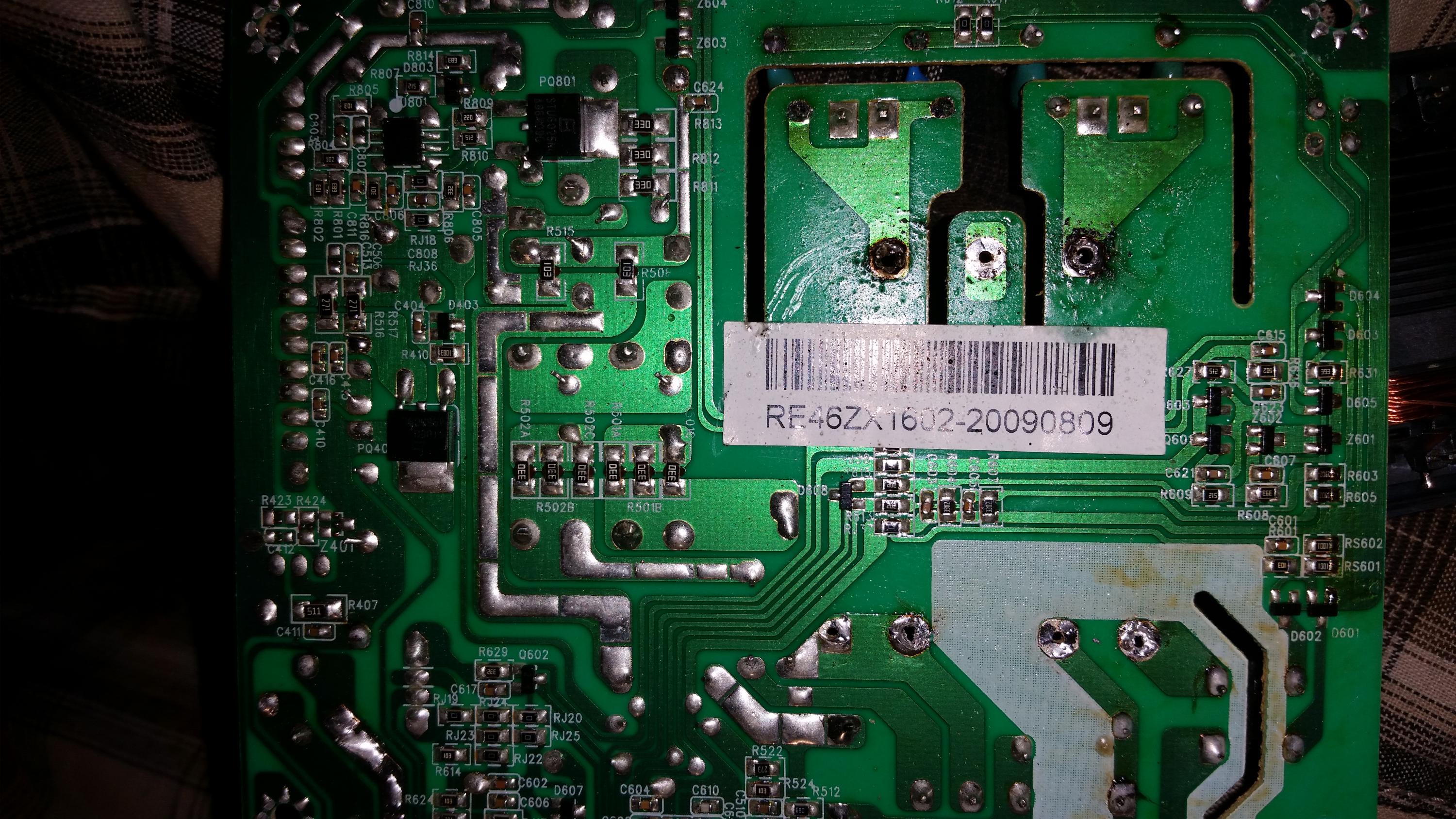

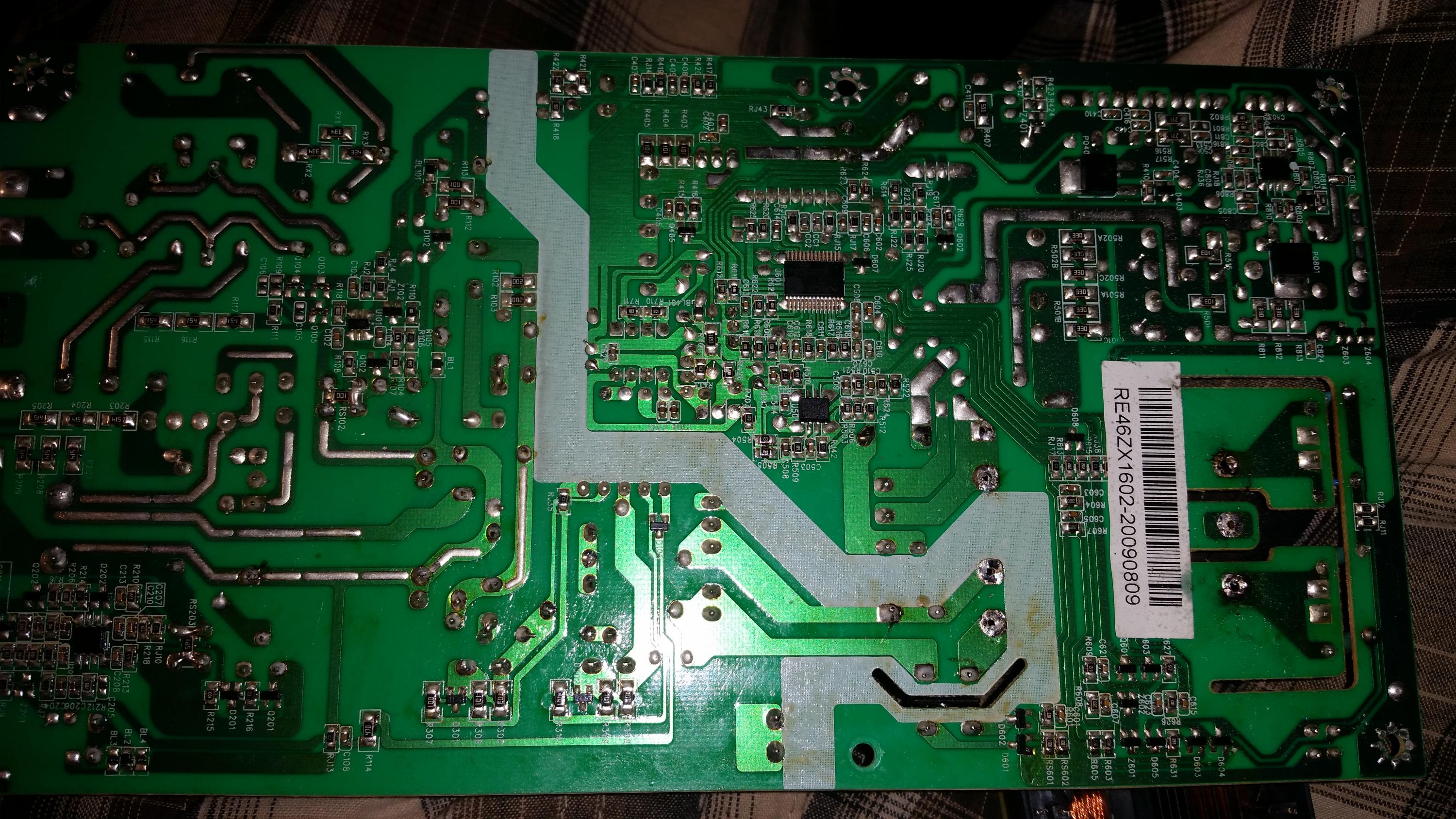

                            Can I get a straight shot pictures of the bottom side of the board?
                            This one is cutout and dark on the edge.
                            https://www.badcaps.net/forum/attach...3&d=1471213443
                              Re: Element 32le30q
                              Bottom side pics
                                Re: Element 32le30q

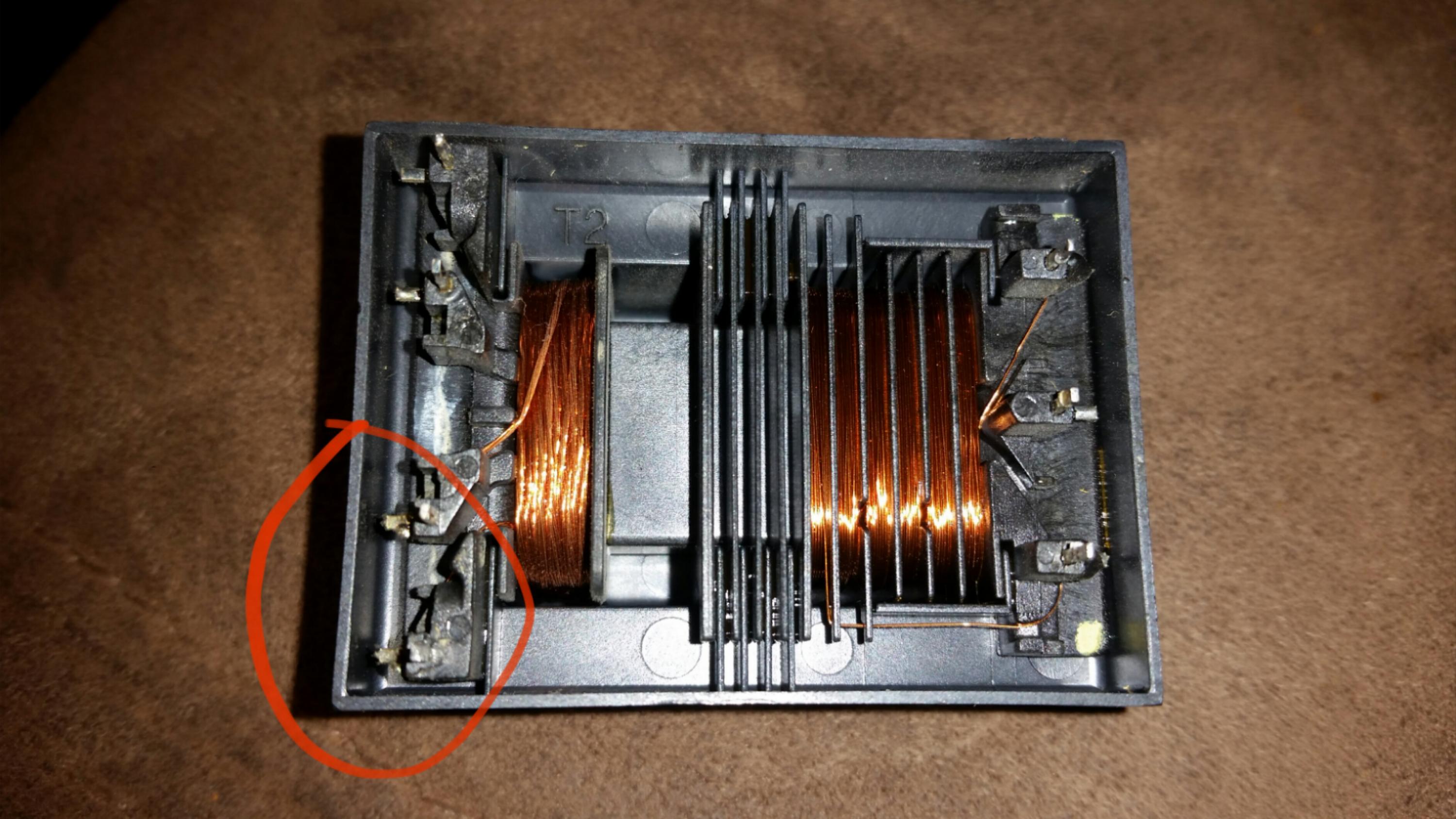

                                Hmm, the pictures were taken before the Inverter transformer (T302) is removed?
                                I also see that you unsolder the Standby power transformer pins.

                                  This is what I have so far.
                                  Picture provided by shopjimmy.
