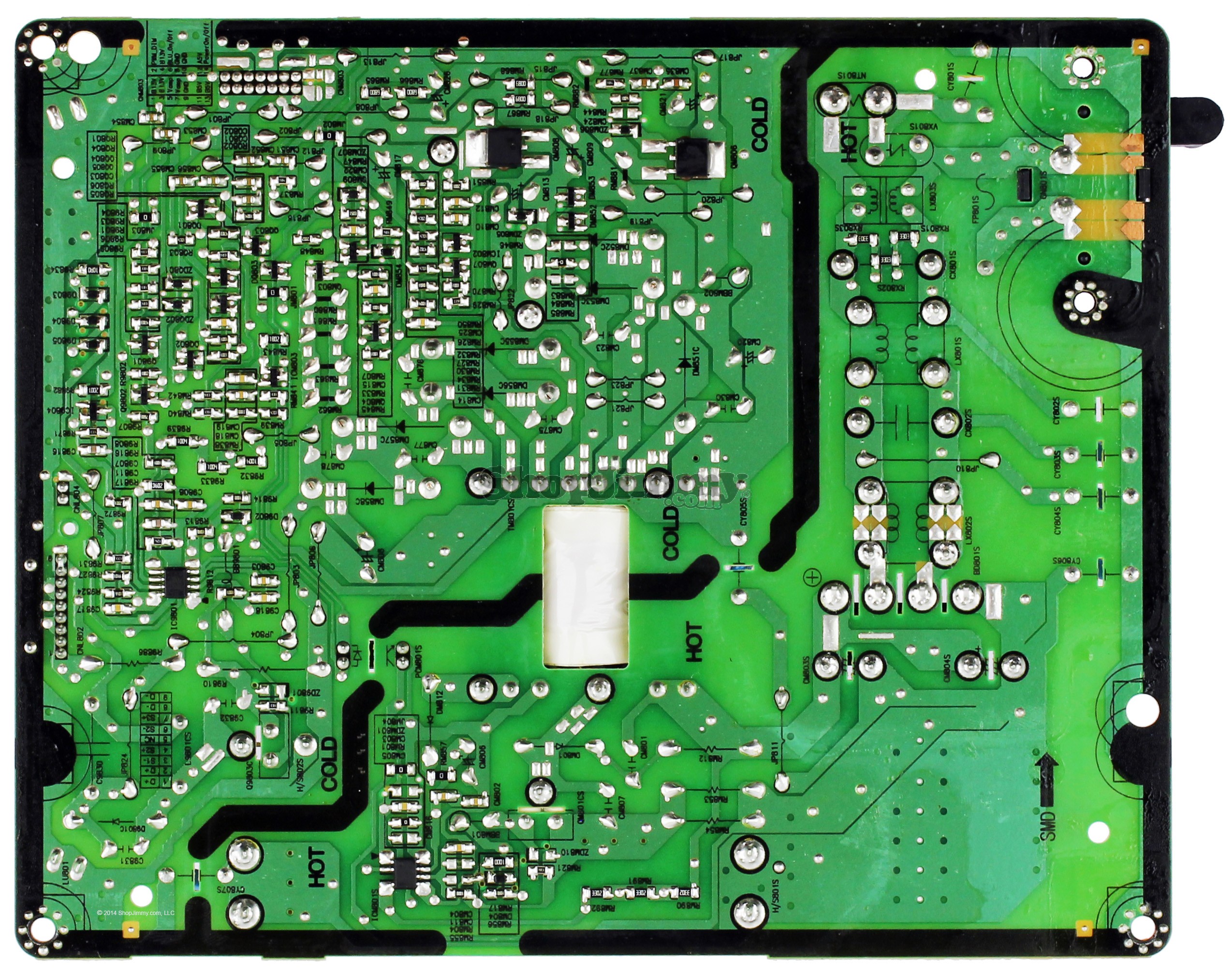

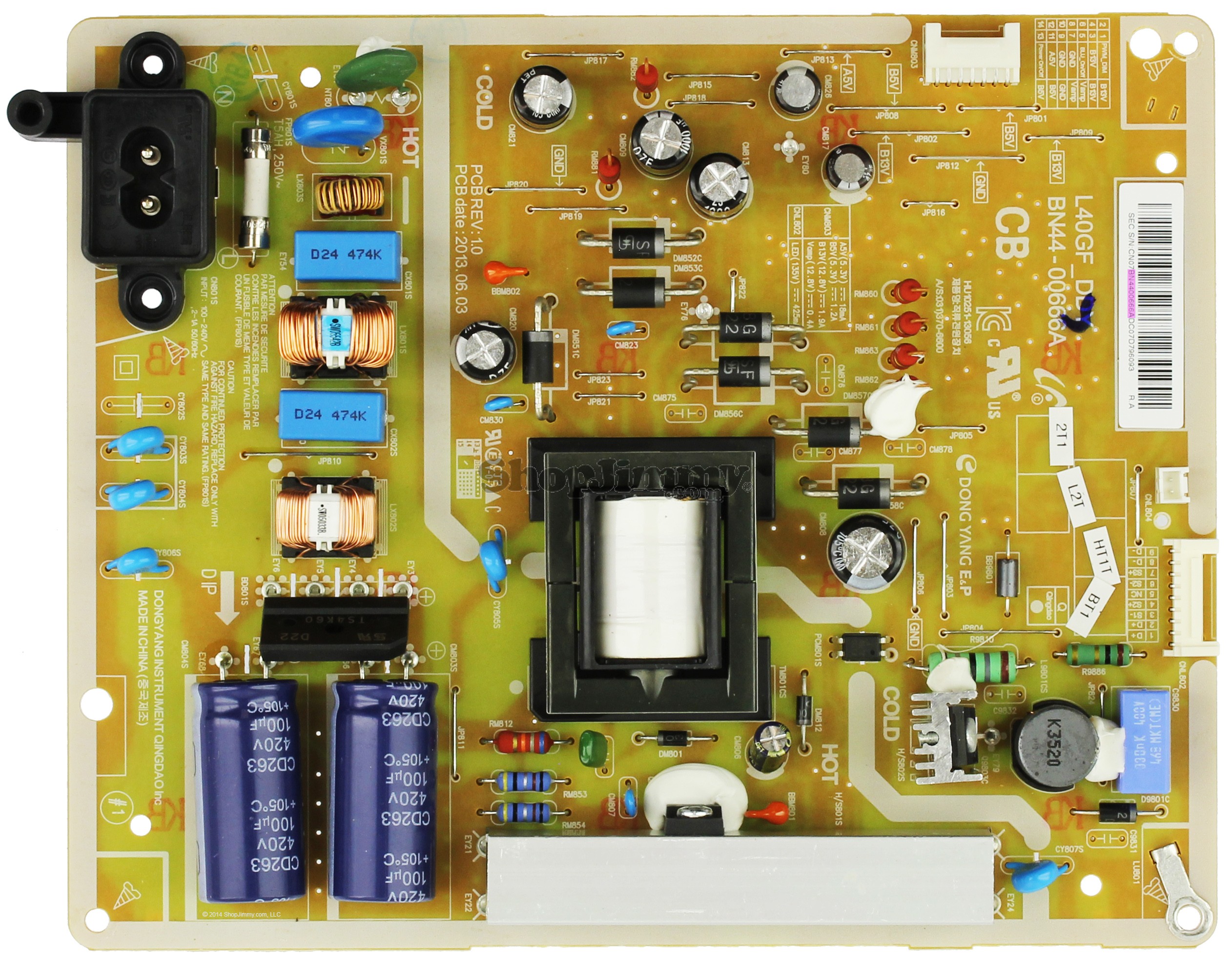

        D+ (there are two of them, you can check either one of them) is the label on the LED connector CNL802.
        You will have black probe on the chassis, red probe on the D+ then turn on the TV and see if the Voltage rise up higher then 210VDC and then come back down after 3~4 seconds, record those readings.
        Samsung BN44-00496B?
        or
        Samsung BN44-00666A?

            Samsung BN44-00666A is the model of the power board. In terms of the reading, I seemd to be getting a rather continous reading of around 205-210V. I can try retesting it but that was about what i'd get.

              You have open circuit in the LED string. If you look at the Voltage chart on the board, you will see 135 VDC for the LED supply Voltage when it is loaded with working LED string.
              Pictures provided by shopjimmy.
