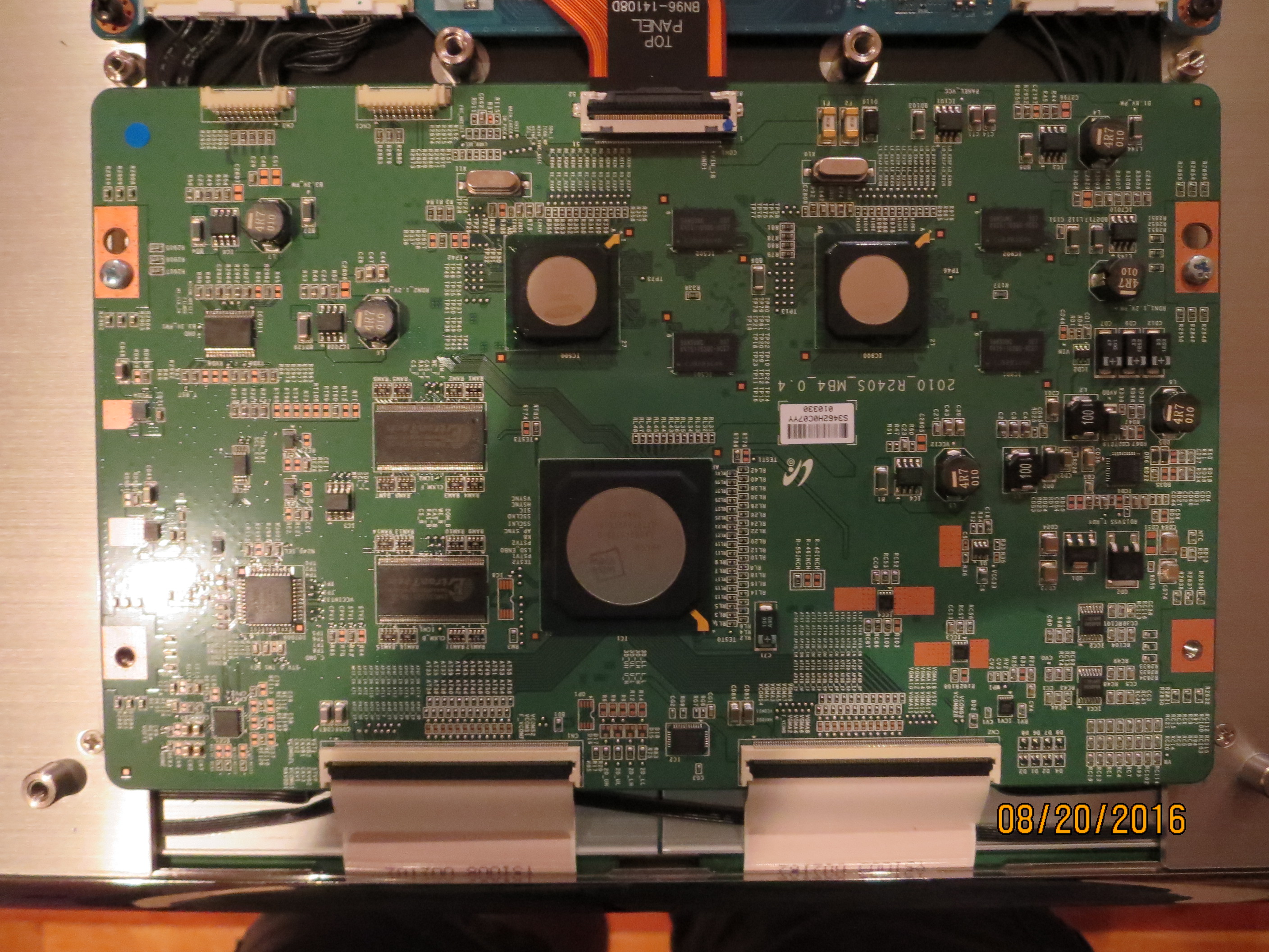

          took base unit apart - blown main fuse. replaced it, blows when 110V applied. disconnected base from display screen - base unit turns on with new fuse. connect display screen, main fuse blows. bad display screen ??
          t-con board is located on back on display screen along with IR board & 3D board
          will take apart display screen to get shot of TCON bd

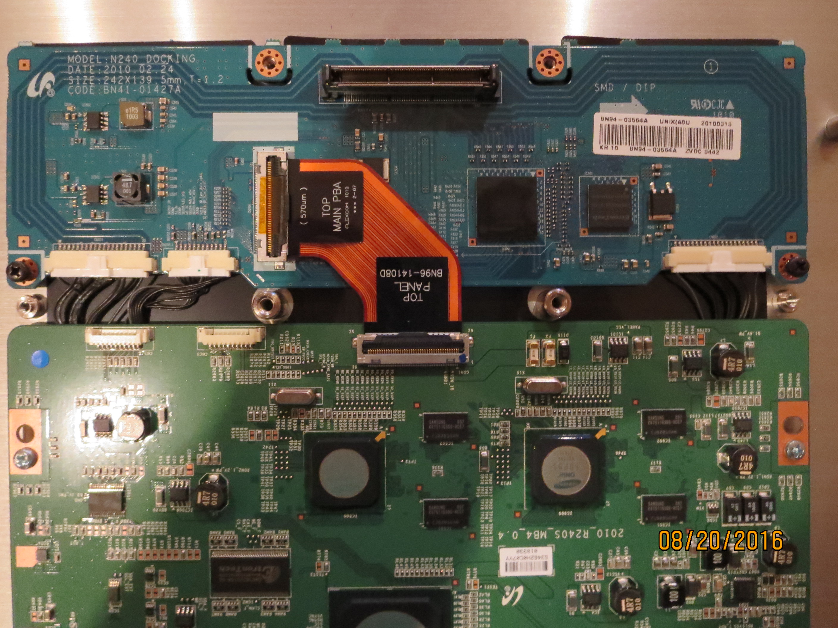

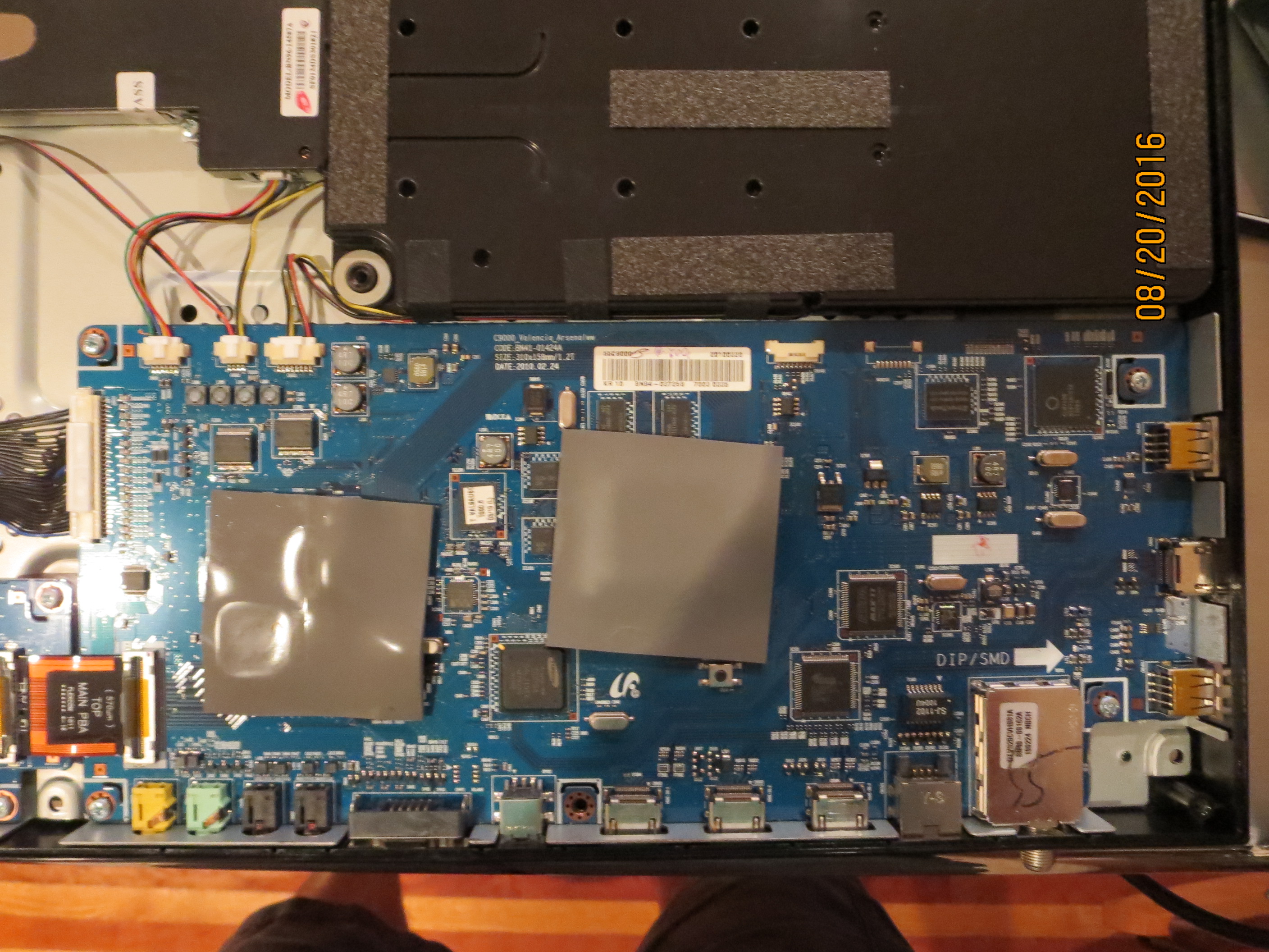

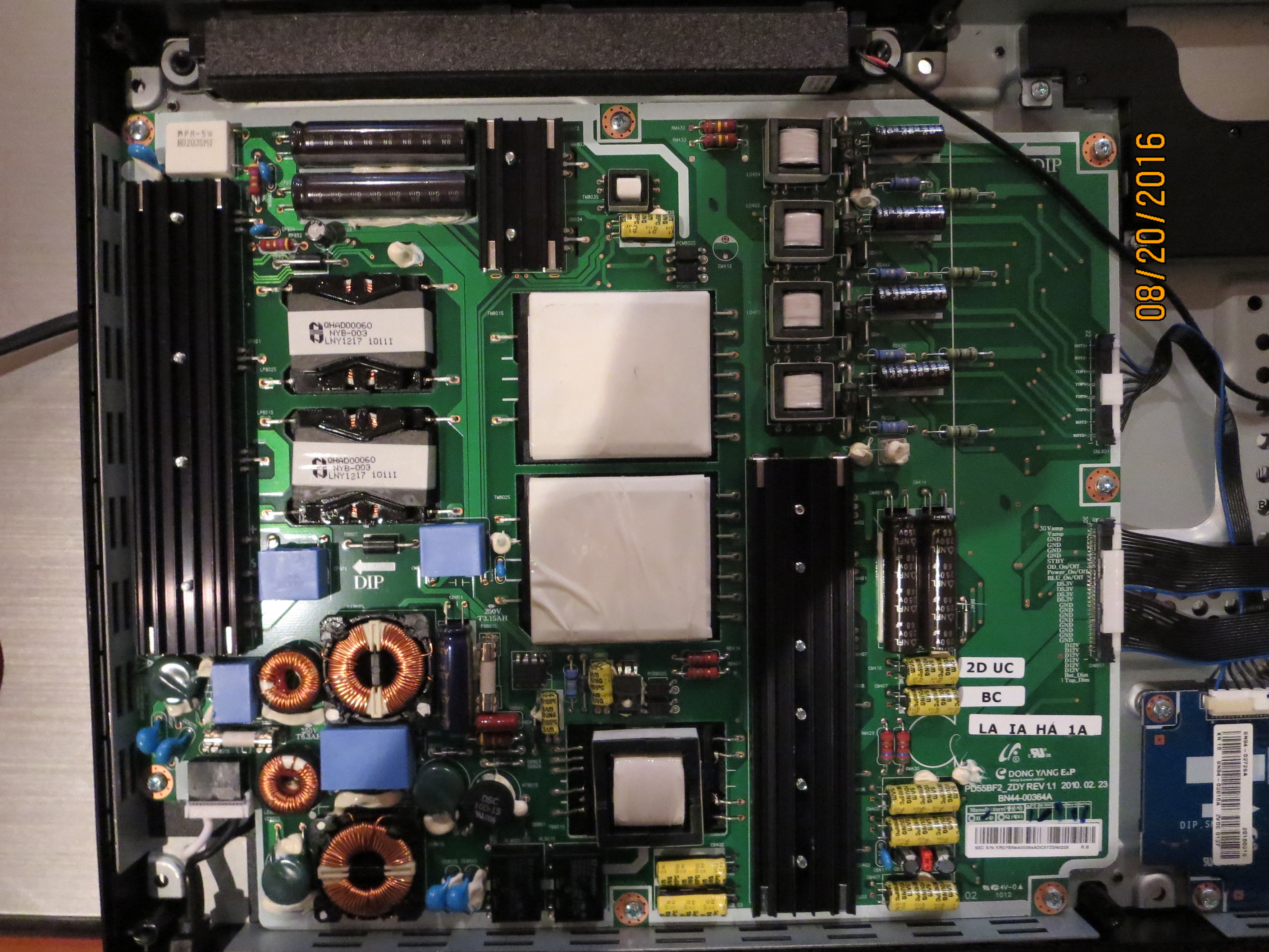

                Re: Samsung UN55C9000 dead
                pics of base boards (1-3) pic 1 is power supply, pic 3 is main BD
                pics of display screen boards (4-5)
                pic 4 is T CON BD - 5 is docking BD

                • CapLeaker
                  Leaking Member
                  • Dec 2014
                  • 8190
                  Can you explain that any better what happened?
                  "took base unit apart - blown main fuse. replaced it, blows when 110V applied."
                  This sounds like something is wrong in the primary circuit of the power supply.
                  "disconnected base from display screen - base unit turns on with new fuse."
                  Contradicts the first sentence, because I thought the fuse in the primary just blows as soon as you plug it in.
                  We really need to clearly eliminate one thing after the other. That's why I asked specific questions on my post #3.
                  For now, I just want you to disconnect the main board from the PSU, leave the backlights connected, jump PSon to STBY and plug the set in.
                  The power supply should turn on and the backlights should light up. If all this is good, measure each pin (look post #3) on that connector and post it with the corresponding pin out name.
