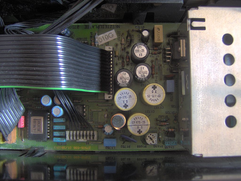

    I was cleaning from dust my trusty VHS recorder, a 4 head Grundig VS620 class 1987, when I spot three bulged caps in the vrm board:
    The bulging ones are Frako EPS 220 uF 25 V, black jacket with gray stripes: Frako is a German brand still present today, but I can't find any datasheet in its site nor any reference to EP and EPS series.
    The vcr works fine, I could ask a friend to simply replace the caps but I can't find a good substitute without knowing thier specs: any idea?

    Re: Frako caps in Grundig VS620 vcr
    Nice of you to care about classic old stuff.
    Those are exactly what fails on the machine.
    Just meet or exceed the voltage and meet or exceed the capacitance, and use the best quality available to you. nothing critical about those power supply caps.
      Thanks Arneson, I'll check for reputable and heavy-duty GP caps since these Frako don't seems low-esr ones: maybe Nichicon KMG or something like that if I can find them.
