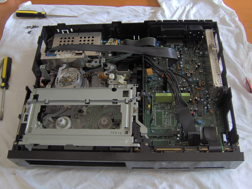

    could you provide few pix of that mechanism?
    Sorry, the site was unreacheable yesterday and I downloaded the pdf only now.
    Tomorrow I'm going to shoot some photos: do you need any details?
      if you feel like it you can take the bottom lid of and do some pix from there.
      if it's easy to do.
      if it has many screws, don't bother.
      oh yeah, make the pic of the whole machien without the upper lid: we only saw the zoomed detail of where the frako caps are.

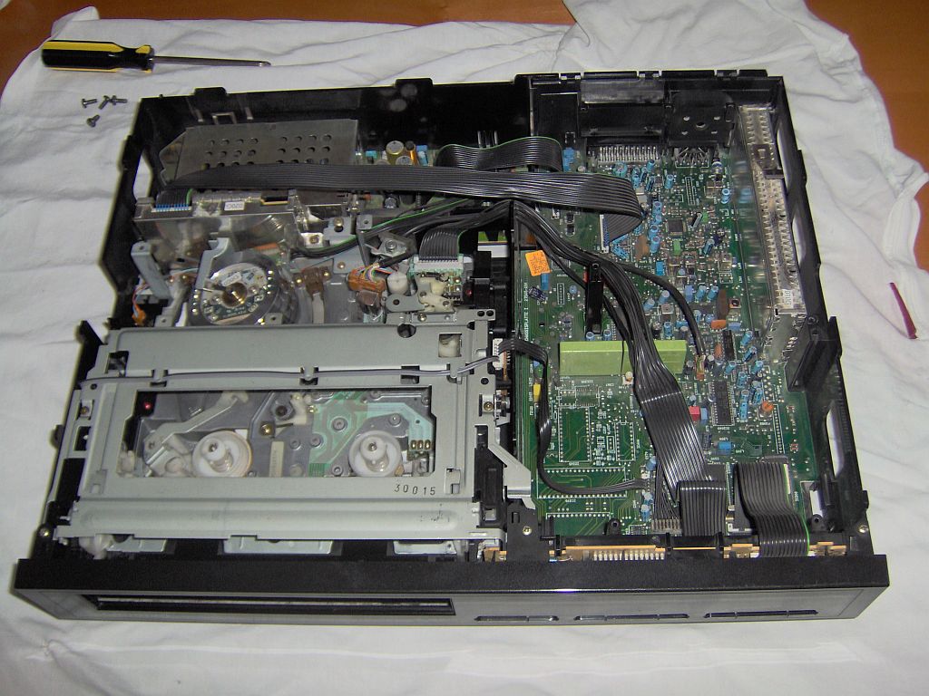

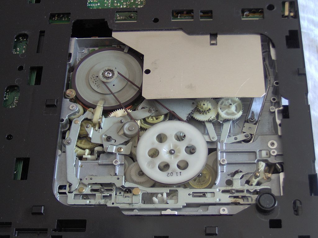

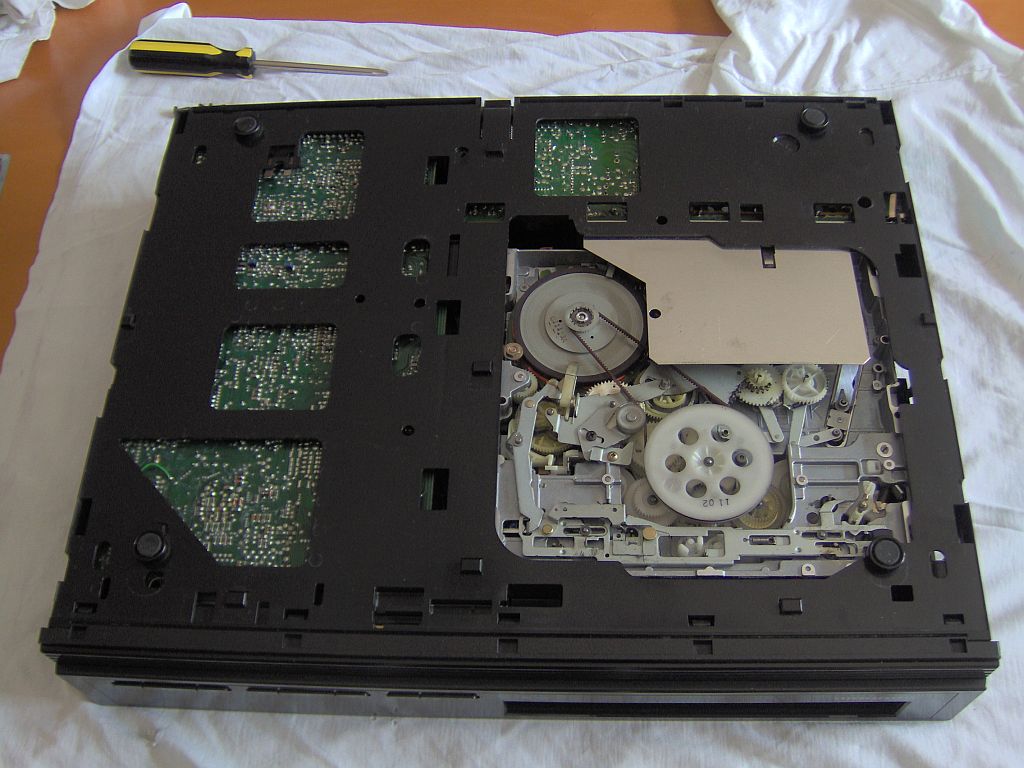

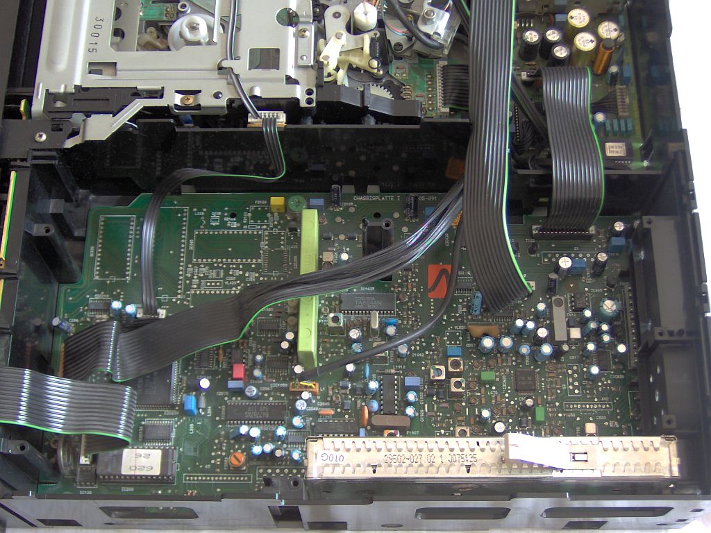

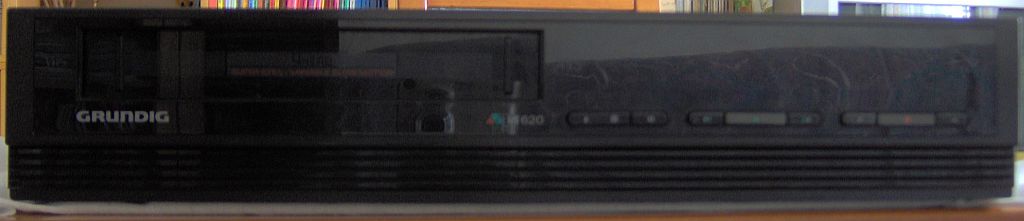

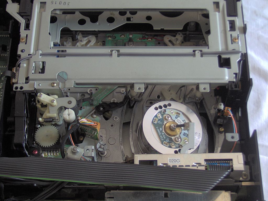

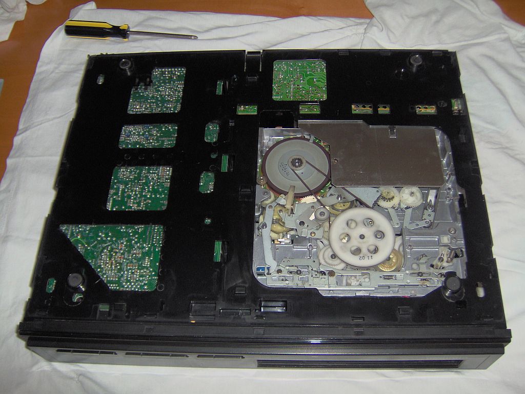

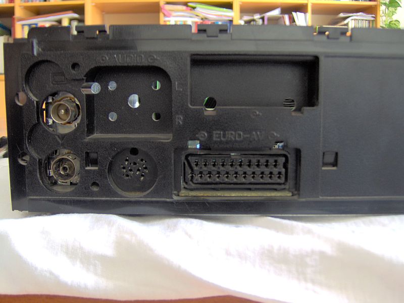

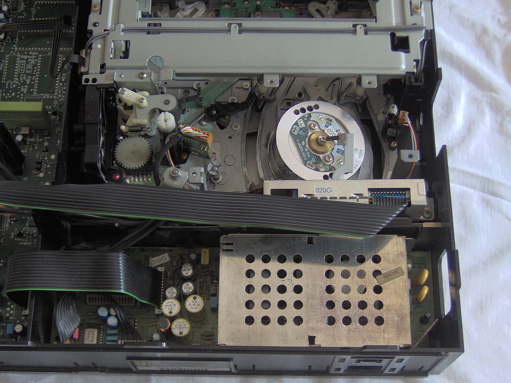

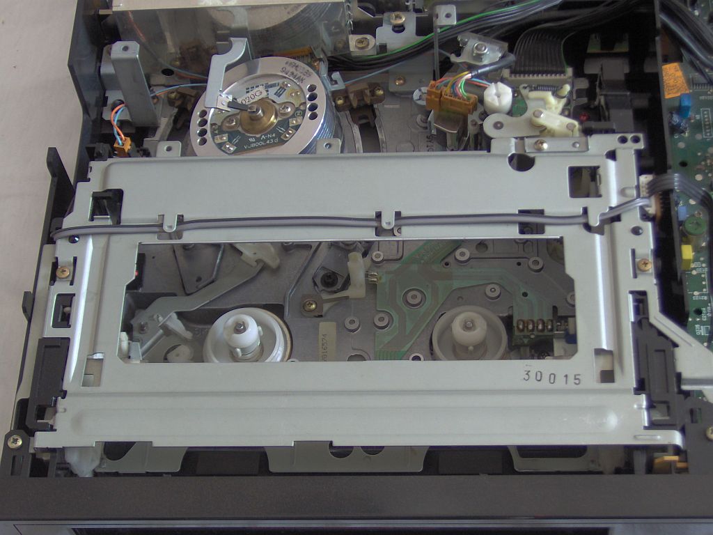

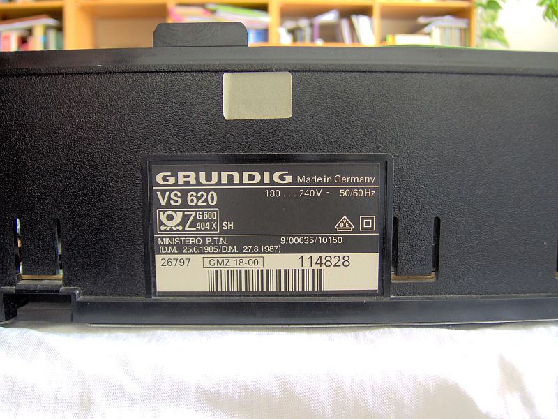

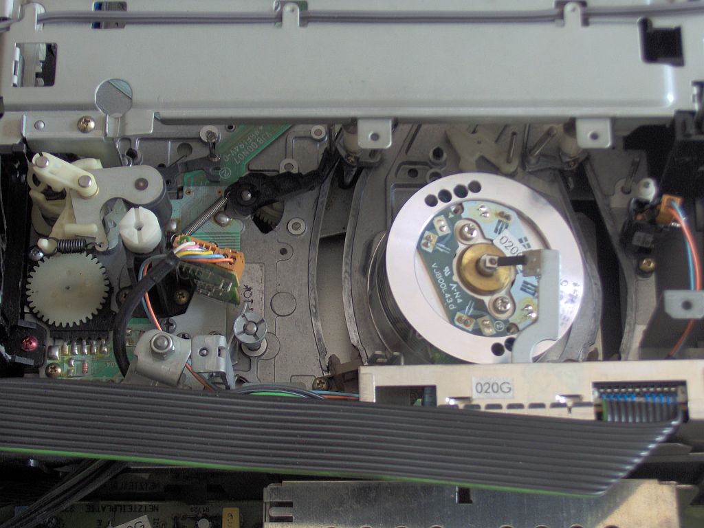

        Done Now there is a long sequence of photos:
        1) Front:
        2) Internals with and without flash:
        3) Board: caps with light blue jackets are Rubycons, black ones are unknown (according to vents, maybe Elnas). There are two jacketless Philips caps, but I don't think they're polys.
        4) Cassette holder:
        5) Heads: overview and closeups.
        6) Bottom: only 4 screws keep up and bottom lids together; once removed them, the bottom one is kept in place by plastic handles. Surprisingly, it was less dirty than I had expected to be.
        Both flash and flashless pictures; the only interesting part is gear detail.
        7) Connectors: the back has connectors on the left side and the power plug on the right one. The manual calls Universal connector the round 9 pin connector between the RF output and the Scart plug and, according to the manual, it connects a Sat decoder to the VCR: I found no reference online and I wonder which signals does it carry (RF, composite, S-Video, RGB?) and if it works one-way (decoder -> VCR) or both-ways.
        I know there is the old Commodore 64's 8 pin Din connector which carries S-Video, but shape and pin position are different; being 9 pin, I had even suspected it could be a serial port of some kind.
        8) Model plate

          i don't see any of those pix....
          you didn't have to bother with details about pix; i'll figure it out all right...
            I lost two hours: uploads gone mad give me excess acid
            I reupload all again ...
            1)
            2)
            3)
            4)
            5)
            6)
            7)
            8)
            I hope it's all ok now, otherwise I'd upload everything on Imageshack or similar services.

              definitely panasonic machanism.
              has a lot of resemblance to my old panasonic nv-sd200, i bought that one in 1995, lasted about 8 years.
              that one has much more plastic than this one, though.
              i made few pix of panasonic while adjusting it, will make picasa online album soon...
              in meantime here's that mechanism from another source
              http://www.leifline.com/reptips/imag...ekanik_Top.JPG
              http://www.leifline.com/reptips/imag...nik_Bottom.JPG

                NV-SD200 series uses the Pana23 platform according to Hinkel's: maybe Pana2x gears are cheaper and more fragile than older ones.

                  and when it comes to grundig, broad(not the one i got lg from this one's older) broke it as soon as i return the vcr to her!
                  seems she was a bit rough when inserting the tape so she broke one gear teeth, and loading motor was spinning on empty(this gear connects loading motor and main gear and eject mechanism...i'll make pix when replacememnt part arrives, ie when i'll be putting it back together).
                  (which reminded me of ebay vcr i mentioned and scenic tried to get owner to sell(earlier in this thread)...it's probably simillar error, as this one was pretty loud too when it started...)
                  found a part
                  http://www.nedis.com/Articles/Philips/310.10657.php
                  ordered it, so we'll see how that goes...broken teeth is on the worm shaft.
