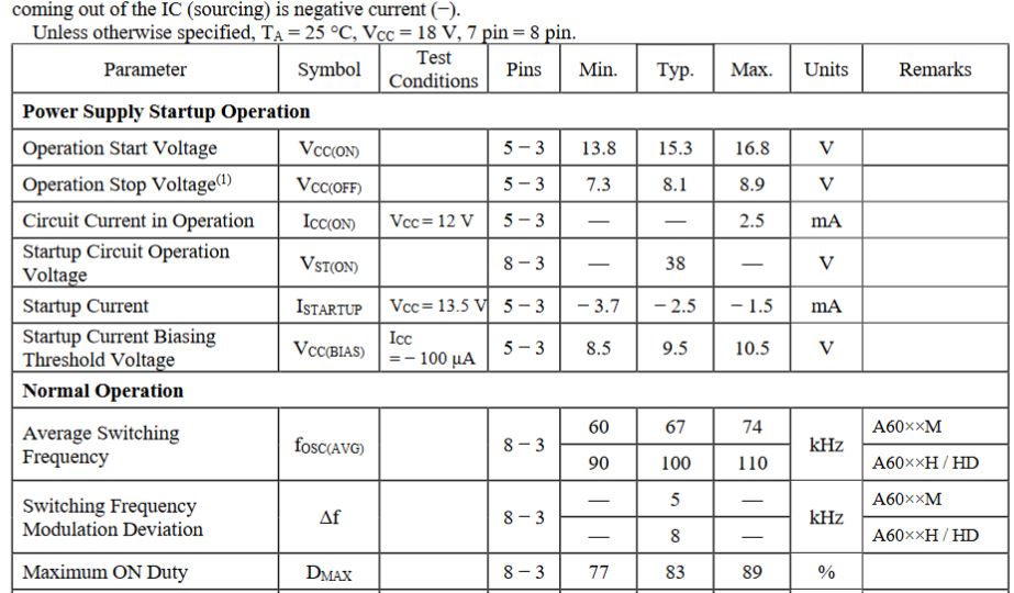

    Where should the voltage come from on the 5th leg A6069H?

              • dskall
                • Oct 2016
                • 2905
                • usa
                #47
                Re: Sharp LC-60SQ15U TV DPS-167CP - No power
                Use data sheet. Pin 7,8 are the startup voltage

                        Hello, please help me i have same problem on my Sharp Aquos 60LC635E No 5V power, tv dead . Blown R7900 and short D7950 . I changed it, than blown R7900 again . D7950 ok. I change IC7903 and cap on 5 leg 50V 47u and R7900 never blown again but 5V not( I do not know what to do . On big two cap 315V, on 5 leg IC7903 9V this very low for start A6069H . Datasheet say min 13V.
                        Please Help me. board power supply dps-162KP B RUNTKA932WJQZ
                        The voltage isn't high enough, just like you said here, the question is why, I can't figure it out but one of the pros knows I bet.

                          #52
                          9.1 Startup Operation
                          Figure 9-1 shows the circuit around IC. Figure 9-2
                          shows the start up operation.
                          The IC incorporates the startup circuit. The circuit is
                          connected to D/ST pin. When D/ST pin voltage reaches
                          to Startup Circuit Operation Voltage VST(ON) = 38 V, the
                          startup circuit starts operation.
                          During the startup process, the constant current,
                          ISTARTUP = − 2.5 mA, charges C2 at VCC pin. When
                          VCC pin voltage increases to VCC(ON) = 15.3 V, the
                          control circuit starts operation

                            #53
                            between 3rd and 8th leg 300V

                              #54
                              CAP c2 (C7907) i change but nothing changed

                                #55
                                Check pin 5 diode, resistor and cap.
                                • romasik
                                  • May 2022
                                  • 56
                                  • Ukraine
                                  #56
                                  i check, all ok
                                  • dskall
                                    • Oct 2016
                                    • 2905
                                    • usa
                                    #57
                                    If all components off of pin5 are good. May have bad ic.
                                    • romasik
                                      • May 2022
                                      • 56
                                      • Ukraine
                                      #58
                                      So I replaced it with a new one.

                                        #59
                                        What is the voltage on pin 4 of ic7903, this is the FB (feedback) voltage.
                                        Is R7907 ok?
                                        IC7801 will not effect ic7903. IC7801 is the pfc driver ic. and is not active in standby

                                          #60
                                          Is R7907 ok?
                                          7907 check his ok, on 4 legs 40mV
