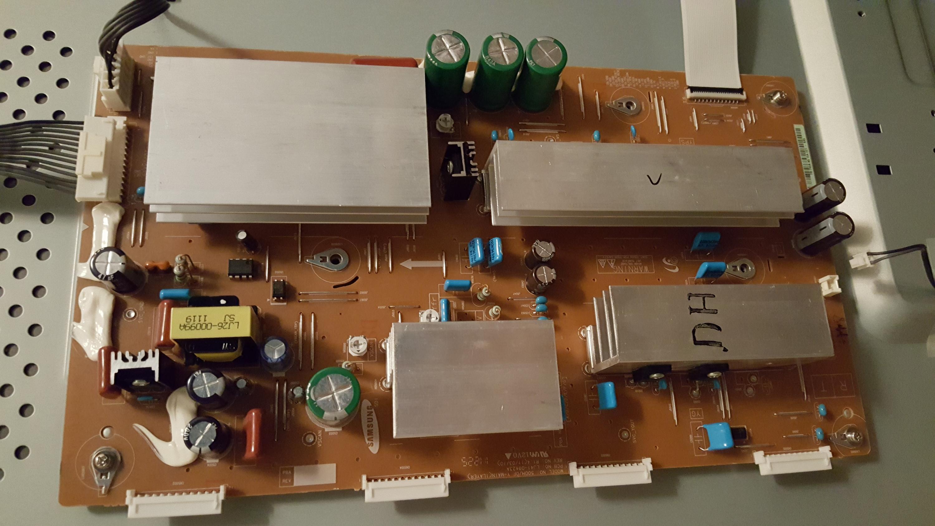

    This is a replacement Y-Main board I just got in the mail. Looks like all caps were replaced and no sign of a bulge in the slightest.
    What should I do next to further isolate issue? Thanks in advance!

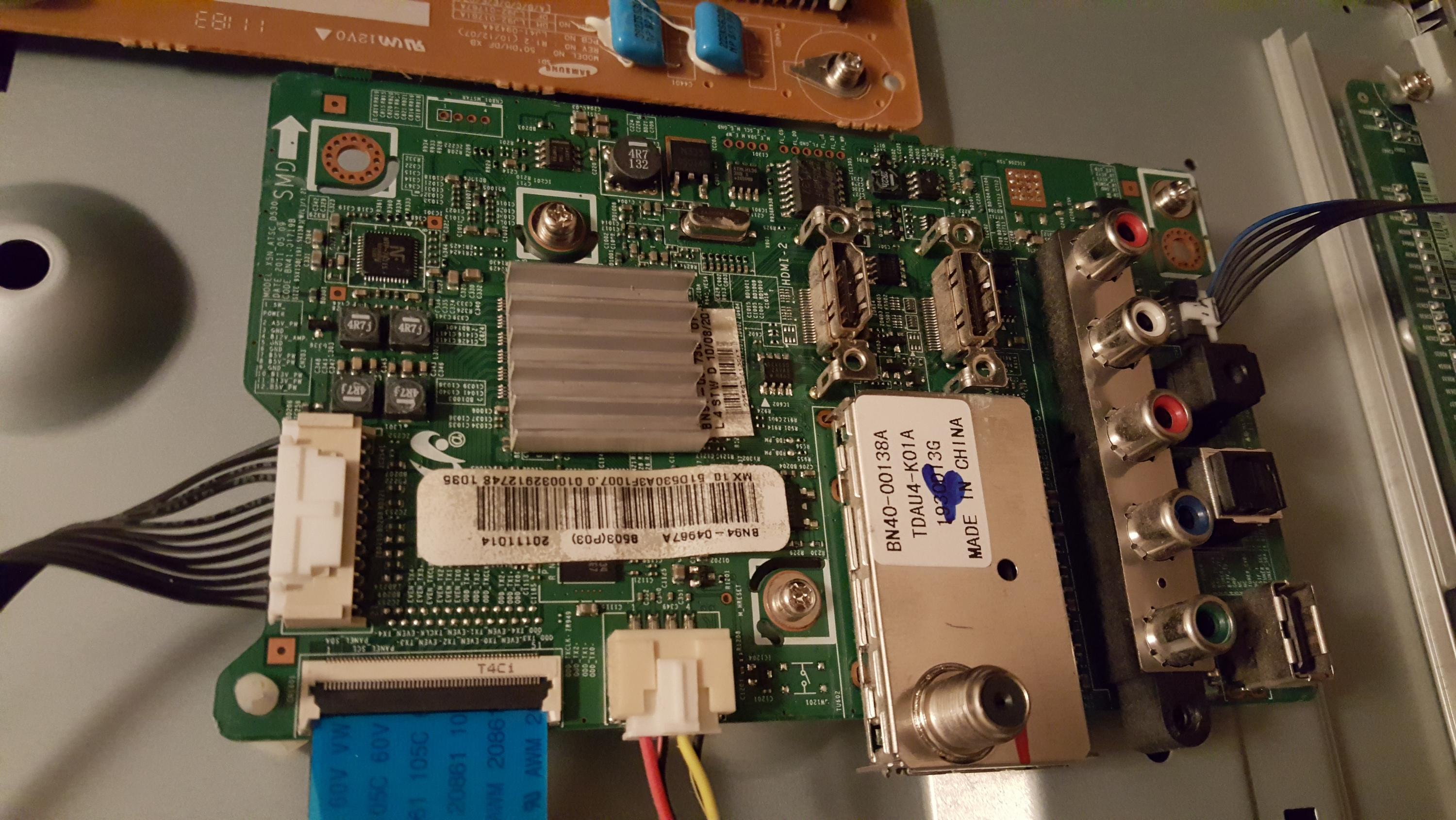

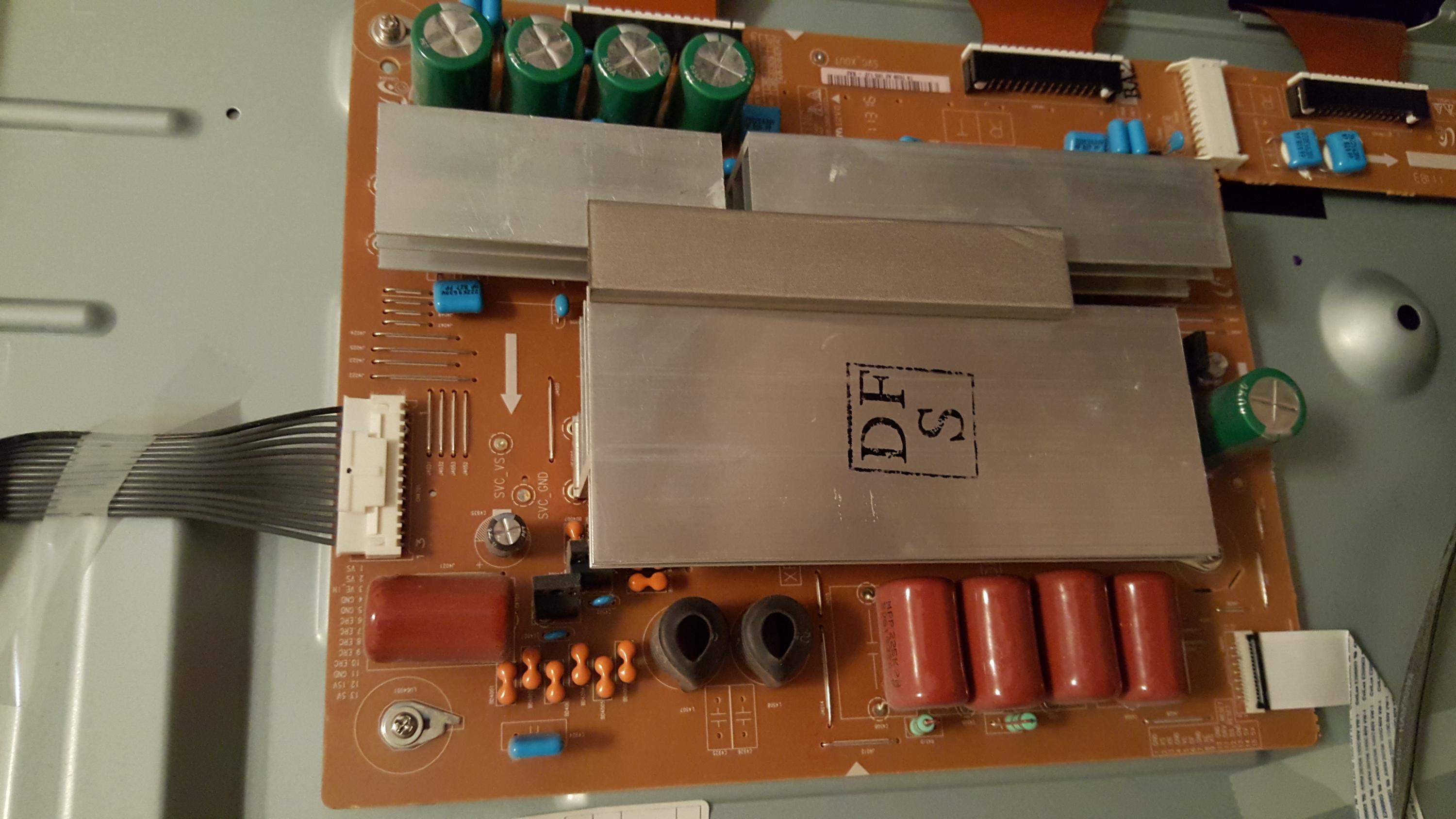

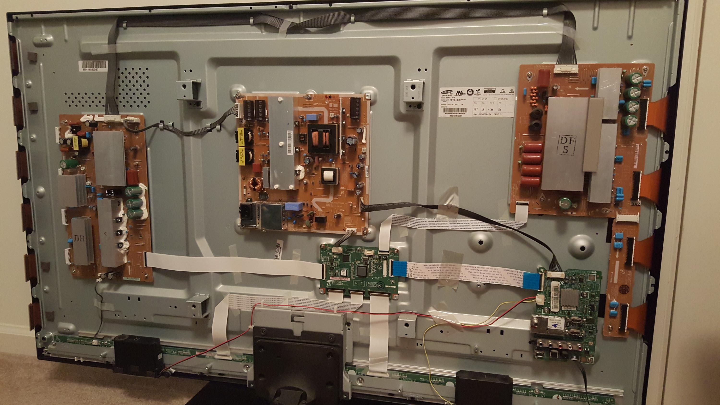

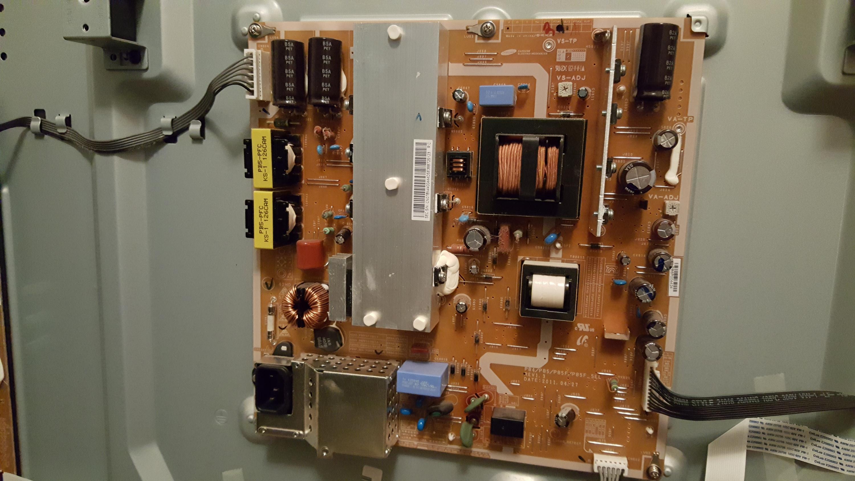

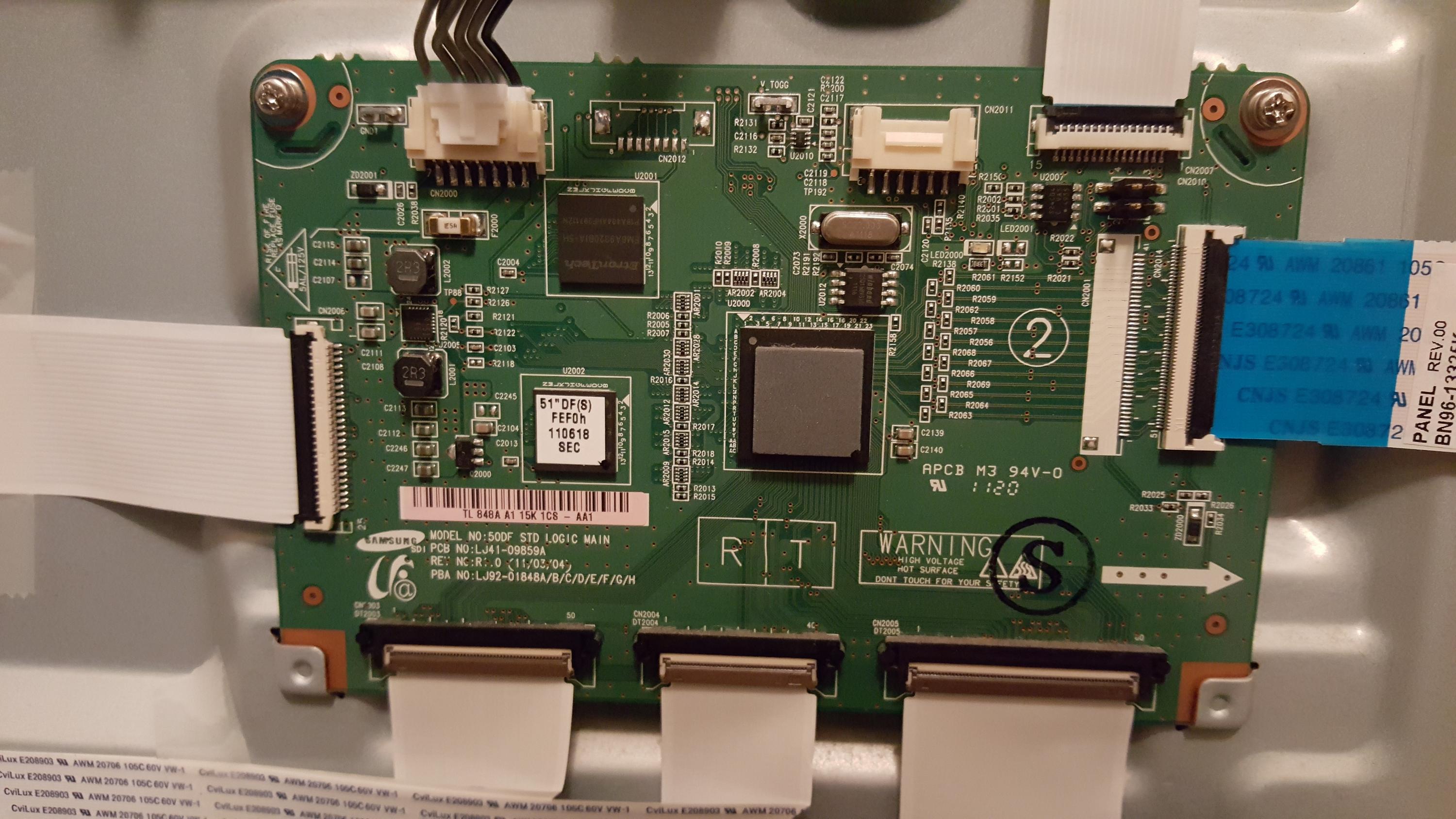

        Ok, sorry for not uploading pictures in the first post, but here are pictures of the TV's boards.
        From the left: Overall board layout, (Excluding the Y-Buffer which is out for testing.) - The Main Power Board - The Y-Sus Board - The Logic Board - The X-Main Board - The Main Board.

          You don't really need a capacitor tester to be honest. It's always useful of course but on these boards either the IGBT's or diodes fail or the panel/mainboard fails. Same for other tv's. The older lcd tv's have problems with capacitors , if they are not bulging they most of the time are fine.

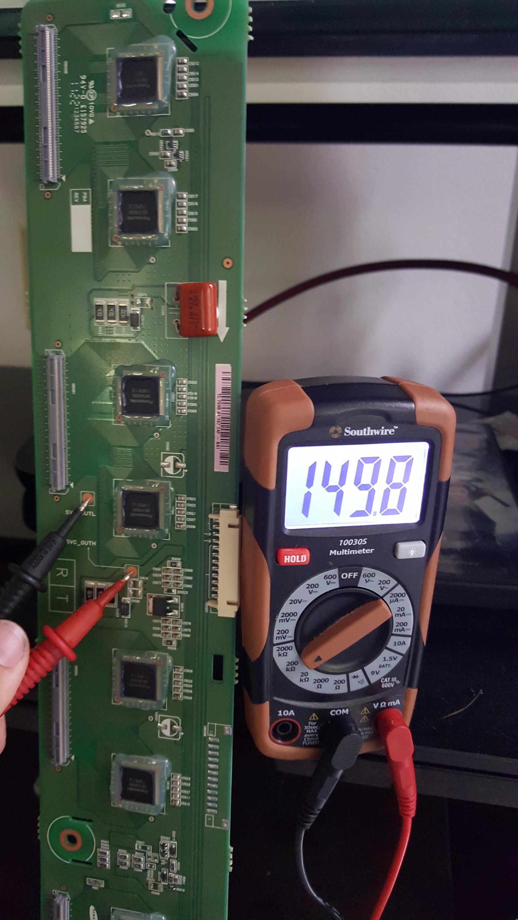

            Also, on a side note, I tested the two Y-Buffer boards I have, I believe both might be good and not shorted. Upon throwing 200k Ohmns at the test points, I read 150K ohmns on both.
            I still am suspecting a fault with the Y-Sus board. Going to return the replacement to the seller and try a different vender.

                Ok, so I went back to test the Y-Sus board and started with the main power board instead. I actually noticed something I don't think I realized before, the VA test point reads the correct value of 57V on the sticker, but when I go to test the VS point, it will read around 199V for a second and go back to reading just the starting value of 1. The sticker says VS is 207V. This is with the power connector to the Y-Sus board disconnected. As expected, when I test the two VS pins going to the Y-Sus board, I get the same reading. Something shorting out the VS line on main power board?
