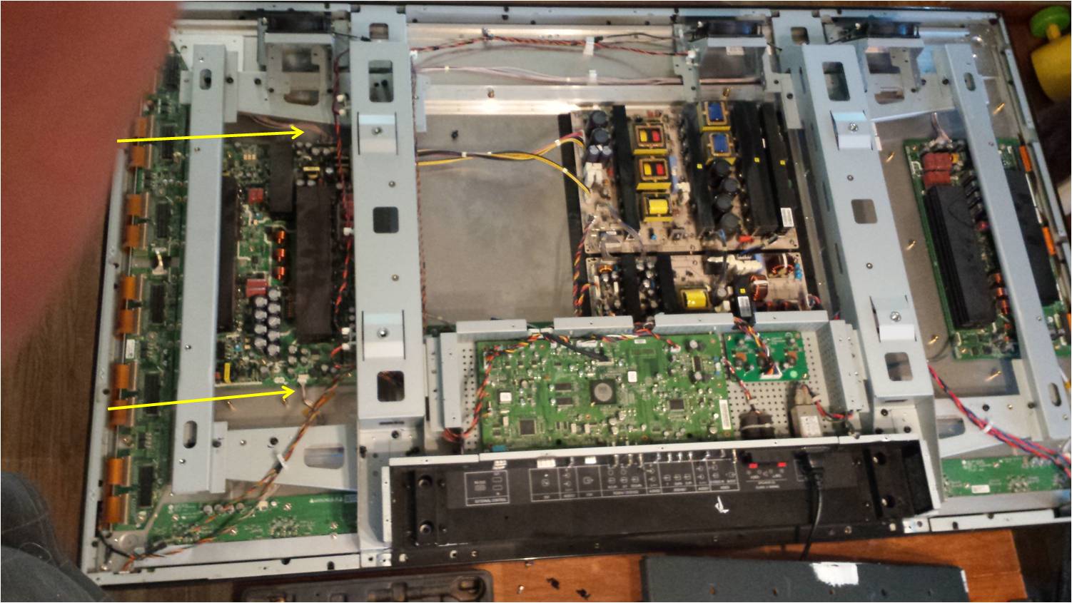

    Please excuse my amateur noobiness here. I have the aforementioned plasma screen. It won't turn on when cold. If it's warm it will turn on and off fine and stay on. When I try to turn it on the power supply clicks and I also here a click in the main board then the red LED comes back on. The second click seems to be a circuit protection shutting the unit back off due to a fault. If I unplug the four wire harness from the power supply, which seems to be the main power out to the Ysus, the Green LED illuminates and stays lit. I've also found that if I leave that plugged in and unplug BOTH the small wire harness plug from the Ysus to the XRLBT board AND the wire harness plug from the Ysus to the Zsus, the Green LED will illuminate and stay on.
    Any ideas or steps to take to further troubleshoot? I do have a DVOM.
    Thanks in advance for the help. I have attached a picture of the back of my screen if it helps. The arrows are the two plugs that I unplug to get the Green LED to stay on.

      That 1st 'click' makes me think the Pwr Bd is OK and the 2nd 'click' suggests to me a problem in the Y-SUS Bd.

        Before I replace it I'm curious as to why it would work Ok with the Y sus connected but the left lower buffer and X sus disconnected from it?. is it normal for all the power to flow through the Y sus to the X sus?

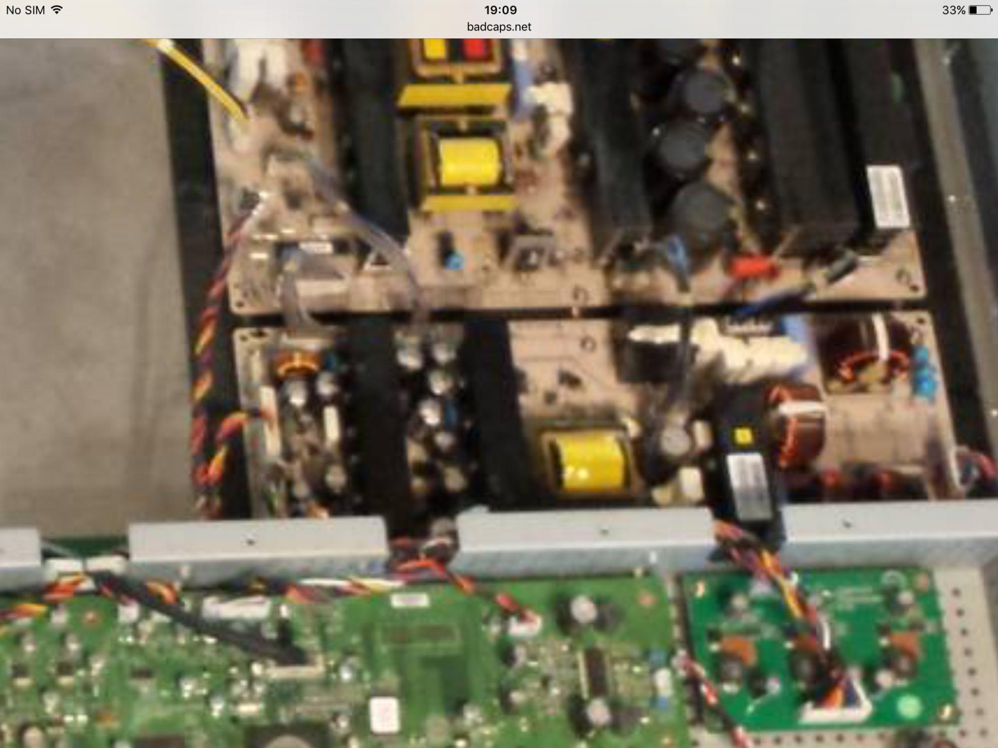

          Lol I see badcaps on the second psu down cant you OP ?

            Theres several badcaps in that second psu down, this will be the issue. Ysus is probably ok:

              How can you possibly see that from that picture? Do you think that would cause the problem with the unit working with the Z sus and buffer unplugged from the Ysus?

                I have good eyes and them caps blown out are common for this chassis. They are 3300uf or something ? Do you know how to diagnose and replace caps ?

                  I can solder and replace. I can use the ohm then voltage charge and discharge test but that's it. I can buy the whole board for $38.00 too. But any advice on a better way to diagnose and replace would be great. My DVOM is a cheap Innova 3320.

                    Well then replace the failed caps, what are the values of the bloated ones ?

                      Ok. I ordered the caps, replaced them and put back together. Works good so far. Thanks for the help.
