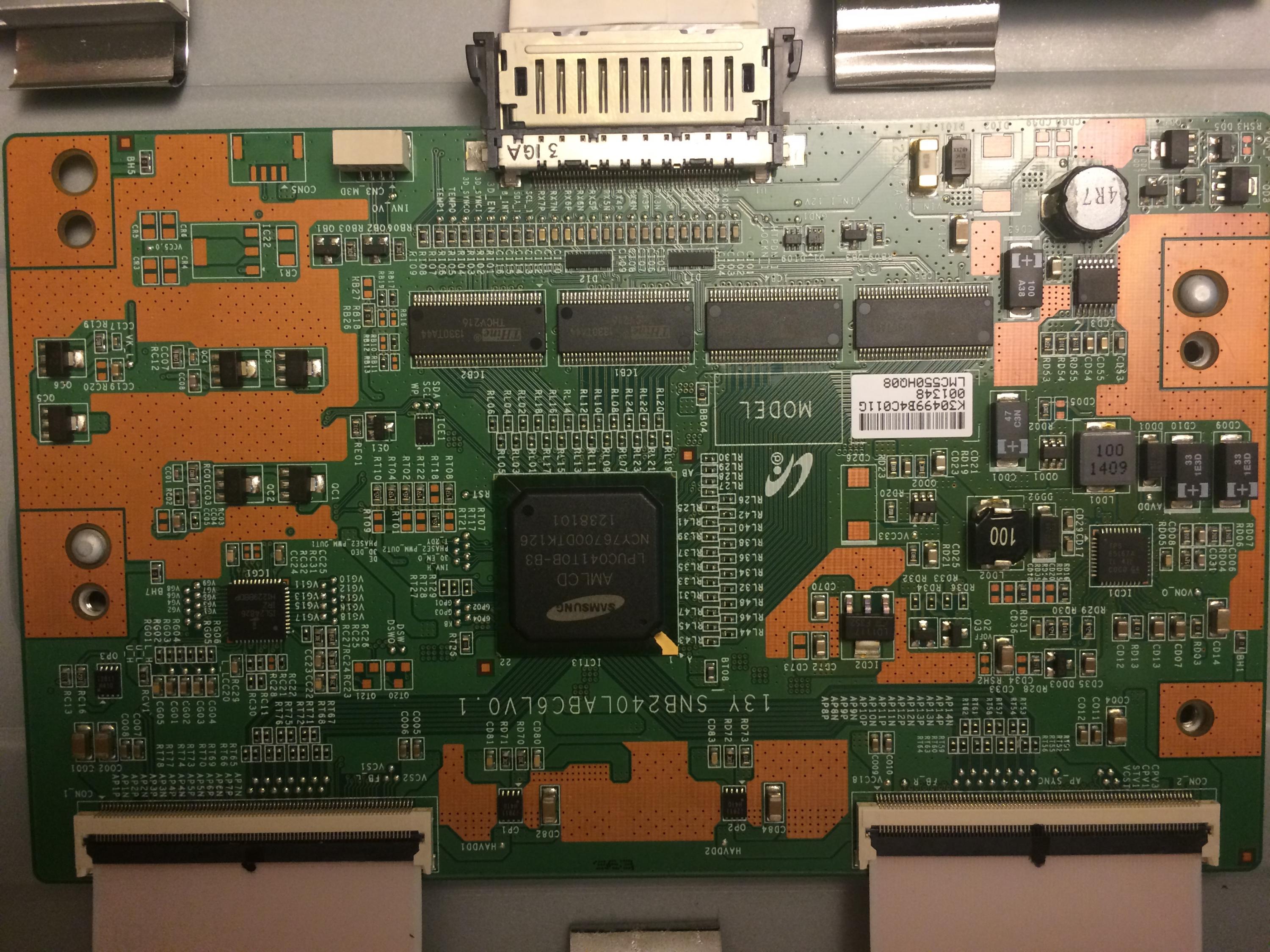

    Hey what's up... I have a PANASONIC 55" LED / LCD TV Model # TC-55AS680U that I replaced the T-CON board on --- TV worked for 7 days than went out with steady flashing led.... continuous counted up to 50 a few times to make sure it was not the 1 - 14 led service display --- it's just a steady red blink once every 3 seconds.... I will keep reading in the meantime to see if I find a similar situation, but if anyone can let me know if this means a main board or power supply board, that would be great!

        Re: Tc-55as680u steady blink
        Yes the T-CON was exactly the same and worked for a week or so...?

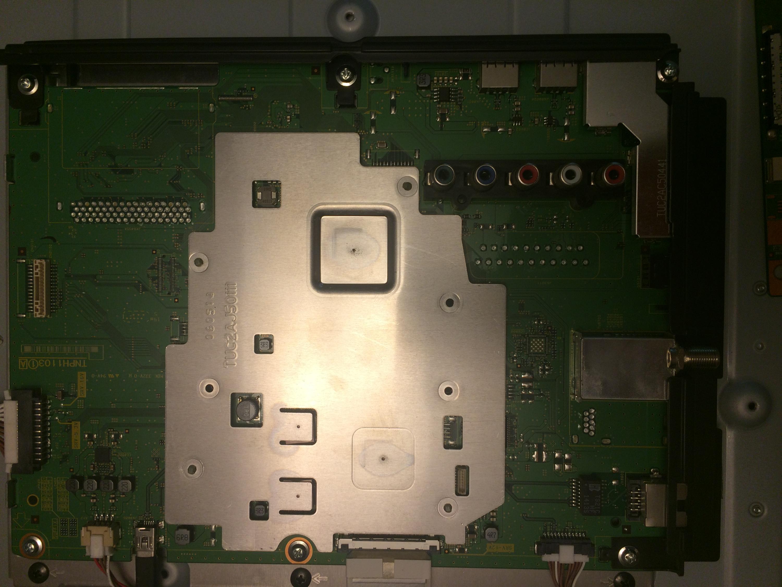

                          According to the blink chart its the "STV 5v sense DG board" <-- DG board is also known as Aboard or mainboard. Mainboard is the board with all the HDMI on it.
                          You need to measure the voltages on the connector that goes to the mainboard. ( From power supply to the mainboard ).

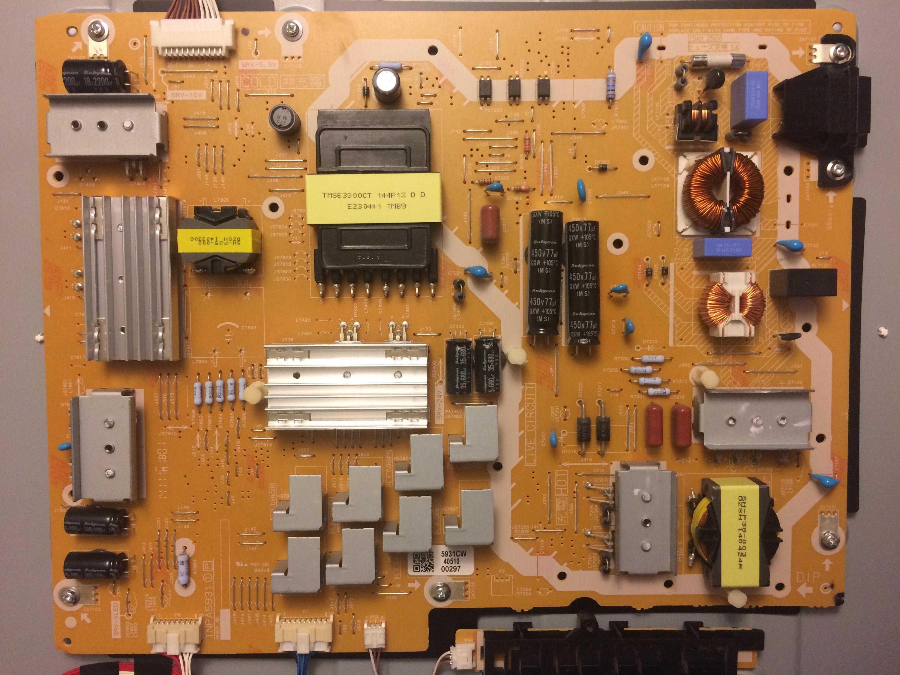

                            here are the pics... All the service points on the boards check out... during the restart.... but the 12V going to main board turns off when the set turns off... so its only on momentarily... It also travels down to the t-con board (which was replaced)..also measure all the high voltage 74V to the LEDs - the big caps go to 170V 5.2 V consistant even after the flip off... Light flashes on and off and goes int the blinks which are actually 3.5 to 4sec between each but continuous...
                            the wires going to the main board are all close to zero except the 5v... I am going to try and measure them once or twice more... but only the forth white from the bottom carries the constant five volts...
                              Your first hunch was right... It was 1 LED that was keeping the whole TV from working... I jumped it with a wire until the part comes in.
                              3rd row 3rd led... go figure.
