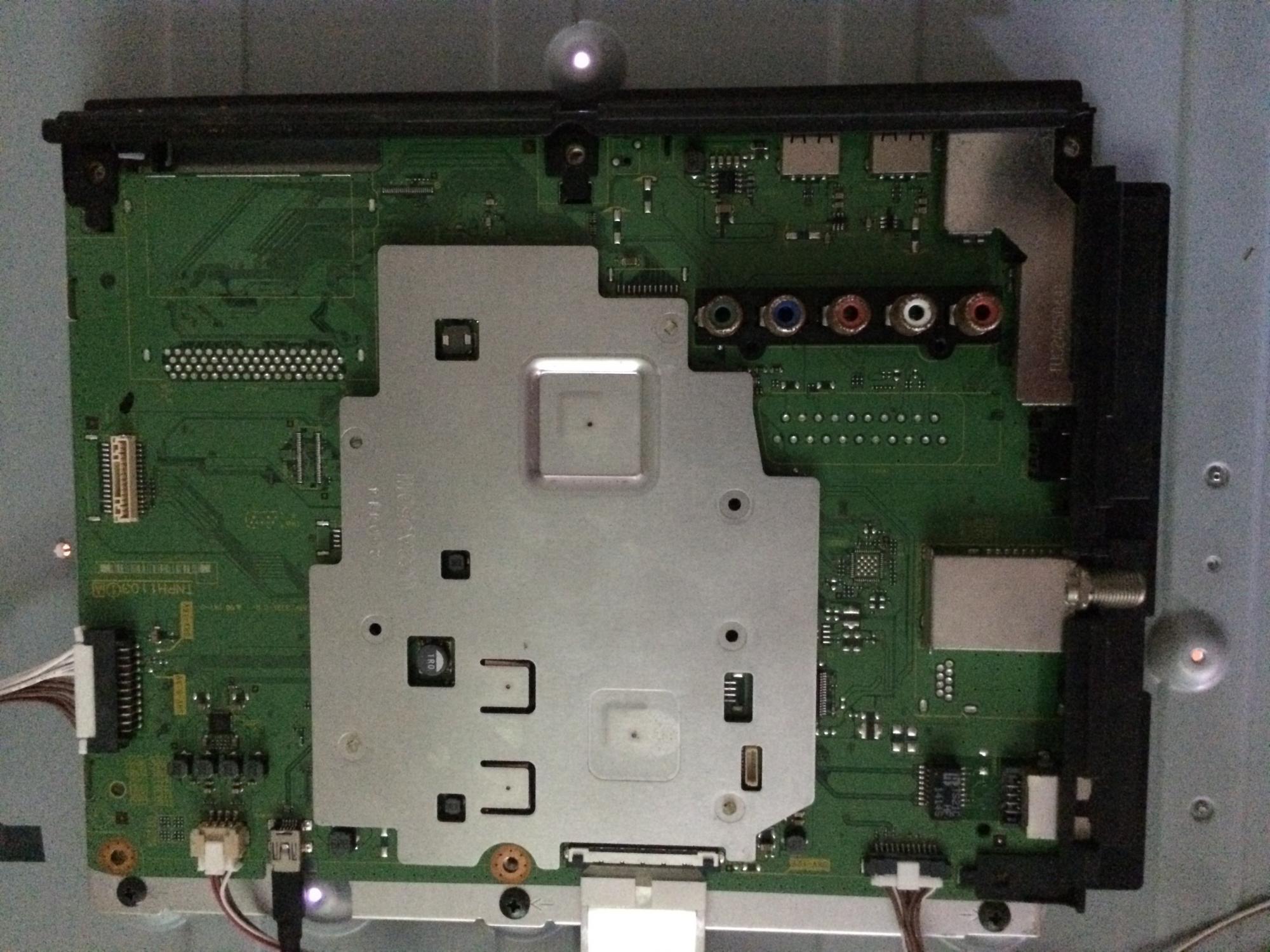

          Ok , looks like the backlight is on , is that correct? If so the leds and powersupply are working.
          It looks like a mainboard issue to me. Tried updating the firmware and see if you get a picture?

                  Service manual says 13 blinks is the mainboard. Maybe the cpu has bad BGA Soldering , hard to find out though.

                      I don't think there is any water damage. I had it on a surge protector but we have had some heavy storms lately. I don't have the remote control I typically use the Direct Tv remote and if I have an app on my phone and ipad to control it. Where can i buy an A board? Is it cheaper to just replace the tv?
                        #31
                        Re: Tc-55as680u steady blink
                        Nah you need to buy the A board. There is a board number on it TNPH......
                        Just look on Ebay , they are not that expensive. $50/60 i guess.
                          #32
                          TNPH1103 I can't seem to find anything in the United States...

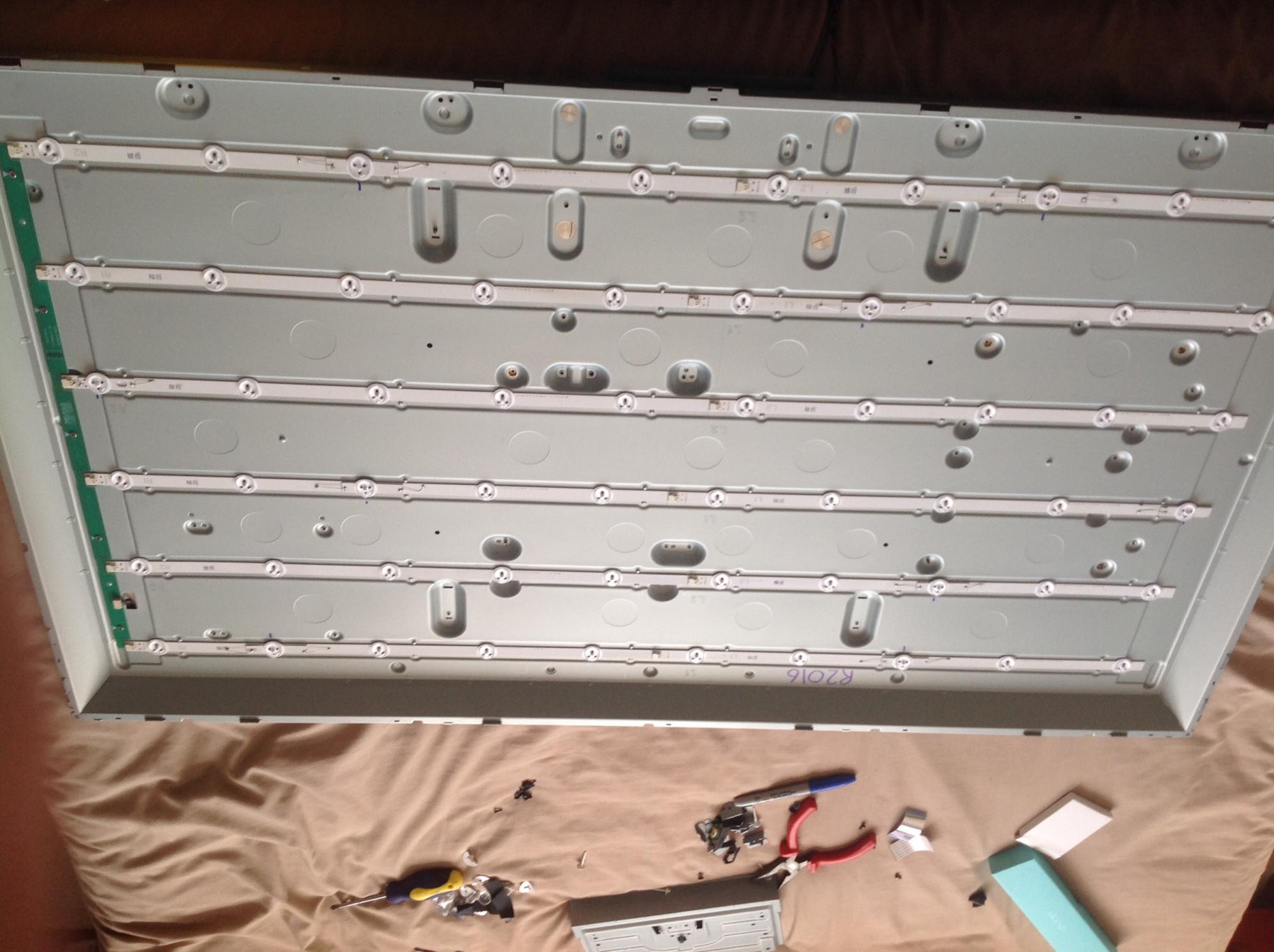

                                        Originally posted by phat34 View Post
                                        Your first hunch was right... It was 1 LED that was keeping the whole TV from working... I jumped it with a wire until the part comes in.
                                        3rd row 3rd led... go figure.
                                        Thanks so much for all you help...
                                        Can you please show in your picture, where this 3rd row 3rd led is?
                                          #40
                                          Hello, I now have the exact problem that phat34 had, I cound not understand how he "jumb" the wire to identify what led is bad.. Can someone help me?
