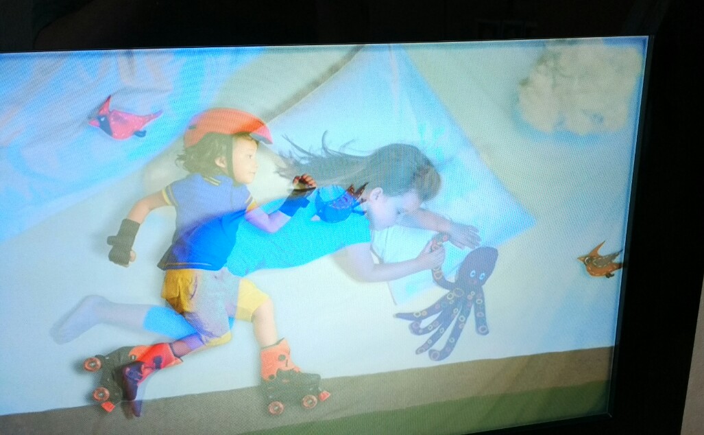

    I just repaired an le32a330 samsung to by replacing the as15f
    But now Im staring at the screen with an edge all inside the lcd screen
    Its a blue edge which is most visible as a "blob" in the upper right corner
    What could this be. Could this be tightening the screws to hard?
    To my knowledge it is not a tcon / mainboard problem so what could this be

    Picture of the blue edge

      If you think it's overtightening of the screws then loosen them all, check if the screen is back to normal and then do them back up carefully while keeping an eye on the screen.

        Ive seen this before, auo panel ? I think its the Lcd foils wearing out Ive never been able to fix it. Try what Dick says though.
