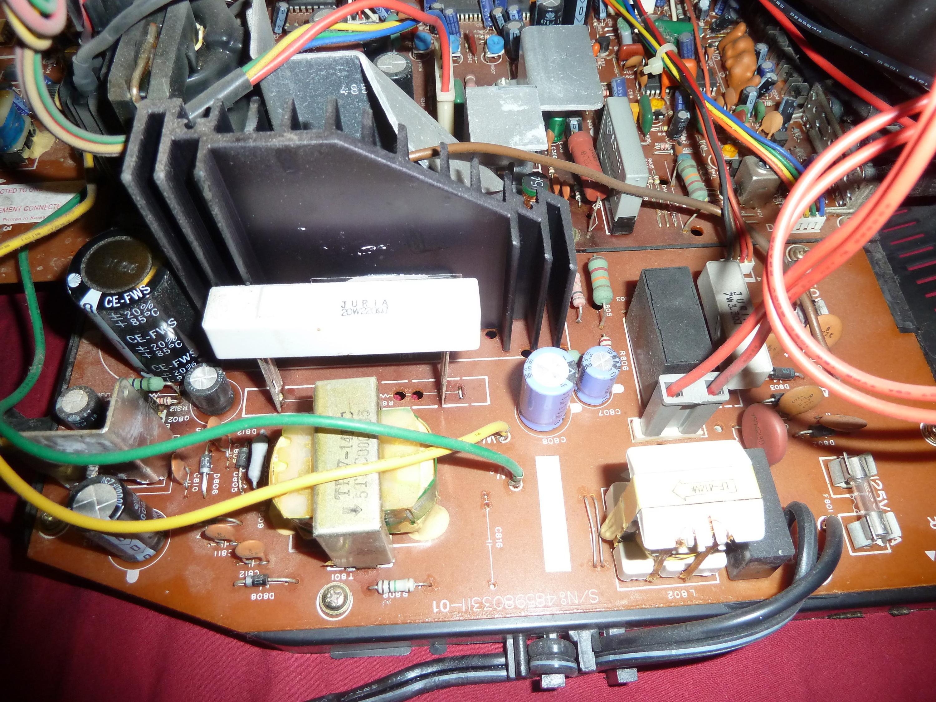

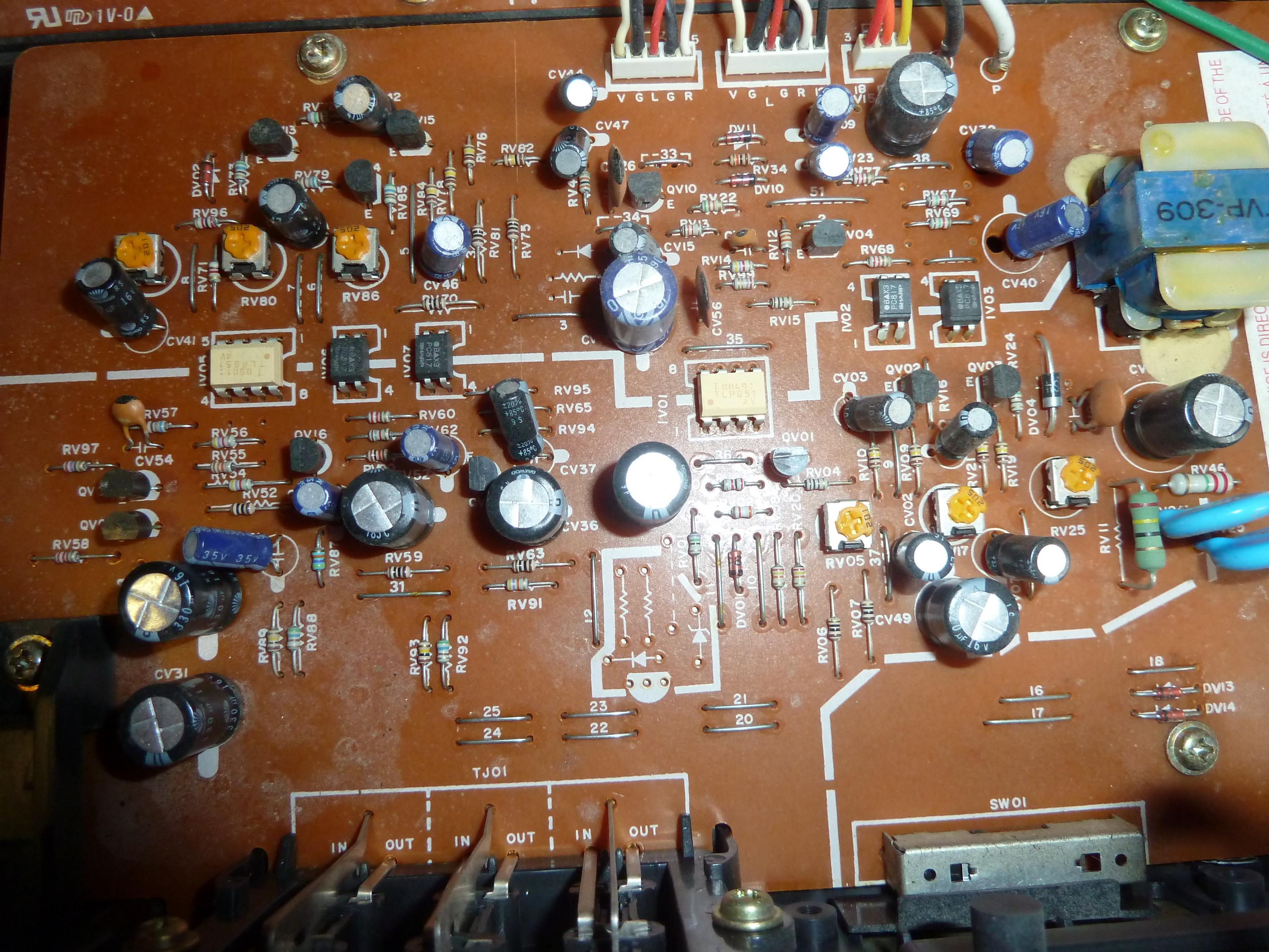

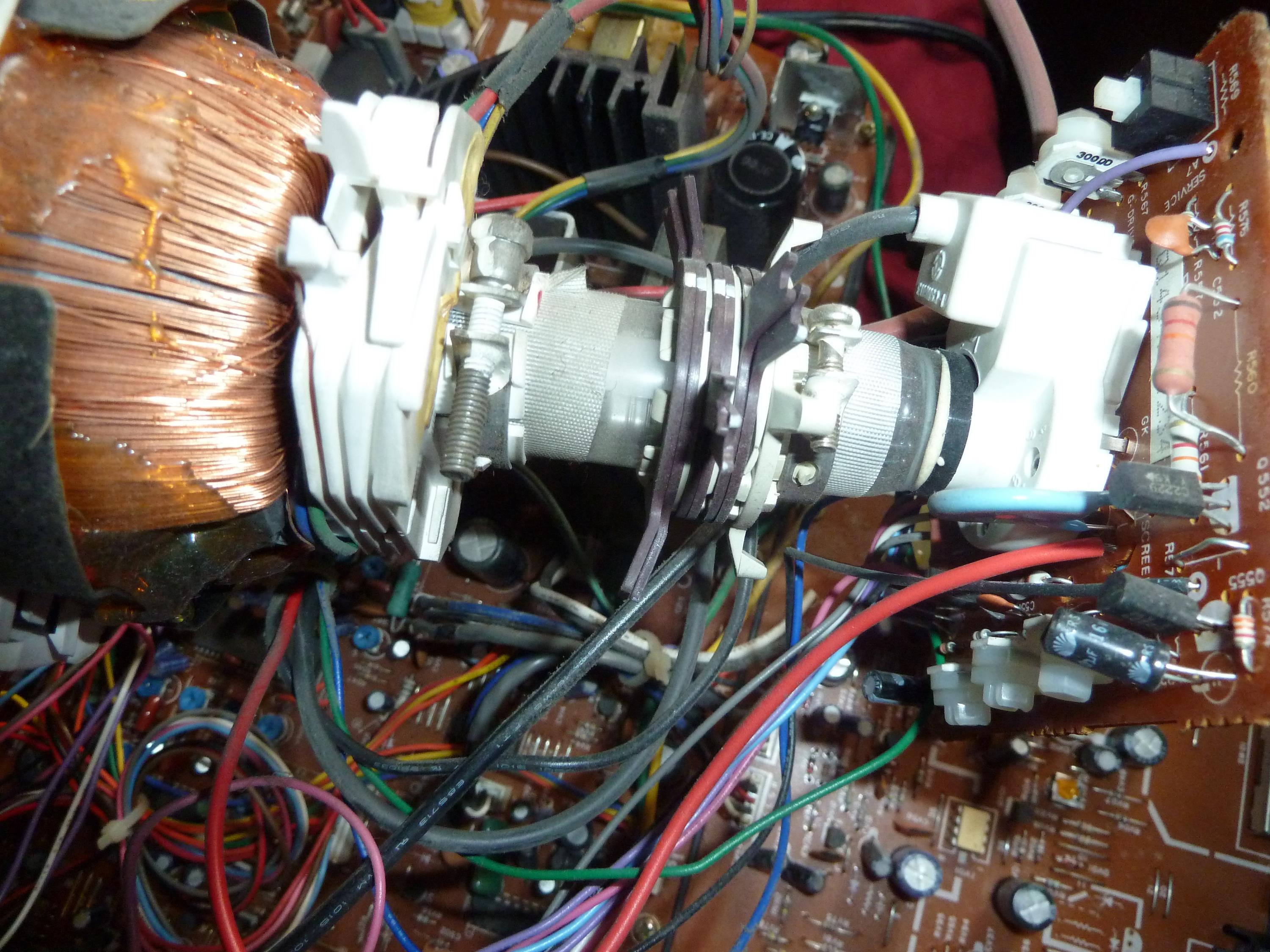

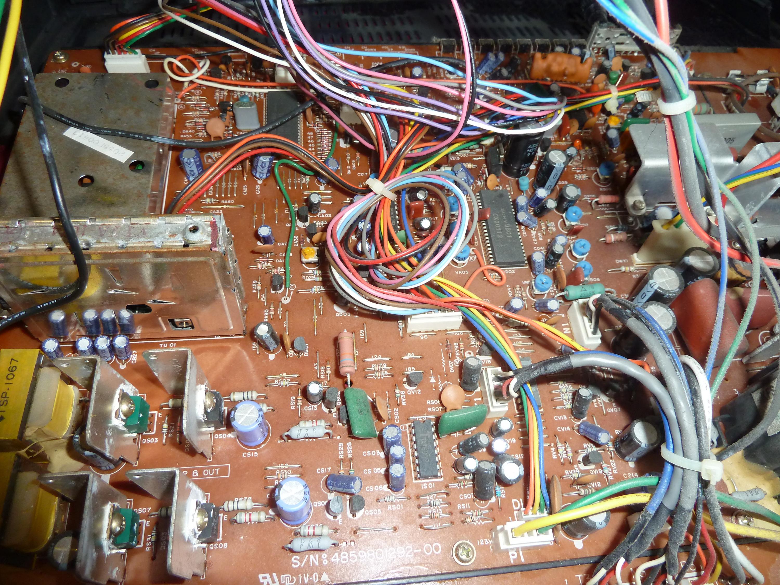

        Re: 32" Citizen CRT TV Cuts Out and Won't Come On
        Here are pictures of the boards. Where would the horizontal drive be? Sorry I have no experience with CRT's.
          Well I replaced the 3 smaller capacitors on the left of the power board (3rd picture) because I had them on hand and still nothing.

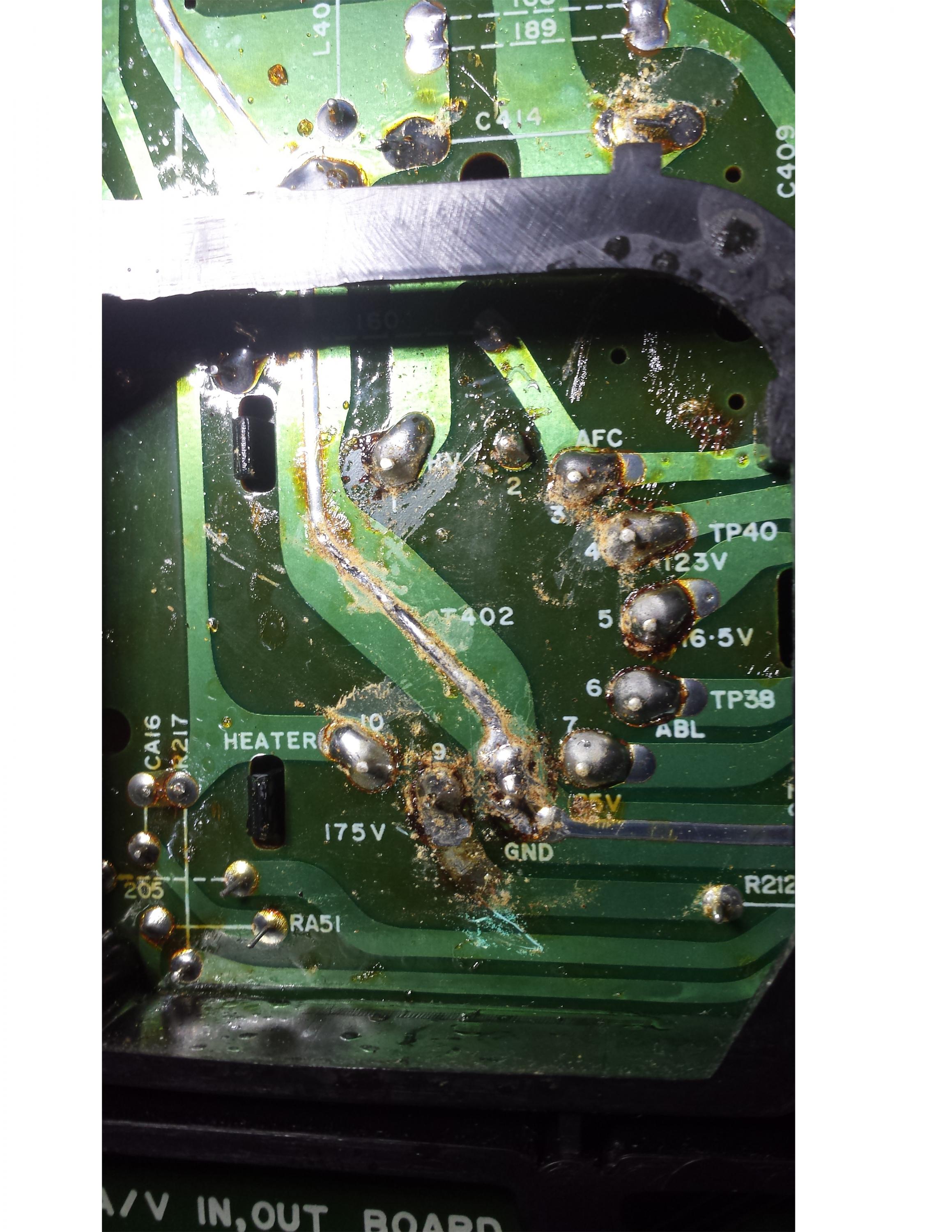

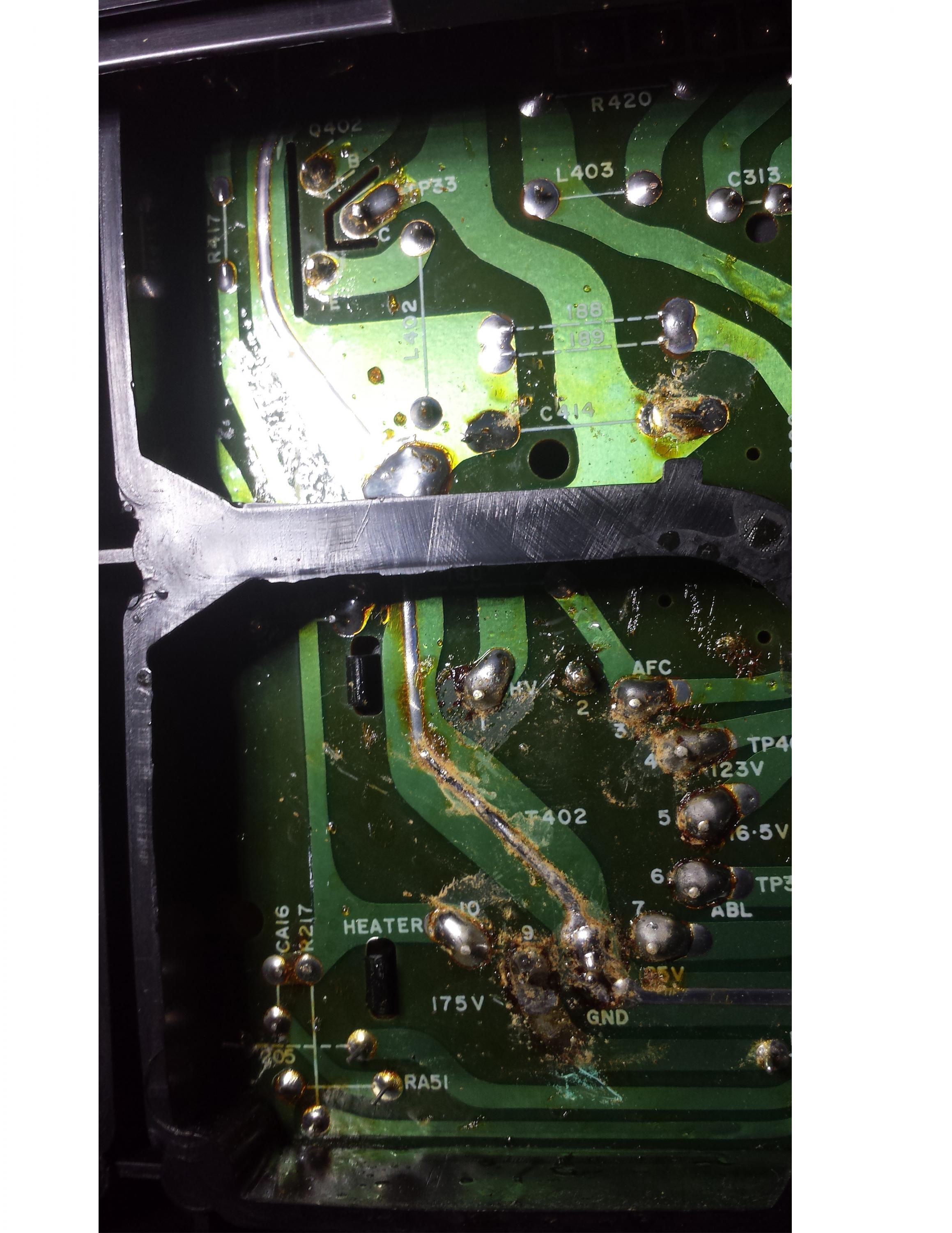

                I tested all of the pins on the flyback transformer and the pins of what I'm assuming is the horizontal output transistor?? I've attached pictures of the board and a list of the pins and their voltages. The transistor I tested has the collector tied to pin one of the flyback transformer. Is this the right one?
                HV-147v
                AFC-0v
                123v-143v
                16.5v-0v
                ABL-23v
                25v-0v
                175v-0v
                heater-0v
                E-0v
                C-147v
                B-0v

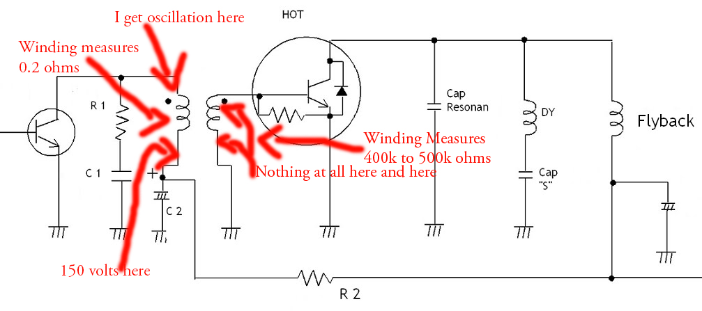

                          No you wouldn't 'see' any thing there, just yet. Make sure you are seeing approx. 0.3-0.5Vdc on the Base of the Horiz Driver Transistor. Also, the X-ray Protect cct may be keeping the set down if it is faulty or really seeing a problem. If you do have 0.3-0.5Vdc on the Base of the Horiz Driver Transistor, the pin off the Main Chip would have a 10uF 50V e-cap to Ground that is fauty. Try a TEMPORARY connection to ground on the X-ray Protect pin and see if the set turns ON. If it does shutdown the set immediately and trouble shoot that cct. If not get a new Flyback transformer.
                            I just checked a Horz. drive transfomer I have and the primary dc res. is about 6 ohms, the secondary reads less than 1 ohm. If your drive transformer reads what you posted then the secondary is open.
                            I checked an older Sony chassis and the drive transfomer is P: 100 ohms S: 2.5 ohms

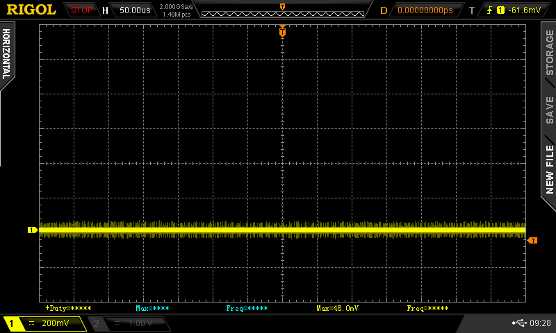

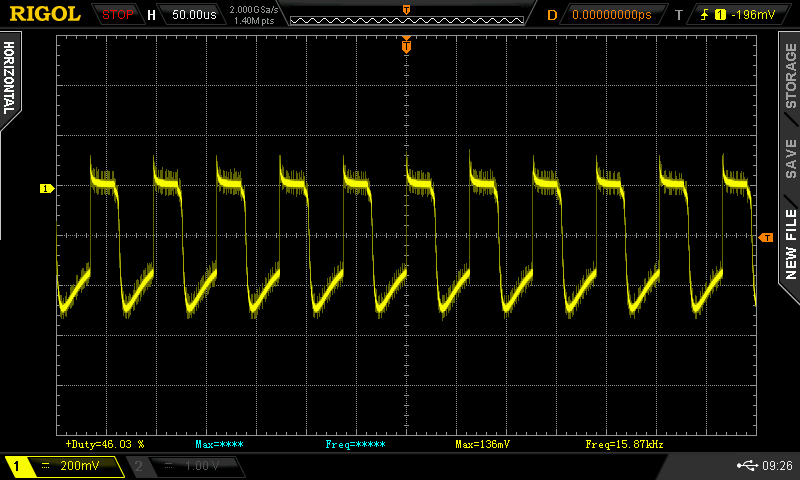

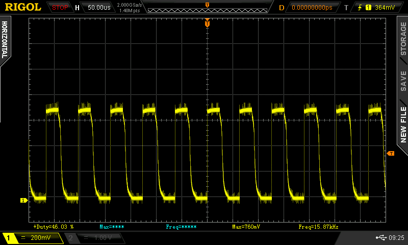

                                My x-ray protection isn't activating the voltage is at 0 and shorting to ground does nothing. I am 100% sure that that is the correct reading on the transformer because I took it off of the board and measured it several times. It is one of those little round transformers where you can see the windings on the outside.
                                EDIT EDIT EDIT: Sorry guys stupid mistake!! I say that I'm 100% sure and then I realize that I'm wrong... The primary winding is the one that is open not the secondary. I don't think this is too big of a mistake because neither winding should be open. I was looking from the top of the board and got it backwards in my head.
                                I've attached 3 waveforms saved from my scope. The first one is the base of the horizontal oscillator transistor. The second is the input to the primary winding on the horizontal drive transformer. The third is the output on the secondary winding of the horizontal drive transformer. It is pretty clear that the transformer isn't passing the signal through because it has 150V and the oscillation on the primary winding but nothing on the secondary.
                                Sorry for the mistake!

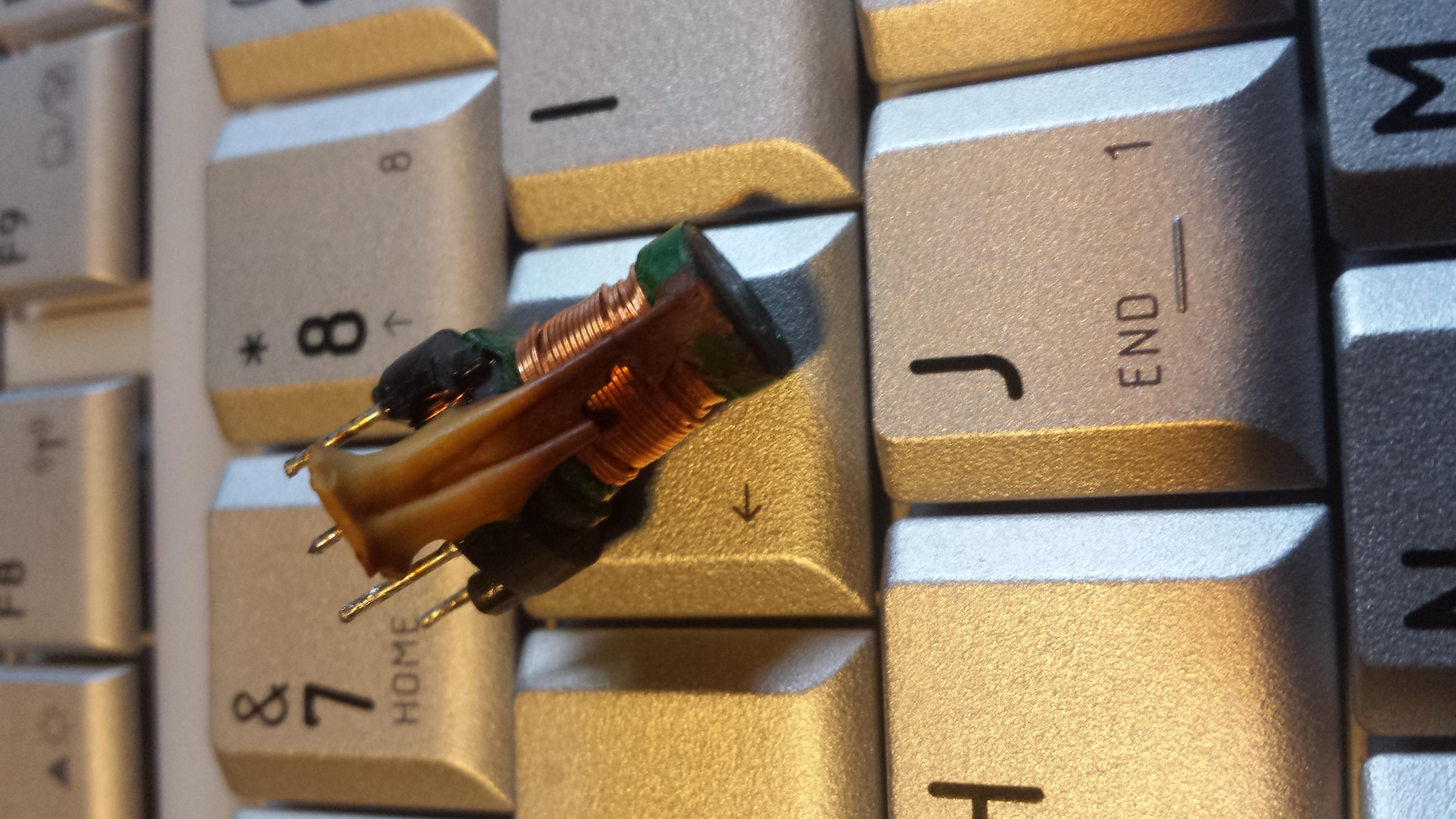

                                  Well here's a picture of the suspect. The glue on the side of it looks discolored due to heat. Is it possible that it failed due to overheating? This makes me hesitant of trying another transformer because the only other one I have is from a working TV and I don't want to blow the ass out of it. I'm tempted to just unwind the thing and see if the wire is broke.

                                  • R_J
                                    • Jun 2012
                                    • 9588
                                    Thoese where a peace of shit, I replaced a few of them. The fact the primary is open and the secodary is still ok is good, as when the secondary goes open the horz. output transistor usually shorts. If you have access to some other tv boards you might be able to find one, does the pc board have the other holes to mount the square type transformer, some had both sets of holes.
                                      Well I decided to go for broke and bodged in the transformer from my other working tv set and it fired right up. The color is a little wonky on the edge and the picture is a bit smeared but at least I found my fault. The board does have 5 holes but they didn't line up at all with the other transformer so I had to use wires. Now to find a replacement transformer. I'm assuming that is not the type of thing you can go buy a replacement for.
                                        Well I did a very dodgy repair. I unwound the primary winding on the transformer, all 51 turns of it, and took the wire off. I then peeled back the isolation tape and while I was doing that the base cracked in half and the core fell off. I found the ends of the secondary winding and the one going to the inside was very very short. I tinned the wires and sure enough there was 68 ohms of resistance. I then Krazy glued all three pieces and took a small strand of copper, attached one end to the post and painstakingly soldered the other end to the winding. For the other end I just unwarpped one turn and soldered it to the post.
                                        I used some scotch tape as an insulator and started winding the primary. When I was done I was worried that it was too loose. I put it in the tv anyways and it seemed to work because I could hear the high pitched whine but there was no picture. I took the transformer off, unwound the primary, and then rewound it much tighter and in a more uniform fashion. I put it back in and surprisingly enough, it worked! All the colors were back to normal as well. I don't imagine this repair will last for very long but at least it works while I find a replacement.
                                        Thanks for all the help in tracking down the issue to everyone!
