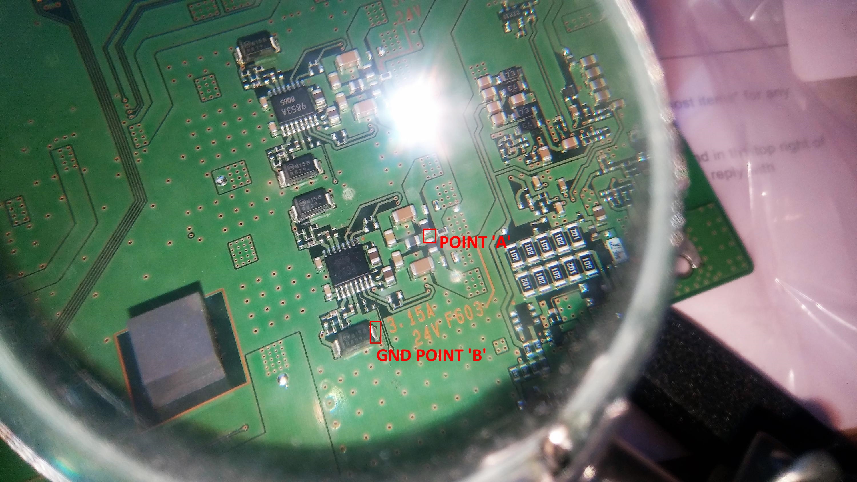

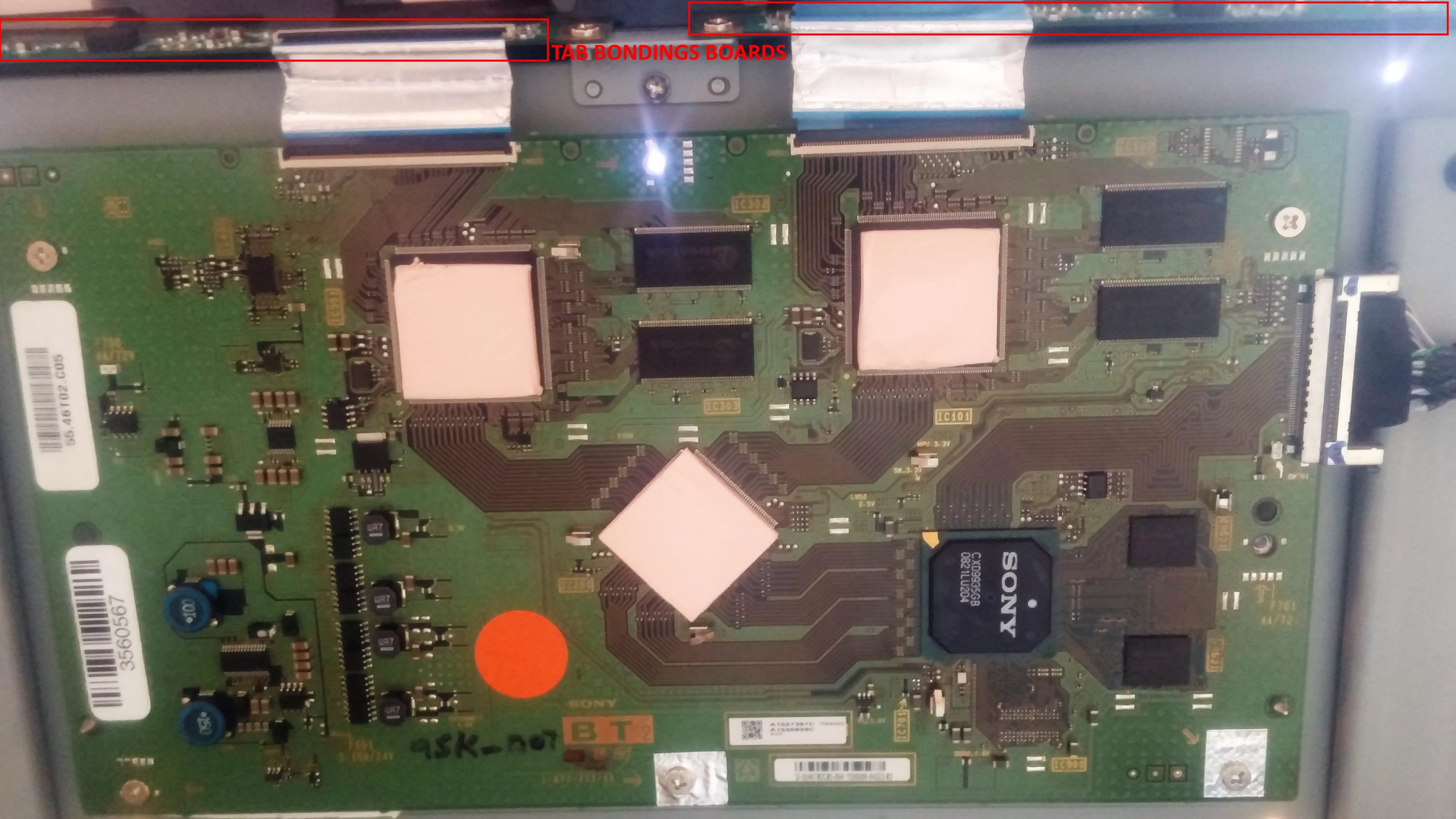

Re: Sony KDL-42XBR6 14 blinks missing DC to T-Con
I don't think you will get a "good result" from a sony with both cables from the tcon to panel disconnected. You need to only disconnect one at a time and see what the result is there after in terms of display and flash codes.... assuming, of course, that said fuse is good.
