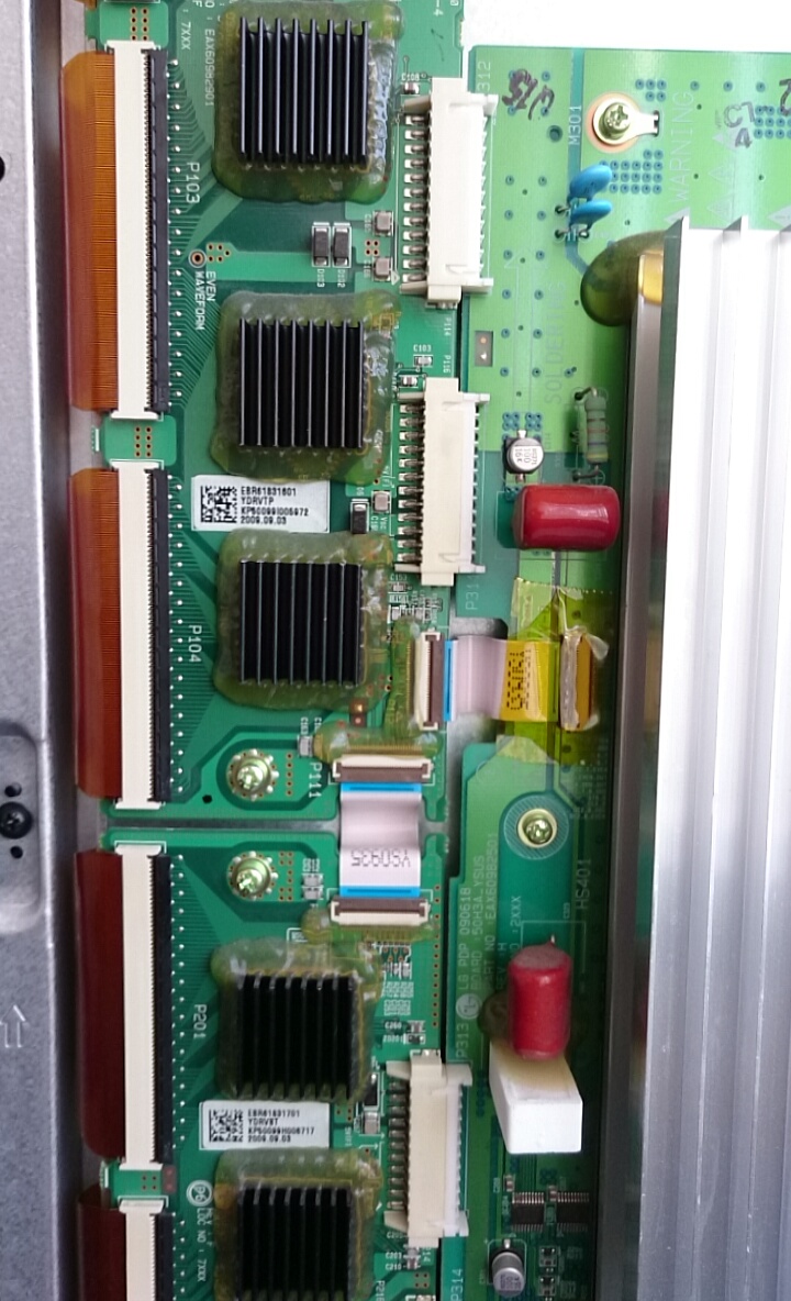

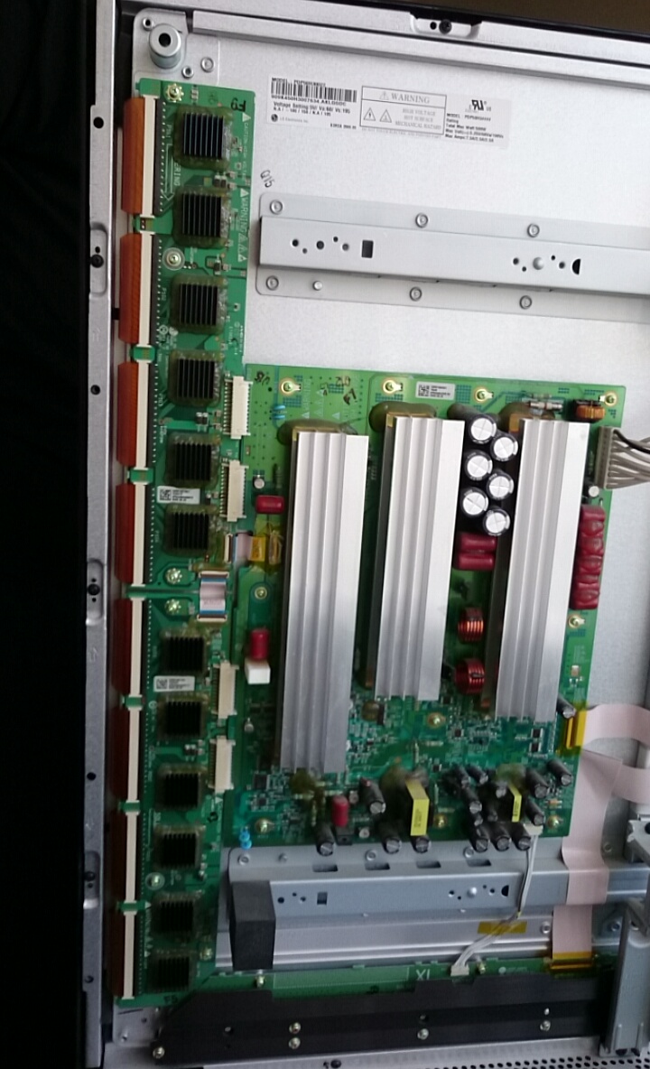

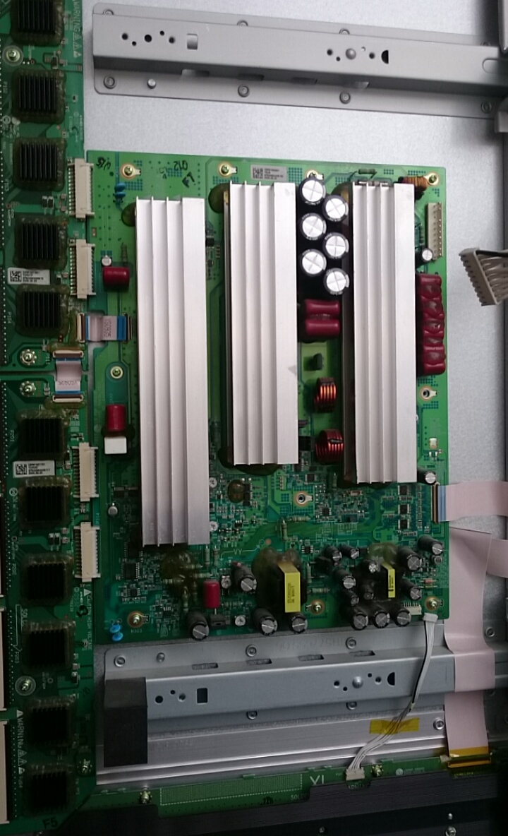

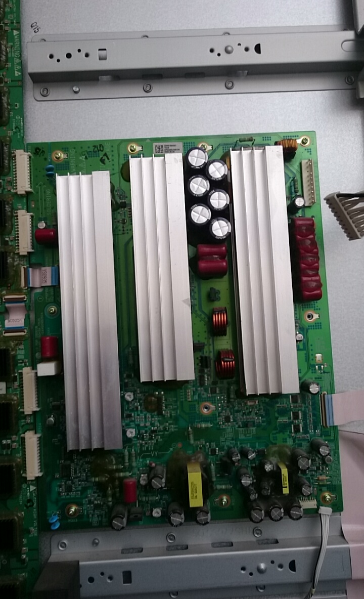

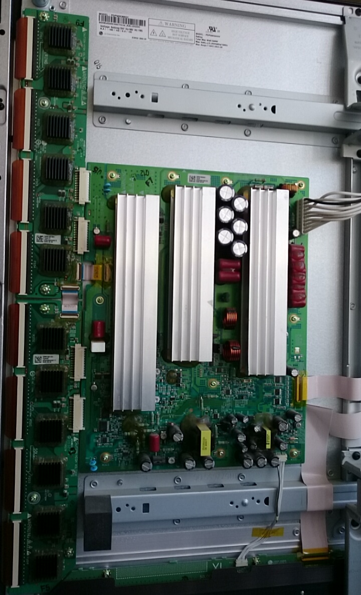

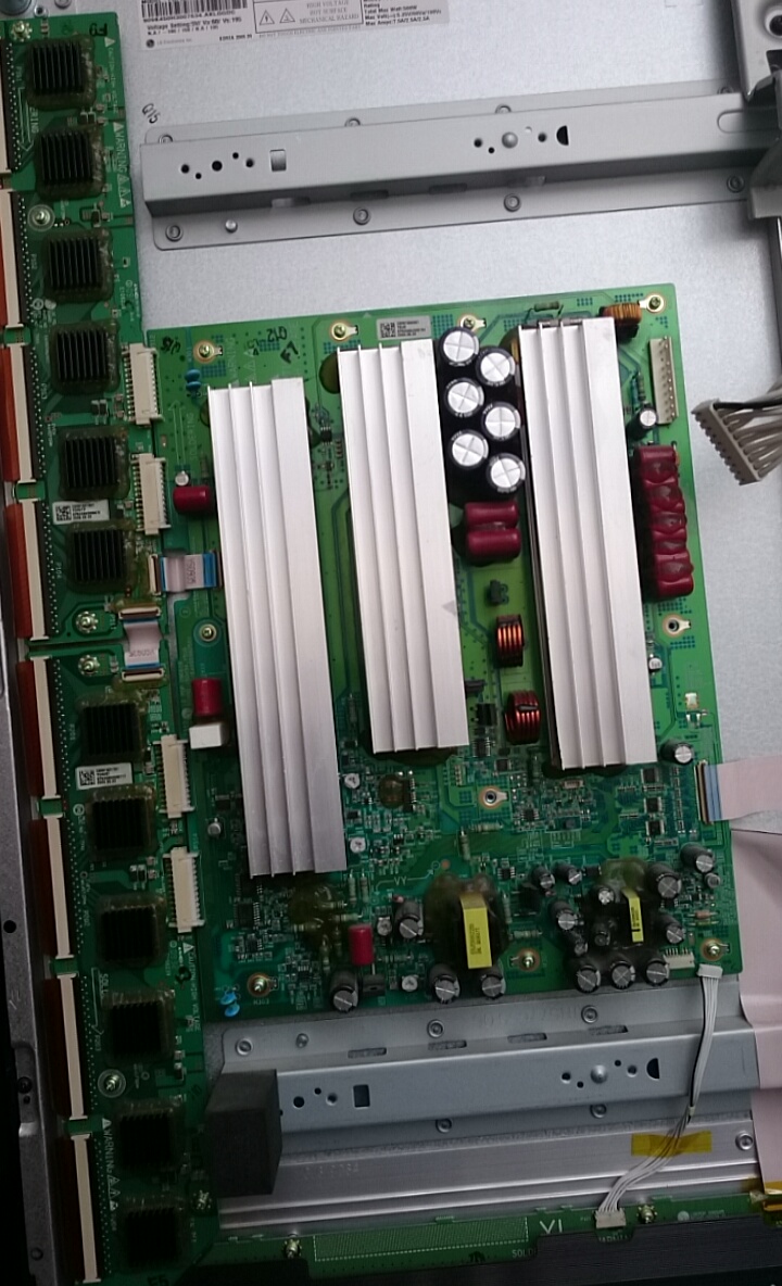

                  Update...
                  I've taken off and reattached the Ysus board...getting impatient with no progress. No difference!
                  I've attached pics below...could you kindly point out which bits I need to use (and how) to run a test image please.
