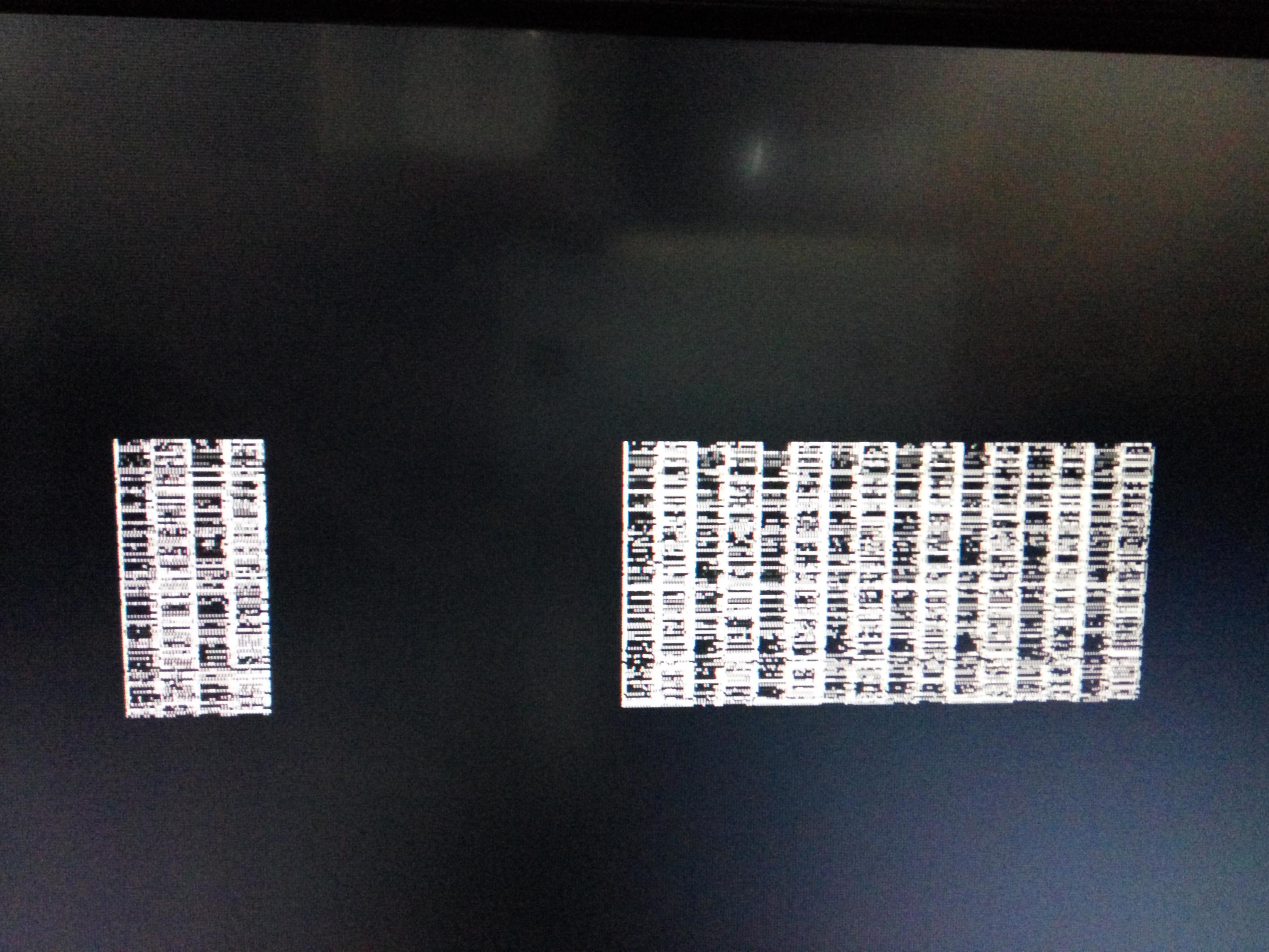

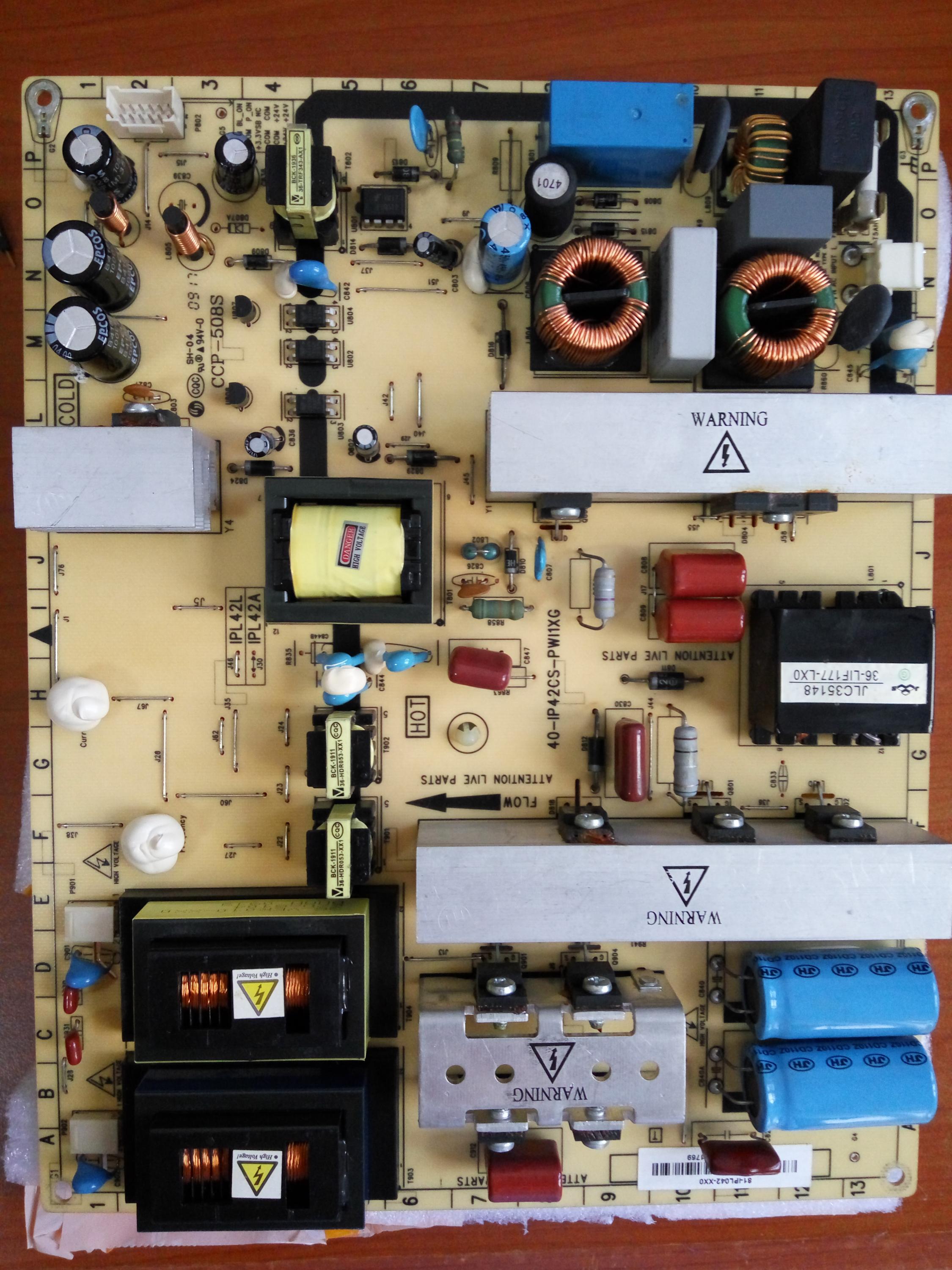

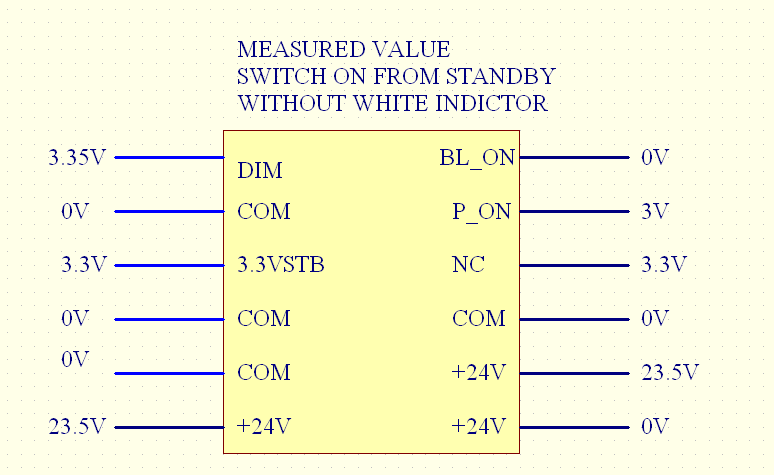

    The TV is giving intermittent problem as follows:
    1) Stay in standby mode (red color indicator) and will not responds to the remote or power switch on the TV....Have to unplug and replug in supply multiple time and with luck will turn on.

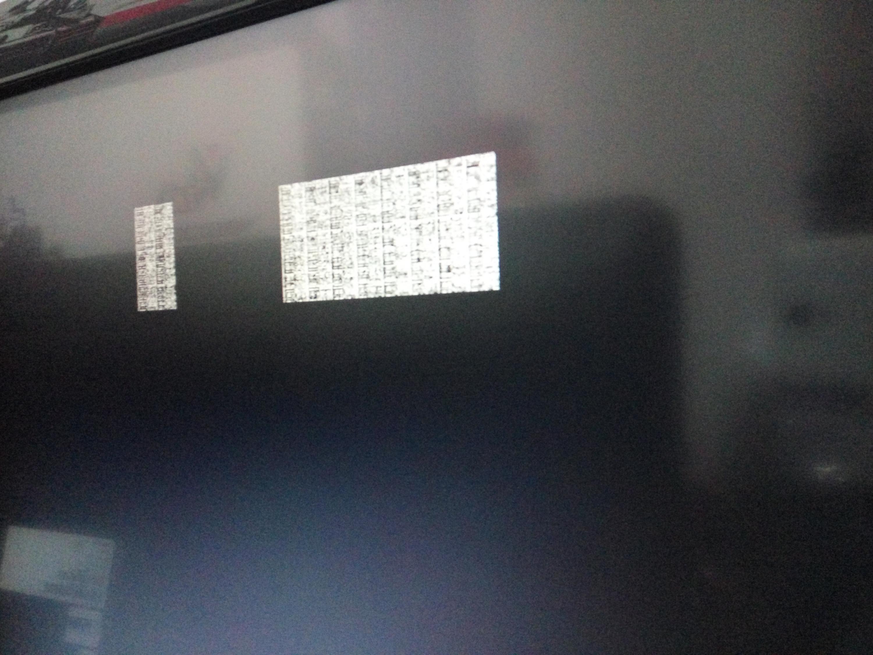

    2) When turn on (white color indicator) it will operate and suddenly there will be a glitch and the display goes haywire and speaker clutters....following will not be responding to remote ...have to power down again.
    3)At time, from standby mode, pressing the remote will switch on (white indicator) but no picture or sound......again will not response to the remote.

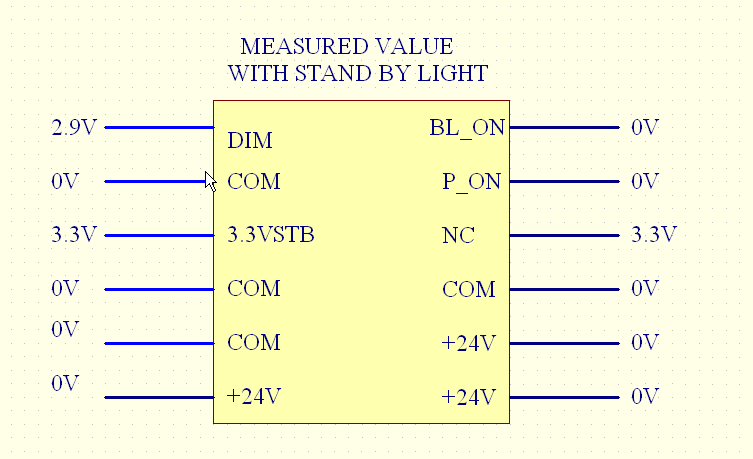

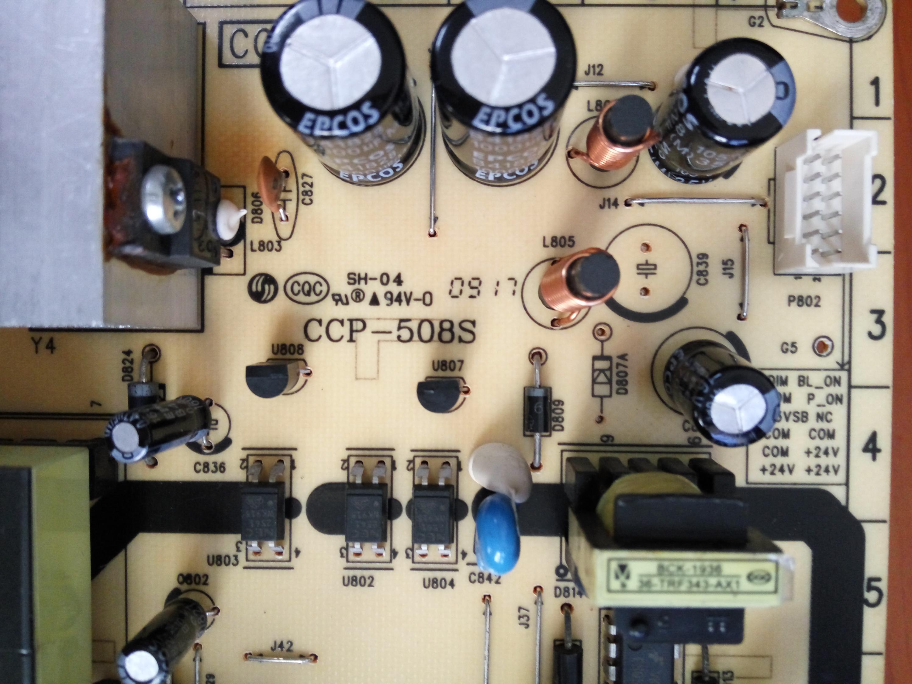

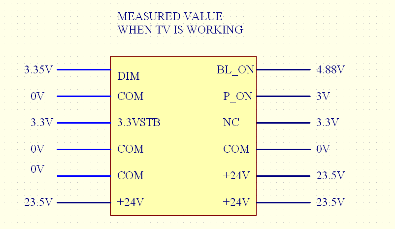

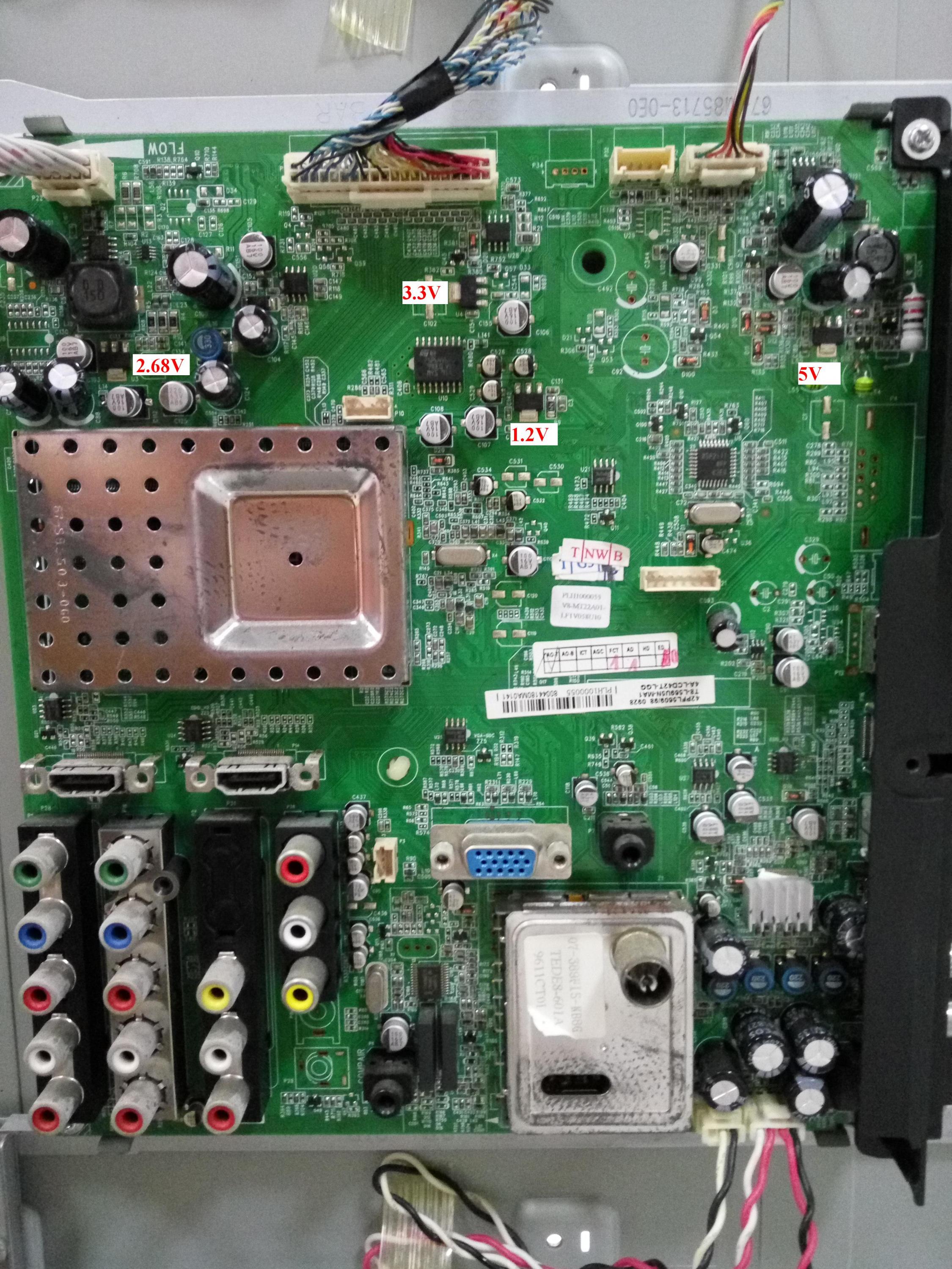

    Test Done so on PS board - measurement
    a) PIC 1 : with standby light
    b) PIC 2 : switch from standby to white light but no display
    c) PIC 3 : when TV is working
    I have remove and tested all the thru-hole capacitor and the reading are all OK.
    Not sure if it is the Power Supply or Main board that is giving the problem... If it is the main board, how to or is it possible to rectify and repair.
    Attached Photo :
    ps measured point with cable connected to main board
    PS Board Part No : 40-T8222P-MAD2XG
    Seeking all the experts advice....
    Rgds
    Wushumike

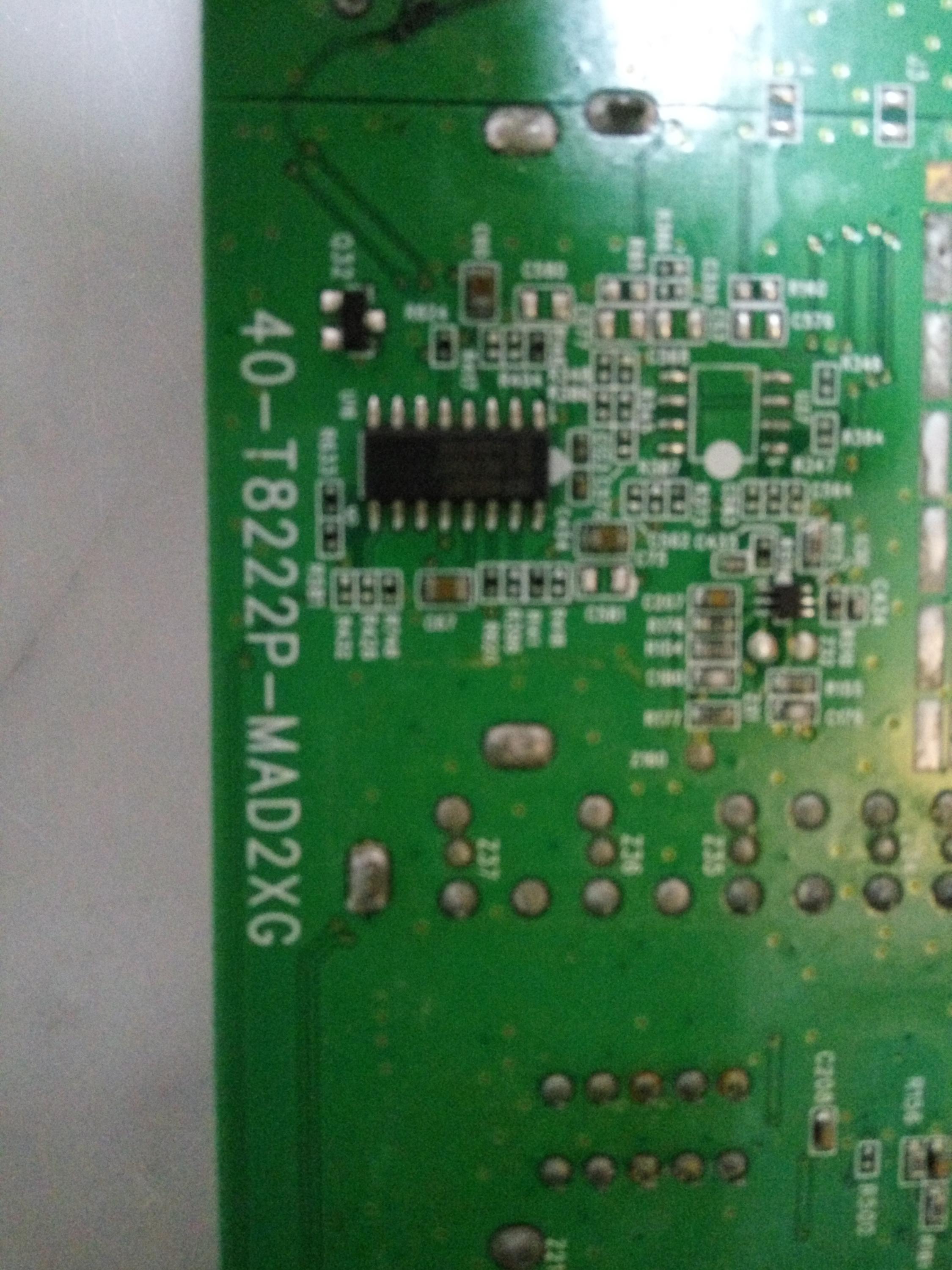

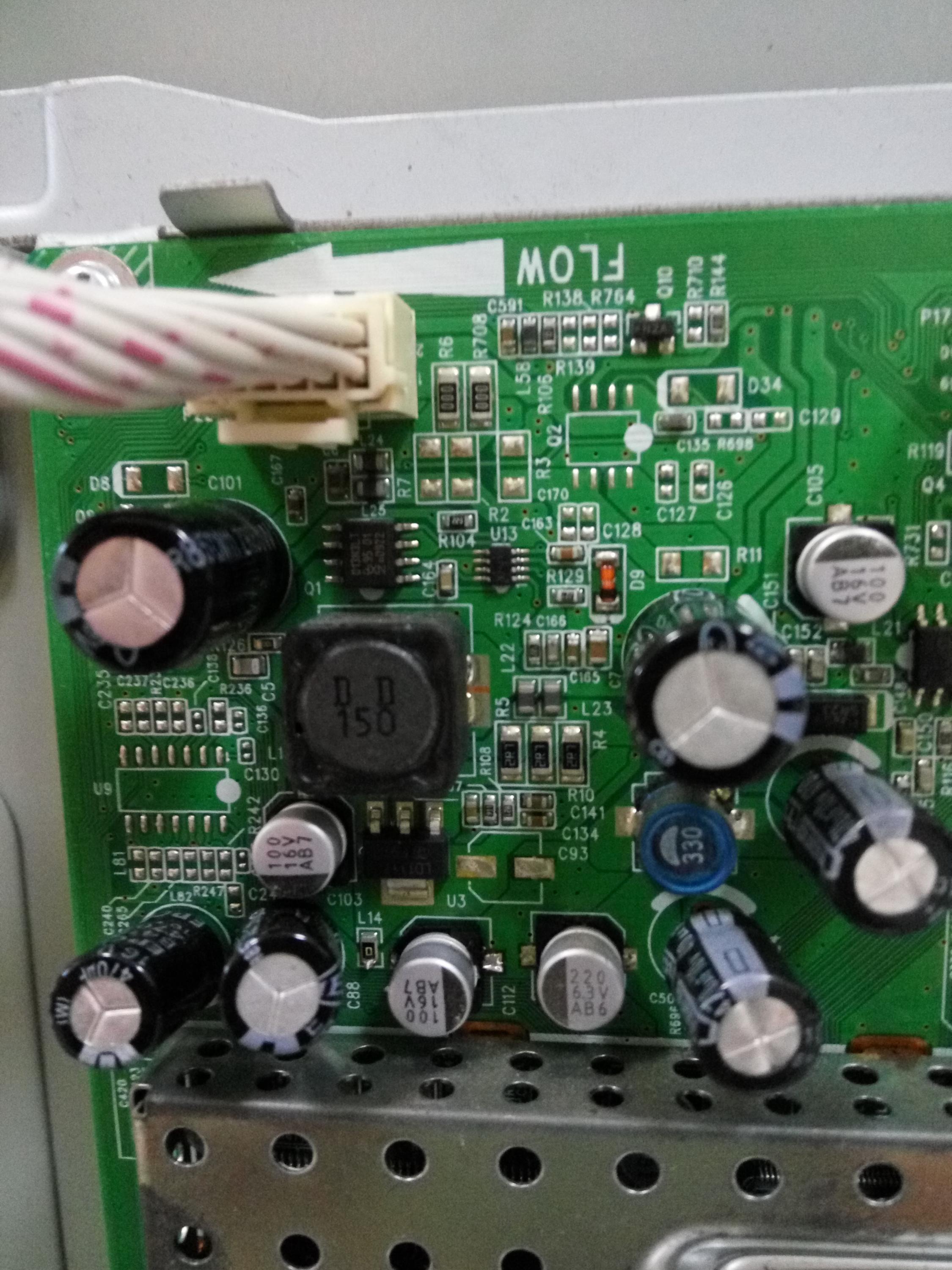

    Re: Philip 42PFL5609/98 - Intermittent

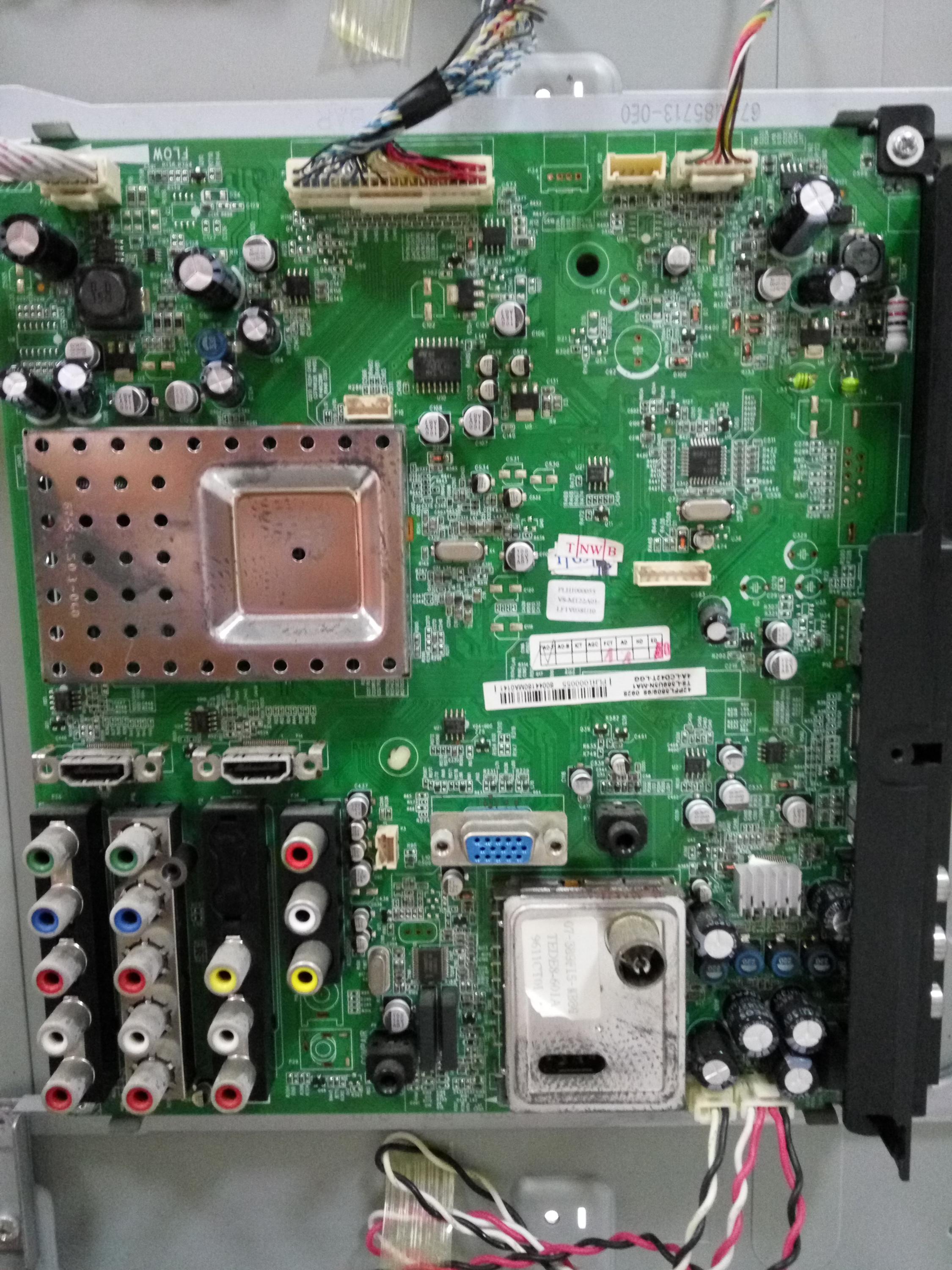

    Can we see the pictures of the whole boards?
    Right now it looks like the main board is the problem.
      Hi BUDM
      Here is the photo of the ps and main board.
      Oh btw i made a mistake the ps part no should be 40-IP42PS PW11XG
      The main board is 40-T8222P-MAD2XG
      Rgds
            This is the glitch screen im talking about.

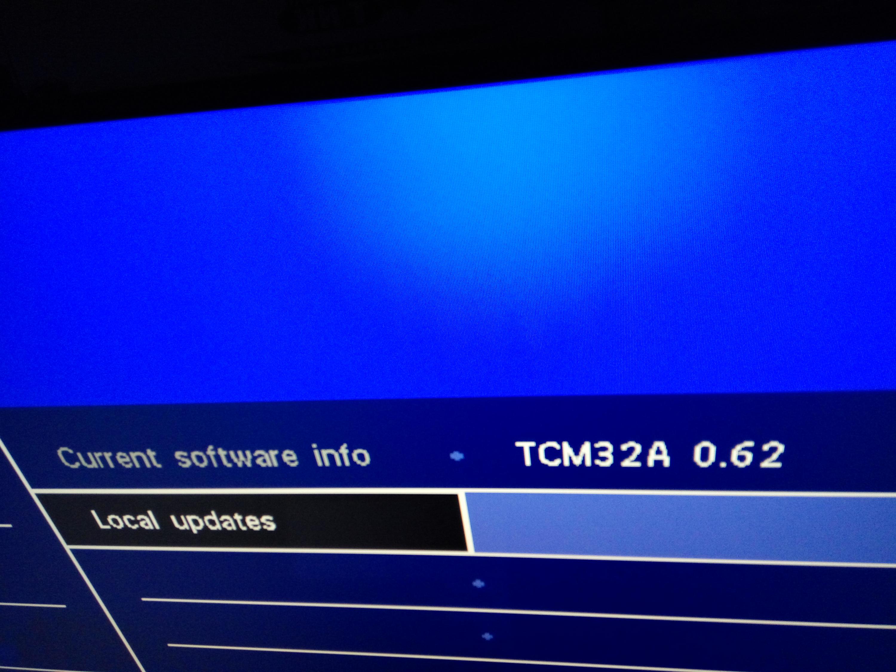

                  Yes Diah,
                  Remember that I downloaded and updated the software via USB some year back...then the TV operate without any problem.
                  Anyway, I downloaded the version from Philip and reload it to the TV again although it was reported by the system that the version is the same.
                  I have also measured the voltages of the main board regulator when the TV is working and all the voltages seems normal...attached picture of reading.
                  Thanks for the schematic....but I don't know how to work around the problem if it is due to software.
                    with yours photo of Firmware update, yours Pfilips should work Picture and sound with HDMI digital signal.. plug video source to HDMI 1 and post here photo please.

                      Even when the tv is not working properly, I did a measurement on the main board regulators output....the supply actually did turn on as I was getting 2.68V , 1.2V, 5V, 3.3V .
                      At least with all helps, it has been narrowed down to the main board problem and not the power supply board.

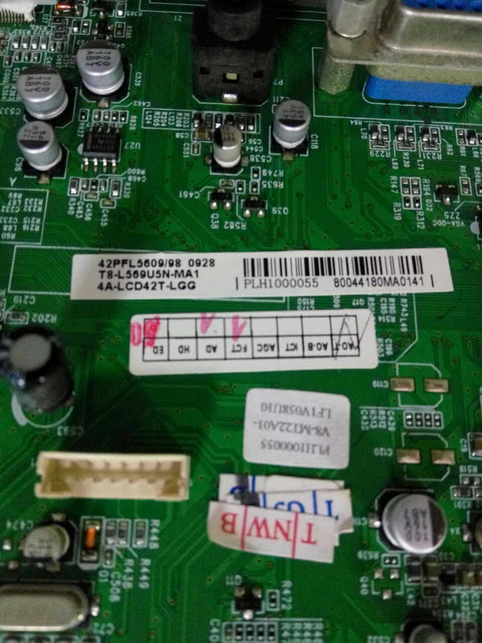

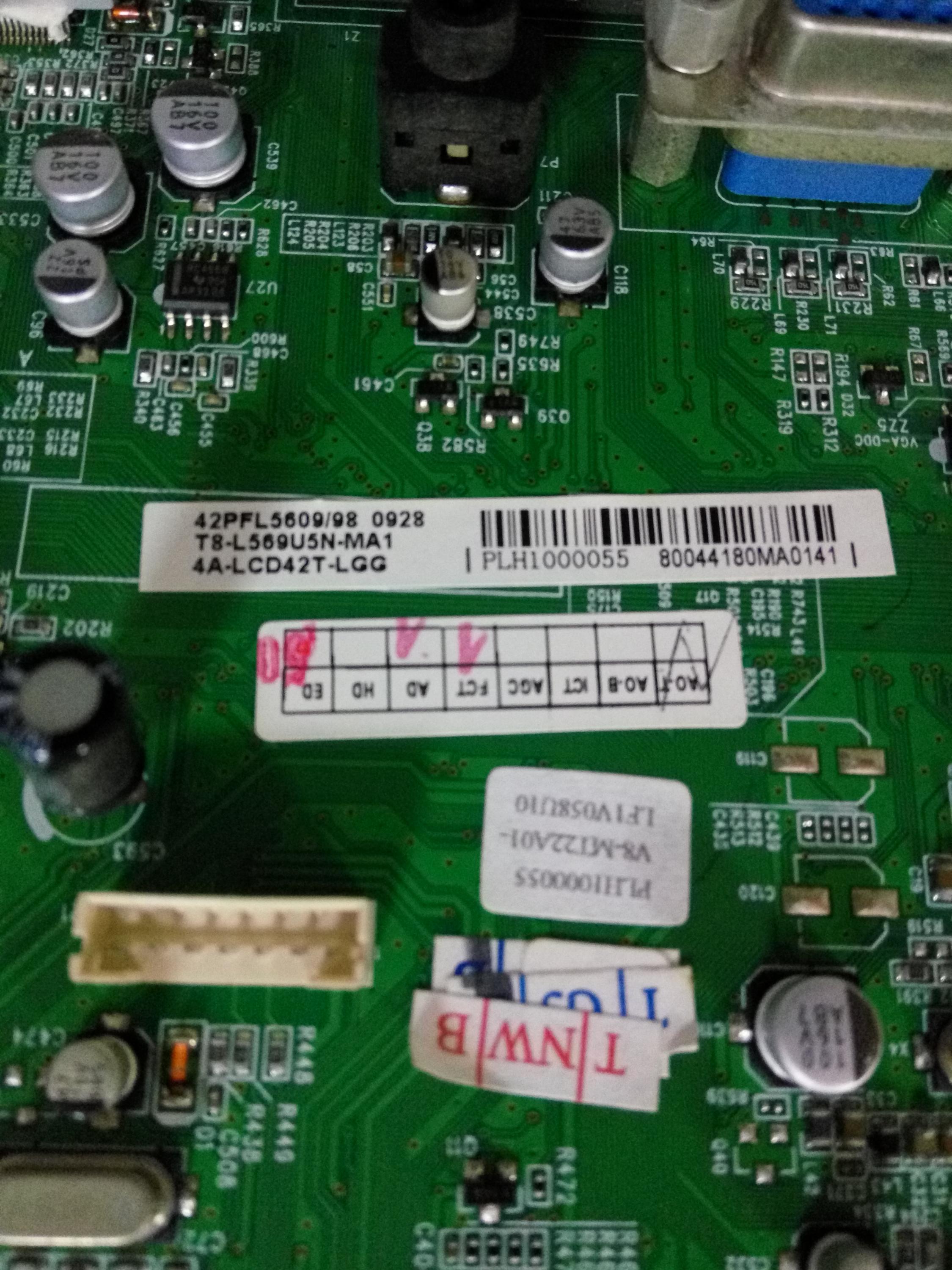

                      My TV mother board partnumber is 40-T8222P-MAD2XG 42PFL5609/98

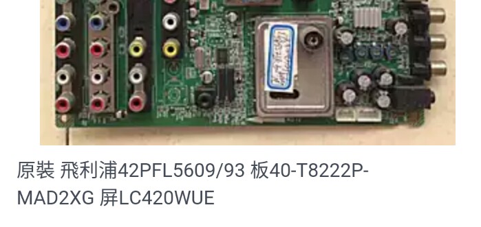

                      I did a goggle search for the board and found selling
                      40-T8222P-MAD2XG 42PFL5609/93
                      Not sure /98 and /93 what is the different..... If I were to get the /93 is it compatible to my TV model

                        Is it possible that 98 and 93 are being misread?
                        • wushumike
                          • Jun 2016
                          • 41
                          • singapore
                          Hmmmm....
                          I attach my tv mb photo and taobao snapshot...
                          Eeee... initially I thought was the year...but 93 is just too old
                            /98 & /93 same chassis TCM3.2A and pin layout passed

                                I have removed the aluminium shield to take a look at the processor area...no dry joint or bloated cap...I have also use the same heat blowing method.but problem still remain.
                                As the fault is intermittent...I really have no ideal what is wrong...
                                Frm the schematics, there is this standby mode processor...could this fail?..but then there are firmware burn into the processor...so no way to replace .
