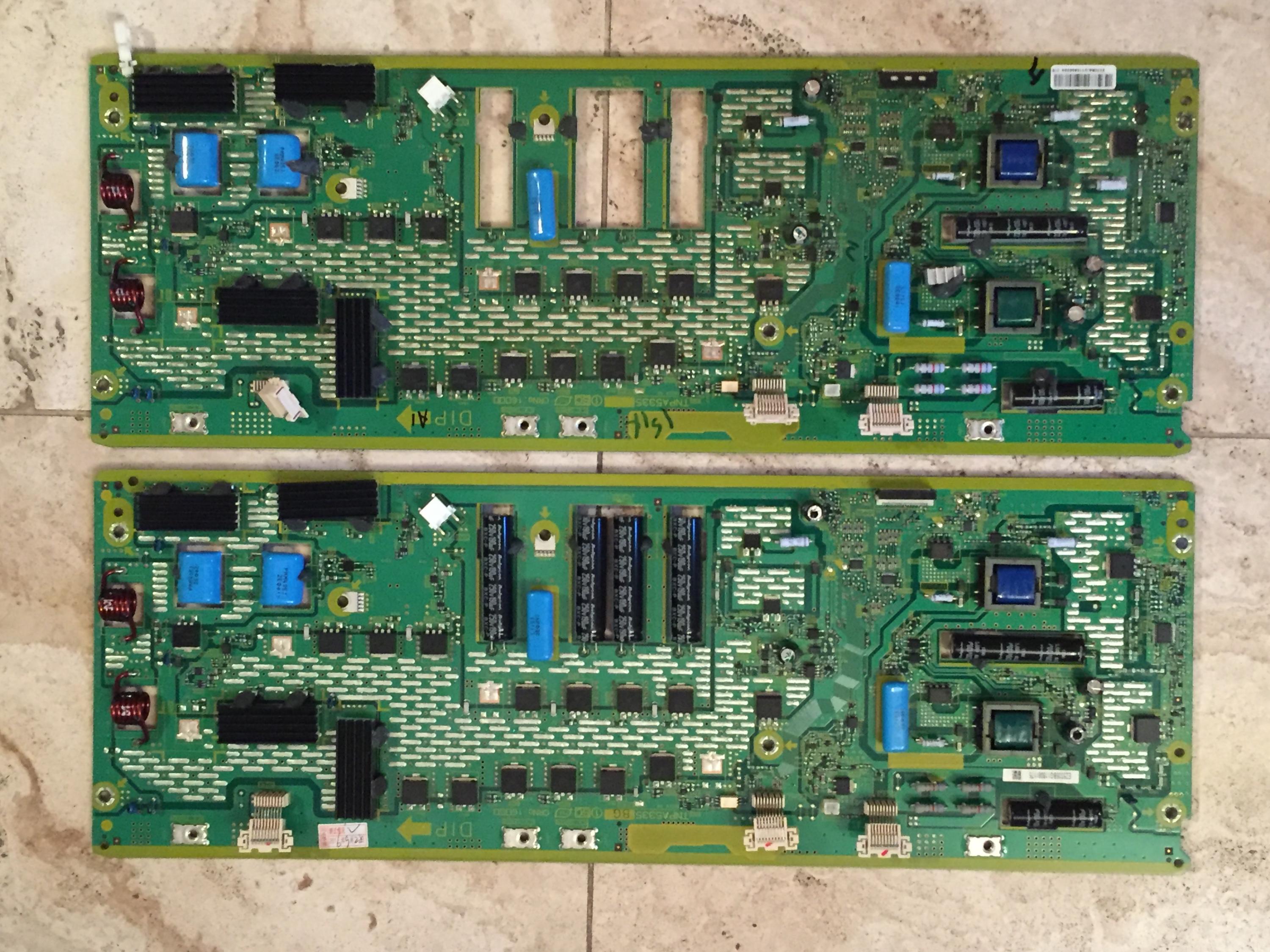

                          On both boards , how many BIG capacitors do you have? Can you post pictures of both boards? As i said there is a difference in AB / BA / AH model boards.....

                              I will get pix of the old and new boards later today. There were 4 large aluminum caps (which I still have) but I also cut out a mylar one and an SMT one which I don't think I saved.

                                near ic724 and in the area of the sc46, sc50 connectors there are a bunch of parts and ICs missing on your original board.
                                on the 50" boards these are populated. In a nutshell this means the circuits and the way these are driven are different and why we have this unusual result.
                                I'm very sure somewhere within this forum someone else has discovered this trying a different board in error.

                                  Here is a picture of the old (BA) and new (BG) boards. The old one has the caps removed and a slightly bunged up connector. I do not see a difference in the parts layout.

                                    I do , I've also mentioned the general location to look.

                                      Okay I see the extra parts. Thanks for that. I guess my next step is to return my BG board and get a BA board or parts for my old board. I tried shop jimmy but they are out of BA boards. A place called PTS might have one for $95.
