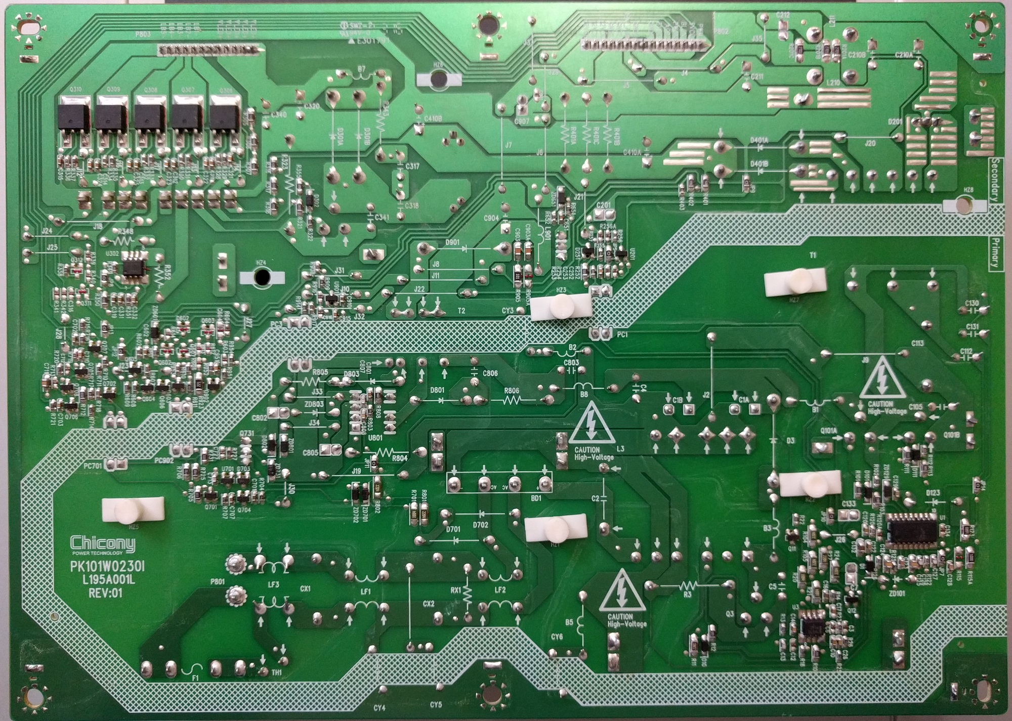

    Hey everyone,
    I just bought a Toshiba 58L4300U TV real cheap because it appears to be dead. It does not power on at all. I was hoping I would find some bad caps or something easy to fix, but no luck there. All the caps and other components look fine to me physically.
    The power/standby LED for the TV never lights up at all.
    Poking around with a voltmeter on the power supply board reveals the following:
    • 5VCC output always has 5 volts
    • ACD output always has 3.3 volts
    • PWON output always has 3.2 volts
    • 12 volt outputs provide 1.9 volts output briefly when attempting to turn on TV, but quickly drop back down to zero within a second.
    Any suggestions on what to check next would be appreciated.

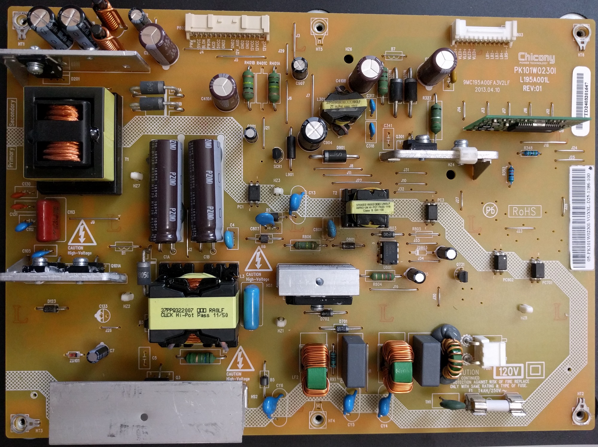

    Are you getting about 400VDC between the two legs of either one of the main filter caps C1A, or C1B when PWON signal is present?

      363 volts on each of the big caps as soon as I plug the power cord in. It fluctuates a little when I press the power button, it changed so fast it was hard to catch the number though.
        Re: Toshiba 58L4300U won't power on
        So the PWON (PS-ON) does not change state between <1V and >2.5V when power switch is toggle?
        363V for the PFC Boosted Voltage seems to be on the low side, the boosted Voltage will only present when POWON is present, when TV is off the DCV on the caps should then be around 160~170VDC.

            You can disconnect the cable between the power supply and the main board first, then use 1K 1/4W or larger between the POWON pin and the 5VSTBY (5VCC) pin to force on the power supply and see if the 12VDC will stay on.
            If not, try disconnecting the LED backlights connector to see if the 12V will stay on.

              OK, I disconnected the main board and use a 1K resistor to trigger the power supply. With or without the LEDs connected to the power supply, I get about 1.8 volts from the 12 volt output when I first trigger the power supply on, but it drops pretty quickly down until it gets close to zero.
                OK, so you do have problem in the 12V power supply section.
                Can you check the DCV between the two legs of either caps C210A, or c210B to see if the Voltage is present and then drops down too (those two caps are the filter cap for the LED backlights power supply section).
                T1 power transformer is used to generated the 12Vs and the Voltage for the LED power supply.

                  At those caps I get about 1.8 volts when first switched on, then it quickly drops to almost nothing.
                    As expected because they are all generated by the same power transformer.
                    So now we have to dig deeper in that section of the circuit, not going to be easy without the diagram.

                                Check the resistance on the secondary 12V pin to the GND pin. Is there any short? If so look at D201 if the center pin is shorted to any of the 2 outside pins...
                                • Nexus1966
                                  • Jun 2016
                                  • 37
                                  I started just testing random components and found what looked to be a shorted diode.
                                  D301A or D301B (they are in parallel) - a google search of the part number brought me to this: http://www.vishay.com/diodes/list/product-89144/
                                  According to that page it is a schottky diode. I got an analog multimeter to test them with the instructions I found here: http://www.electronicrepairguide.com...tky-diode.html
                                  One of them appears to test good, the other one is shorted both ways.
