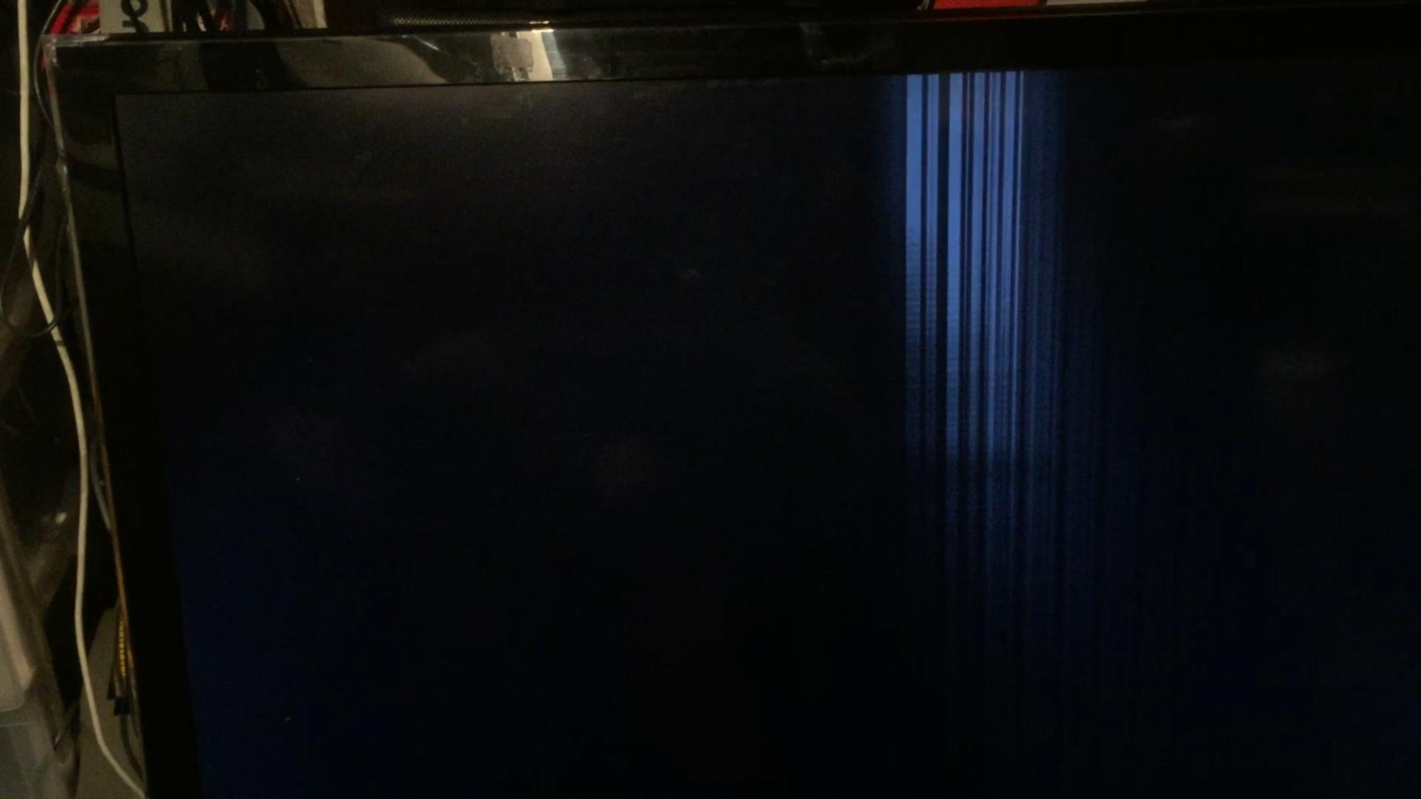

    Sorry not Plasma LED edge backlit
    This is supposed to be the LG NO SIGNAL picture but its just scrolling lines, at first I naturally assumed panel fault ,but there is this niggling doubt in the back of my mind.....
    when I unplug the Tcon from the main board its just a plain normal backlit picture (obviousley) so does anyone else thinks its Panel ?

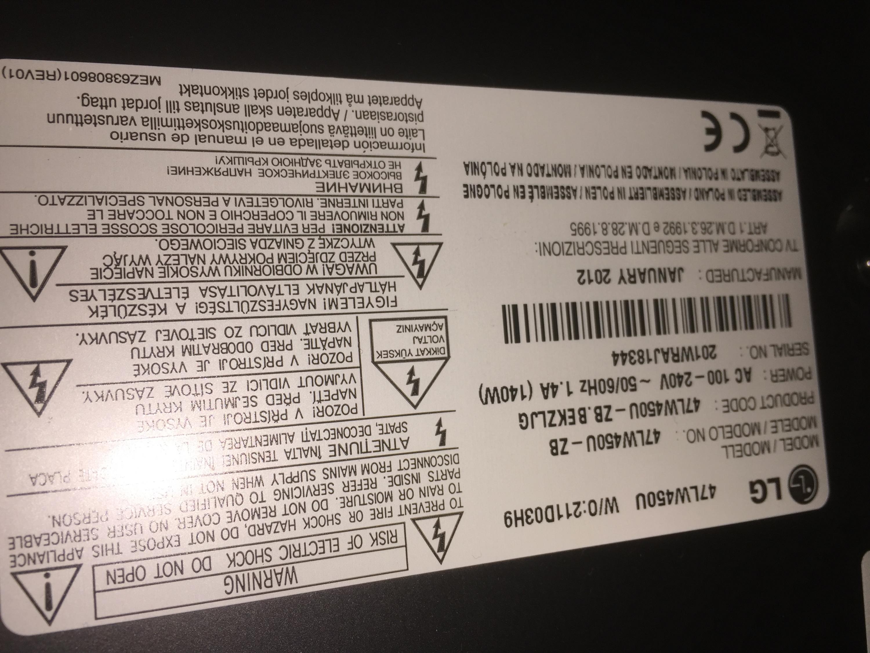

    model attached

      If you unhook one of the Tcon ribbons to the panel and see if you get a clear picture then reconnect and repeat for the second ribbon.
      Edit.
      How many ribbons from the Tcon to the panel does it have. Googling appears to show 2 Tcon boards. One with 2 ribbons and one with a single ribbon to the panel.

        Mate you even said it yourself the panel is toast.
