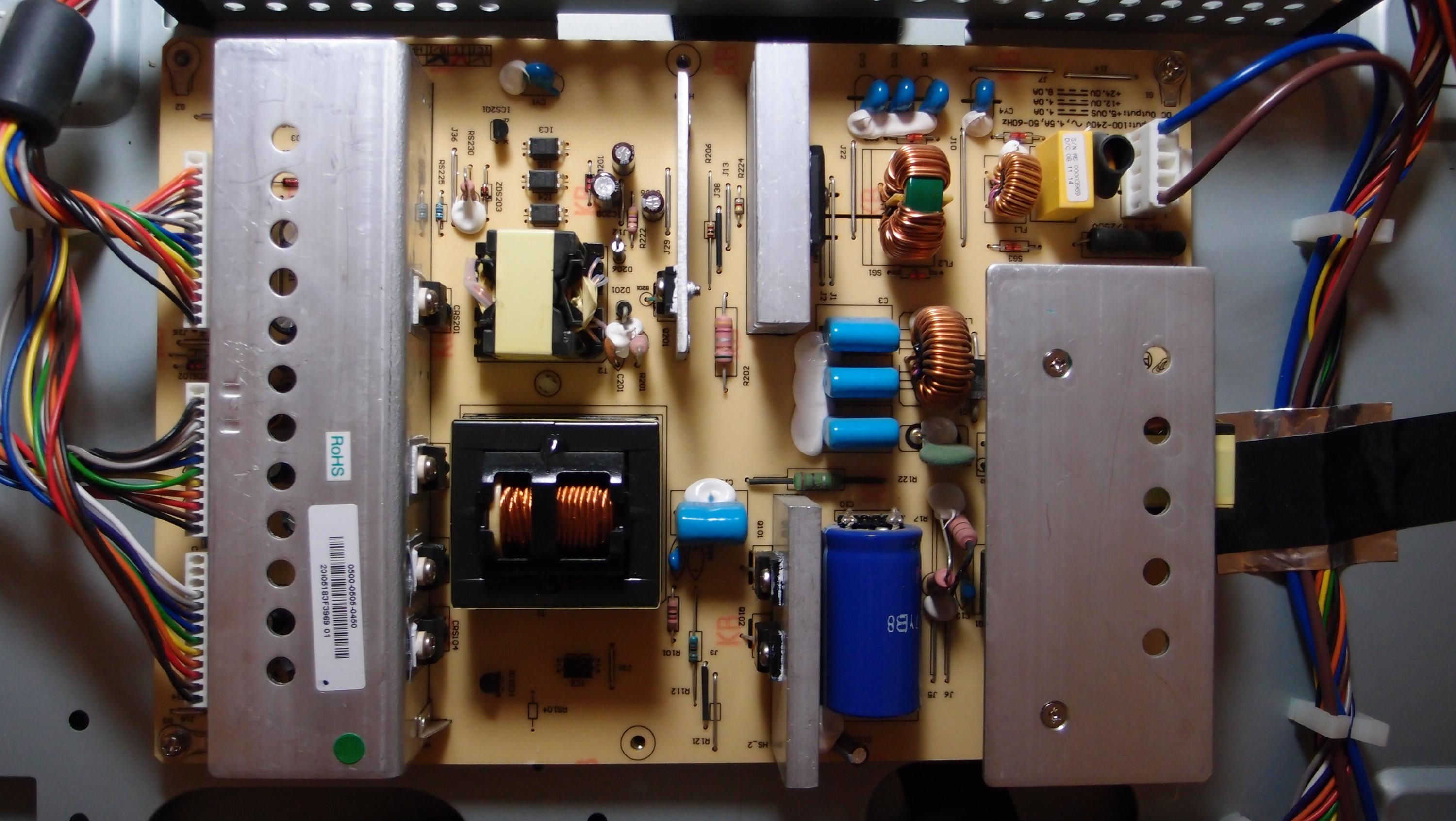

            Re: VO42L Turns OFF After a Few Minutes...
            Power Board is FSP-254-3M01
            Motherboard is 0171-2272-2604
            Power readings to MB:
            TV on Standby: VIZIO Logo is Orange
            +5V is on, all other voltages are zero.
            TV is ON: VIZIO Logo is White
            B1: 5.08V
            A1: 3.35V
            5V SB: 5.22V
            12V: 12.29V
            PSON: 2.7V
            Voltages After Cut Off:
            All voltages zero and VIZIO light is off.
            24.2V to inverter boards when on, zero when off.
            With a DVD player connected to HDMI, seems to die within a few minutes. Without one connected, lasts alot longer, sometimes does not cut off at all.
            395V at the large filter cap.
            All caps on PS and MB pass the eye test, all flat tops.
            The toroid near the 3 blue film caps is buzzing (or something else nearby).

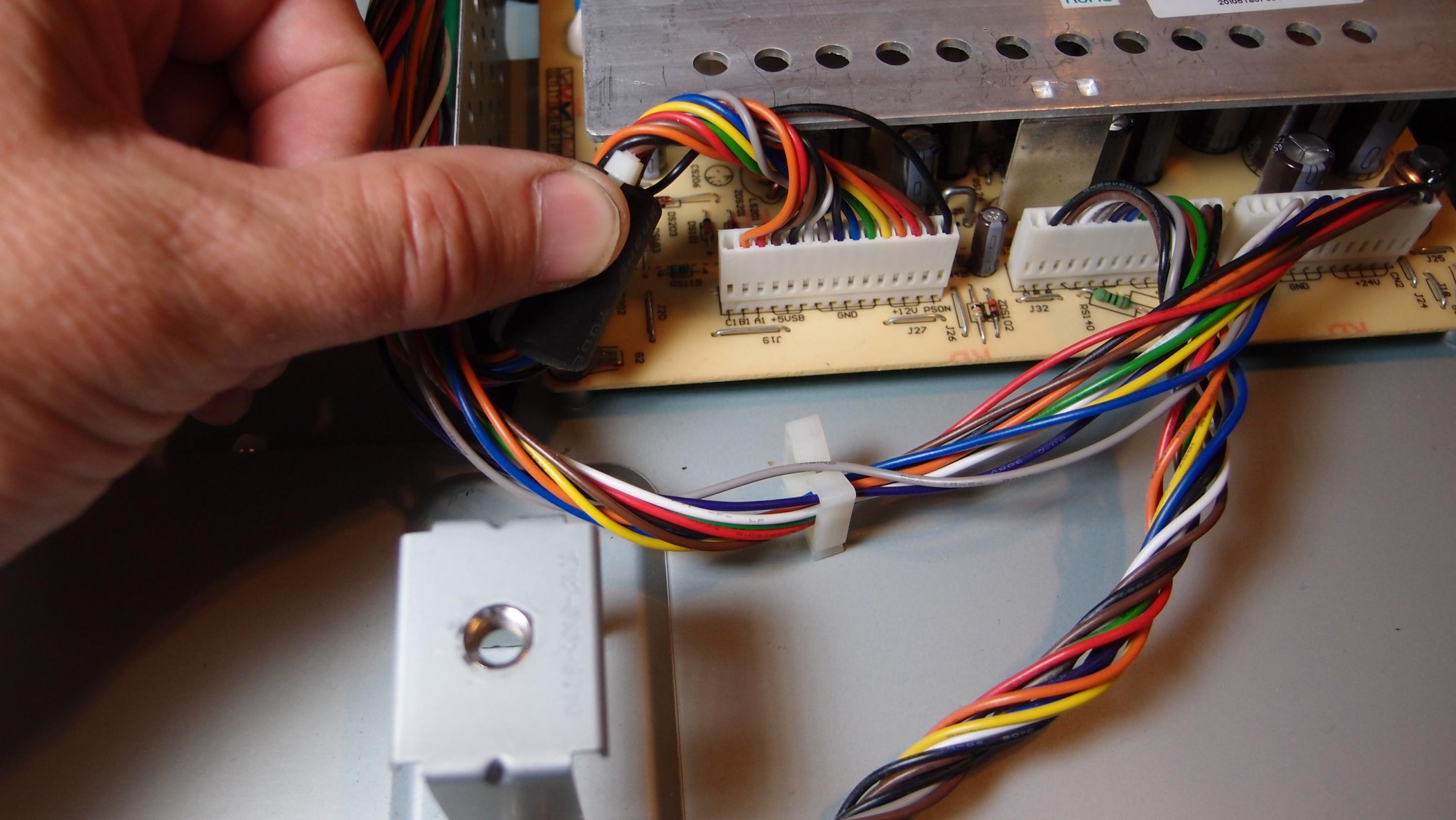

              Is the one capacitor behind the connector (PS_On) under the heatsink domed or is it just the photo?
              • smata67
                • May 2006
                • 14
                Unfortunately, it is flat.
                  So I have a mainboard on order and am also going to go ahead and do some preventative work on the ps board. There are vendors on Ebay with "kits" for the FSP-254-3M01. Does anyone know what components are in these kits? I would rather source directly from mouser than get generics, but I will if I have to.
