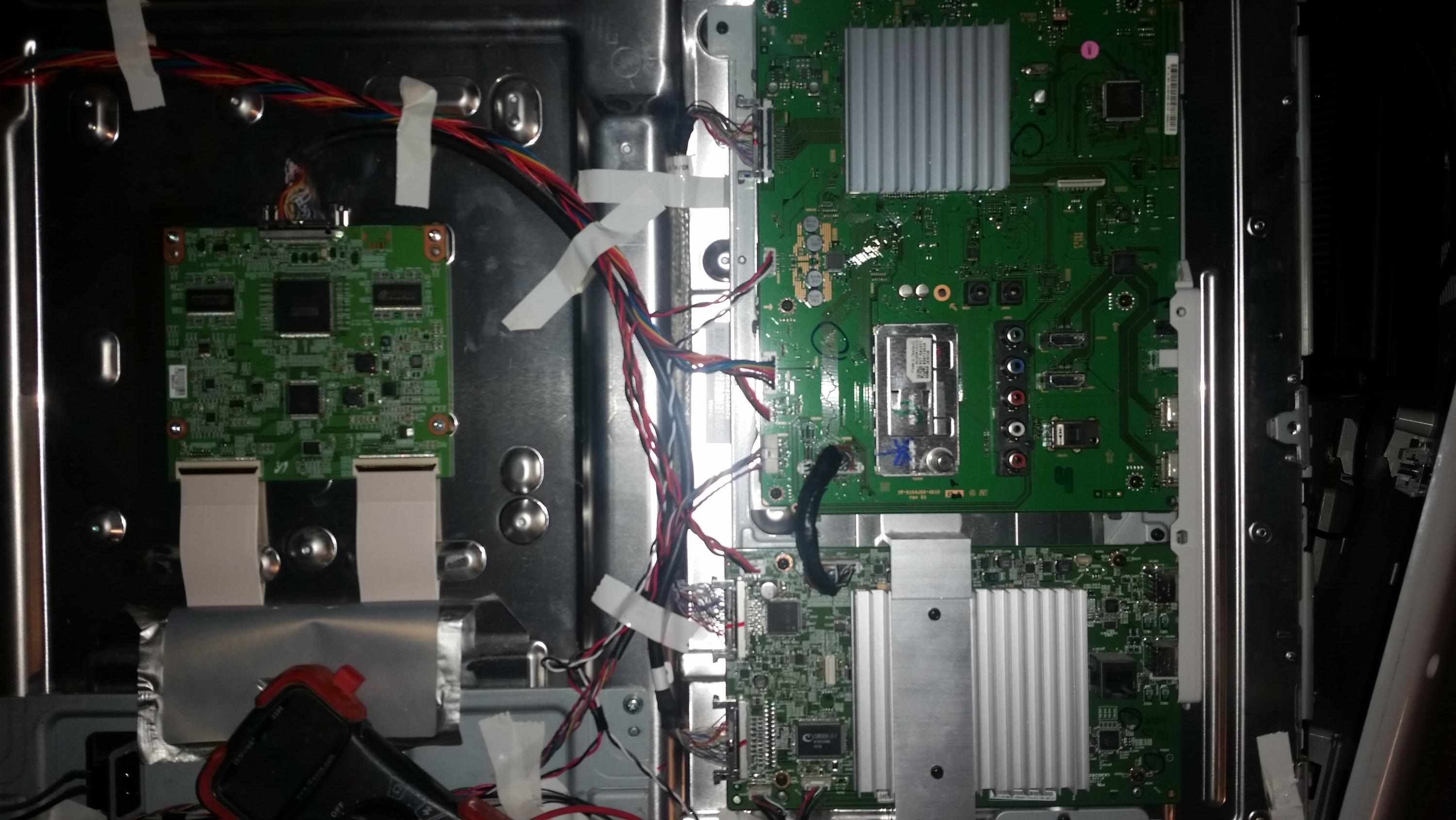

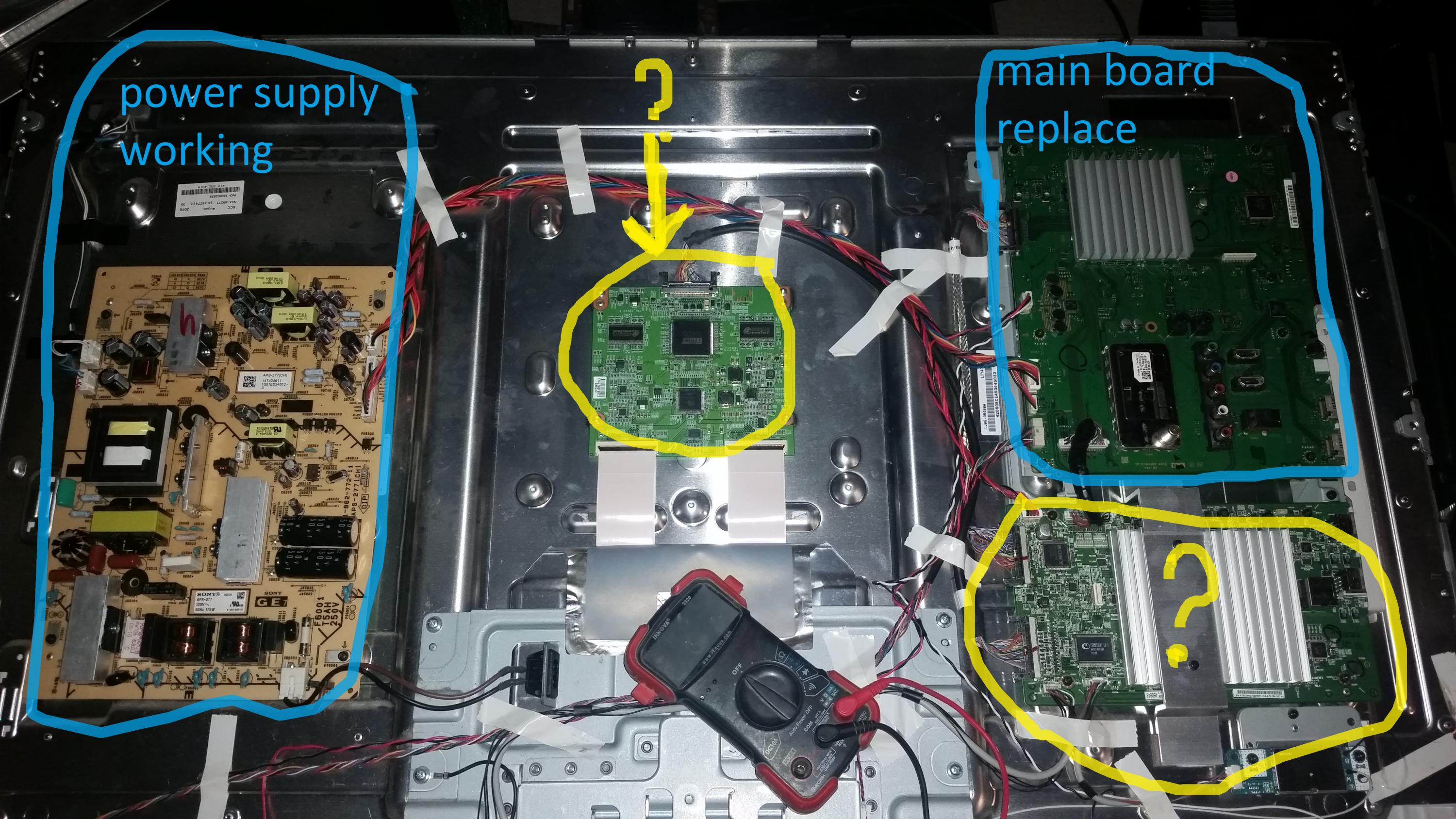

    i have this sony tv nsx-40gt1 i replace the main board, and now it does turn on. before i did change this board it didnt power on just red blinking ligth. now that it works back light comes on, but no picture. this tv has 3 boards one with the tuner, i replace and the others are for internet and t-con

      when i turn on the TV back light comes on and the after a sec it blinks green and orange it has 3 led light and those 2 only blink green and orange at the same time. green is power and the orange is it timer picture off

        That board in the middle is the Tcon board. Make sure the fuse on the TCon is good and there is power going to it. You can verify the signals on the LVDS with an oscilloscope, whilst turning on and off the menu all the time and probing the LVDS pins.
        Also we need voltage measurements of the PSU (ribbon cable that goes to the main board) with the TV on and off, to see what is really happening.

          12.5v on fuse. On t con

            So Tcon has power, what about the rest?

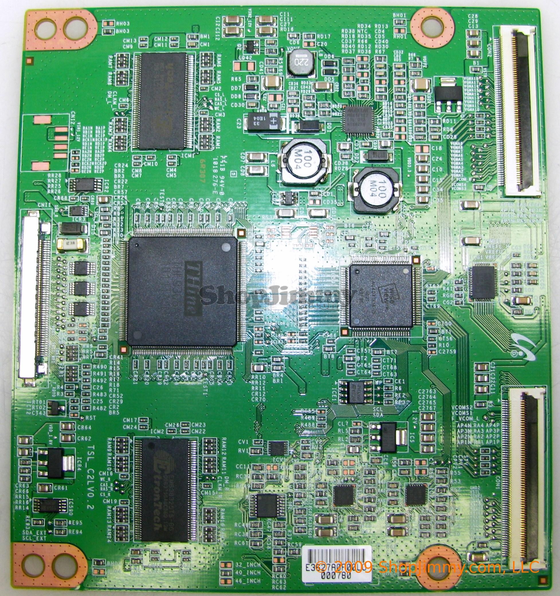

              There are 3-pin Voltage regulators such as IC5, ICR4 which has Voltage test points next to them telling you what the DCV should be, there are also other DCV test points on the boards as well, such as VCOMS1, 2, VGMAxx, VDD3.3, etc. so look at the board really well.
              Sony 1-857-792-11 (TSL_C2LV0.2) T-Con Board for NSX-40GT1
              http://www.shopjimmy.com/sony-1-857-...-con-board.htm
              Picture provided by shopjimmy.
              BTW, 12VDC at both ends of the fuse with ref to GND?
