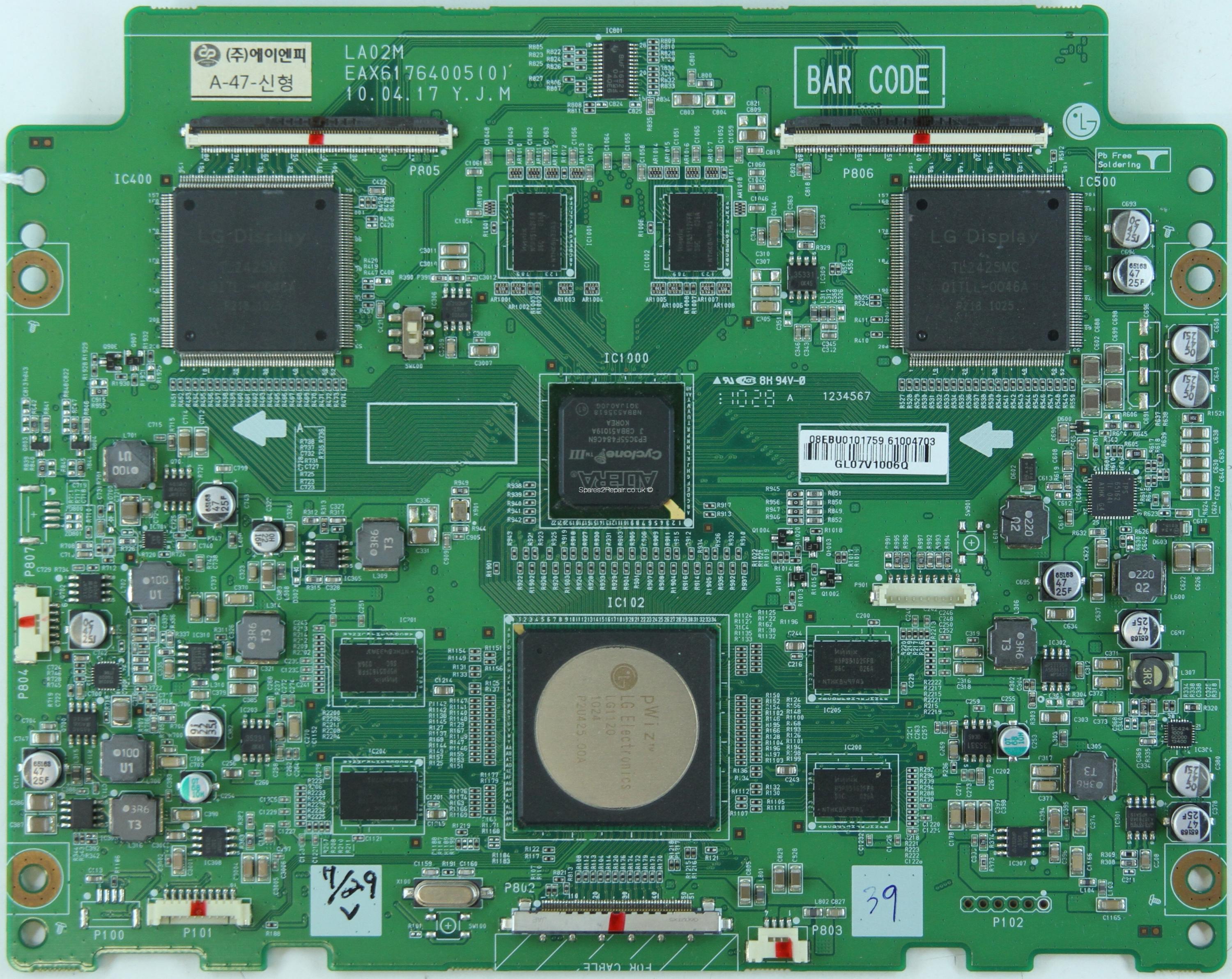

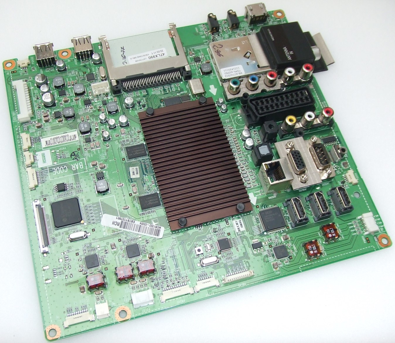

    Hi I have LG47LX9900. Accidentally it stops with some short circuit sound. I disconnect it from main power and restart again after 10 minutes. Tv was turning on and respond on remote signals but there is no audio, no video and no back light from it. I asked local technician too see these problem. He said that I have to replace Main AV Board. So I bought new AV Board from Ebay.co.uk. And after replacing the new board I still not have audio and video from LED. So I again contact my technician for this issue now he said that the next step for this problem is to replace T-con board. So I bought new one from Spares2Repair.co.uk. Now I replace the T-con board and turn the tv on with LVDS cable connect only T-con side (I accidentally broke LVDS pins so I reset all pins) . After 2 time restarting the tv in morning I got back backlight and display in half screen size with verticle bars and half side completely black. All led light strips working fine. But at evening I try again to power on the screen but again no audio, no video, no backlight. I try all way but nothing happen. TV respond on remote signals, gives clicking sound on startup but without audio video.

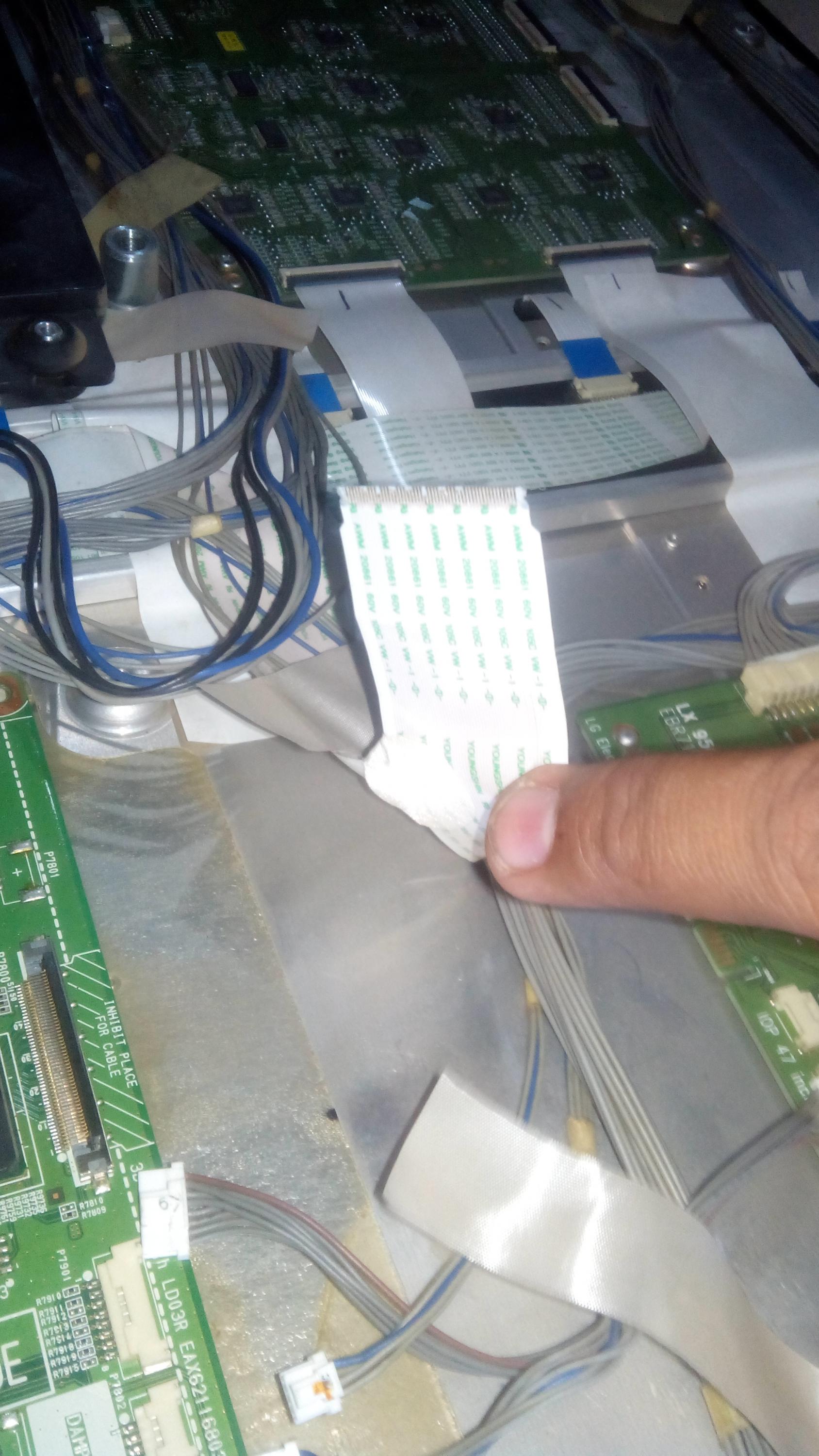

    Can you provide a picture of what was broken?

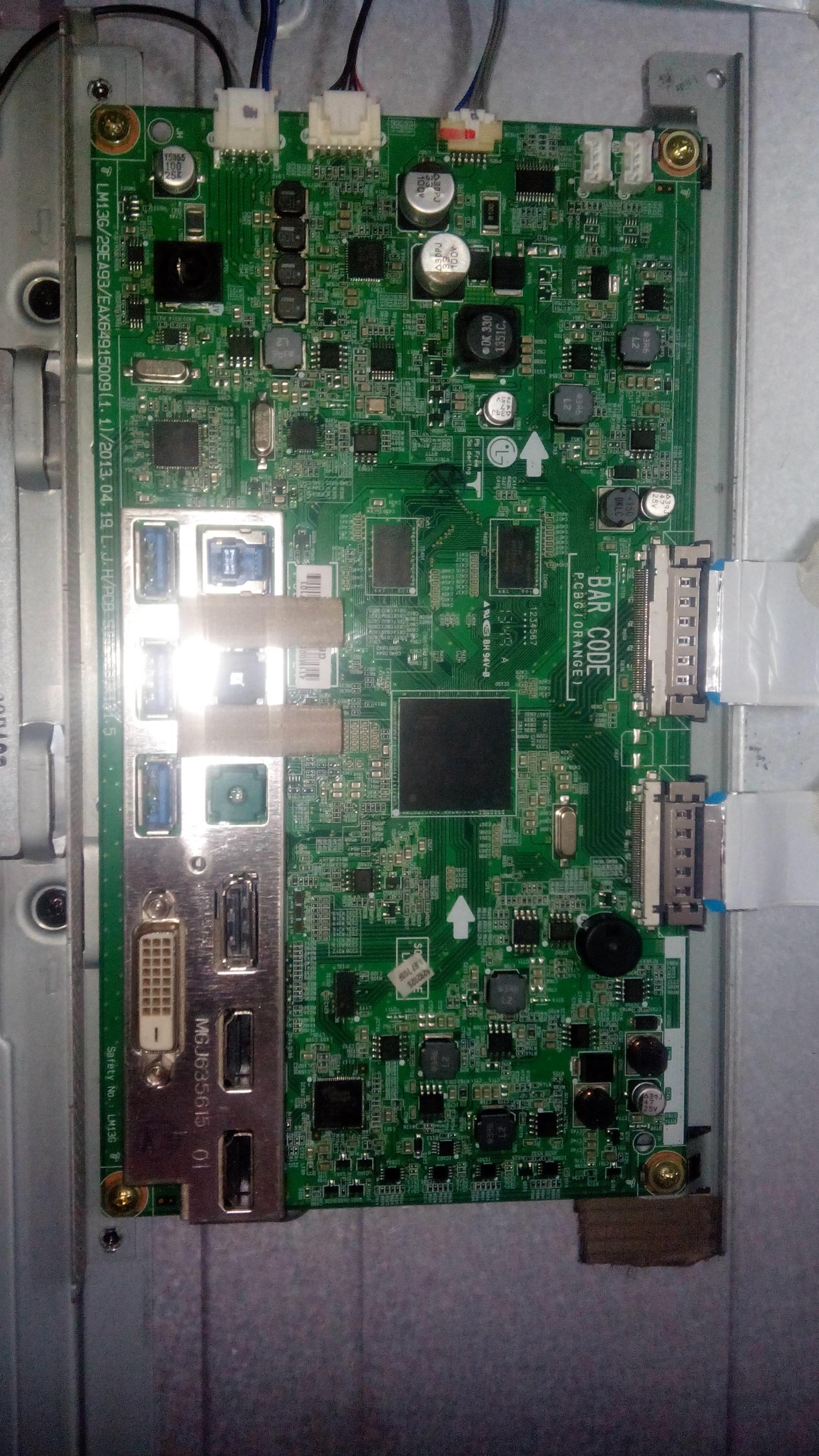

      Pic no.4 shows damaged pins of LVDS cable..I searched for LVDS cable but not found in local market so i cut down the broken lvds cable and trim it and make new pins. after attaching this new modified cable i still not got display. But after removing the cable from Mainboard side I got backlight and display in half left side with half dark black right side. So i thought i will look after this at evening. but at evening when i turn on the tv like in morning but surprisingly i didnt got audio, video and backlight.

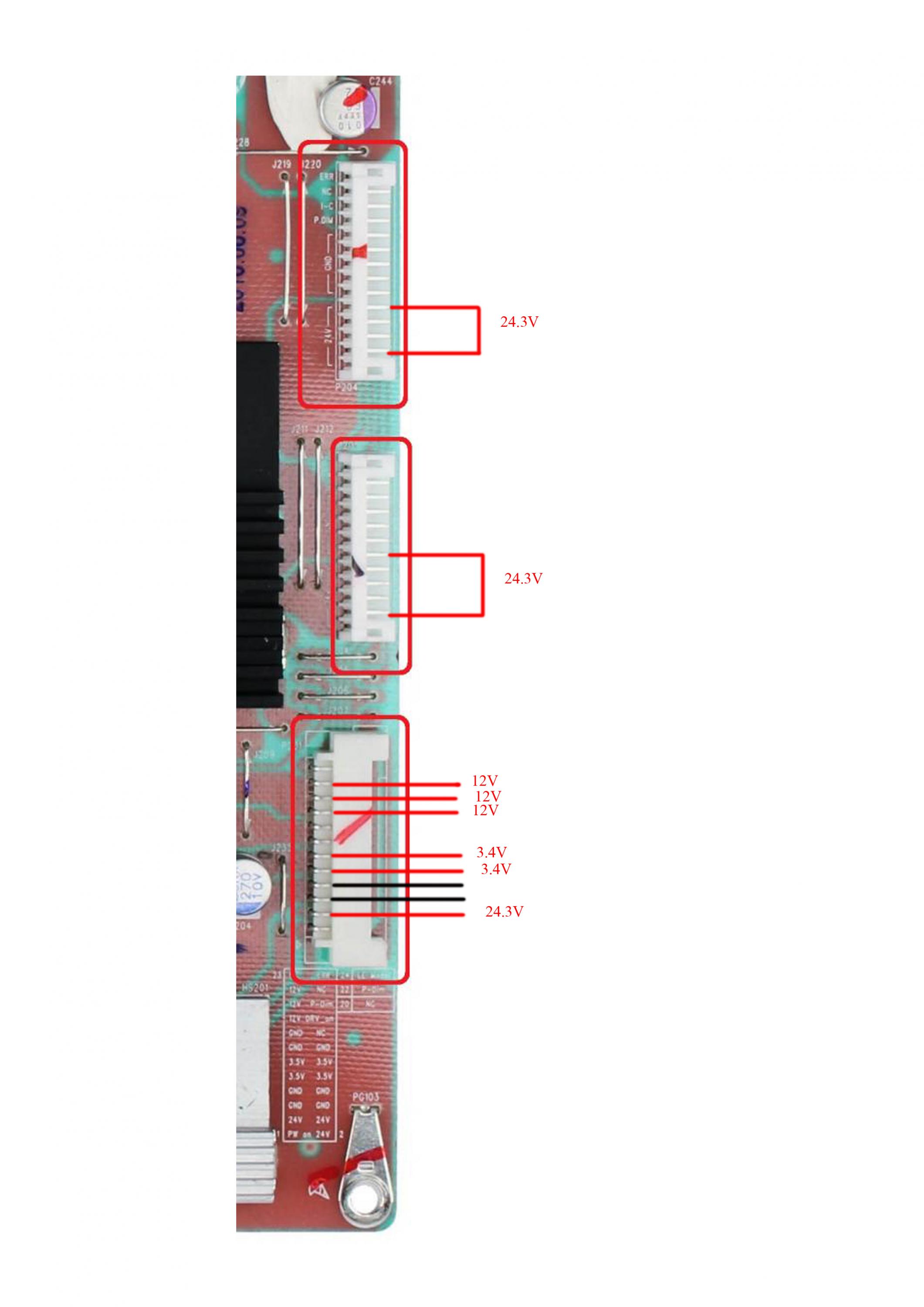

                1 question arise here..
                If I unplugged the power strip from AVBoard tv doesn't power on.
                So I read the voltage with tv on and I got 24.3 instead of 24v, and 3.4v instead of 3.5v, 12v pins give me perfect 12v output.

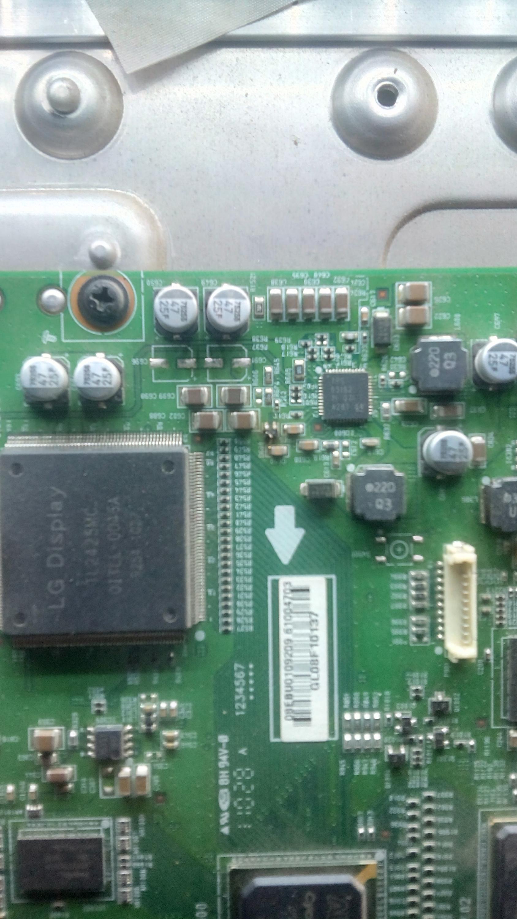

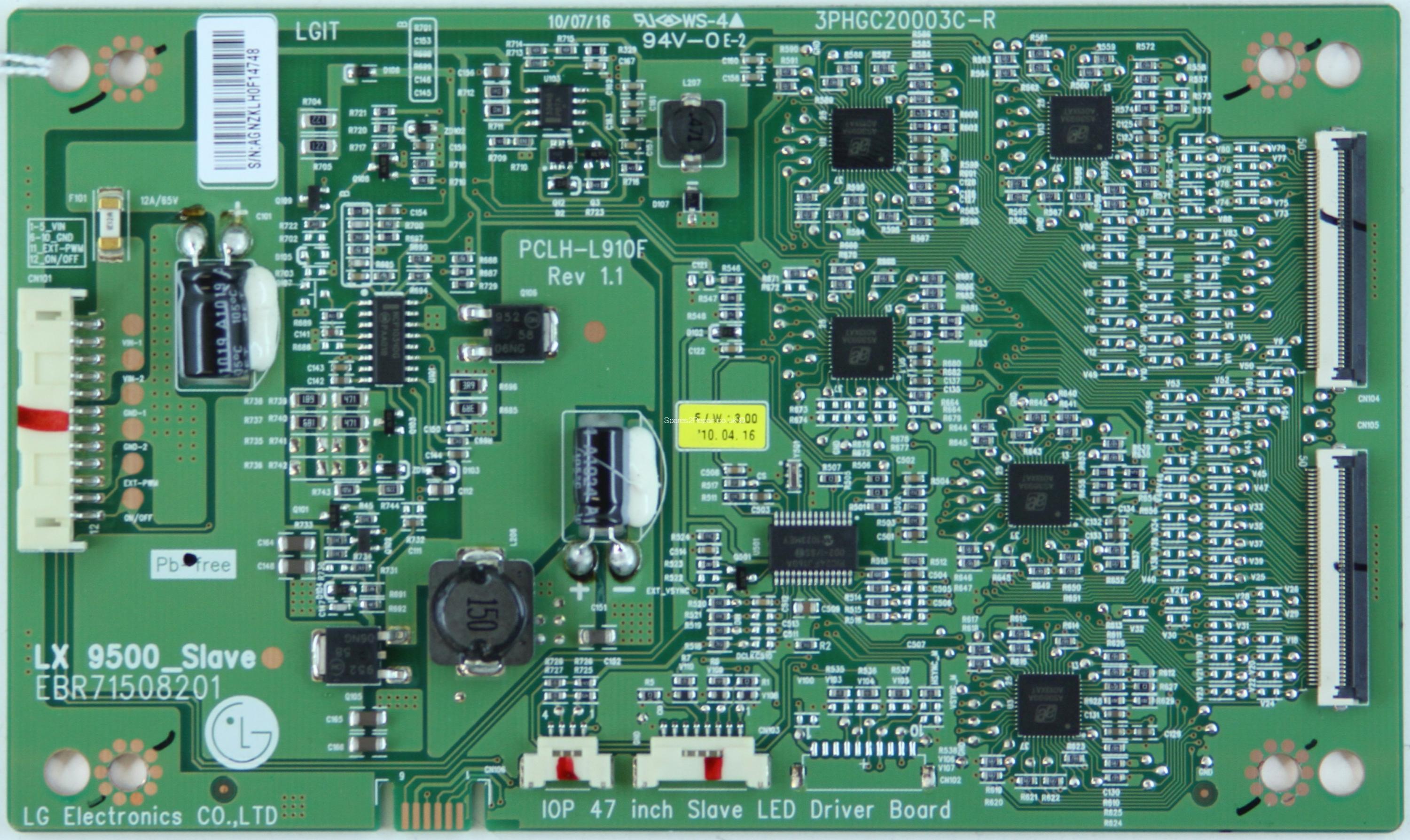

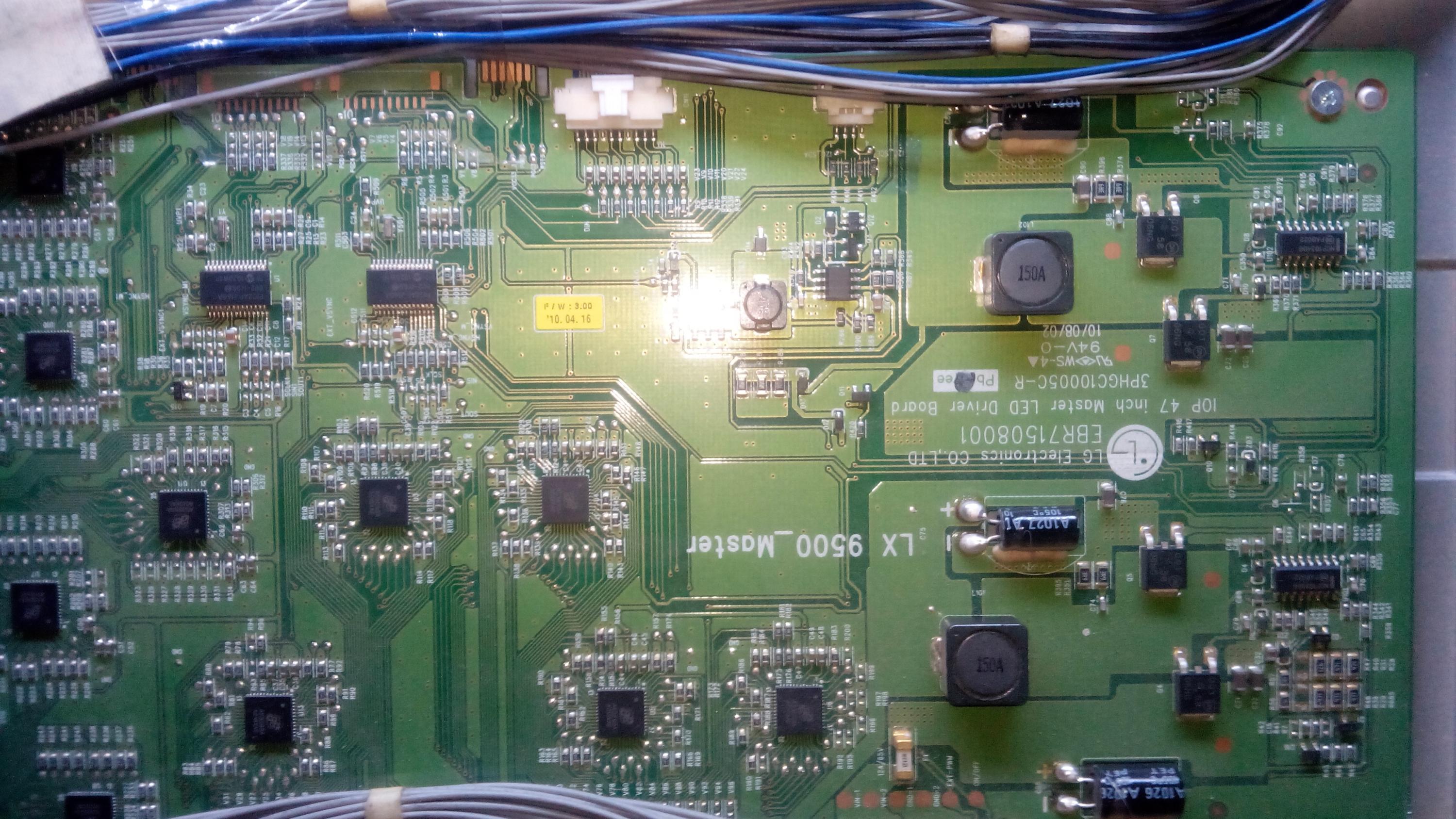

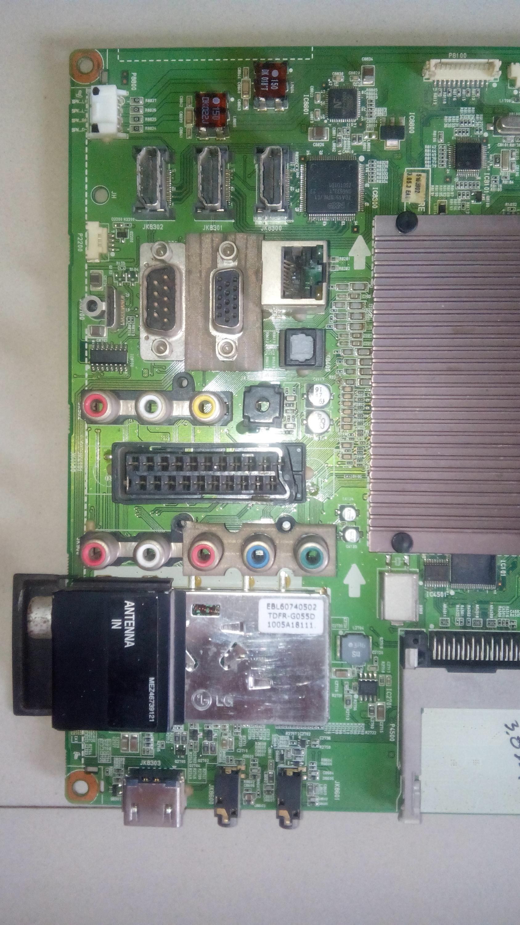

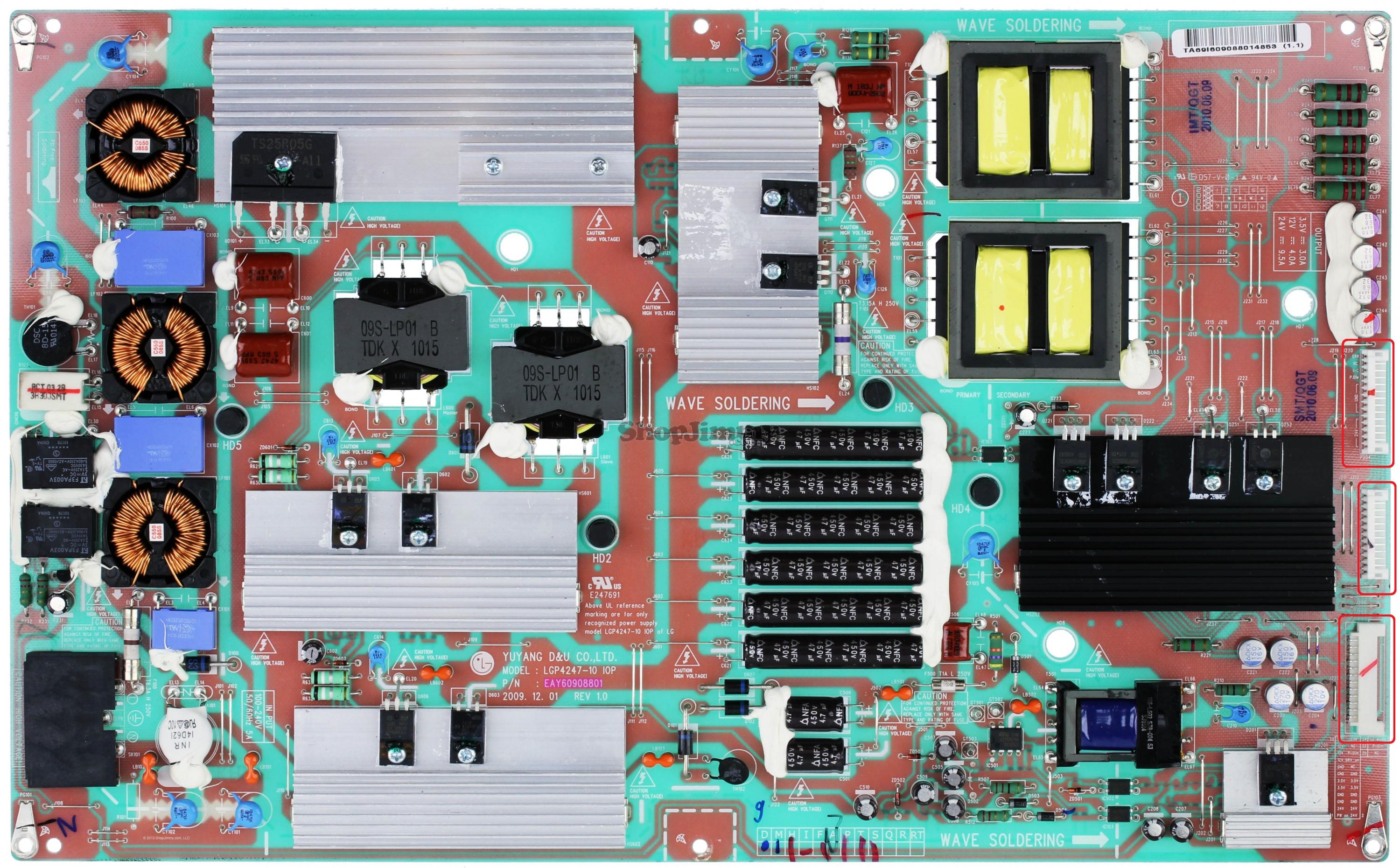

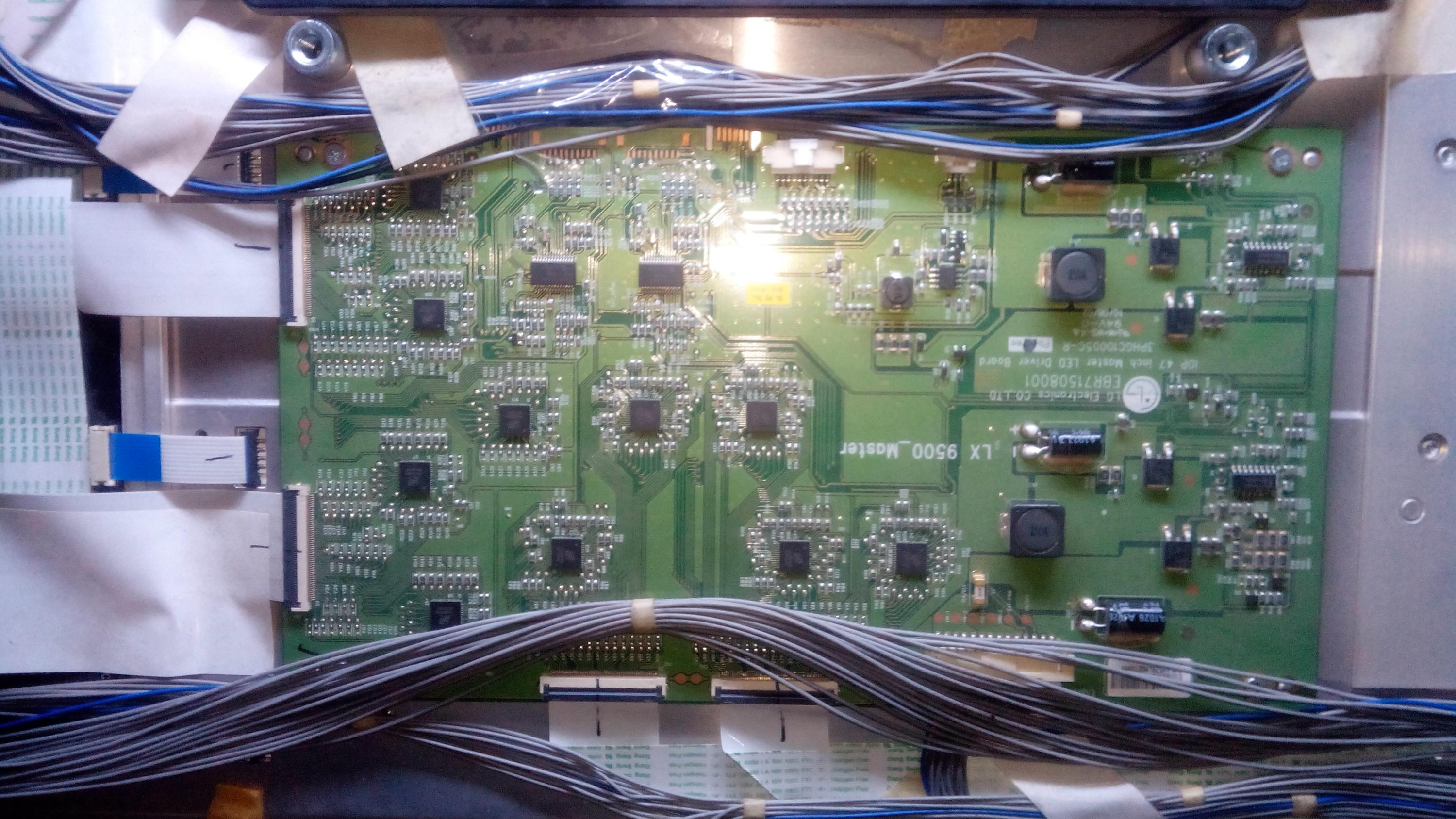

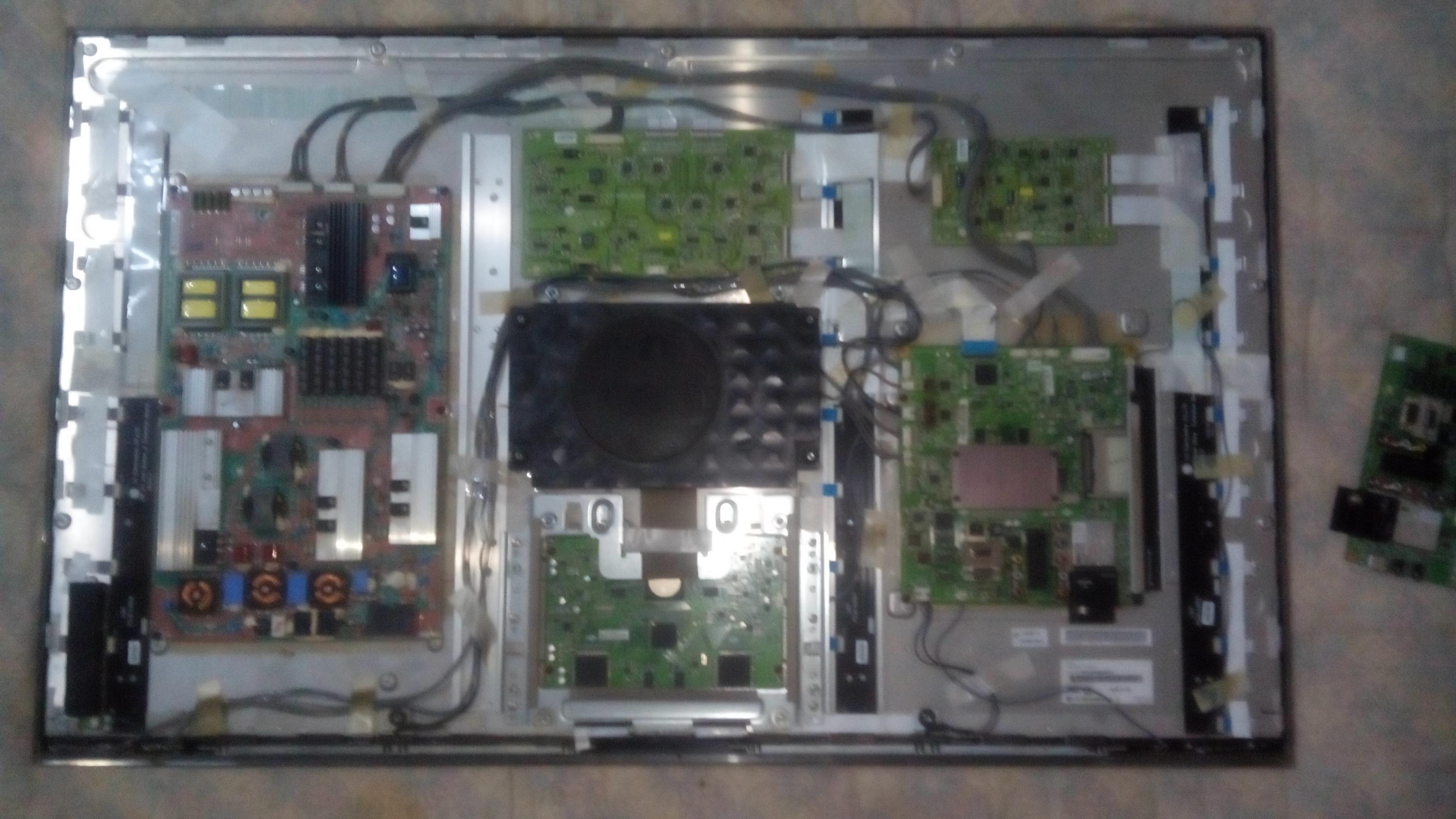

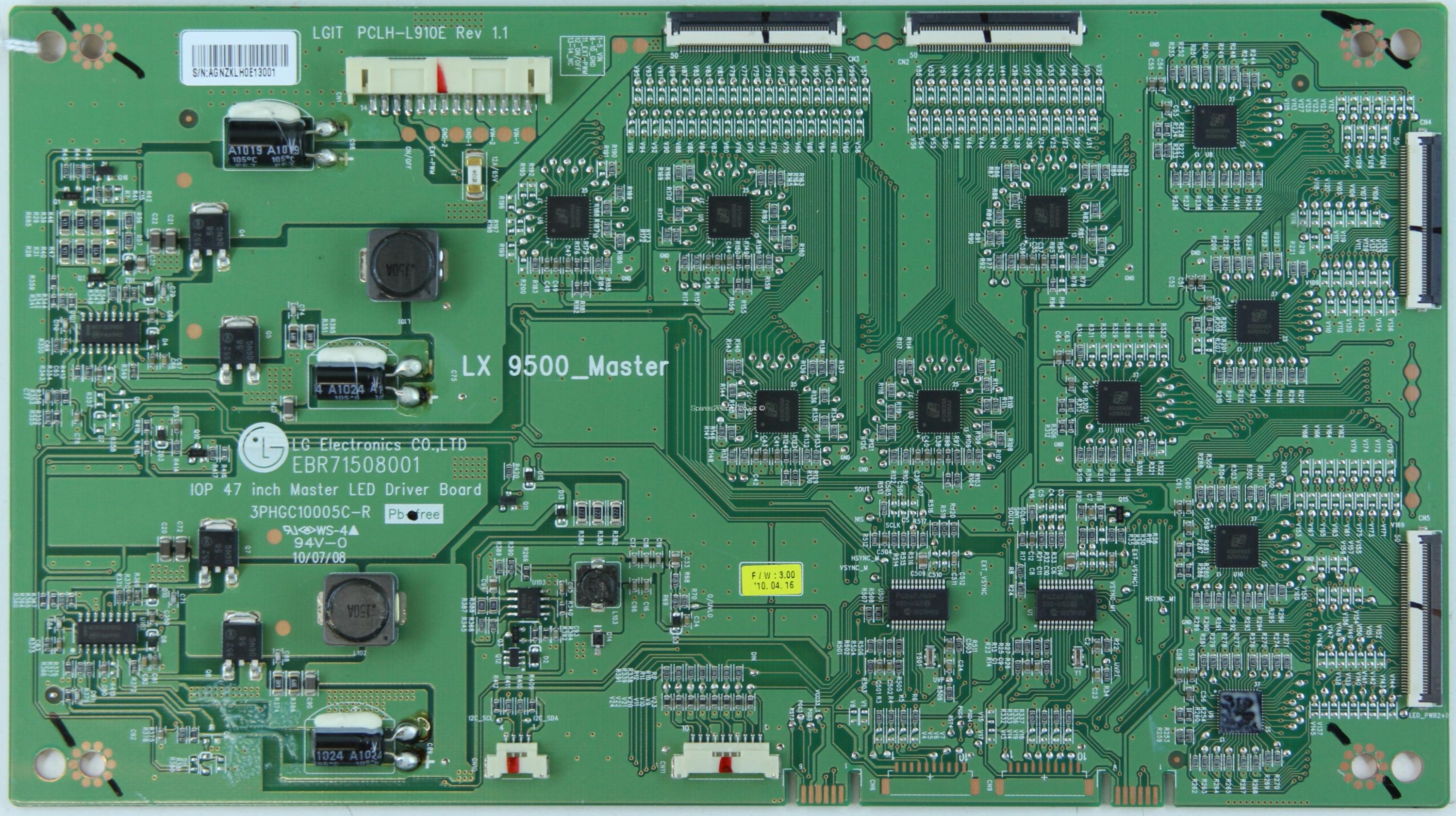

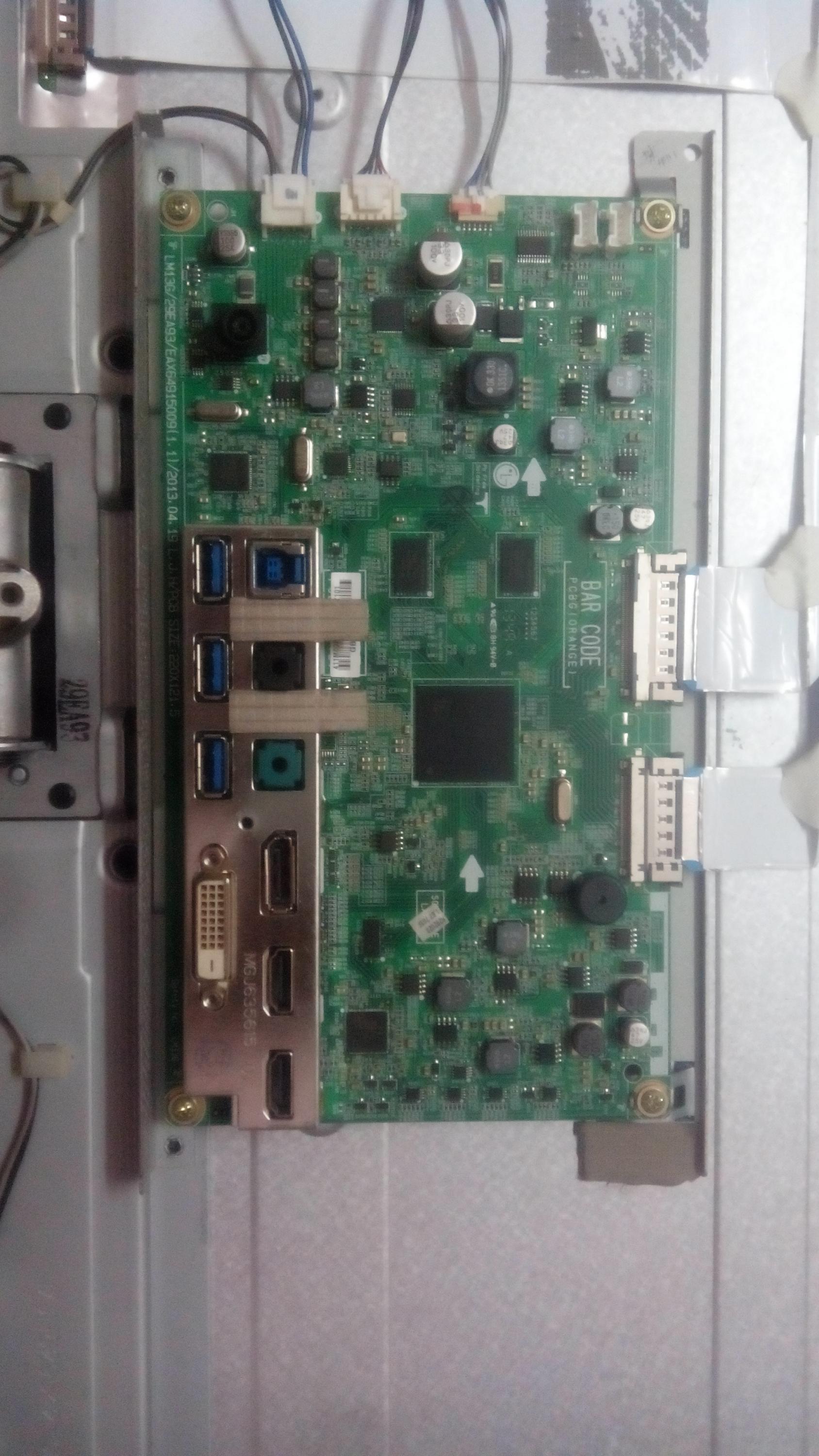

                  These are few pics of Board of PSU, T-Con, Main A/V, Master LED Driver, Slave LED Driver....
                    Re: No audio no video no backlight on LG47LX9900

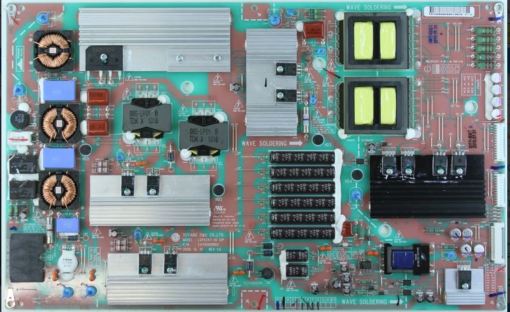

                    Hello Ashish,
                    You have to help us help you. The picture of the power supply board is to small to work out what the voltages on the connectors should be.
                    You need to power up the set and give the voltage reading when in standby and when switching out of standby so that people here have an idea of what may be wrong.
                    I have attached a similar power supply picture and you need to give the voltages at the pins shown in the red boxes and list them as requested in post #5
                    Photo courtsey of Shopjimmy

                      I would also try to get a replacement LVDS cable as you have had to modify the contact ends this maybe causing issues so to rule it out change it if you can.

                          I bought another used good condition cable from local market but still no progress

                            I agree with you sir..as per all red box where they say 24V I got 24.3, and where they say 3.5V I got 3.4V, and where they say 12V I got perfect 12V. I measured this value with power on the TV. Now I will try to read the output again on standby mode. But i have one query that how can i read voltage from all 24pins? Because If I unplugged the connector TV not start.

                                Quite sure the 12v runs all the time here and the Mb switches the 3.4 pv for the Led driver. Possibly Mb issue.

                                  First if I look at the power supply circuit I posted above it says
                                  Connector P304
                                  Pin1 = Err
                                  Pin 2 = NC
                                  Pin 3 = I-C
                                  Pin 4 = PDM
                                  Pin 5, 6, 7, 8, 9 = GND
                                  PIn 10, 11, 12, 13, 14 = 24V
                                  So where are the readings for Pin1, 3 & 4 just as an example.
                                  If the only way to read the voltages on the connector is to turn the board upside down carefully then that's one way. Or you may be able to use a thin piece of wire pushed into the connector alongside the existing wire.

                                    The power supply is OK otherwise you will not get the switched 12V and the switched 24V.
                                        Connector P304
                                        Pin1 = Err
                                        Pin 2 = NC
                                        Pin 3 = I-C
                                        Pin 4 = PDM
                                        Sir whats the functionality of Pin 1=Error, 2=NC, 3=I-C, 4=PDM?
                                        As per my reading with tv standby mode I got only 3.4v, 24v & 12v line shows 0v.
                                        And after switched on the tv I got 3.4v, 24.3, and 12v.
