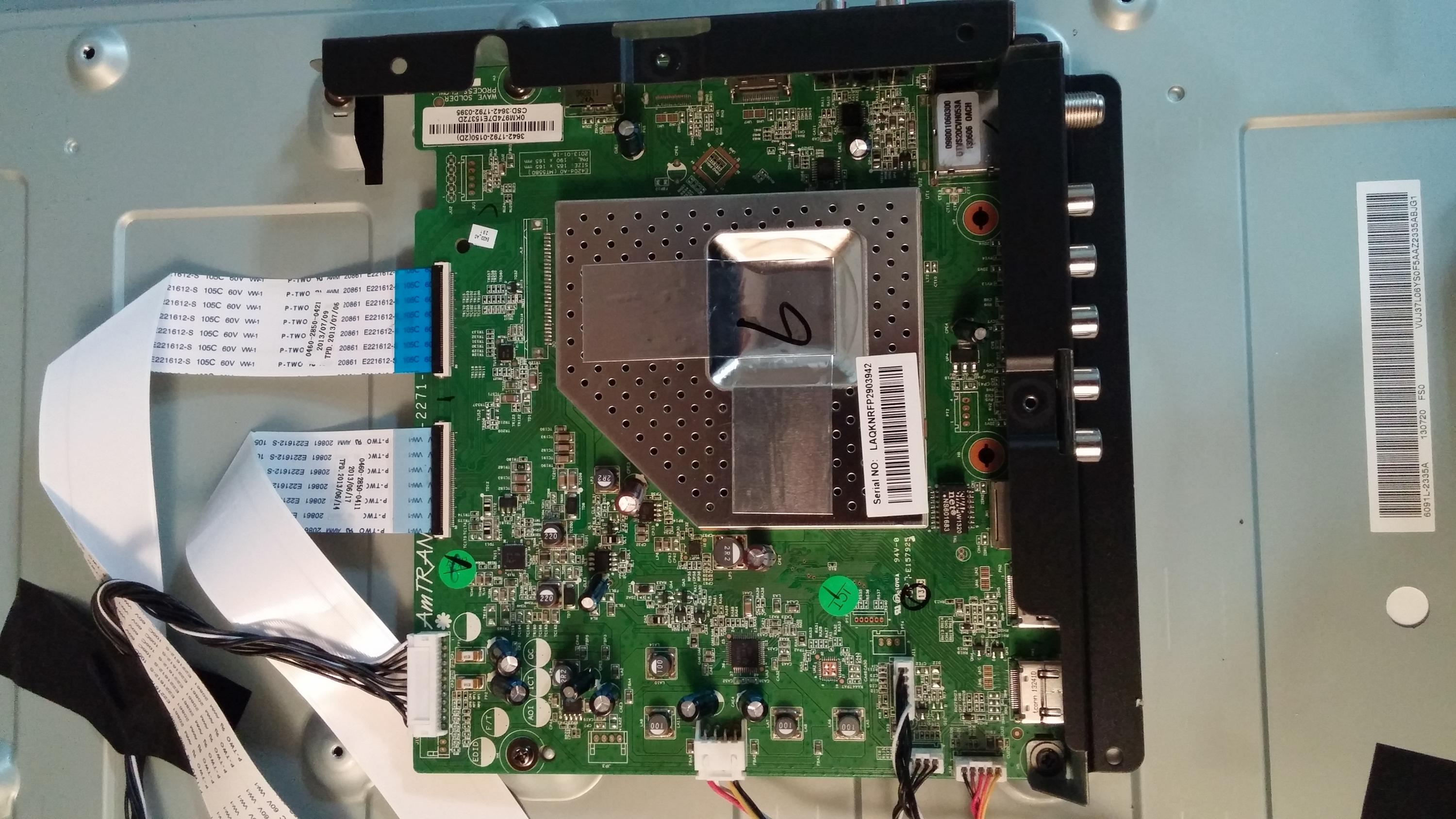

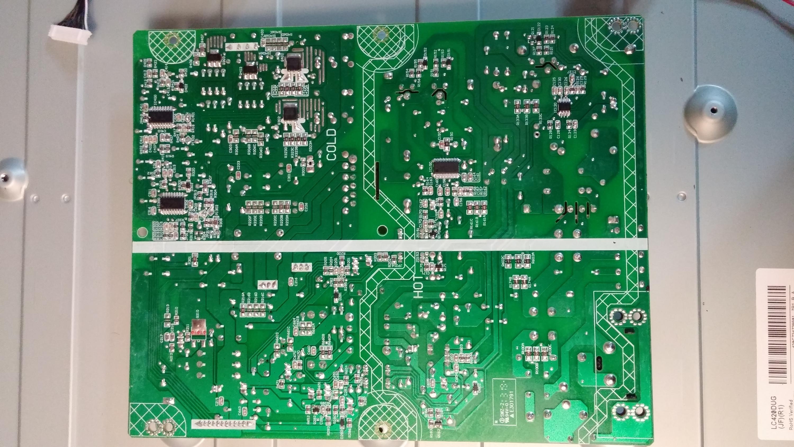

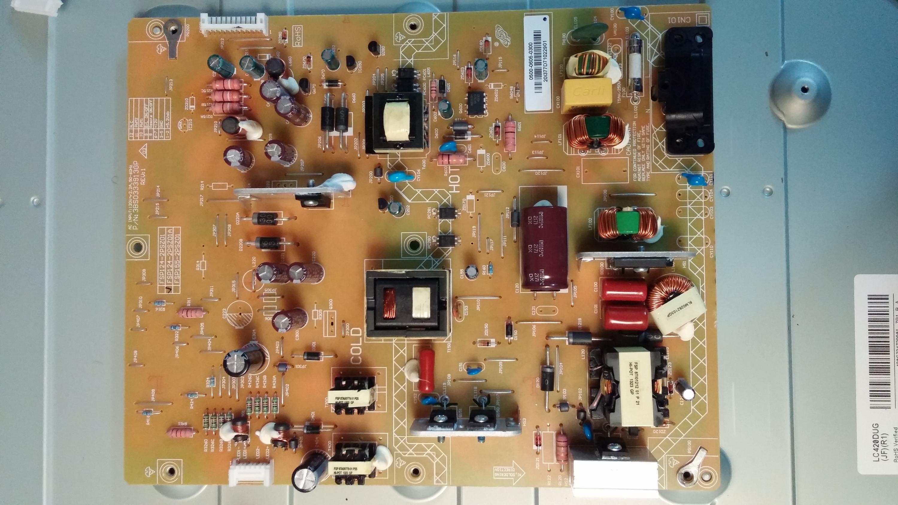

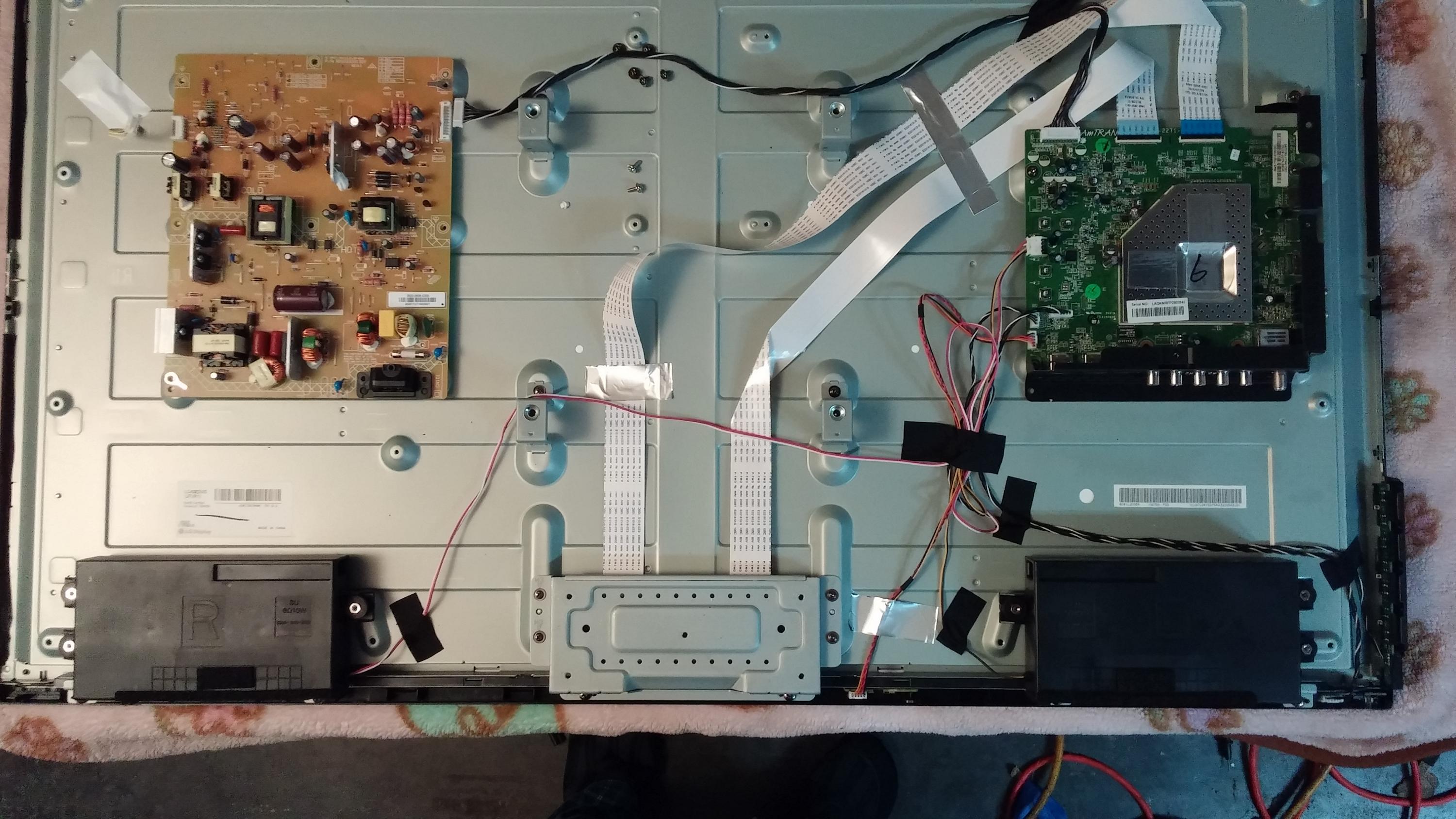

    We need good clear well focused pictures of the whole back side of the TV so we can see all the boards and how they are connected together, then good pictures of the top/bottom side of this power supply/LED driver board so we can see board P/N and the labels for each connectors, etc.
      Re: Vizio e420i-a0 backlight flashes, then black
      Hope they're clear enough.
        Forgot this one...

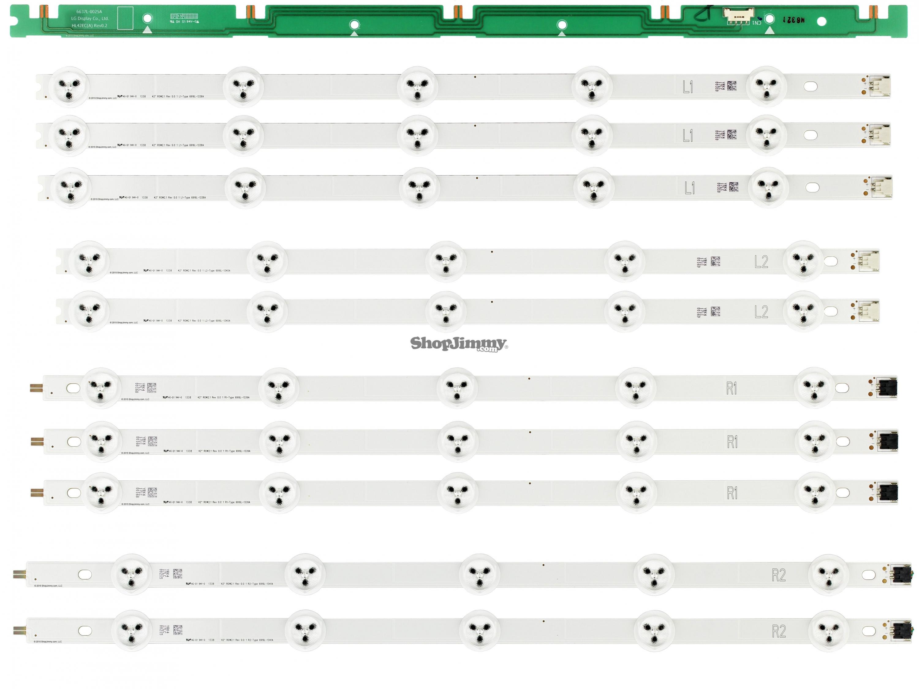

                You LCD panel is LC420DUG as shown in your pictures, according to SJ, it has 10 strips of LEDs, each strip has 5 LEDS, so each string has 25 LEDs.
                http://www.shopjimmy.com/lg-lc420dug...ps-1-board.htm
                Vf for 25 LEDs is series should be about 25 x 3V = 75 V
                Per your readings:
                Total VF of LED string 1 = 129V - 86V = 43V.
                Total VF of LED string 2 = 129V - 72V = 57V.
                It looks to me some of the LEDs are shorted out, the LEDs will still light up but the over current protection will kick in and shutdown the LED boostconverter power supply.
                Pictures provided by shojimmy.

                  So I guess my fix is to replace with a new set of leds?! I've seen guides on testing individual led, and I've replaced them in a set before. Just wanted some confirmation on my own assessment sounding correct. As far as the led strips I can't find them for the e420i, but I see plenty for the e420(without the "i"). I'm assuming that they're most likely the same. They look exactly the same. $16-$20 per single strip.
                    The main key is to match the LCD panel with the LED strip.
                      https://www.badcaps.net/forum/attach...7&d=1463682166
                      LC420DUG JFR1.
                      Contact SJ.
