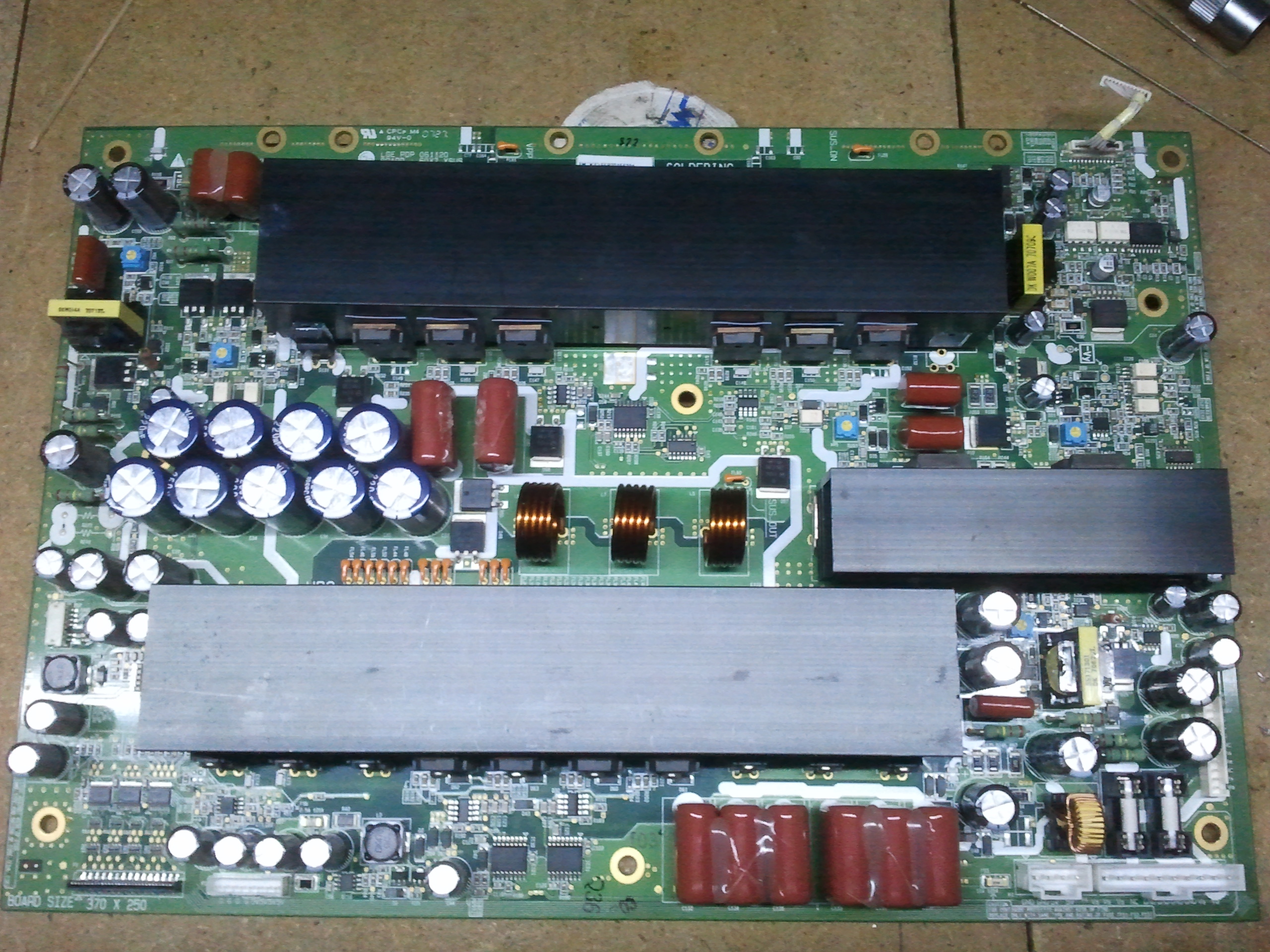

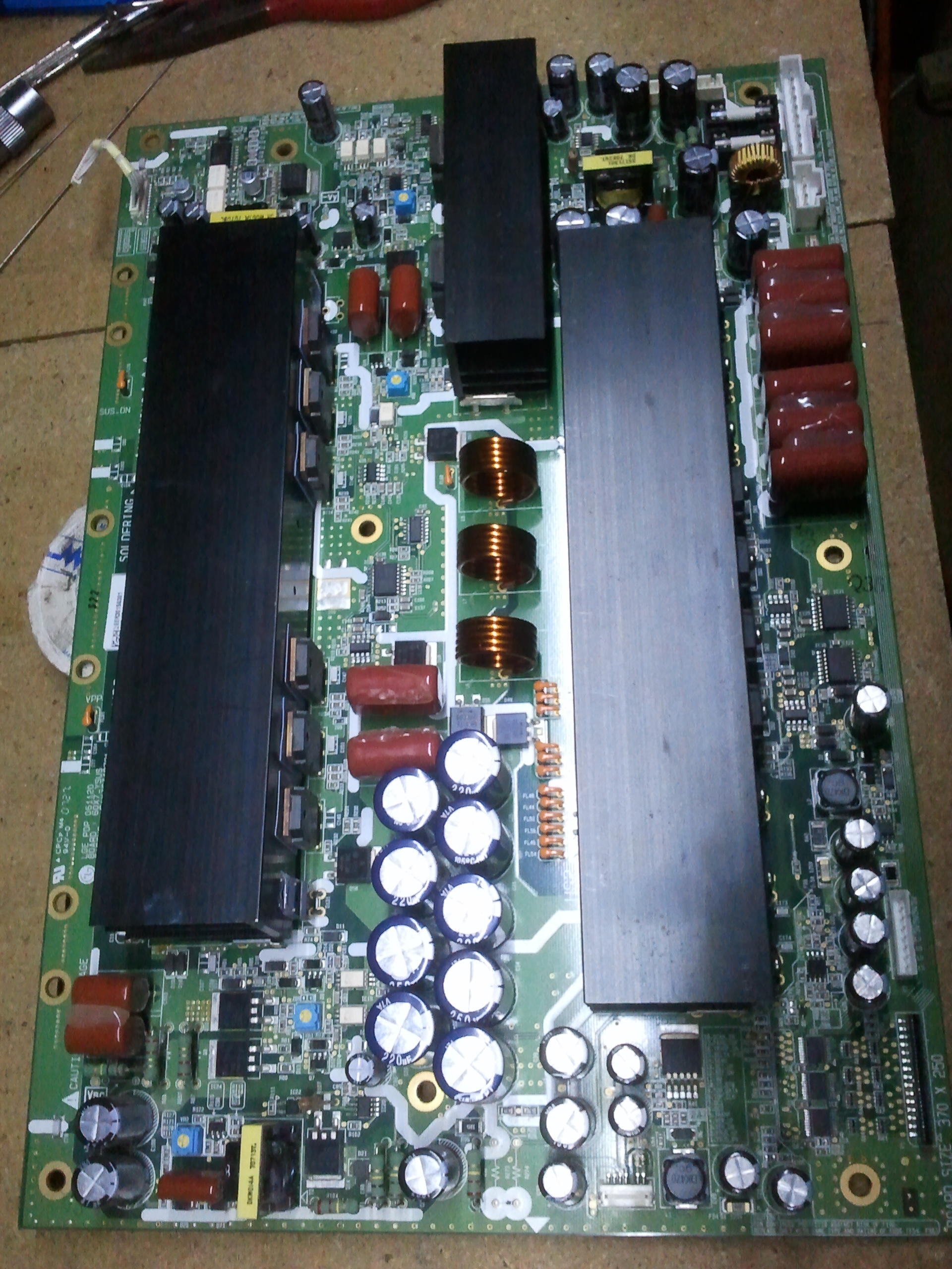

    Hope some one can lead me in the right direction .
    I was given an Lg 60PC1D-AA Plasma tv i was told it had sound put no picture .
    Problem is the Y Sus board , have found Q24 sum45n25 shorted and two resistors that are open R250 and R251 i think they are 1R5 not sure if some one could help me with the resistor numbers it would be great . Have tested all the fuses which are every where and testing all the low ohm resistors . If i have missed any thing it would be much appreciated if you could suggest any thing else that might need to be replaced . Can those resistors be replace with normal resistors ?
    Thankyou
    Regards John

      • wozzie
        • Dec 2014
        • 21
        Re: Lg 60pc1d-aa
        These are pictures of Ysus board . Hope this helps ,ill try and take a picture of the back of the set with out the board .

          Re: Lg 60pc1d-aa
          The IPM module's are under heatsinks and may have legends alongside. Can you measure the resistance from any of the supply pins given on them ( maybe 5v, 15V, Vs) to ground to see if you have a short circuit.
          You could also check the Mosfets and see if there is a short between any of the 3 pins.

            Re: Lg 60pc1d-aa
            Wozzie's Y-SUS Doesnt Have IPM's....
            --Its the slightly later, discrete type...
