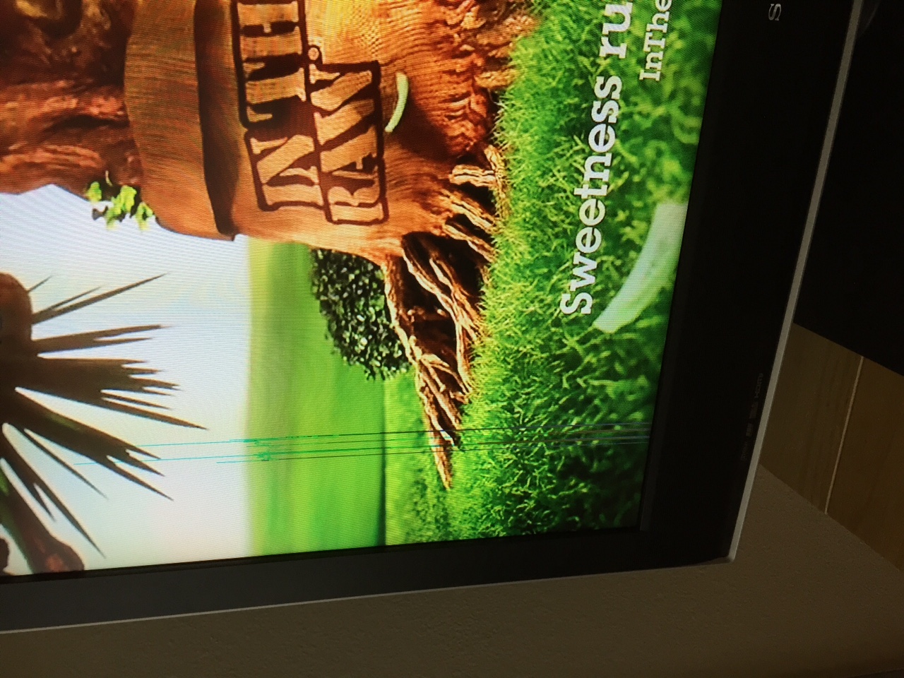

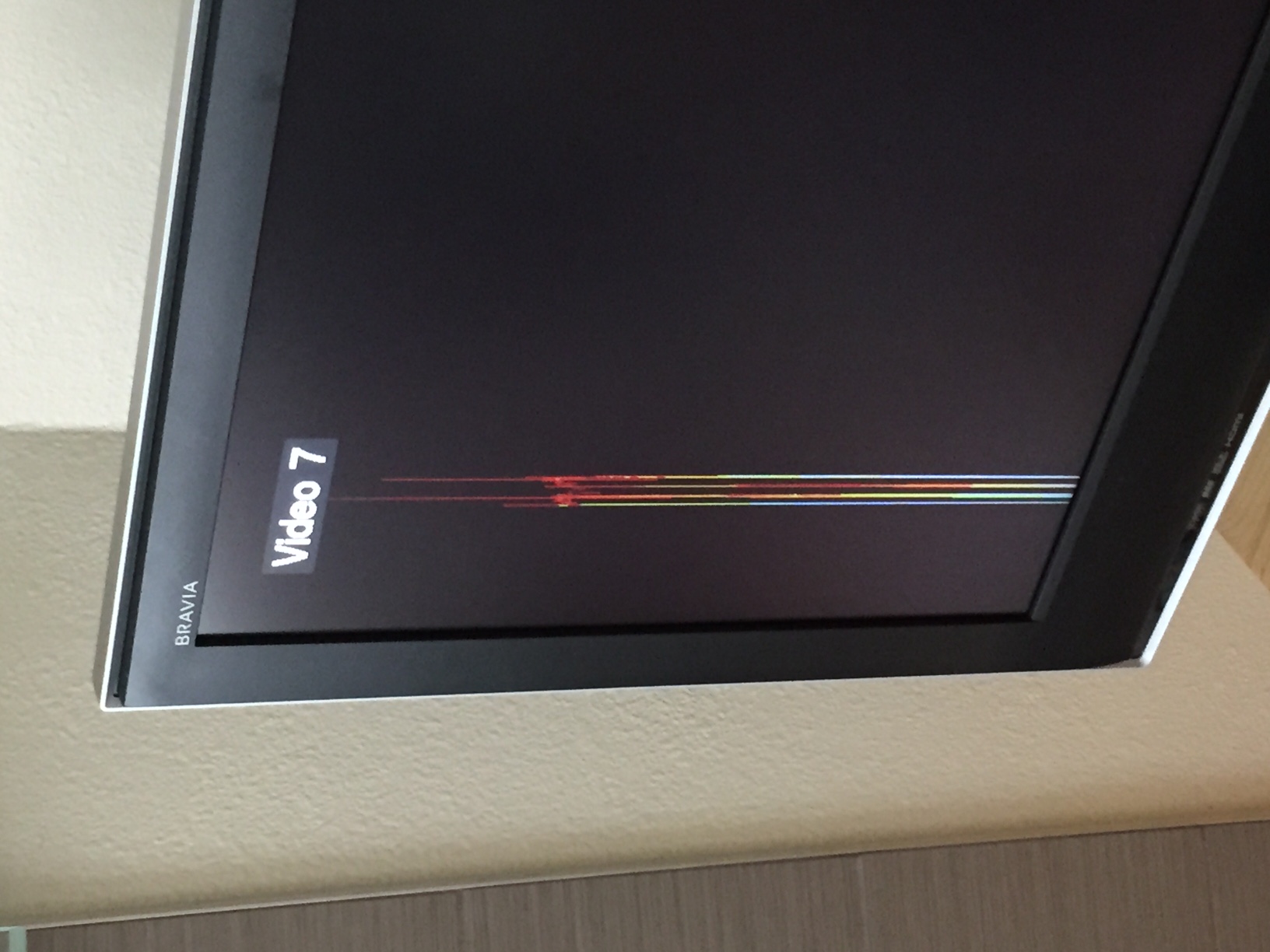

    Sony KDL-40S2010 Partial screen vertical lines
    I have a Sony KDL-40S2010 with vertical lines on part of the screen. The TV was packaged and shipped with a lot of padding and when we opened the packaging and turned it on it looked like this (see attached pics). Maybe something was damaged or came loose during shipping. I have been reading about bad T-Con boards and wanted some advice before buying a replacement. The T-Con board that I would buy is here: http://www.shopjimmy.com/samsung-lj9...-con-board.htm.
    Most of the T-Con symptoms I've been reading about affect either the entire screen or half of the screen. This TV has video and sound output and the lines are only on a small portion of the screen. I can get a T-Con and try it out but before I do I wanted to see if anyone could offer more specific advice since the symptoms don't exactly match that of a bad T-Con board and I'm not experienced enough to know what else it could be.
    I appreciate the help.
    Pics:

    Re: Sony KDL-40S2010 Partial screen vertical lines
    it is most likely a tab driver problem... unfixable :-(
        So just to double check, are there any connections to check on the tab drivers if I were to open the TV up? Shipping the TV most-likely caused whatever damage that has appeared unfortunately.
          As its intermitent you might be able to get away with a tab bond repair. Take the screen apart and start pressing on the tabs see if it clears the fault if so will insturct further.
