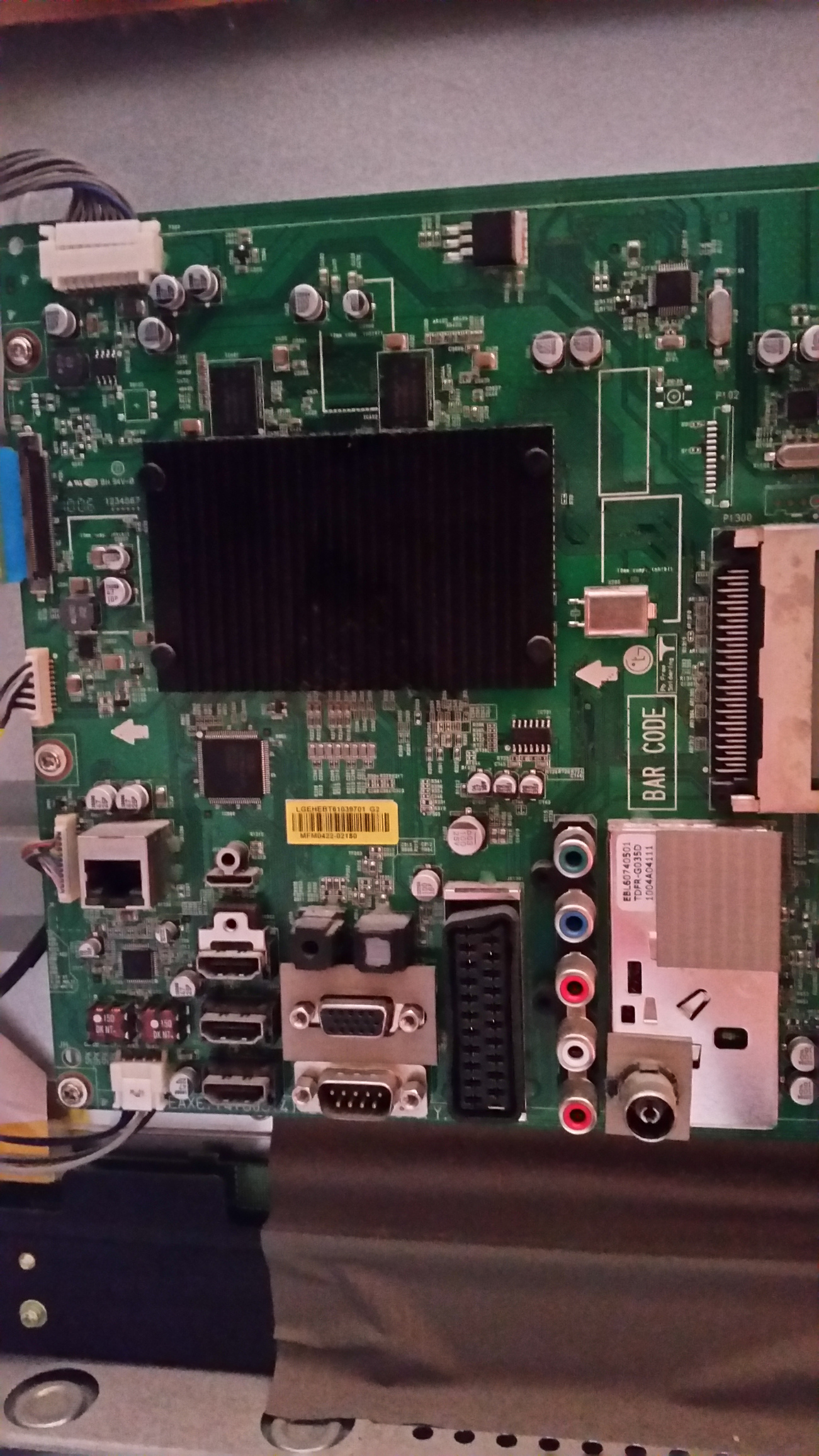

        Re: LG 50PK790 No Image No Sound
        Sorry photo is a bit fuzzy but hopefully okay enough for guidance, I know I need to disconnect a cable and then link two pins together but I'm not sure what any of those parts are on the board.
        Apologies for asking for basic steps, all help is much appreciated.

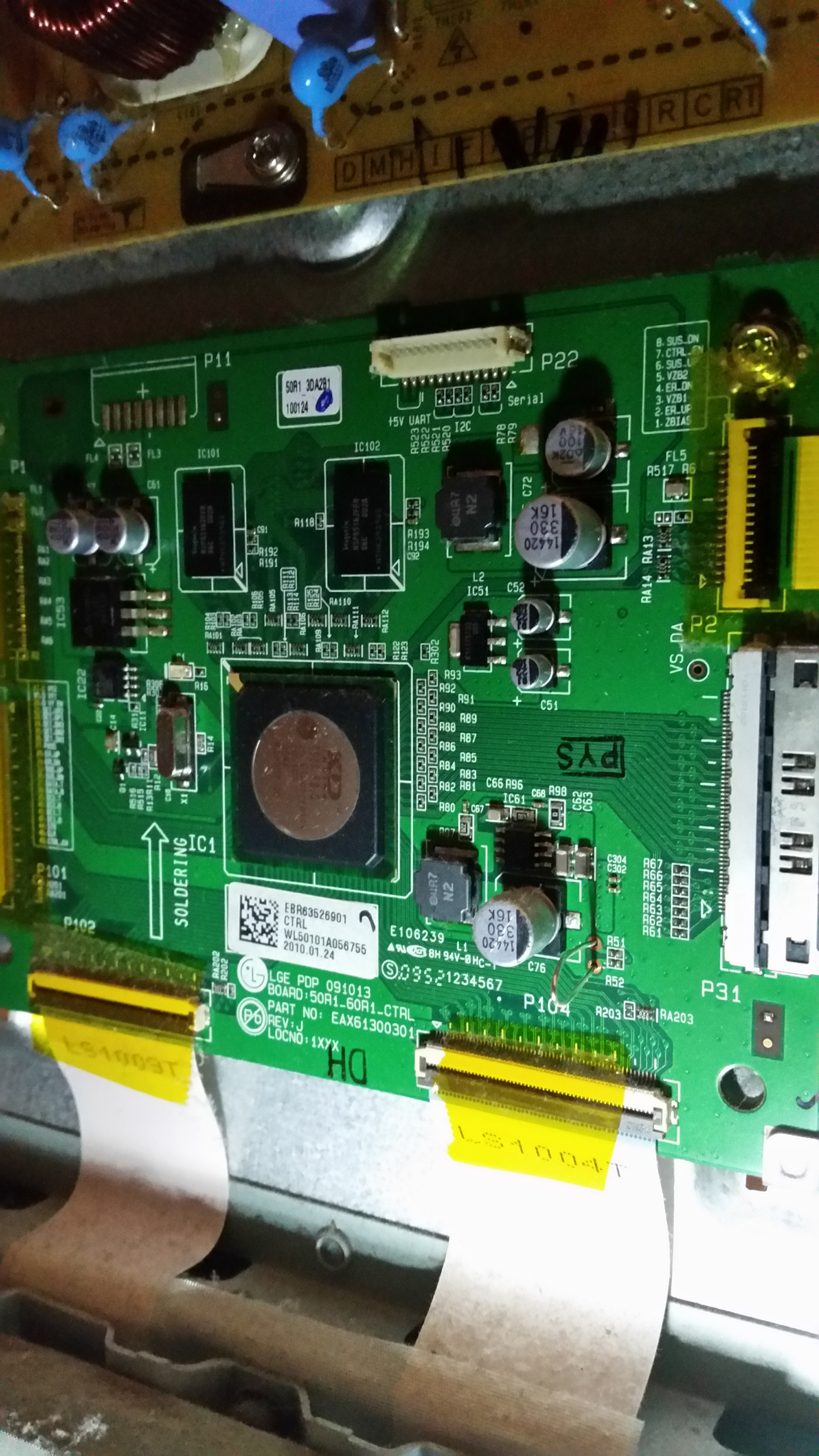

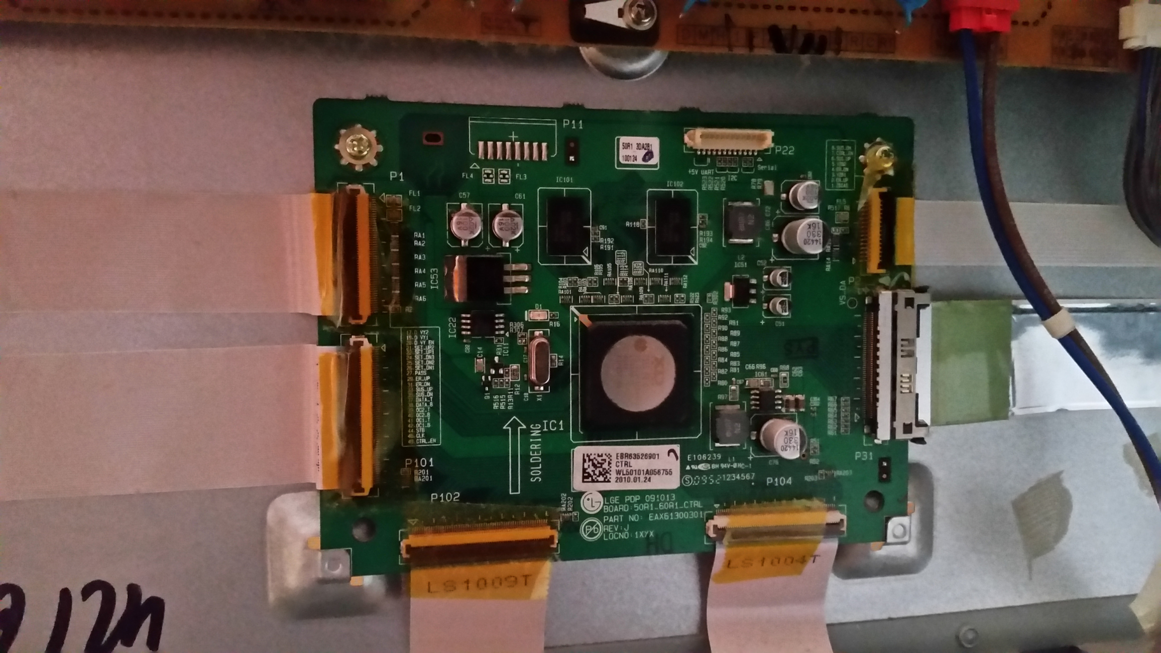

              Have you an image of the controller board please ?
              • RavenHerald
                • May 2016
                • 11
                • England
                Imaged attached, thank you.
                  Originally posted by charis
                  if you have sound and not image is the Y SUS the IGBT dont have corect voltage and flex cables dont make good contact.If no sound also the main problem.
                  If your picture is corrupt or washed colors change the caps on Y & Z sustain boards calibrate the voltages VA VS.
                  If start and shutdown after 10 minutes or more is your power supply.
                  For the other set they start putting red or green dots and with time the problem get bigger but sometimes for example if you use a dvd input stop or if the unit get warm.
                  Its overload of the phosphorus a panel problem.
                  Ignore all the contents of this quoted post--Its ALL Utter Garbage!

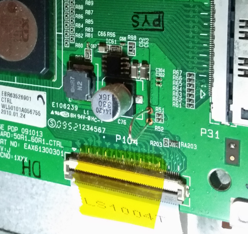

                  Link the test-points 'Test-auto-gen' on control-board and retest
                    +100000 got to laugh at the phosphors being overloaded part though haha
                      Aye--But my post wasn't much better--Cant see auto-gen on cont-board at all!
                      TELEFIX
                      • ReeceyBurger123
                        Never Give Up !
                        • May 2014
                        • 7325
                        • Britain
                        I think its on the unused connector block Ali
                        • RavenHerald
                          • May 2016
                          • 11
                          • England
                          Thank you, I was ignoring that but good to know I was right!
                          I got it connected, test patterns working fine.
                              Image is attached, should be clear enough so you can read anything you need off it but let me know if not. I left the wire in so you can clearly see where the points are {bottom right}, I realised the angle of the other photo hid them a bit!
                              Thank you both for all of your help in diagnosing, I really appreciate it. Unfortunately it seems to be hard to find a replacement for this model so I may have to bid it farewell.

                                  Sorry photo got squished smaller than I thought, have attached a close up.
                                  Fixable would be awesome! It's a great tv and I hate getting rid of anything that could be fixed, how would I go about fixing it?
                                  • ReeceyBurger123
                                    Never Give Up !
                                    • May 2014
                                    • 7325
                                    • Britain
                                    Do you know much about Bga solder failing ? If so common fault is the solder under the Cpu on these boards going, try giving it a reflow if not best to replace it and heatsink or even fan cool the mb they get hot which is the reason for failures.
