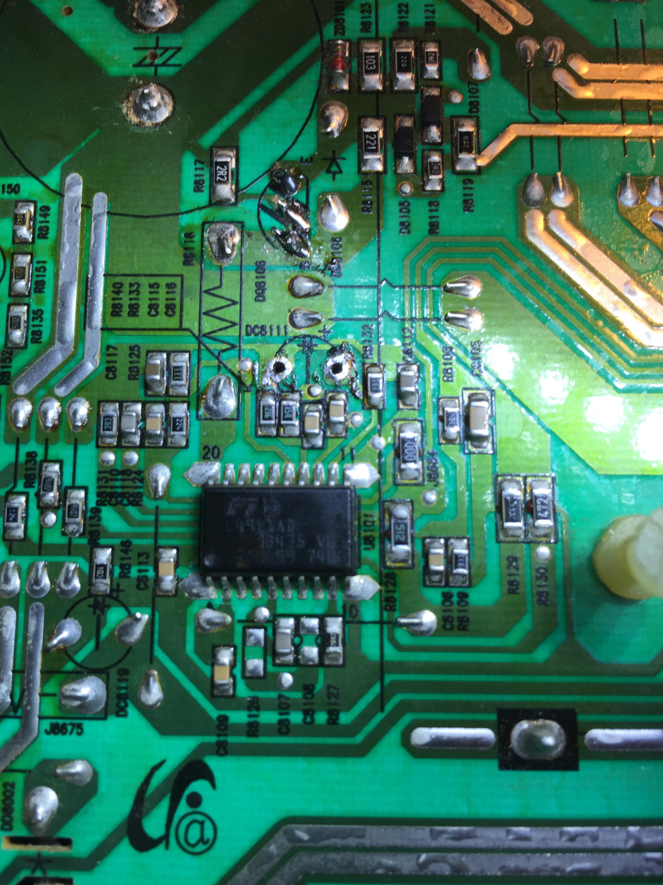

Help identify ST Micro regulator or oscillator chip
  • jimmyboy111
    • Feb 2013
    • 32
    • US
    This is located close to the rectifiers on the board
    LJ92-01511A goes to a Philips 50PFP5532D
    I cant find anything on L4911AD that fourth letter or number is all scratched up and fuzzy
    the closest I can find is L4971 from ST Micro but that only has 16 pins not 20
    I suspect it is the culprit of my dead board because it is connected to the base of a transistor which runs an oscillator for the first set of power mosfets on the board .. you can see pin 20 on the chip goes across a resistor connecting to the base of the transistor in the photo
    .. the rectifiers work fine .. the missing cap I removed in the oscillator (you can see it in the pic) 4.7uf electrolytic tests fine with ESR .. the transistor was removed as well and tested fine .. not knowing the pinout of this chip is eating my lunch

    Re: Help identify ST Micro regulator or oscillator chip
    looks like L4981 to me.
    datasheet looks promising too
    http://www.st.com/web/catalog/sense_.../SC680/PF63215
    • jimmyboy111
      • Feb 2013
      • 32
      • US
      Thanks .. it was right there on Mouser .. I typed "L49" earlier I just didn't scroll down
      DOH!
