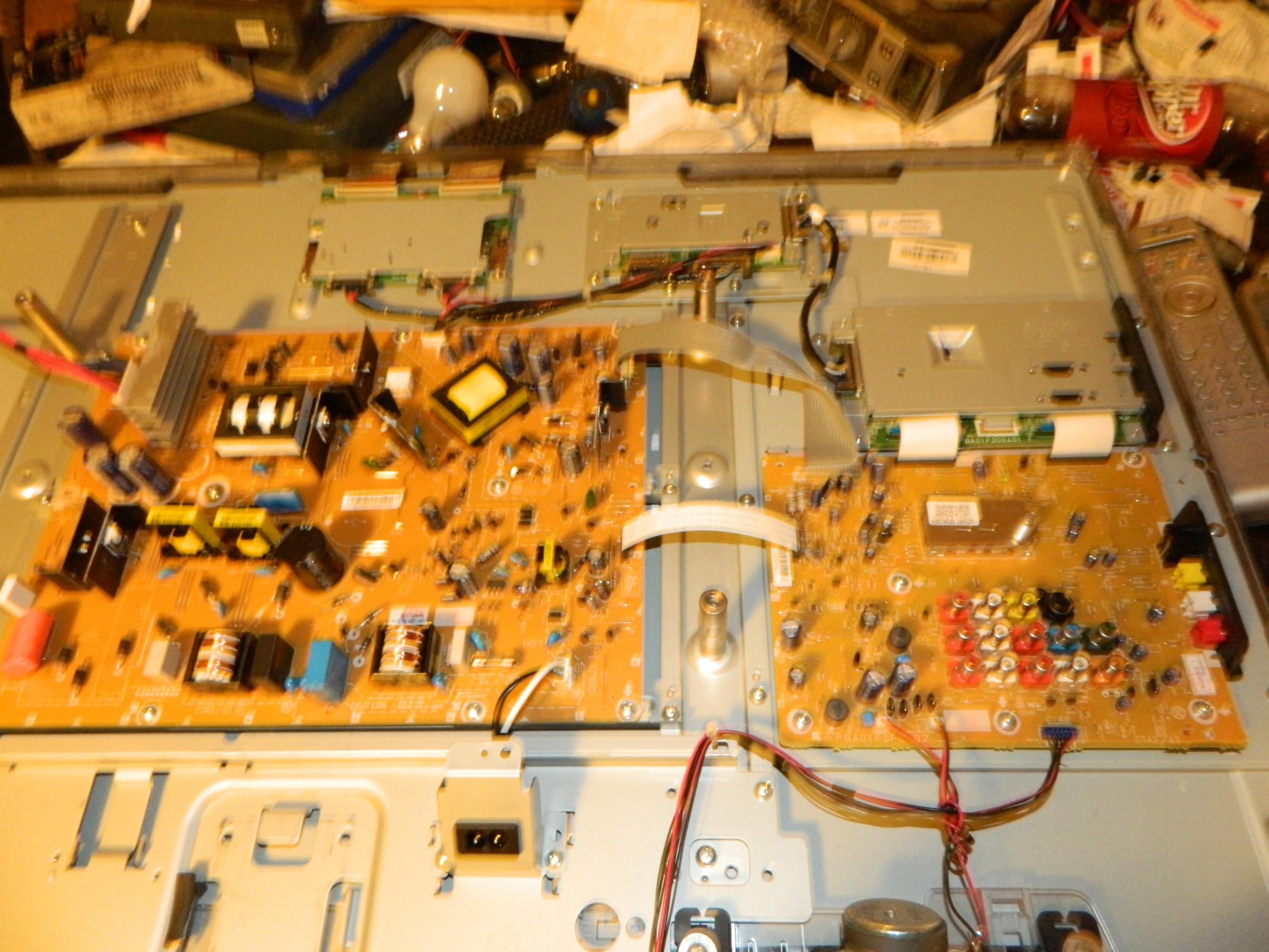

Ok, this tv came to me. It was written on it, no power. So took it apart and figured out was someone was messing with it. Saw the main power fuse missing, so replaced. TV came to life, but no display. So checked t-con board and figured out the smd fuse had 12v on one side, but not the other/ So ordered a t-con off of ebay and now I have display.

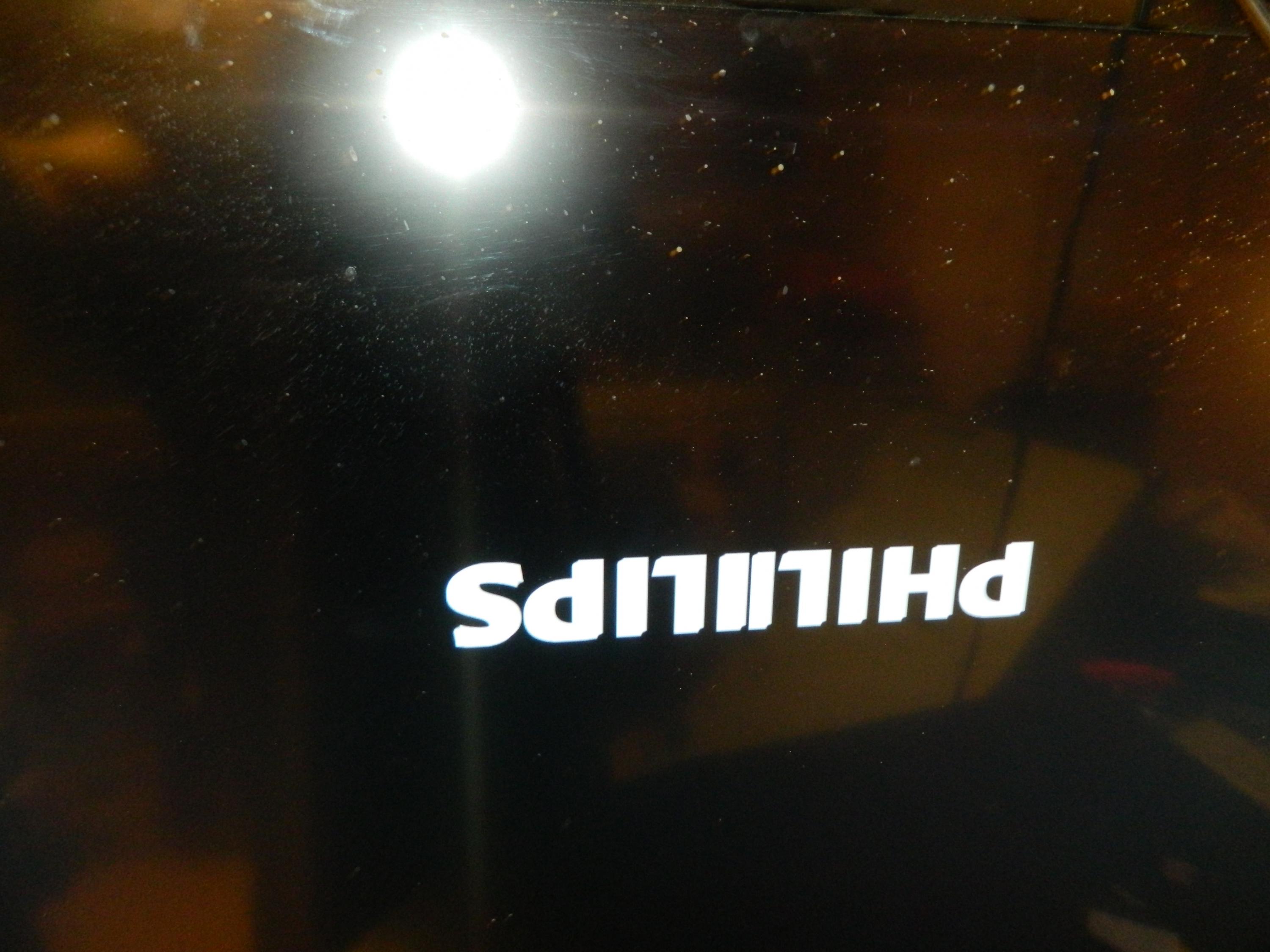

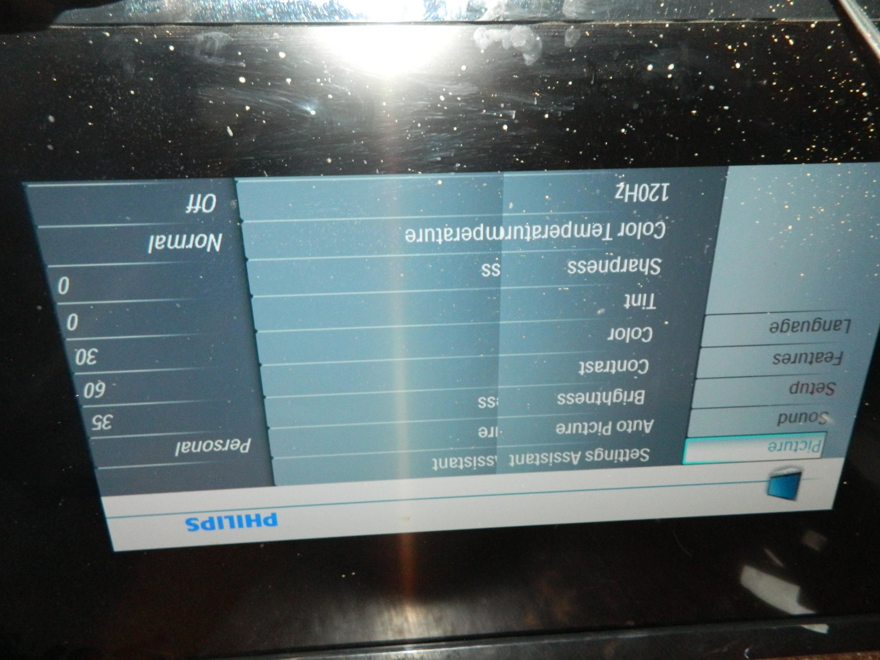

But now here is the weird issue. When starting up the "Phillips" logo displays perfectly. But when it finalizes, there is almost a like a line down the middle of the screen and like a mirror effect in between that line from left to right.
I uploaded pictures so you can see. Now is this a bad panel? I tried re-seating all cables. I tried applying pressure along the driver board as well as tapping, no change. Middle line like mirror still here.
So the question remains..bad t con? Or there is some kind of digital board in line from the main board to the t con board...is that bad? Hate to order it on a whim, its 20 for the digital processing board in line. Or bad panel? Also want to know so I can open a return on ebay for the t con if bad...
Everything else is functioning correctly except for the line and mirror image dead center in the screen, which is oddly not there with the phillips logo.
