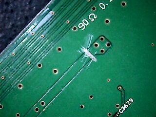

                  Good news for your 5 Emerson TVs and Mother Earth! .....Will cost you almost nothing to repair!
                  After I removed Amp IC and two down-converters IC3605 & IC3604. Mother board still has short. So, I cut two traces of PCB to isolate the problem. found the low resistance 8.4ohm was caused by..................A SMD cap 4.7uf C3637...................I put all the parts back, but omitting the C3637 cap. The Emerson TV works beautifully.
                  Emerson TV Buzzing-Won't turn on LF391EM4F
                  [Tech Tips] Simply remove the SMD cap C3637 4.7uf.

                    #29
                    Re: Emerson TV Buzzing-Won't turn on LF391EM4F
                    so I wasn't far off then. congrats! Nice pics btw.

                      What? That is totally awesome. I got to test that out. Do you know how many TVs will never hit the dump because of this? This is so awesome. I will let everyone know as soon as I get around to it.
