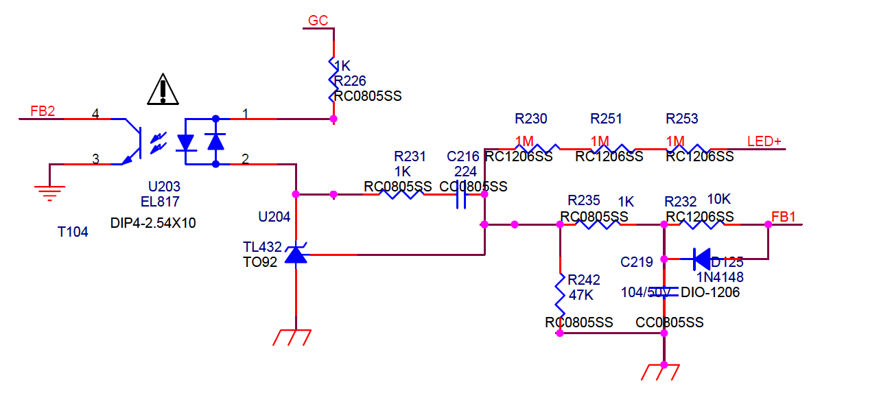

      OK, got a little more info:
      1) the PFC_OUT stays at ~385V (to ground) after the backlights shutdown. Which in hindsight was likely seeing as the 12V and 5V rails are derived from this also and they continue.
      2) It appears I may have been mistaken yesterday about the FB pin of chip U103 being ~0V. Today after startup it seems to go to, and stay at ~4.8V. not sure If I had a bad contact with the multimeter probe or had perhaps done something silly there (like measured the ground pin not the FB pin) but it does seem to be at 4.8V now. Again still no idea if this is good or bad!
      3) VDD pin of U103 is ~16 V so it appears to be getting a good power supply.
      4) It appears that Q111 (the other transistor on the FB pin of U103) isn't actually implemented on this board. So at least that's one path that cant have failed!
      I also probed the GATE pin of U103, and it seemed to stay at 0V, of course thats a PWM output, but I'd be expecting a some sort of reading if it were actually attempting to switch the power MOSFET.
      I'm a little confused about this now. It seems that there is *some* switching going on, as there's a brief voltage spike at startup (hence the flash of the backlights) but there doesn't seem to be any sign of life from the U103 Gate pin. Or is it just that even if this were switching I wouldn't expect to see it on a multimeter voltage setting?

        Apparently I'm a n00b at using a multi meter and stuffed up the GC1 measurement that I had in this post earlier. looks like its a much more sensible voltage, stays below 50V. And across the capacitor EC108 its only seeing ~6V but it seems to vary a lot between power cycles.
        I also re-read the OB2263 datasheet and discovered I'd missed a paragraph
        before:
        "At overload condition when FB input voltage
        exceeds power limit threshold value for more than
        TD_PL, control circuit reacts to shut down the
        output power MOSFET."
        Am I right in interpreting this as: If FB pin is above power limit threshold value (VTH_PL Power Limiting FB Threshold Voltage =3.7V from page 5) for (TD_PL) period of time the chip shuts down?
        if so, seeing as FB is 4.8V that would explain why the chip has shutdown!
        which basically puts the direct source of the "fault" at anywhere in this area (and its attached voltage feeds):
        note: Ive edidted the schematic to remove components that aren't implemented here to make it a little less cluttered
        so BUDM may have been right about 10 posts ago with stating that we need to know what the OB3354 VFB pin is!

            100% agreed. Definitely the U103 (ob2263) chip is in shutdown mode.
            I just cant figure out *WHY* it is - Obviously the optocoupler isn't "turning on" and pulling the FB pin down below 3.7V as needed. But again *WHY* I cant see.
            I do have some more voltage readings if it'll help anyone assist with figuring this one out.
            all are pin references/ test points are as marked on the schematic
            1) GC ~5-6v (varies over cycles), very briefly.
            2)Pin 2 of U203 (optocoupler in question) ~0V
            3)"reference" pin of U204 (tl432 shunt regulator) spikes breifly to ~.6v then drops to .4V
            4) the "BASE" pins(BASE1, 2 etc) of U5 - OB3354 all go to ~3V (coinciding with the backlight flash) and seem to stay there. I interpret this as meaning that the OB3354 is *trying* to drive the LEDS still (still switching the BJTs to drive the LEDs) even after the LED+ rail has lost power. - could someone please correct me if I'm wrong here?
            5) and very confusingly (for me anyway) if I measure the voltage across D123 I get a positive result BOTH ways (ie. if I swap the multimeter leads around I STILL get a positive reading on the DMM)
            Im utterly confused about this area of the circuit (the optocoupler drive area).. I have no idea whats going on here. From the similar area in the 12/5V area I assume the "reference" voltage of the shunt regulator is expected to be around 2.5V, but again *why* it isn't 2.5V is confusing me.
            I swapped the shunt regulator over with a good one and it's still all the same as before, so that isn't the issue.

              So, finally got *somewhere*
              I desoldered the VDD pin of the OB3354 chip and raised it slightly so it wasn't contacting anymore.
              I now get a stable output on the LED+ rail at 165 V
              the "REF" pin of the U204 (tl432) has gone to the expected ~2.5V
              the optocoupler is now working and pulling the feedback pin of the U103 down to 1.2V.

                  Reconnect everything as it should be and if you breifly apply a short across C219 which I think will overide the fault detection (but at your own risk) to see if it will bring up the backlights even breifly. If it does then you must have a led(s) fault.

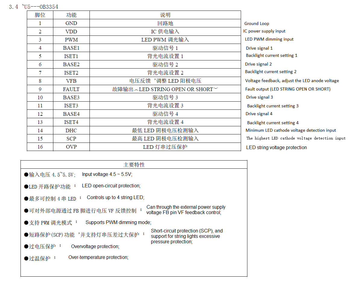

                    I did a few more tests and am now 99% sure the OB3354 chip has failed. It looks like the VFB pin is being pulled to ground regardless of the operating conditions. Neither OVP nor SCP have actually been triggered and the chip even appears to continue operating (probably not as intended) even after killing the LED+ power.

                          Re: "Dick Smith" 55" LED backlight issue - model GE6880
                          With the LED connectors unplugged it responds exactly the same as if they were plugged in. LED+ briefly goes ~100V+ then the LED+ rail drops down to 0. As far as I can tell all other pins respond in the same way when LEDs are unplugged or plugged in.
                          This would normally get me thinking its an open LED somewhere, however as far as I can tell the "open string" fault isn't being triggered (FAULT pin stays high).
                          pin 9 of the OB3354 chip is "FAULT" - and the best data I can find on the OB3354 chip indicates that this pin is the "Fault output (LED STRING OPEN OR SHORT)" seeing as this pin stays high it would tend to suggest to me that the LED open fault isn't EVER being triggered, even with the LEDs entirely disconnected!
                          I've included a copy of the pin descriptions of the OB3354 chip that I found. Unfortunately I can't find a datasheet for this chip anywhere so I don't have any idea whats actually supposed to be happening with this chip (for all I know this is entirely as expected!).
                          On a side note, when I swapped the OB3354 chips over I also went back to all the "original" parts (I had originally swapped over the opto and shunt-regulator, thinking they were faulty).
                          I did notice that with these original parts in and with the OB3354 chip power pin pulled off its pad the LED+ string was only going to ~80V, not the expected ~160. when I swapped in a new opto and shunt regulator it again went up to the anticipated 160V.
                          Does this assist in any way?

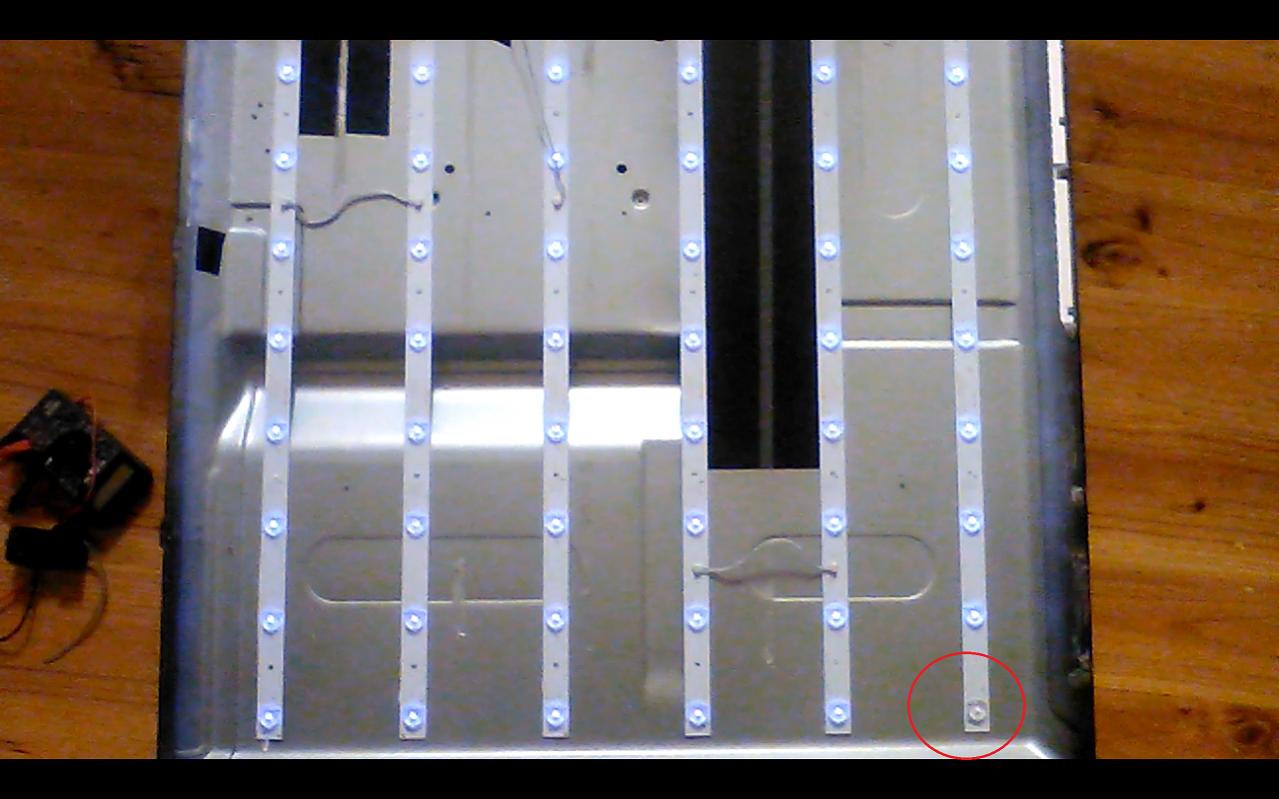

                            I believed that you had failed LEDs all the time while reading this. You should test every LED in your strips with a power supply. For each strip, multiply the number of LEDs by 3 and apply that much voltage - ie, if there are 10 LEDs then apply 30V. There are two test points at the connector end for factory testing, one (+) and one (-). If no power supply, take two 1.5V batteries and tape them together so that you have a "3V supply". Apply power to each LED by attaching the leads to straight pins and touching the leads of the diodes. The good ones with give off quite a bit of illumination. The bad ones may just slightly glow. Just be sure to get the polarity correct.
                            Another way is to use the pins to dig into the white resist layer of the strips near each diode. I don't like doing it that way because it is unprofessional, but it works.

                                Sorry I should have mentioned earlier, I had already done the 2xAA batteries test over each LED (The LED strips have test points for each LED in the chain which made it much easier than it would have been otherwise!)
                                Each one illuminated approximately the same (there were no distinct dim or bright ones anyway) and drew about ~80mA
                                I actually did that test early may, it was one of the "few more tests" I had run before my last post at that time.
                                So that would seem to indicate that the are all at least somewhat functioning, unless they are failing at a higher current. but as far as I can tell the LED+ rail never even hits a voltage that would get even 80mA through them! - 48 LEDs per chain, means 144V to hit 3V per LED, the LED+ rail doesn't seem to get that high!
                                also the big big big indicator (in my mind) is that the LED open or short fault isn't being triggered. even when the LEDs aren't physically connected, which surely MUST trigger the open fault if its working "correctly"!

                                      I took a movie of the LEDs flashing to see if any didn't turn on or were noticeably dimmer etc.
                                      the only irregularity that I caught was one of the LEDs seems to "turn off" faster than the others. (picture below)
                                      Is it likely/possible that this LED is the culprit? the rest take an extra frame to turn off (the entire bright pulse and fade out is 4 or so frames)
                                      Although if this is the case I still don't know why the fault pin isn't being tripped as surely that would engage the SCP and pull the fault pin low.

                                        I just used some fresh AA batteries and the LEDs were drawing ~100mA, I assume the two I used a month ago were old. Doesn't that achieve the same thing? they each work fine with the 2AAs so I suspect if they are failing its higher than 100mA
                                          #40
                                          Should be the same thing. How were you measuring current?
                                          As for your movie, make sure that that your observation isn't a camera scanning artifact, by taking several movies with the camera at 0, 90, 180 and 270 degrees to the TV. If the same LED goes off early, then that guy is probably your culprit.
