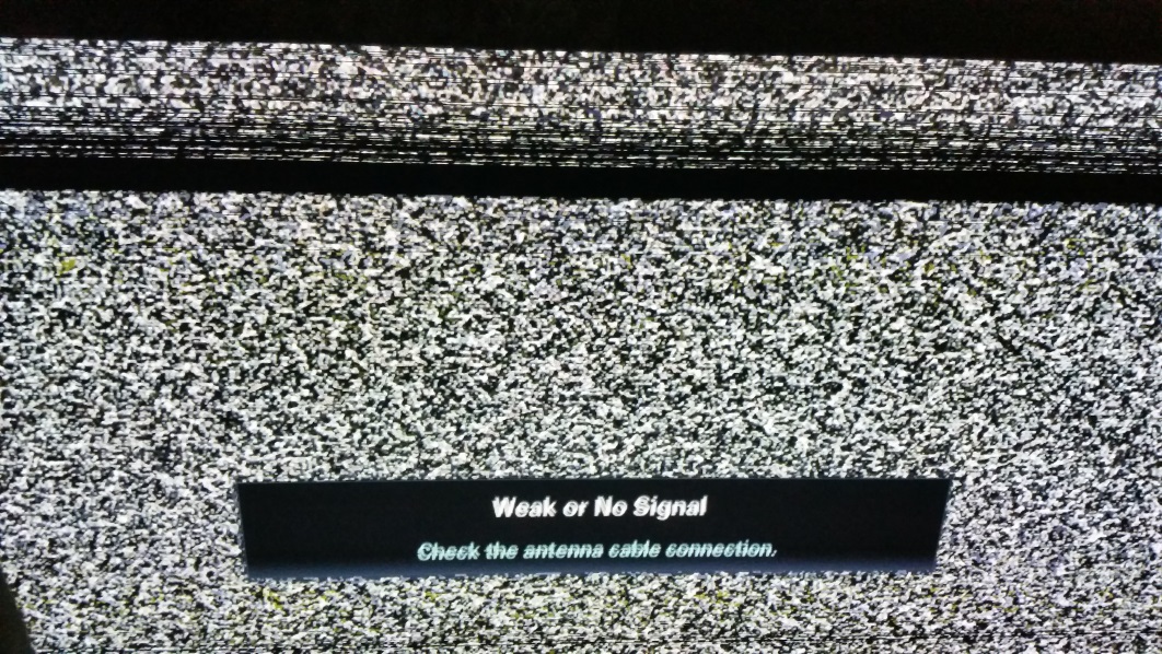

samsung pn50c540g3fxzc black horizontal lines
    display shows black horizontal bars.
    read on similar threads about this likely being a bad panel and not to waste money on repair.
    just wanted to get some confirmation on this
    here are the pics

    check all ribbon connectors going to display and t-c.on board

      Panel failure not fixable, common issue on this model.

          the only hope you may have (temporarily at best) is to try place some gentle pressure on the tab bonded on the side of the panel to see if anything changes.
            Re: samsung pn50c540g3fxzc black horizontal lines
            thanks everyone. I tried pressure on the tab bonded areas. it changed a bit then got really bad then I decided that it wasn't worth the hassle as mentioned before.
