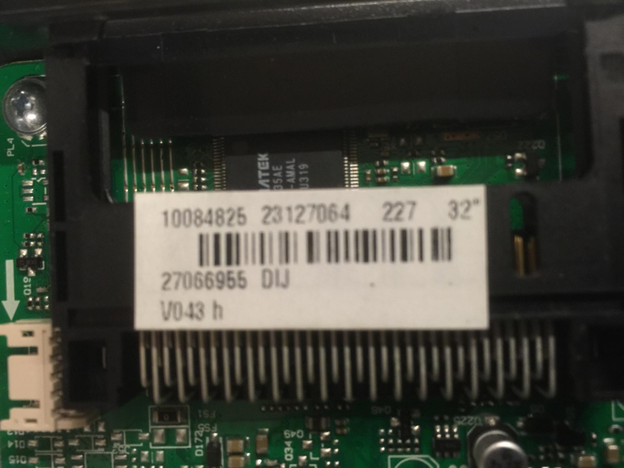

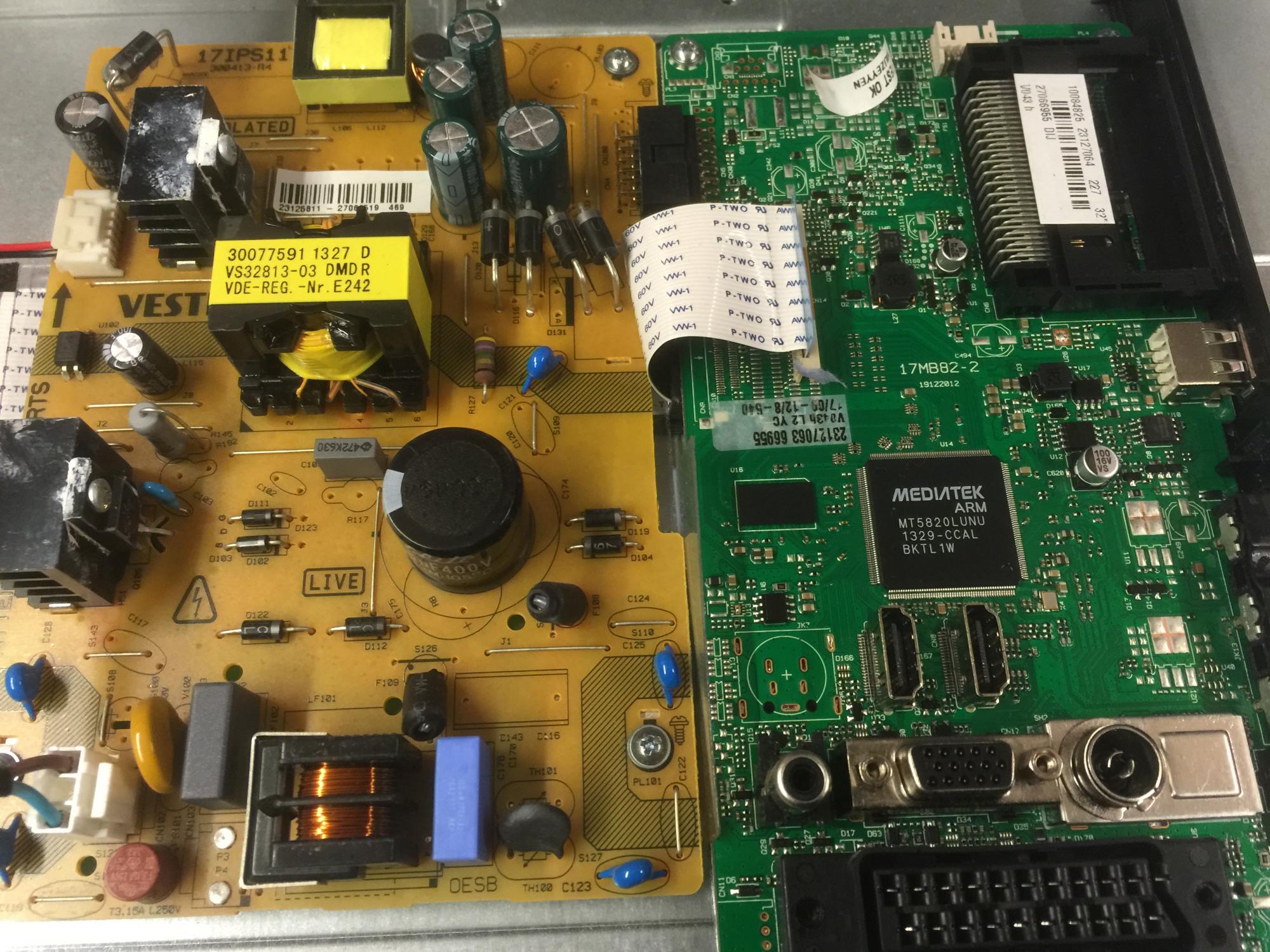

    I'm guessing corrupt firmware but it keeps re booting up, and loses one of the 5v rails after a few seconds , so wondered if anyone has any ideas before I spend the next 6 months looking for a board on eBay

      have you thought about a pre programmed chip? maybe from ohm supplies does the set fully start if you freeze the eeprom/flash chip if so you maybe able to reload the data etc.
        Re: Bush Dled32165HDDVD. Vestel 5 sec shutdown
        Reinstall core update a few times will sort issue. 5v shuts down as its controlled by mobo the 12v and 24 run all the time but as the 5v uses Dc-Dc converters the mobo turns them off when in standby.

            You misunderstood me lol, watch my 17mb82-2 firmware repair video and follow the steps. You only need standby and first stage loader to install core updates.

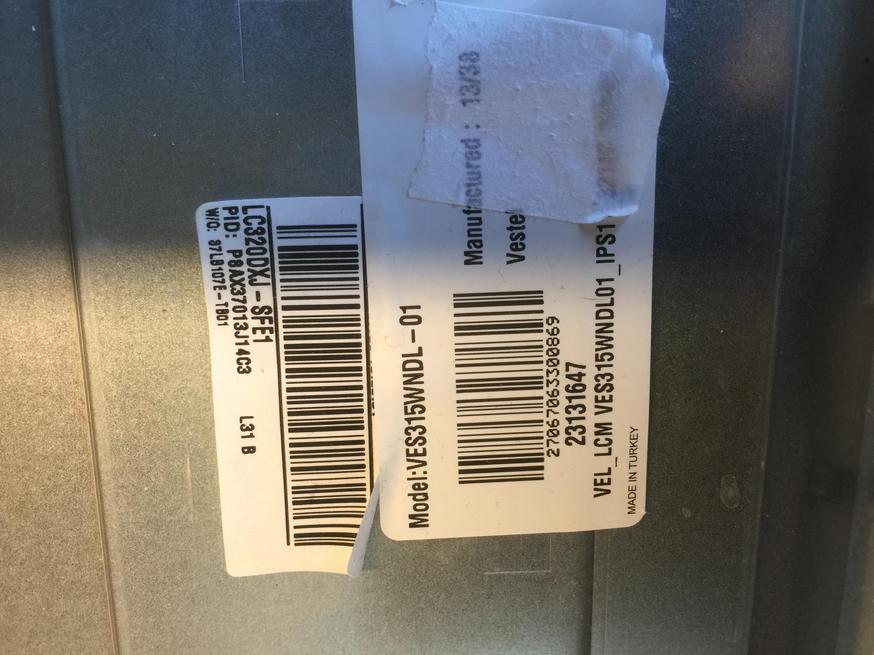

                  What panel is it mate ? For example- VES315-WNDL-01....
                    here it is, hope you can help.

                      I sorted this Tv ran the core update and boom fixed lol
