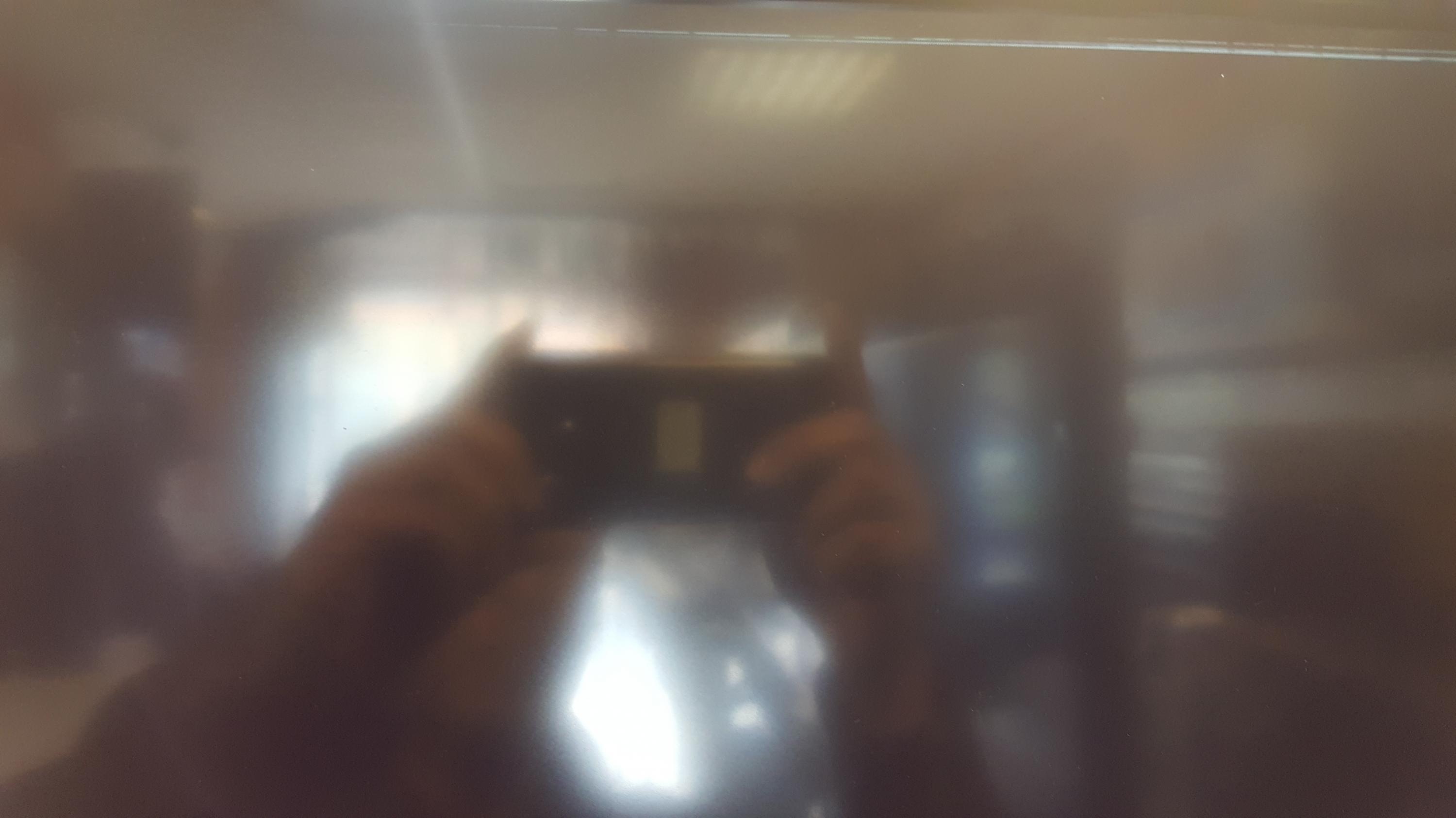

    Lg tv screen comes on slowly
    Hi. Lg tv when I turn it on the screen shows unlock tidy horizontal pixels on the top without backlight. And step by step for 20 minutes the full screen shows up perfect. Is it the panel?
    Re: Lg tv screen comes on slowly
    If you can see the pixels are you sure the backlight is working?
    It sounds like a panel defect.
    • layad
      • Nov 2011
      • 249
      I can see the backlight from the back of the tv . And the pixels what I see are lighting up.after couple of minutes a very faint vertical lines coming up
      • johnboy1313
        • Nov 2012
        • 1959
        Disconnect the ribbons between the screen and the tcon board, one at a time and power the set on.
        • fredaelsadany
          • Jan 2016
          • 66
          • EGYPT
          HI
          please lcd tv type , more pic .
          yes this is fault can be panel or dc-dc converter in t-con board . here the voltage VGH (MORE THAN 20V) IS NOT FOUND or very small . IF YOU look at T-CON BOARD THIS VOLTAGE IN IT COMES FROM IC AROUND IT 2 TO 3 BUCK COILS try to found VGH and measure it .
          PLEASE SEND PHOTOES .
          thanks
          • layad
            • Nov 2011
            • 249
            Thank you all guys . I'll check all what you said today after work
              I would say most likely the panel is bad.
              • layad
                • Nov 2011
                • 249
                Thanks guys . It's the panel unfortunately
