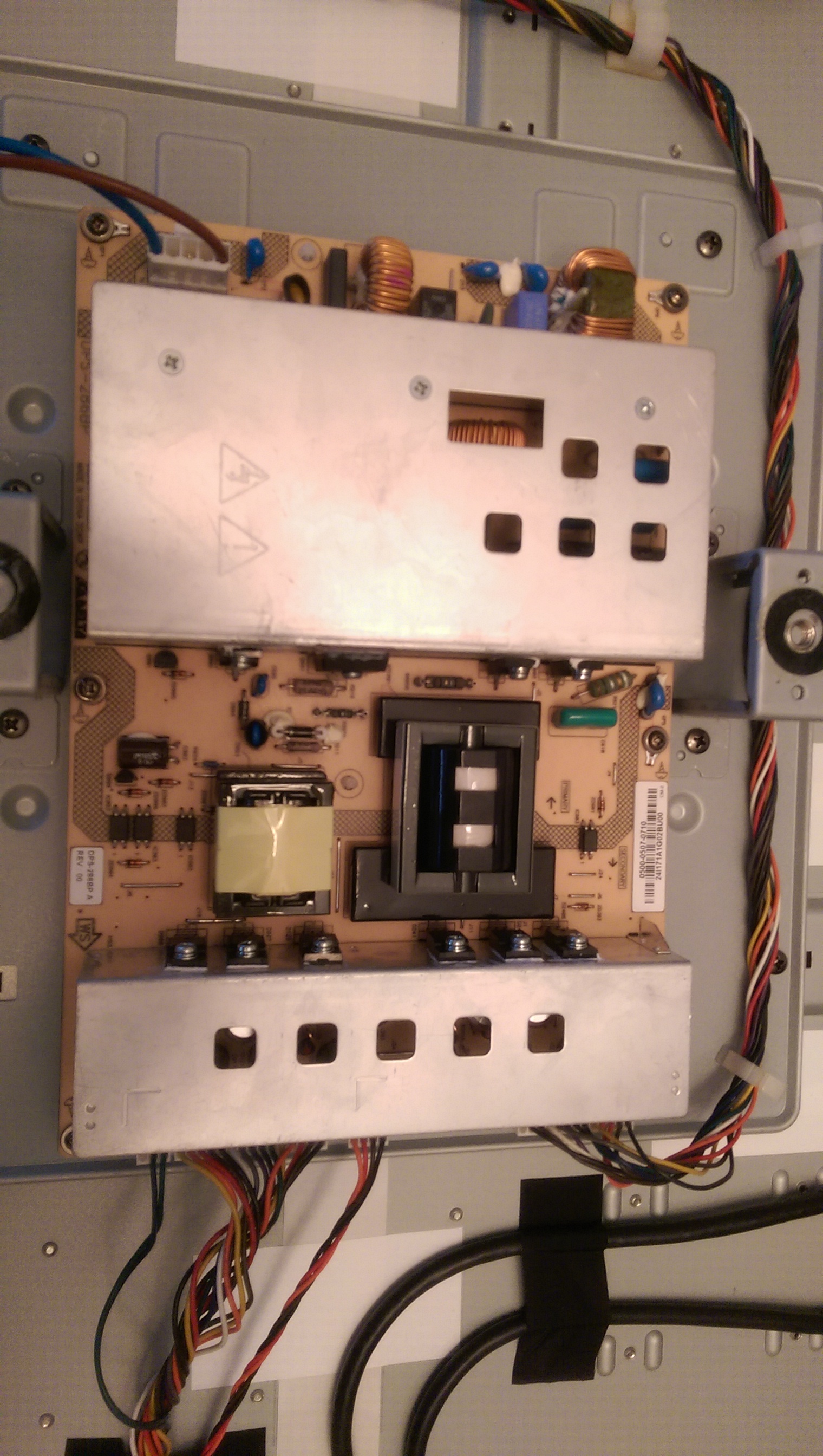

    I have already opened it up once and checked a few things with my multimeter. The 3 fuses on the main board checked out OK. The main fuse on the power supply unit at first read good, but later on I found it to be blown, so I put in a temporary replacement for now. I've been reading that I need to check all the voltage regulators to make sure they all check out as good. This will be my next step. If I can determine all I need is a new circuit component then I'll be very happy, but I am prepared to order a new main board and possibly power supply board if need be.
    Help
    If anyone out there knows if there is a common solution to my problem that would greatly help. If more information or photos are needed, just let me know what all I need to check (continuity, voltage, resistance, amperage, etc.) and I will report back.

      All I could get a reading on was the incoming power CN1,Pin1,L,120V / CN1,Pin3,N,0V. I also had 120V at both sides of the fuse. On connectors CN2 through CN6 going out to the other boards I got a reading of 0V on all pins, but previously I know I was reading some voltage. A few of the voltage regulators on the primary side (Q601, Q602, Q801, Q905) had around 58.8-60V at them along with the primary side of the D903 transformer. I may have fried something when I was reading the voltage off Q905 and my meter lead slipped and shorted across two of the pins.
      This was all measured from ground with all the wiring to the other boards removed. I'll check again tonight with all the other boards plugged back in to see if I get anything different.
        Re: Vizio SV472XVT won't turn on
        When you check the DCV in the primary side, you do not use chassis as the GND ref, you have to use the negative leg of the main filter cap in the primary side as the GND ref for your meter, the secondary cold side you can use the chassis as the GND ref.
        So lets fined out if you have at least 5VSTBY on the cold side first.

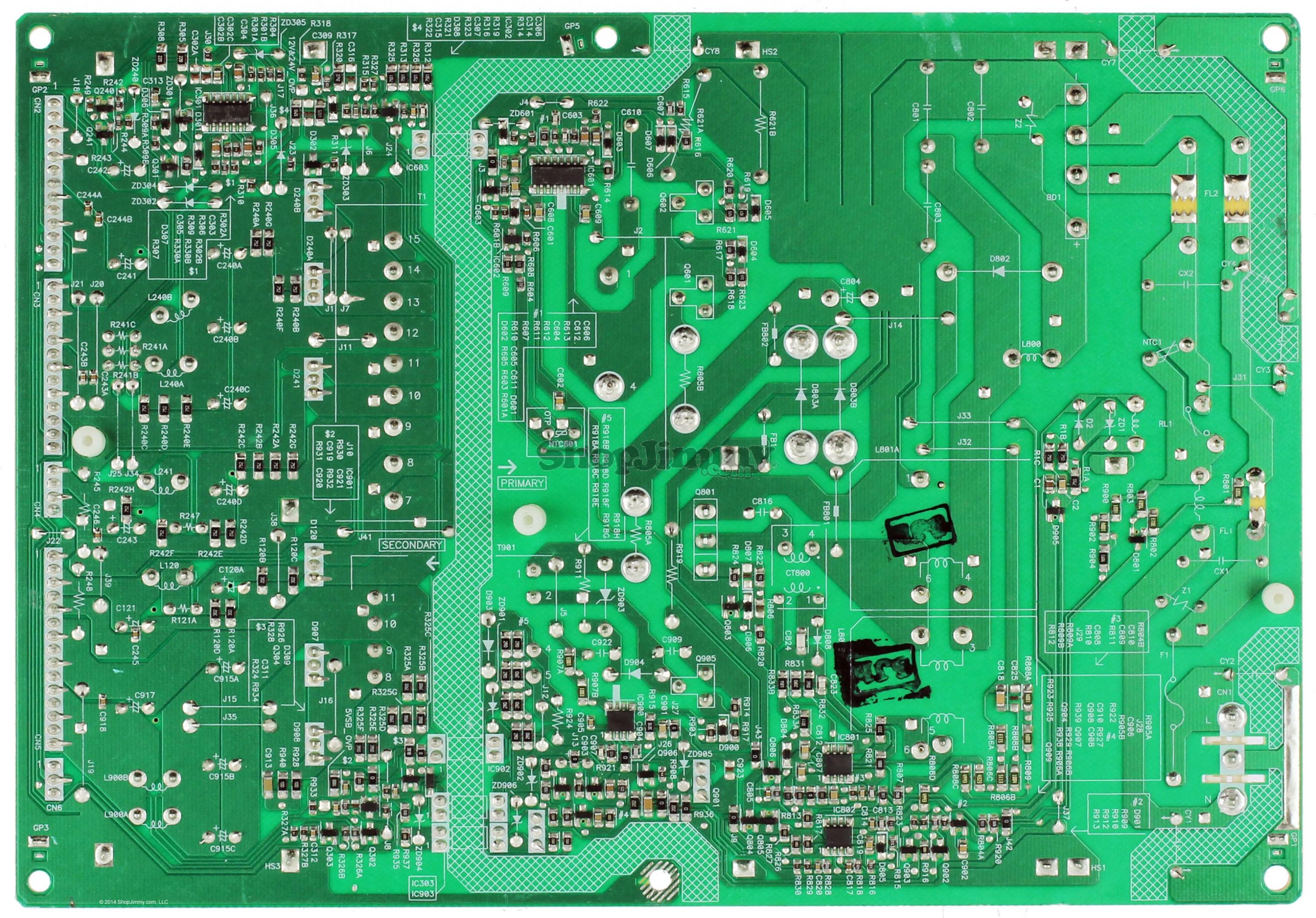

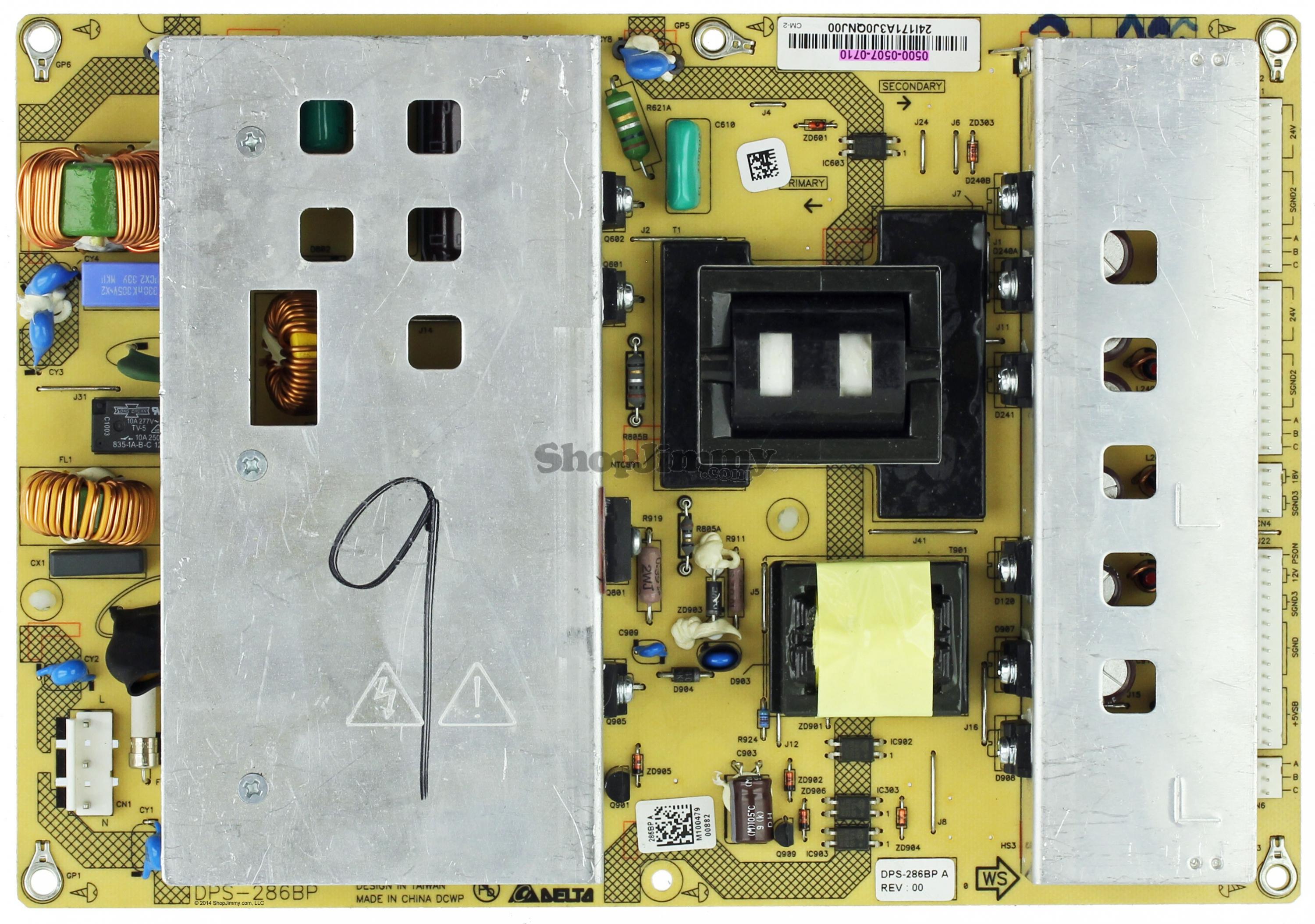

            So right now all 5 connectors on the cold side have no DCV at all?
            You can run the power supply board by itself out off the chassis so you can test the DCV between the two legs of the main filter cap C804, it should have about 160VDC.
                    If the picture of the parts as shown on the EBAY is correct, then it is not the right parts for his board because his board uses SMD SMPS IC for driving the Power MOSFET, the one on EBAY is the Power SMPS IC.
                    The board on EBAY is DPS-286AP, his board is DPS-286BP.

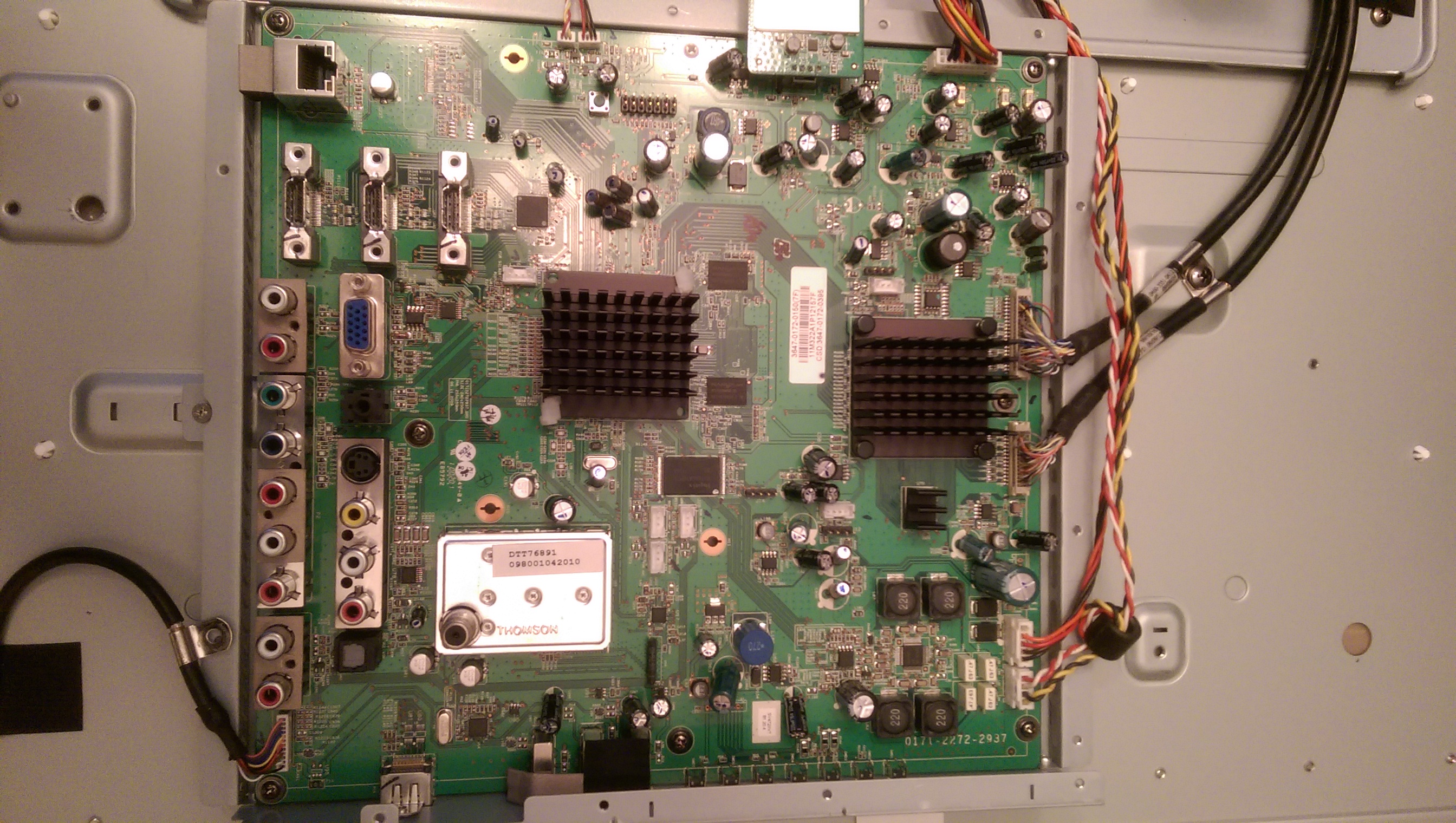

                                    It looks to me the main board is also bad, there is not any command signals from the main board at all.
                                        I do not see the Ivr-error pin, and these old VIZIO do not use the error signal from inverter.
                                        The 'A' is for the BL-ON, the 'B' is for Dimming control, right now all 3 signals are not present.
                                        I think the clue about the main board is in post #1 "A while back all my HDMI ports went out and I had to switch to component connections"
