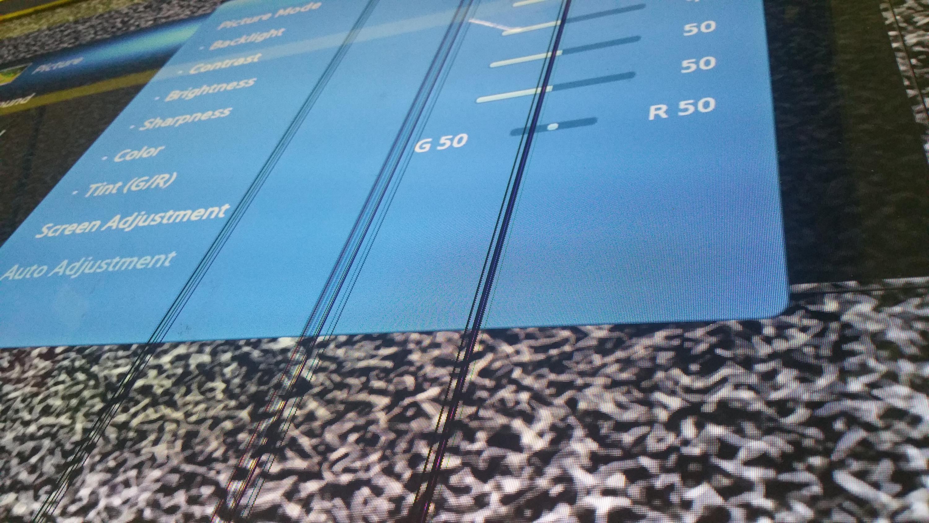

    Hi to all i have and un46d7000lf TV with vertical lines even when you apply pressure to the tabs the vertical lines do not move i measure the volts on the power board and they are all normal range this is a puzzle any help will do thanks again.
  • mmartell
    • Oct 2013
    • 3189
    Re: un46d7000lf with vertical lines
    Panel failure. If pressure on the tabs doesn't help then you are out of luck. Btw I have this same tv, very nice picture.
