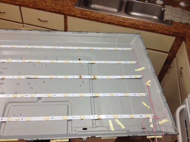

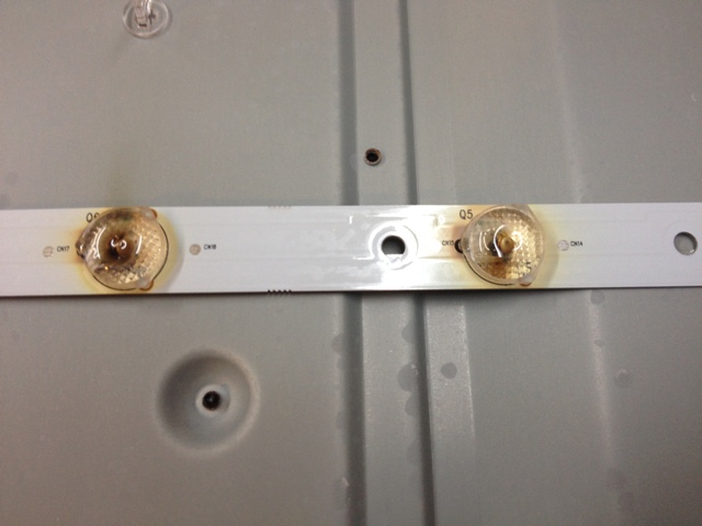

                  Re: Seiki SE50FY28 LED TV, no backlite
                  OK, progress at last!
                  Took off the multiple layers of screens. When I got them all apart, I realized I had been holding my breath the entire time
                  As you can see from the 2 photos, there are indeed 5 strips of 6 LEDs and 5 strips of 8 LEDs, per budm and SJ (thanks!). Now, I at least know what to try and find somewhere.
                  Also from the photos, there are 2 LEDs that look quite burned and likely are a culprit. Haven't tested any of the other strips yet, but that's next.

                      BTW, when checking the boosted output of the LED power supply DCV (L+) feeding the LED string it should be checked with ref to the chassis GND.
                      Just another failed LEDs as usual, beside having open circuit LEDS, you should check all the LEDS to make sure there are no other open LEDs or shorted out LEDs.

                        Are those Leds failed ? Lol just messing you can substitute them with diodes or resistors but if you want the Tv to look even half decent you should replace them. You can obtain strips off ebay or I think someone had the link to the Led type used will try find it. Also you need to test every Led with your meter as it might not just be them two.

                          LEDs bad? Nawwwww. Reminds me of the joke about testing kitchen matches... "Yup, that one worked. That one worked, too."
                          Checking eBay now, but having a lot of trouble finding a match.
                          Just for grins, I may try the diode jumper. Are these regular voltage/current LEDs? Haven't got any of them to light up at all.

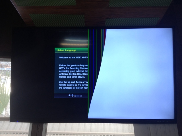

                              Follow-up...
                              Good news: I found a replacement LED strip and installed it, and the LEDs now all light up.
                              Bad news: screen is cracked. I dunno if I did it during the surgery, or it was like that and I never noticed it. In any case, I get a very good picture on one side, and just lines or white nothing on the other side.
                              Any ideas? Can replacement screens be had?
                                Doh ! What a shitter, finding a replacement screen is almost impossible and not worrh it

                                    Out of curiosity can you post a picture of how the screen now looks.

                                        Sorry for the delay. I was so frustrated with the thing, I didn't want to look at it again for awhile (a looooong while!).
                                        Anyways, here's the requested photo. As you can see, it's in great shape on the left side but not so good on the right (well, duh). If I wiggle the screen just so, I can get colored lines within the white area on that side, which means the rest of the electronics/etc is working - except for the discontinuity at the crack.
                                        I found the tv alongside the road, so i don't know its past history. But in thinking it all over again, I'm pretty sure I cracked the screen while working on it - no idea it was that thin. Almost felt like it was plexiglas at first, because it can bend..... A LITTLE.
                                        I am so disappointed in my failure that I have been seriously considering going out and buying the same tv (found it online for $299), and putting the new screen back in this chassis. How's that for stubbornness?
                                        I've been searching for a replacement screen, but as expected it's no joy. eBay'ing the parts is probably the next step. Does anyone know if online places (ShopJimmy, etc) are interested in the stuff?
                                        Thanks for all your direct help, guys, as well as for the forum in general. I've learned a lot!!

                                          I wonder if this could be a tab bond issue? rather than a crack?
