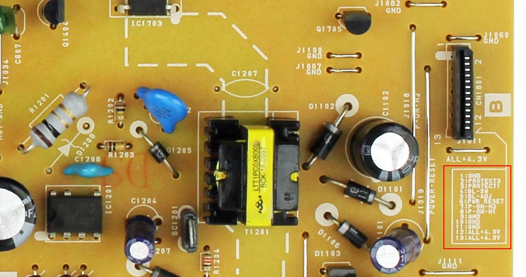

            Hello d_b and others:
            I had to put this project on hold for a few days, but am back at it now. Here is the picture you requested (see below). It's not completely obvious which P-ON pin needs to be connected with the 5v pin, since there are two of these.
            Would it be the P-ON+3.3v pin or the P-ON3.5Vf or REG pin?
            (I'm thinking it might be the latter because if you look at the pic you'll see the following label along the left-hand side of the image:
            P-ON3.5Vf or REG
            I haven't tried either yet. I want to ask a couple more questions before doing so:
            1) Do you connect the 1K ohm resistor directly to the pins in a certain manner? There are no back holes on this particular connector through which I might normally attack it. So, in order to be safe, I would like to know how best to connect the resistor so that I am not endangering myself or what I hope is a primarily otherwise functioning tv set.
            2) I don't have one of these 1K ohm resistors handy at the moment. So, is there another way to do this that would be equally safe and effective?
            and
            3) If I accomplish this properly, can I expect that the set might actually fire up an on-screen image if the Digitial Main (and Tuner) are essentially taken out of play? Or, am I only doing this in order to take readings with the Digital Main and Tuner not in the picture. If it is the latter, then haven't I already accomplished that in the prior readings I documented in earlier posts here?
            ~ kca
              Re: Philips 46PFL3705D/F7 ~ No picture or sound / transformer buzzing
              The command signals from the main board are fed to that small black connector for the flat ribbon cable.
              The stby is ALL +4.3V, the pwr-on are PON M1, PON M2.
              I also see the Protection signal pins, I did not study the board to know what all those function are but at least you can monitor those pins.
              You should check the DCV when TV is plugged in but not turn on and the afetr the power switch is activated to see which pin change states.

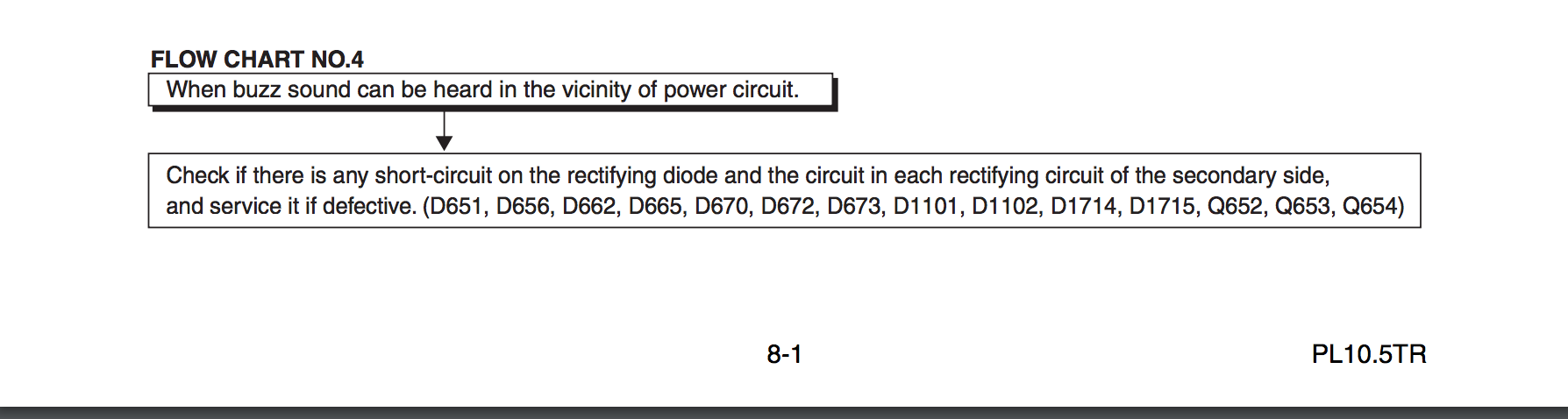

                                Many of the schematic wiring diagrams found there are complex and hard for me to decipher, but maybe they shed insight for you. I did, however, find this flowchart (see image below) that is related to the buzzing.
                                I have already checked all of the suggested diodes, but have not yet examined Q652, Q653, and Q654. Apparently, according to the Parts List also found in the Service Manual, these three are transistors.
                                Any suggestions on how best to test these three with my Digital Multi Meter would be most helpful.
                                ~ kca
                                  #36
                                  OK, I will down load it and see.
                                    #37
                                    ~ kca
                                    Hmm, so they already know about the potential problem. To test the Transistors properly, they will need to be removed and tested off the board.

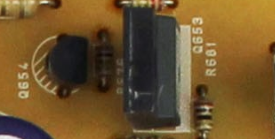

                                        Been looking at how to test MOSFET transistors. Is this video thorough and comprehensive enough:
                                        https://www.youtube.com/watch?v=RkWy1EirEu8
                                        ... or should I be testing them in some other way? Any tutorial you can provide would be very helpful as I continue to try to isolate the problem.
                                        Thanks ~
                                        kca

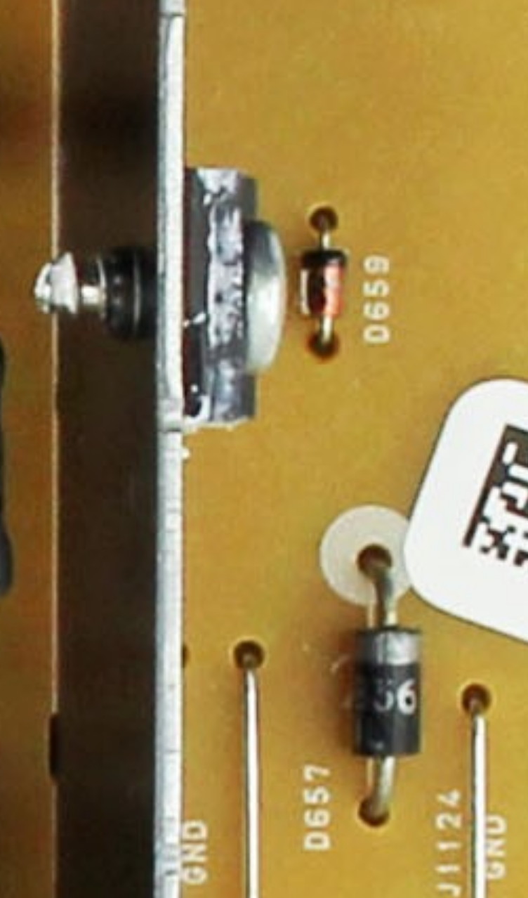

                                        Also included two pics of the three transistors in question (see images below). Note: The Q652 board label is not visible in the photo, but that is definitely one of the two correct MOSFET transistors in question.
                                        And the screen shot from the service Manual describing these three transistors is also included below. Q652 and Q653 appear to be identical MOSFET transistors, and Q654 appears to be what is called an N Channel Low Power MOSFET Transistor. Are these two different types tested in the same manner, or should I be looking to test the N Channel Low Power one in a different manner than the other two?
                                          #40

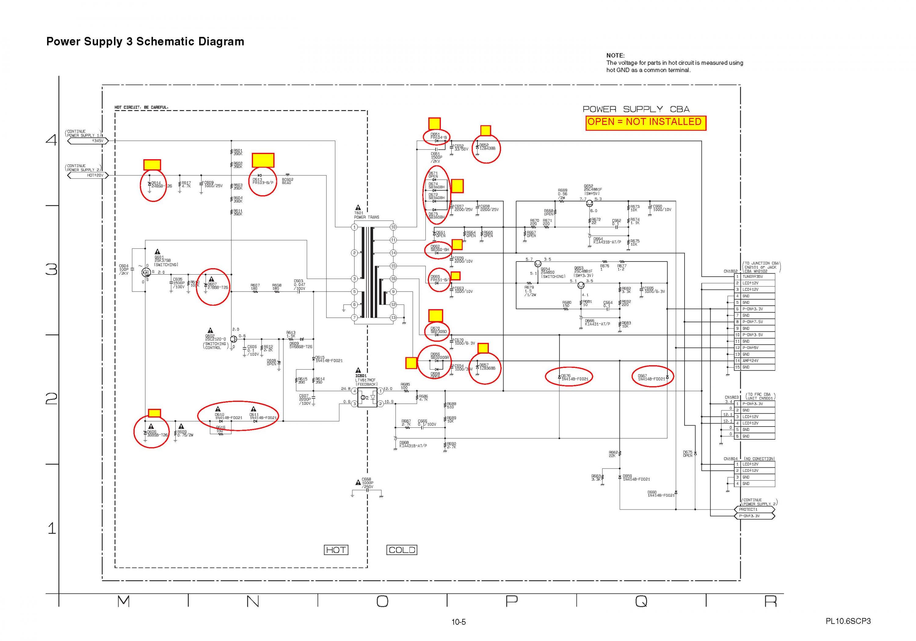

                                          OK, just to be sure, please check those Diodes I marked with yellow boxes (you will have to lift one leg off the board to test), I am looking for low resistance or leakage resistance.
