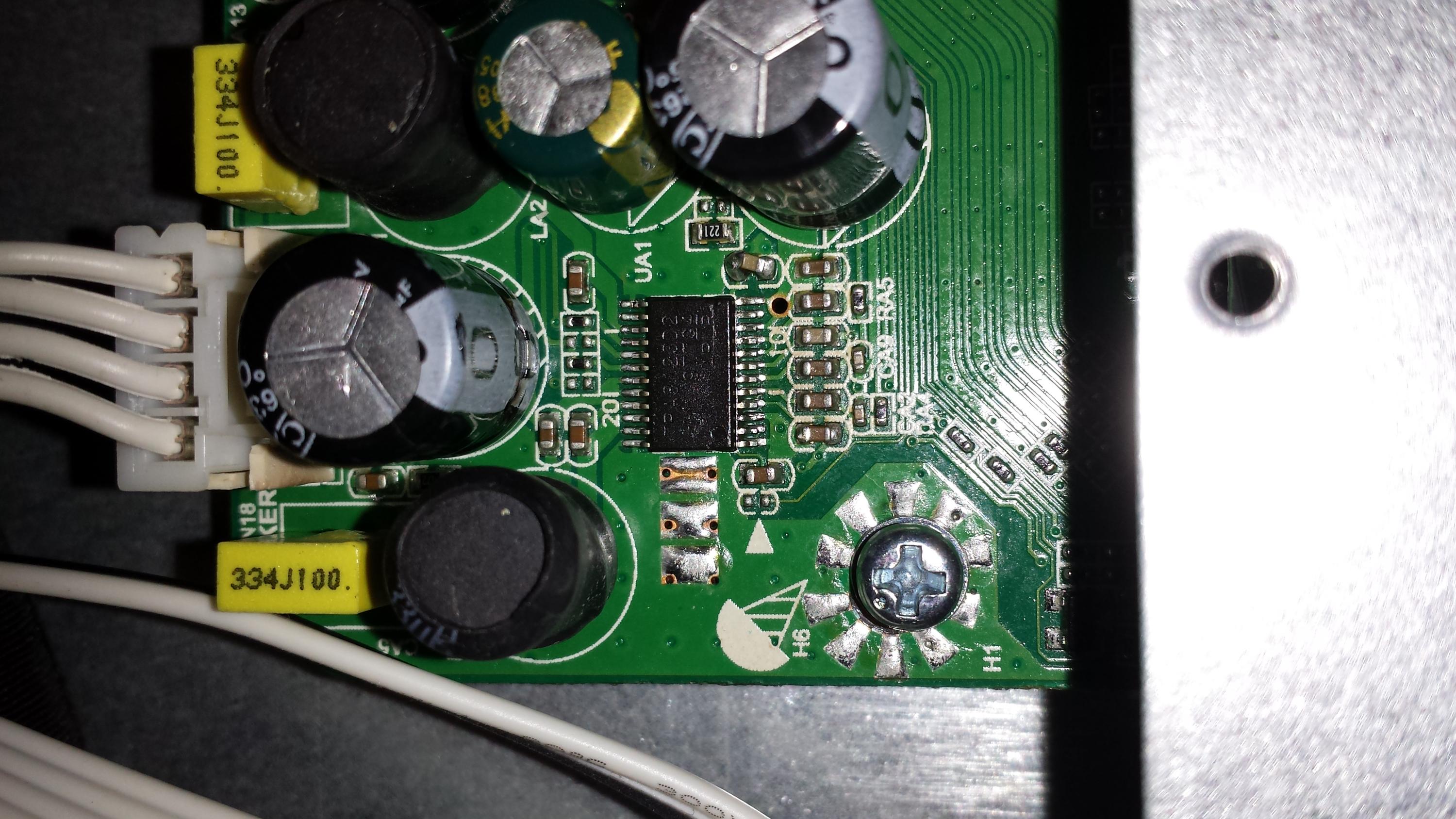

    Hi this has no audio output either on speakers /headphones, i have checked settings and service menu for problems all ok
    all voltages are ok
    mainboard is a horrid T.MSD309.B81C 12176 all voltage regulators check out ok
    any pointers will be great thanks guys

        Got an image of the Ic buddy ? Also have you checked the output and input for it ?

          Re: Bush 50/122f no audio at all
          Here you go bud
            Hmm looks like these boards use the main speaker amp to drive the headphone out as well. Have you checked the voltages going to the amp against the schematic ? On my channel I have a video called "Technika Led Tv No Sound Repair" the amp Ic was getting the voltages but nothing was coming out.

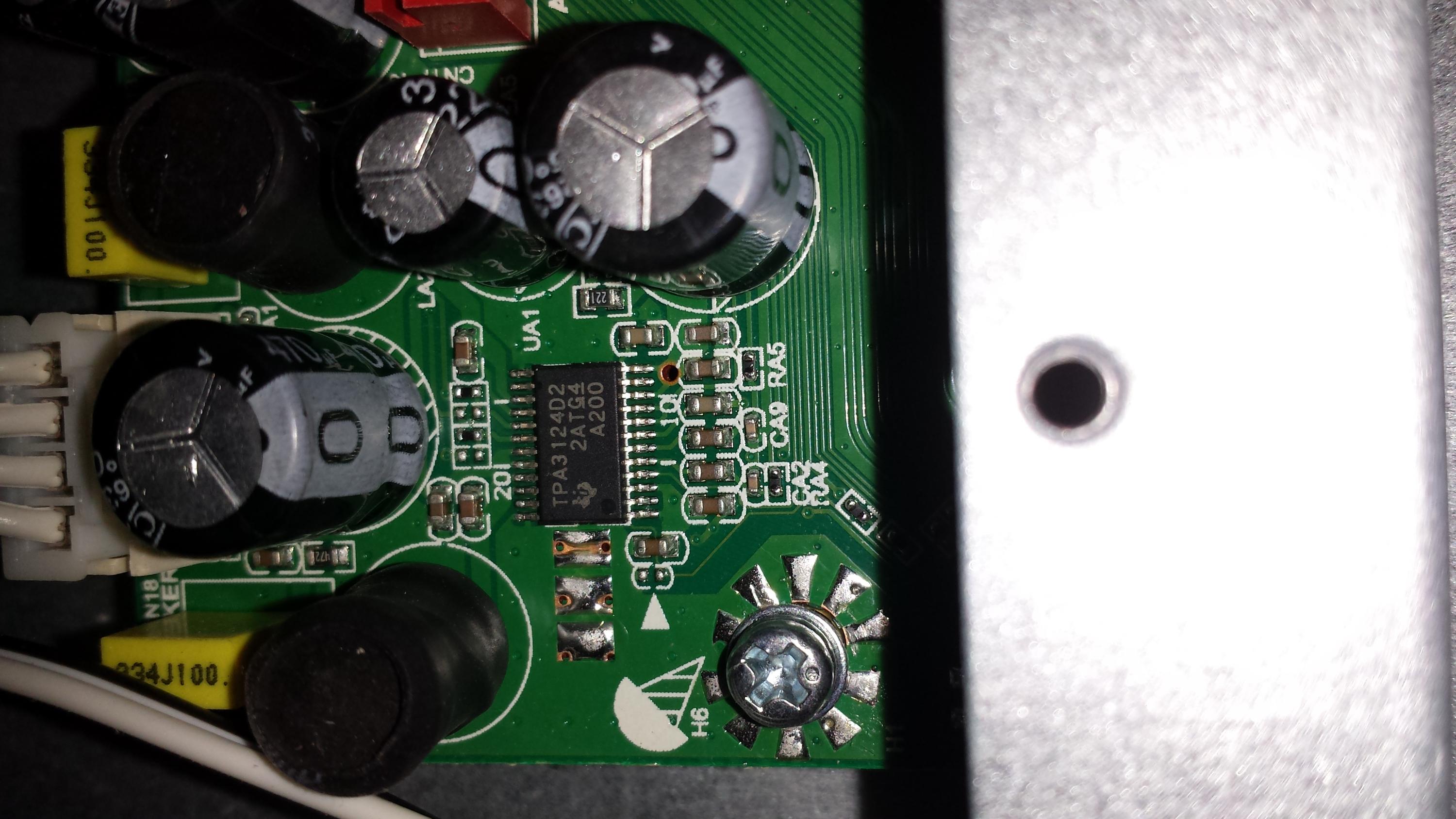

              hi Reece i did see your video and yes no audio at all signal going in but nothing out robbed a TPA3123 off a board and its now working great its now 25w instead of 15w lol

                Wow can you feel the audio power from the speakers with 25w ? Haha lol glad to hear its fixed, my suggestion would be to heatsink that Ic mate Have you an image of your work ?
                  Here you go bud
                  The sound is amazing when the Base line kicks in "NOT" 😊
                      put a thermal pad underneath

                        Wait is that a different board lol the cap is different ? Also yeah TP will work
                          no its not, the original cap bulged with the heat lol
                          it was not quite under the foil i took the big one out lol
