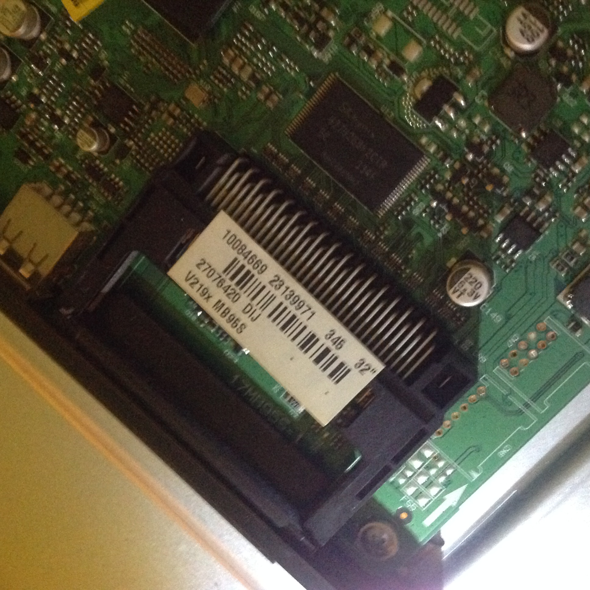

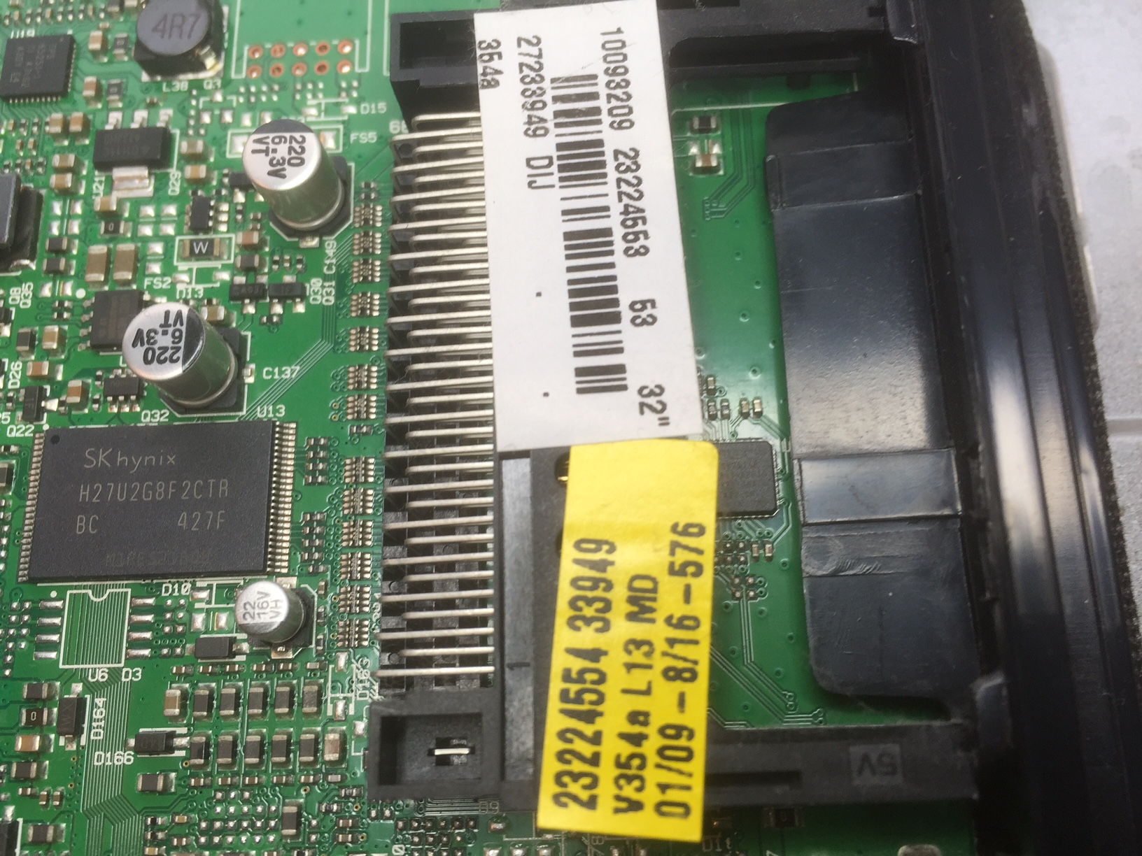

    Hi Peeps, I am currently working on this TV, typical Vestel, it has a main board fault causing it to shut down after an hour, sometime minutes, where is the best place to source a board to match my screen, anyone here help, ?
    thanks.

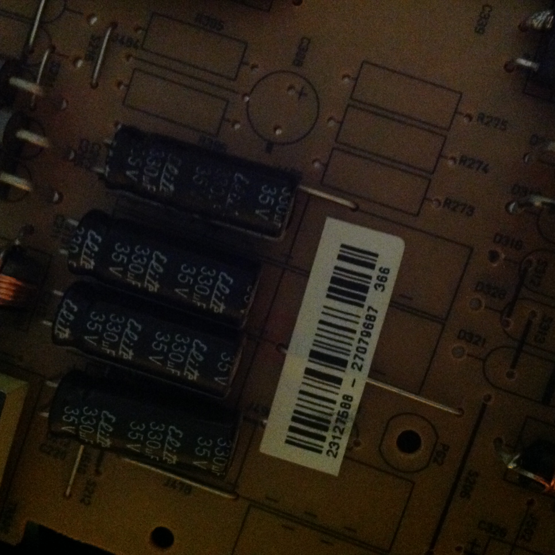

    Re: JVC (vestel)LT40TW51J switching off
    Pictures please showing the parts in your TV

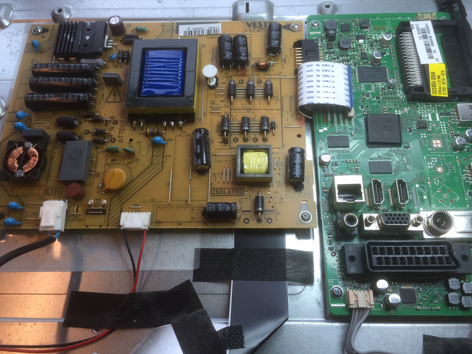

      there it is, cheers
        32" board in a 40" tv????
          When it shuts down can it be restarted immediately and if not what voltages are missing?
            As it is the mobo is the holy 17mb95 shit I would say its a firmware fault. Have you reset the Tv ?
                        If a reset does not work and you have a 17MB95 i recently saw a guy post this fix but unsure if it works but worth a try
                        A common issue,as many will know,is firmware corruption on these,and it's variants.
                        After flashing,you may find that when cold,it will revert to the dreaded blinking light scenario.Many have suggested it's a worn-out flash chip-This is not the case.Its caused by a Multilayer ceramic cap,fitted above C137,directly above the letter C.simply remove it.
                        Problem solved
                          I put a mainboard from a 50" lg in my 60" lg 60pn6500.
                            Thats not the case with Vestels each board has software on it specifically written to that panel and Psu etc. So you cant just change them if the board is the same you need all the numbers to be the same.
                                Thanks for all the replys guys, I updated the firmware but no joy, yes it does start back up again, but powers downagain within a few mins , all voltages are there and correct, I have found a matching main board on ebay pretty cheap so I will let you know
                                    Hi Reecyburger, I have reset and updated software, still no joy, but I have found a Matching Mainboard on Ebay, so gonna fit that later in the week
                                      Hi Dick Barton, no it doesnt restart , get the blue flashing light, all Rails are up, seems to be main board issues maybe firmware
                                        You said you reflashed it though so how can it be the FW ?
