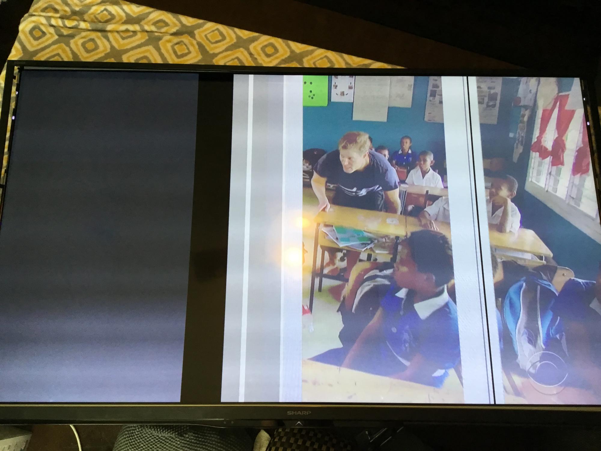

    but I think you still are not really giving the "whole story". First what model are you actually talking about?
    The reason is that the equivalent vizio to the sharp 70 has the same "board structure"... the 60 DOES NOT.
    Having said that, the "checks / tests" are the same, unplug a tcon cable, what happens? Repeat, doing the same for the other side? Next, you move to the corner cables, what happens there? These "checks" isolate whether you have an issue with the side or bottom tabs.... just unplug tcon cables does not give you a "complete view" of issues.
    Having said that, when I was dealing with the sharp, unplugging part of the tcon did give some vertical lining on the side unplugged as opposed to blank white so it isn't necessarily totally unusual... I think. Hence, my thought that perhaps the tcon has an issue where something has happened to it. But again, the basic checks should help identify that. Further, the vizio tcon / system doesn't appear to have as good a shut down process once an error occurs, taking out certain "drive components" that need to be replaced to get it functional again.

      It's a E70-C3
      I'll try a new tcon
      Thanks again man

        One last point / question. The picture that you show is that AFTER removing the tab drivers on the side?

          Re: SHARP LC-70LE550U - side driver issue?
          Yes
          But the original shaded line is gone
            The panel had the same image with the side drivers attached but the definitive horizontal line was there.
            I remote left side divers ( the original side that had the defect) the horizontal line /band is gone now but the vertical pattern is still there.
            I'm going to purchase a new tcon.
            Cheers
              I have the same 70 inch Sharp as in the subject. I followed the instructions and determined the LH side tabs need to be removed. It appeared to be going well until after I reassembled and I got the following picture. Could I have damaged the TCON in the process? The screen is also flashing.
