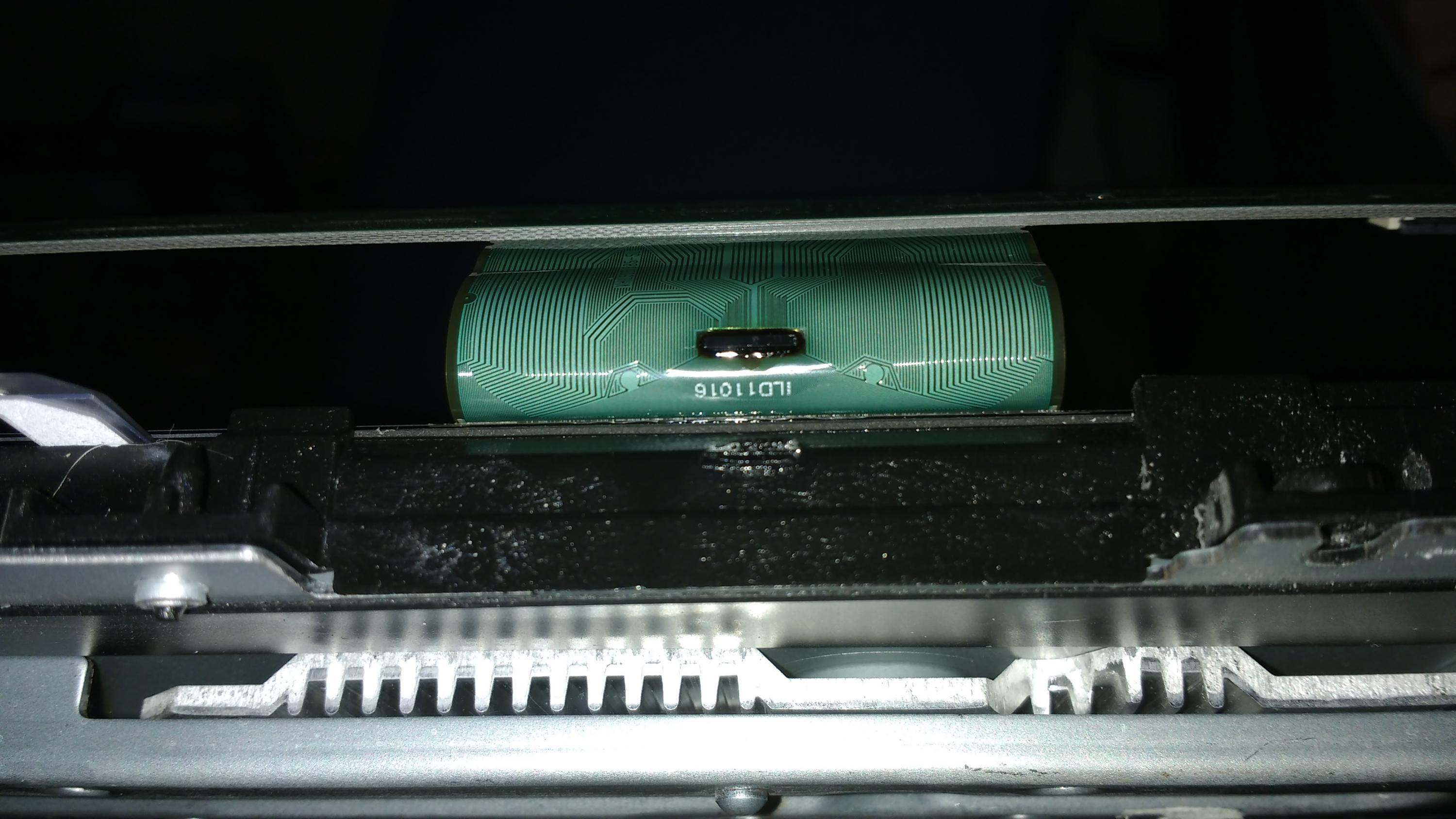

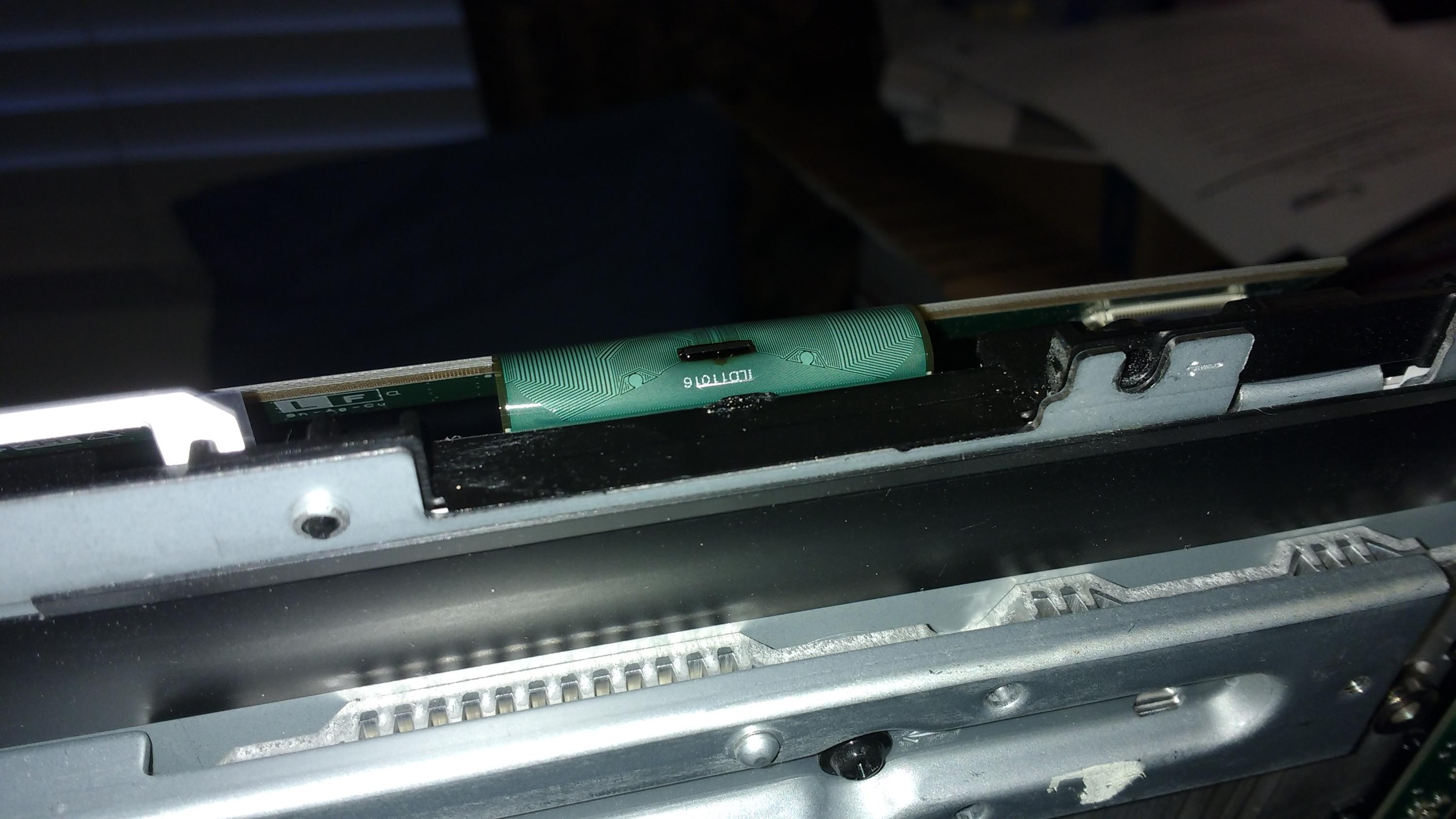

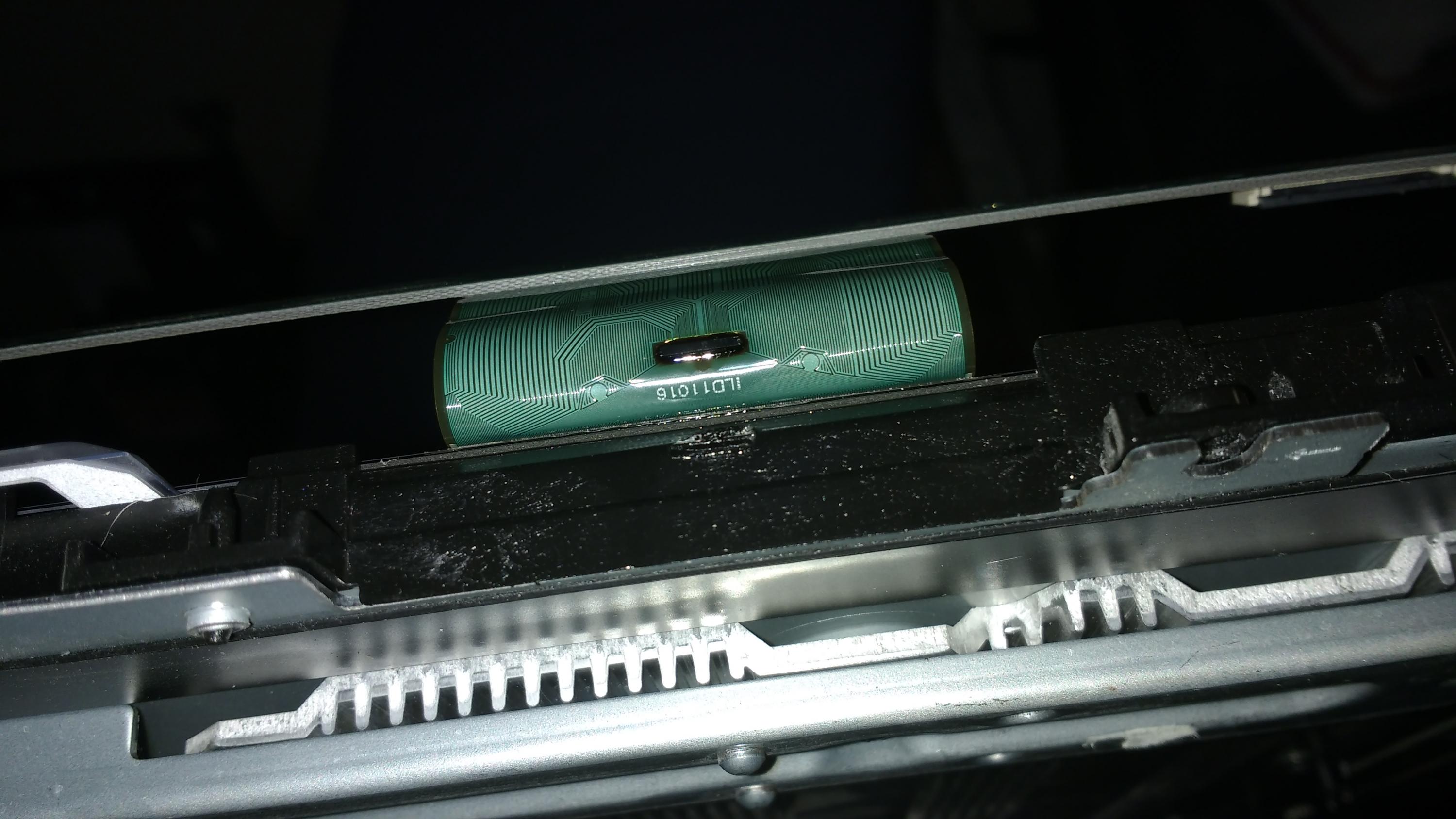

                      Re: SHARP LC-70LE550U - side driver issue?
                      Thought I'd add my findings. Images show that the driver got hot enough to melt the plastic surround.

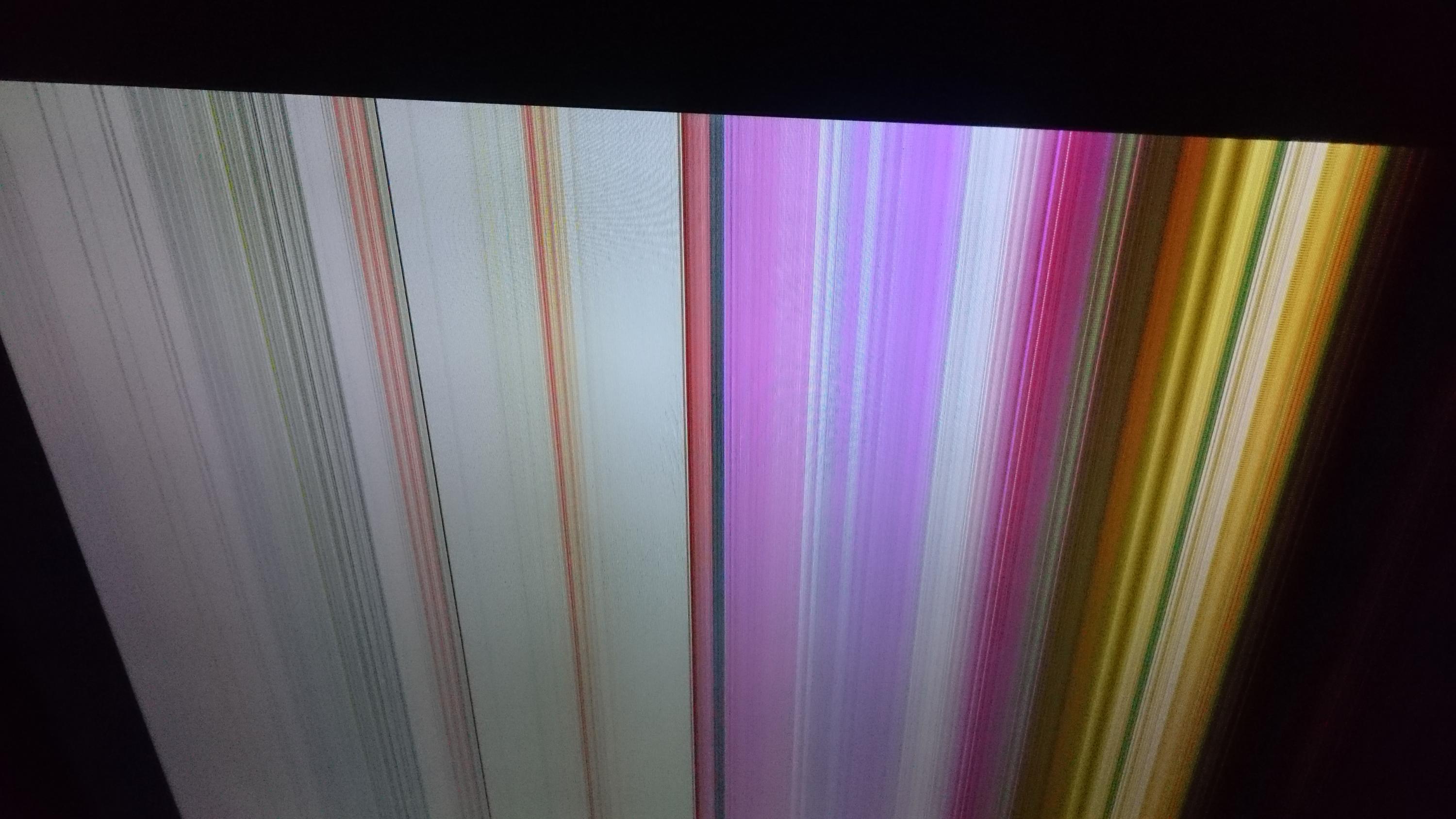

                                      #38
                                      Budwich is this what she would look like if it took out the tcon
                                      • budwich
                                        • Jul 2015
                                        • 3097
                                        #39
                                        hmmm... I wouldn't expect that many lines across the screen...
                                        but... is this a vertical or horizontal picture. My take is its vertical but there aren't many visual clues... :-)
                                        Further is that half the panel or the whole panel?
                                        Lastly, how did you get to this point??? :-) sorry I can't provide more guidance as it is strange and further I haven't actually seen a vizio in the flesh, only reading / following the vizio thread as I worked on the sharp.... since the panels are the same.
                                        Does the vizio have 4 tcon cables or just two?

                                          #40
                                          Sorry for being vague.
                                          It started with a faint horizontal band across the middle of the screen.
                                          When I investigated, it had a side driver tab kinked under the lcd panel.
                                          I took a credit card and freed it from under the lcd and like flicking a switch the picture went to the image I posted.
                                          The picture is now vertical lines over the whole screen and it's quite psychedelic.
                                          The pic posted last night is the whole tv both sides.
                                          It has a single tcon with 2 ribbons.
                                          I'm wondering if when I touched the driver tab if I shorted something on the tcon.
                                          The only reason I'm bugging is that the sharp tv would display the same lines and patterns while trouble shooting to determine which side to remove the driver boards.
