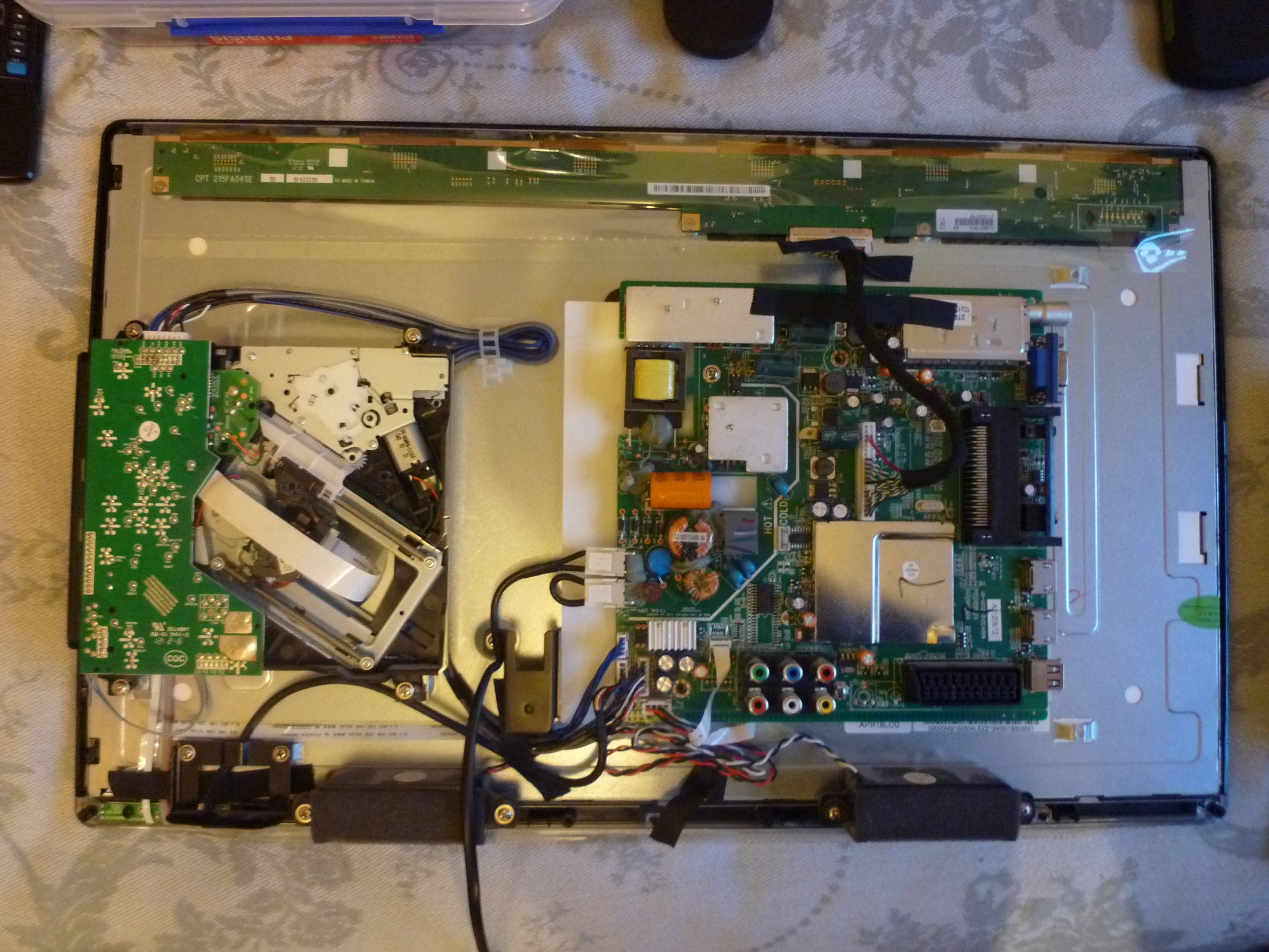

    Hi, have this LOGIK 22" TV which has no image or sound? I think it may have something to do with the integrated DVD player but not 100% sure?

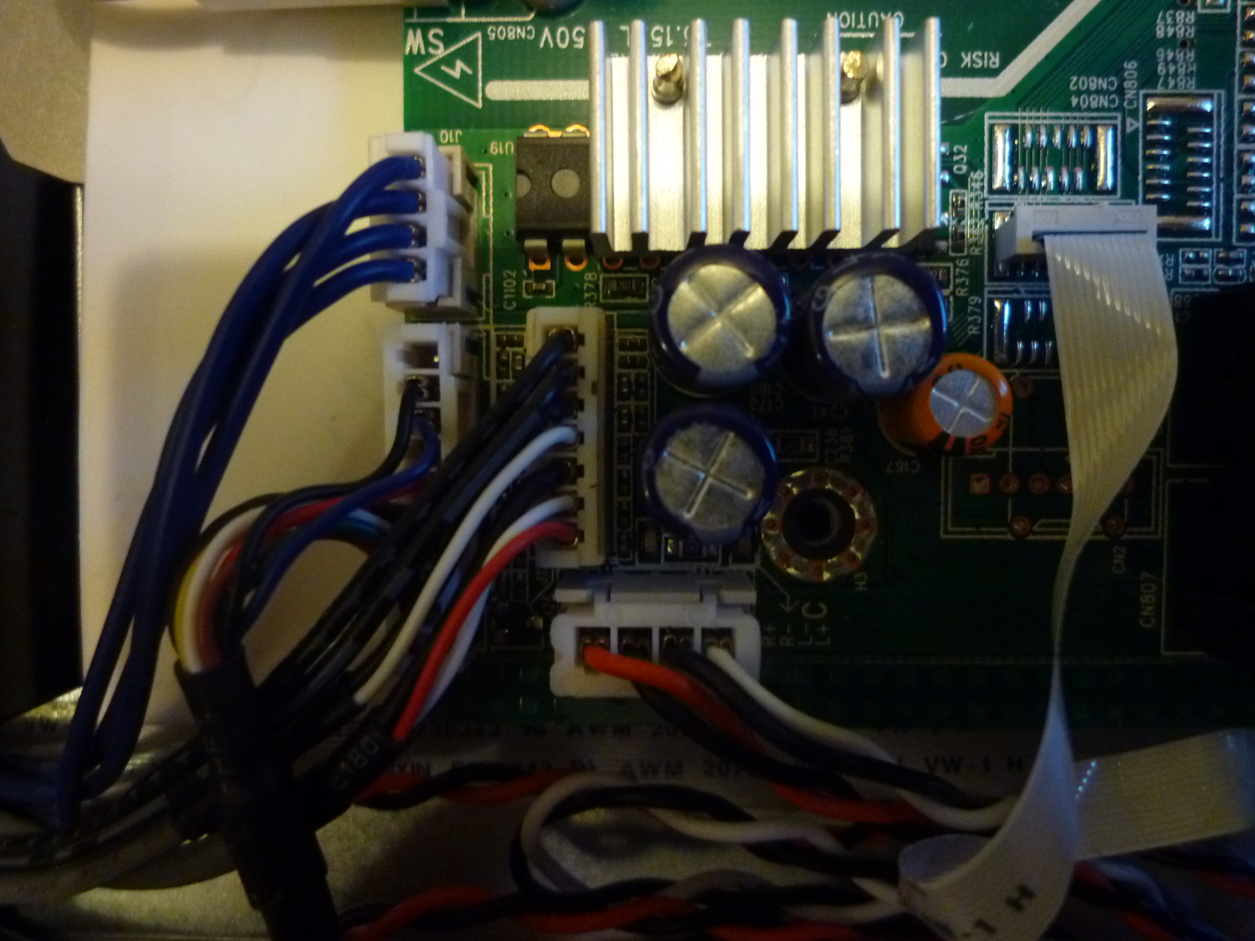

    With the mains cable connected and switched on, there is no STB light or blue on light but the DVD drive is spinning? If I disconnect connector C1102 on the PSU (4 blue wires) this stops the DVD drive from spinning and the blue on light comes on? Sometimes I can get the TV in to red STB light so able to turn the TV on using either the on/off switch or remote. I have tried another main/PSU board but get the same results as with the original board.

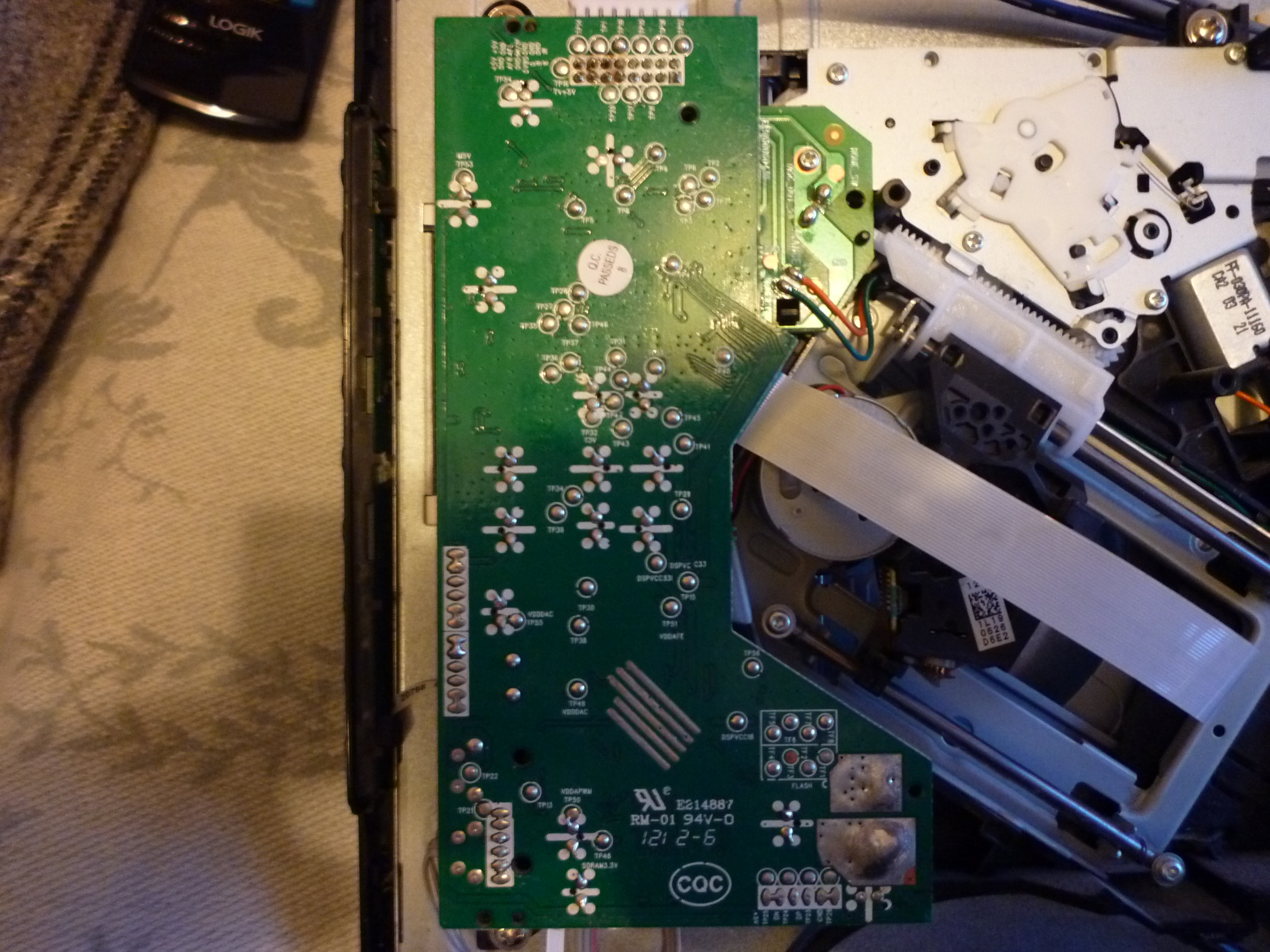

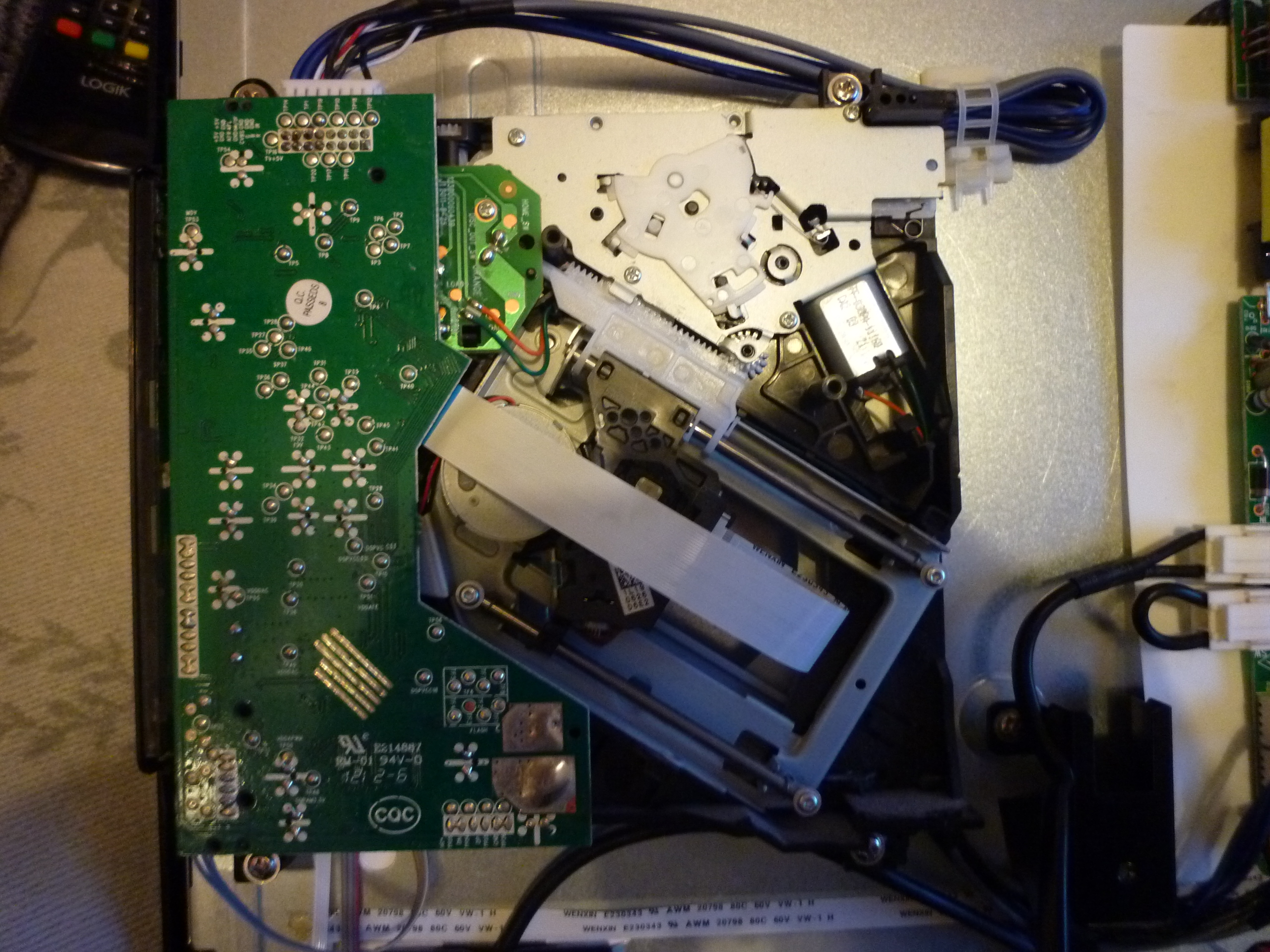

    I'm wondering just what the board on top of the DVD player doe's?

    unplug the dvd player, the tv works fine without one.
    then turn your attention to votages on any voltage regulators on the main board.
    to answer your question btw, the board on the dvd player IS the dvd player, it's a standalone player with 5v / 12v input and a/v output on the top connector.

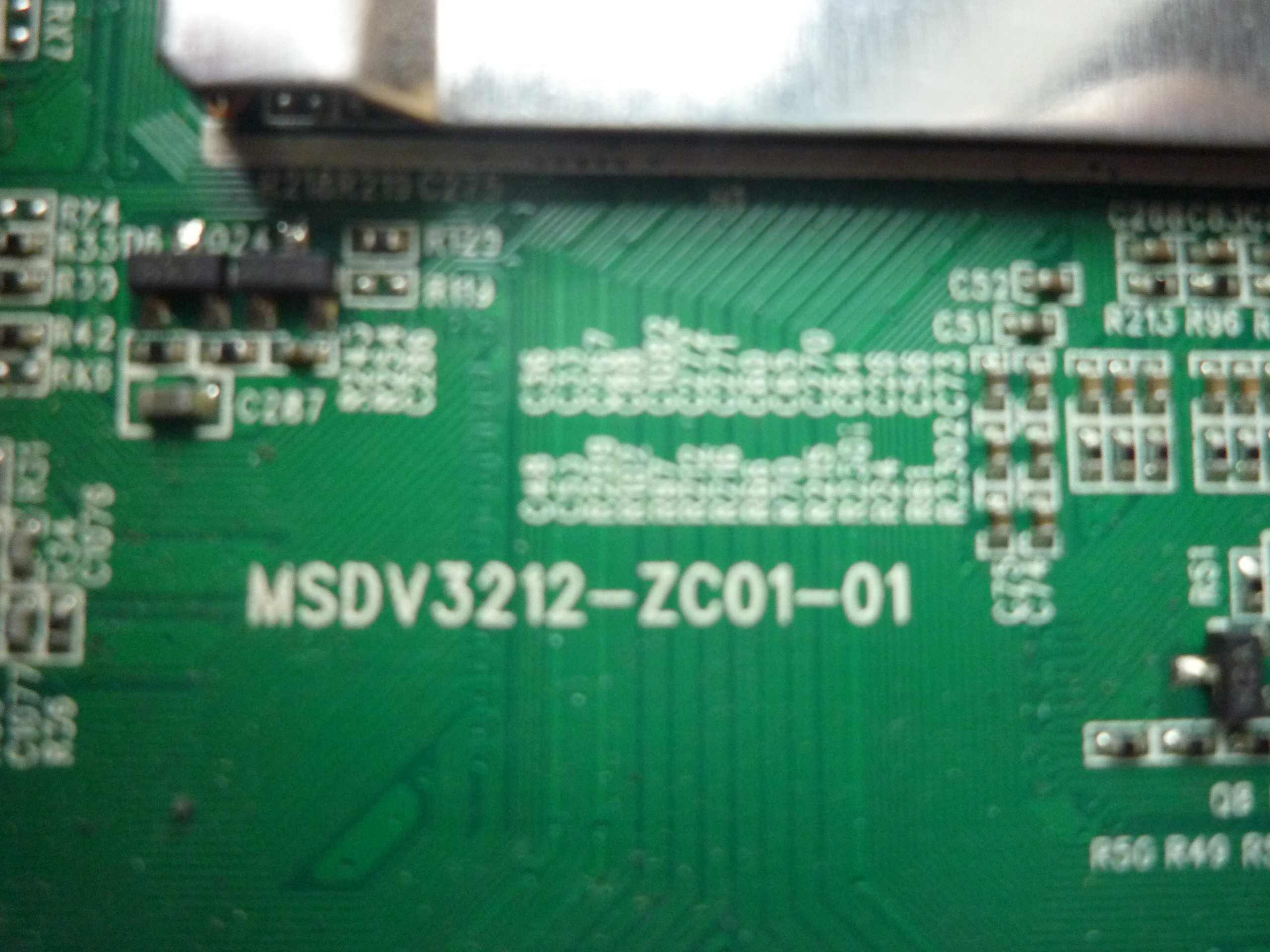

        Whats the power board number?

          Re: LOGIK L22FED12 No Image/Sound - Possible DVD Drive Problem?
          Msdv3212-zc01-01
            Originally posted by AlbertRoss
            Msdv3212-zc01-01
            i will have a look in my spares boxes when i get a few spare minutes ive collected a few 22in sets with cracked screens and kept the boards i will let you know shortly.
                Hi sorry about delay nly just had chance to go through my spare board boxes (i was looking for a psu for a set im repairing) anyway im sorry but i dont have a board matching the numbers/model you need.
