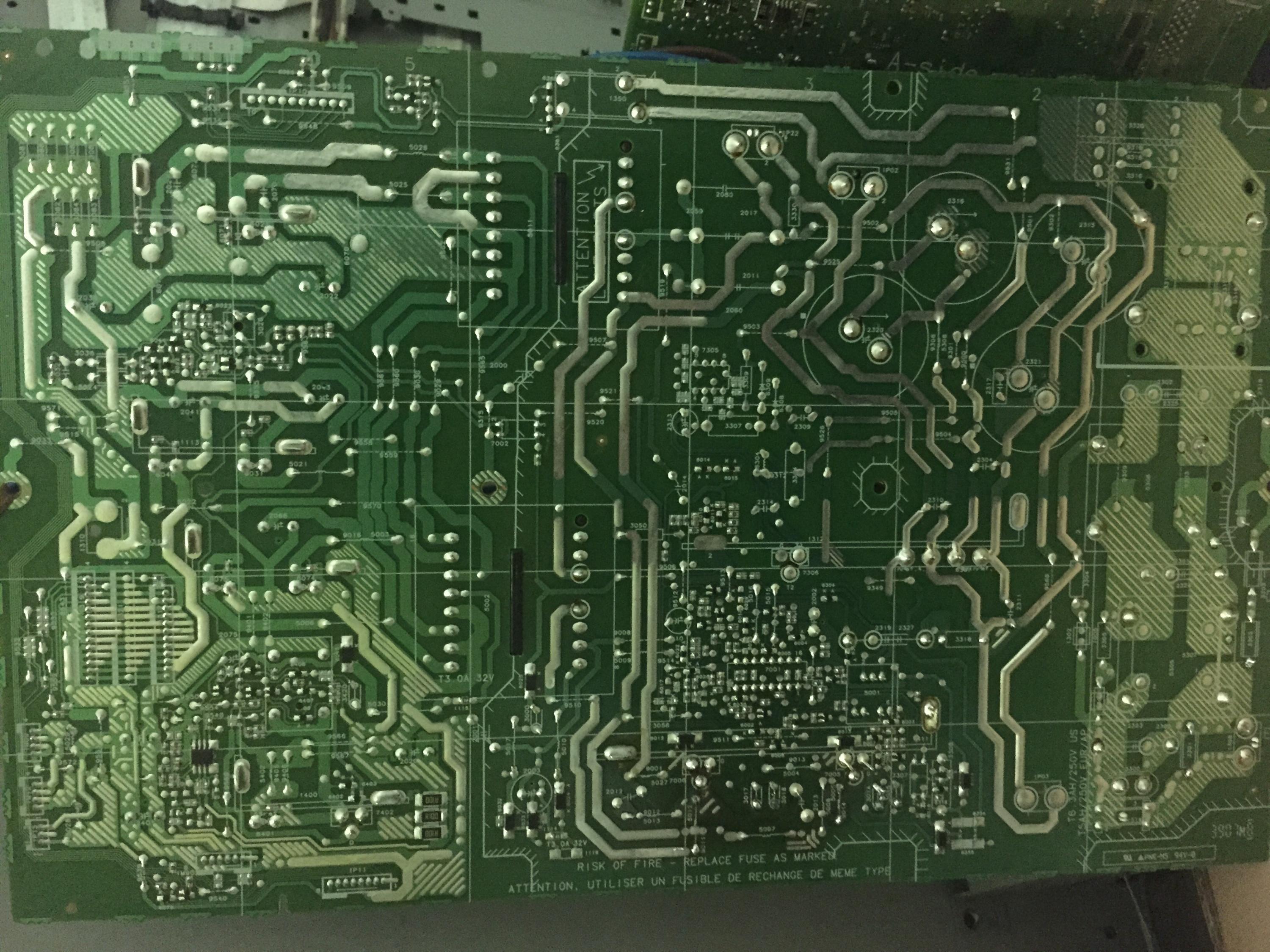

Re: tv lcd Philips 42pfl9632d/10 Power board ko
Top and bottom side of the main board so we can look at the small power supply on that main board? We need to get that 5V from the main board power supply.
tv lcd Philips 42pfl9632d/10 Power board ko
Re: tv lcd Philips 42pfl9632d/10 Power board ko
The relay is turned on when the main power supply board receives the 5V from the main board power supply. I do not get to see good clear pictures of the whole boards in post 58, I waisted so much time with OP on the 100 Ohms resistors already, plus try finding the diagrams, etc. and not getting any where with the OP.
See if this picture is better, or is better two different photos of the same board?Leave a comment:
Re: tv lcd Philips 42pfl9632d/10 Power board ko
The relay is turned on when the main power supply board receives the 5V from the main board power supply. I do not get to see good clear pictures of the whole boards in post 58, I waisted so much time with OP on the 100 Ohms resistors already, plus try finding the diagrams, etc. and not getting any where with the OP.Last edited by budm; 03-20-2016, 04:09 PM.Leave a comment:
Re: tv lcd Philips 42pfl9632d/10 Power board ko
Wondering if this gets measured in DC voltage and if its plugged in (just to be sure to confirm that there is not even a 160 dcv standby)Leave a comment:
Re: tv lcd Philips 42pfl9632d/10 Power board ko
yes thats correct i was just confirming. I will have a read of the whole of this thread and download the manual ive just read the relay isnt being energised so you wont get the voltage on those capacitors anyway so we need to see why the relay isnt being turned on.Last edited by vinceroger69; 03-20-2016, 03:57 PM.Leave a comment:
Re: tv lcd Philips 42pfl9632d/10 Power board ko
how are testing these capacitors black lead on negitive of the capacitor red lead on positive?Leave a comment:
Re: tv lcd Philips 42pfl9632d/10 Power board ko
do you get any voltage on the large main capacitors on the hot side of the psu please remember and be carefull as this is the hot side of the psu and carries mains voltage.Leave a comment:
Re: tv lcd Philips 42pfl9632d/10 Power board ko
I tested the the V in the first part of the main board, anD i have 220V in the connector. The fuse of the main board is good and the same for the resistor of 1 ohmLeave a comment:
Re: tv lcd Philips 42pfl9632d/10 Power board ko
I think the best thing too do is too put any parts you have removed back on to the board and double check your soldering etc then re connect all connectors and then we can start all voltage readings from the basics and may be test your multi meter with a battery too make sure its reading the correct voltages first.).
The multi meter are good, i use two different, and One have two weeksLeave a comment:
Re: tv lcd Philips 42pfl9632d/10 Power board ko
I think the best thing too do is too put any parts you have removed back on to the board and double check your soldering etc then re connect all connectors and then we can start all voltage readings from the basics and may be test your multi meter with a battery too make sure its reading the correct voltages first.Leave a comment:
Re: tv lcd Philips 42pfl9632d/10 Power board ko
"The strange is that the speakers are connected to the main board... if there isn't V, why they work?" That why are you 100% SURE that there are NO Voltages on the connectors of the main board, power supply board? There must be measurement errors.Last edited by budm; 03-19-2016, 03:01 PM.Leave a comment:
Re: tv lcd Philips 42pfl9632d/10 Power board ko
The 5V is generated by the power supply on the main board, so you need to find out of the main board is getting the main AC feeding the 2-pin power connector on the main board or not.
It is time for you to upload pictures of the whole back side of the TV so we can see all the boards and how they are connected together.
What is the history of this TV? Was it hit by power surge? drops? someone worked on it before you? etc.
as soon as i will post the photo of the back side tv.
The strange is that the speakers are connected to the main board... if there isn't V, why they work?
i say alone. the main board take directly the 220V AC from the black connector of the power supply, for this reason the speaker worksLast edited by Bibu; 03-19-2016, 01:05 PM.Leave a comment:
Re: tv lcd Philips 42pfl9632d/10 Power board ko
The 5V is generated by the power supply on the main board, so you need to find out of the main board is getting the main AC feeding the 2-pin power connector on the main board or not.
It is time for you to upload pictures of the whole back side of the TV so we can see all the boards and how they are connected together.
What is the history of this TV? Was it hit by power surge? drops? someone worked on it before you? etc.Leave a comment:
Re: tv lcd Philips 42pfl9632d/10 Power board ko
no,with all boards connected i haven't voltage, no 5v and no 25VLeave a comment:
Re: tv lcd Philips 42pfl9632d/10 Power board ko
Main power supply board connectors.
Do you have 5V2 (notes: this Voltage is generated by the power supply on the main board, chassis GND ref.)? See the large version of the SCH.
Do you have 25V_HOT (GND ref to negative leg of main filter cap in the DC primary)?Last edited by budm; 03-18-2016, 03:22 PM.Leave a comment:
Re: tv lcd Philips 42pfl9632d/10 Power board ko
Isn't brown black brown GOLD and violet?Leave a comment:
Re: tv lcd Philips 42pfl9632d/10 Power board ko
That is 100 Ohms resistor (Brown, Black, Brown) 5% MOX (Metal Oxide) Flame proof.Leave a comment:
Vizio e601i-A3 - Has Sound and Display, But No Backlight - Bad Power Supply Board or Bad LED Bulbs ?by Tynan DillI was given this TV from my great uncle. He said it just wouldn't turn on one day out of nowhere, replaced the TV, and gave it to me to possibly fix and use for myself.
Assuming...7 Photos -
by Destroyer-Br[HELP] Acer AN515-55 (LA-J871P Rev: 1B) – Board won't power on after GPU investigation – Suspecting Super I/O or PCH
Hi everyone,
I'm working on an Acer Nitro 5 unit with the following specs:- Motherboard: LA-J871P Rev: 1B
- Model: Acer AN515-55-59MT
- S/N: NHQ7JAL00403906A973400
- SNID: 03902728734
Initial Issue
The laptop initially presented graphic issues and driver failure (Code 43) for the GPU.
After preventive maintenance (cleaning, thermal paste, etc.), it powered on normally. We disassembled it again to inspect the GPU, reassembled... -
by spantorHello partners.
Could someone tell me how to make this Philips TV source work without the mainboard being connected? The model of the board is EAX65423701 (2.1) and the model of the Philips TV is 40PFH40009/88.
The TV is dead, there is no standby light, however there is a voltage of 12v on the pins ( included 12v VAU ) and 3.2v on the PS-ON pin (see photo) when the power board is connected to the main board. If I disconnect both boards I only get 8 volts on 12v pins. I would like to rule out a fault in the main board by making it work, but so far no one has been able to tell... -
by Dani_2024Hi and thanks in advance for any input you might provide!
Last Sunday I was watching a dvd and fell asleep for about half hour, when I awoke the tv screen was black and couldn't get the dvd menu to show, so I changed the input to antenna and had sound but no picture, turned it off. I then got online and found this great site! ....read many troubleshooting tips and this...5 Photos -
by SoulzinkHi everyone,
I am trying to fix a samsung washinmachine power supply main board.
I already replaced it with another one to fix the machine but i want to try understand the issue with the old board.
Therefore i hope to be able to get some help to explain what to check in order to troubleshoot.
The power supply board reference is the following: DC41-00189a
I have followed one thread (https://www.badcaps.net/forum/troubl...ingmachine-rel... - Loading...
- No more items.
Leave a comment:
