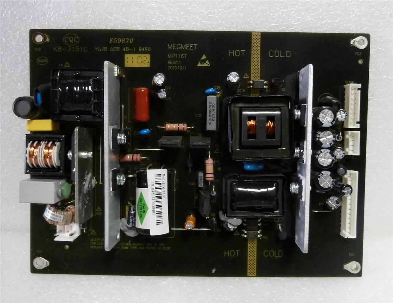

    any ideas what would be causing main fuse on ps to blow?
    power supply board mp116t
    keeps blowing main fuse when plugged in
    bridge rectifier tests good out of circuit
    see attached photo of ps

    fyi when i check for continuity from any ground pin to any power pin i get continuity
    isnt this bad?

        Checked the switching and Pfc devices ?
          Re: WestinghouseVR-3225 lcd tv keeps blowing main fuse on power supply mp116t
          At least check the resistance between legs of the devices mounted on the heatsimk first to see if it shows very low resistance.
