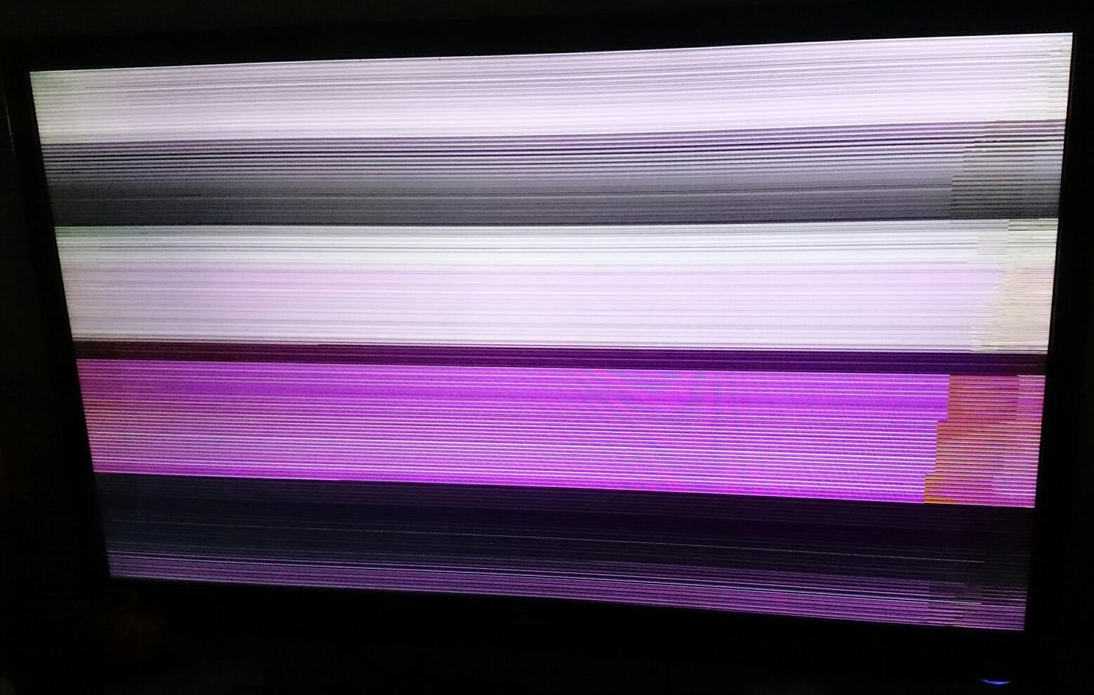

    LG 3DTV 47LW5700 full screen of artifacts on power on
    today, when my mom turned on her tv to watch the dark knight rises on tv, the picture was fine for a few mins at first, then it deteriorated to a full screen of artifacts like an abstract art painting as shown in the attachment. i tried power cycling the tv but it still turns on and displays the lg logo as a screenful of artifacts. after we tried running the tv for 15 mins, the picture cleared up a bit but it was still very wavy and liney.
    any idea whats wrong with the tv? i only encountered artifacting problems like this when my computers had a gpu that died. could it be either bad caps or a cracked solder joint since the artifacts cleared up a bit when the tv heated up for awhile?

    Service manual to start you off is available
    http://tinyurl.com/zydl969

      Re: LG 3DTV 47LW5700 full screen of artifacts on power on
      did she watch it with 3D ?
      if yes or no, took the tv out from the plug for long time, to reset T.CON
        Panel fault IMO. Try reflowing motherboard.
          IMO... Mr. Panel..
          hard reset enough by IN_Start from any Android Mobile with IR sender..
            no she watched it in 2d. it was an analogue OTA broadcast.
            exactly how long is "long"? i tried unplugging it till the standby light went out for about 30 mins and turned it back on but still a similar artifact pattern.
              order menu by RC, if it show make factory reset, if not show menu
              use In_STOP then put code 0413 TV will go standby them after while you turn it on.
                IMO... Mr. Panel..
                Its PanelBurger to you ! Also IMO=In My Opinion.
                  Try reflowing the motherboard I bet the Bga solder is failing as you said it cleared up.
