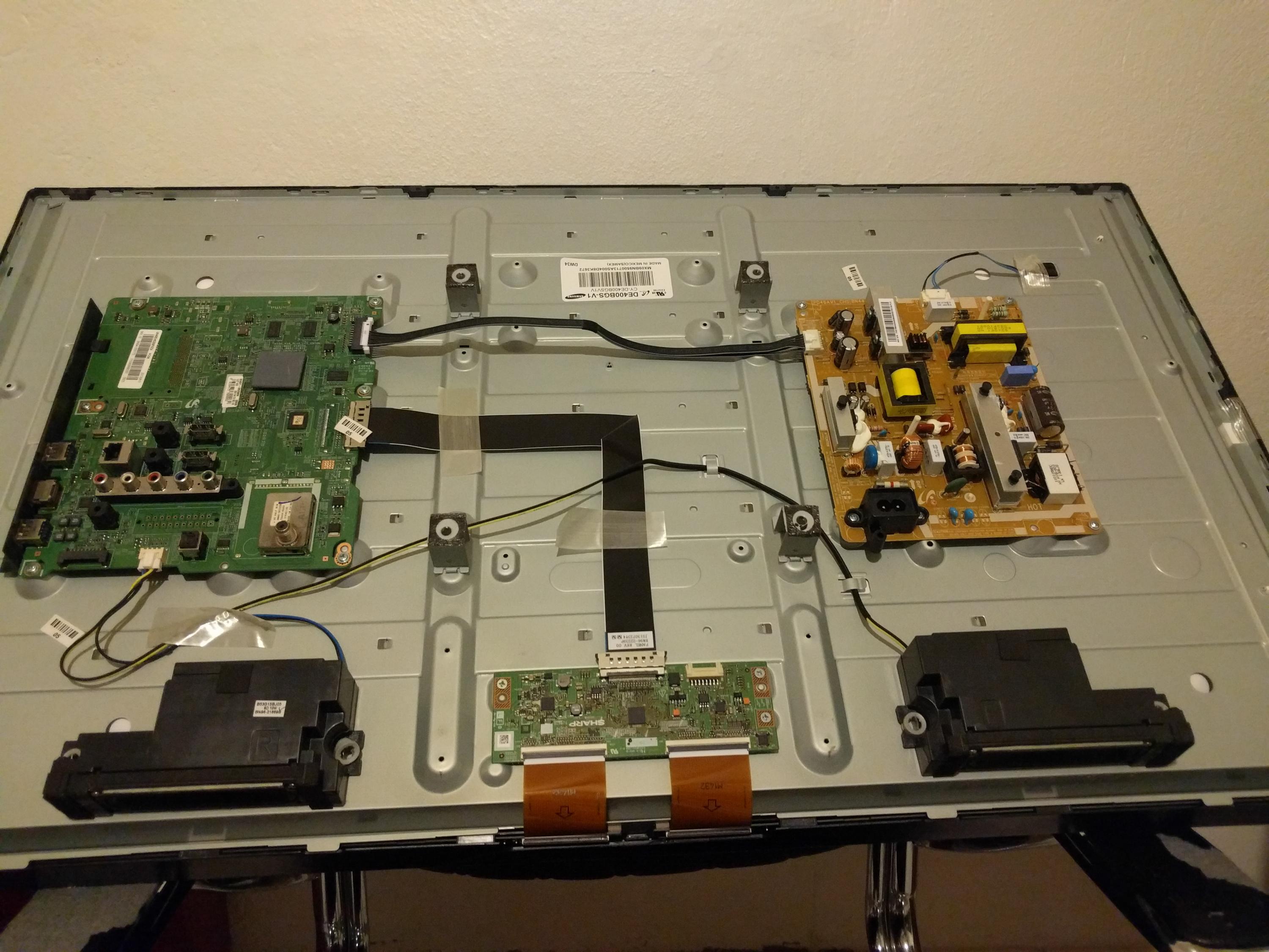

    Hi, i got a flat screen someone was throwing away, the problem is that it works perfectly for about 30-45 min, not too sure on the exact time. After that the backlight turns off and stays off (it may flicker for a second before turning off), i can turn off the tv for while and itll turn back on normally and work for a while again.
    I had opened it up and looked at the caps on the power supply and they look fine. Attached is a picture with the back cover off... would love any help to know what might be the right board to replace.
    Thanks!!!

    When you get it to stay on again go to the user on screen menus setup and turn down the backlikgts to about 50% and see if the backlights will stay on longer.
    I will not be surprised if you have LEDs going out on you.
